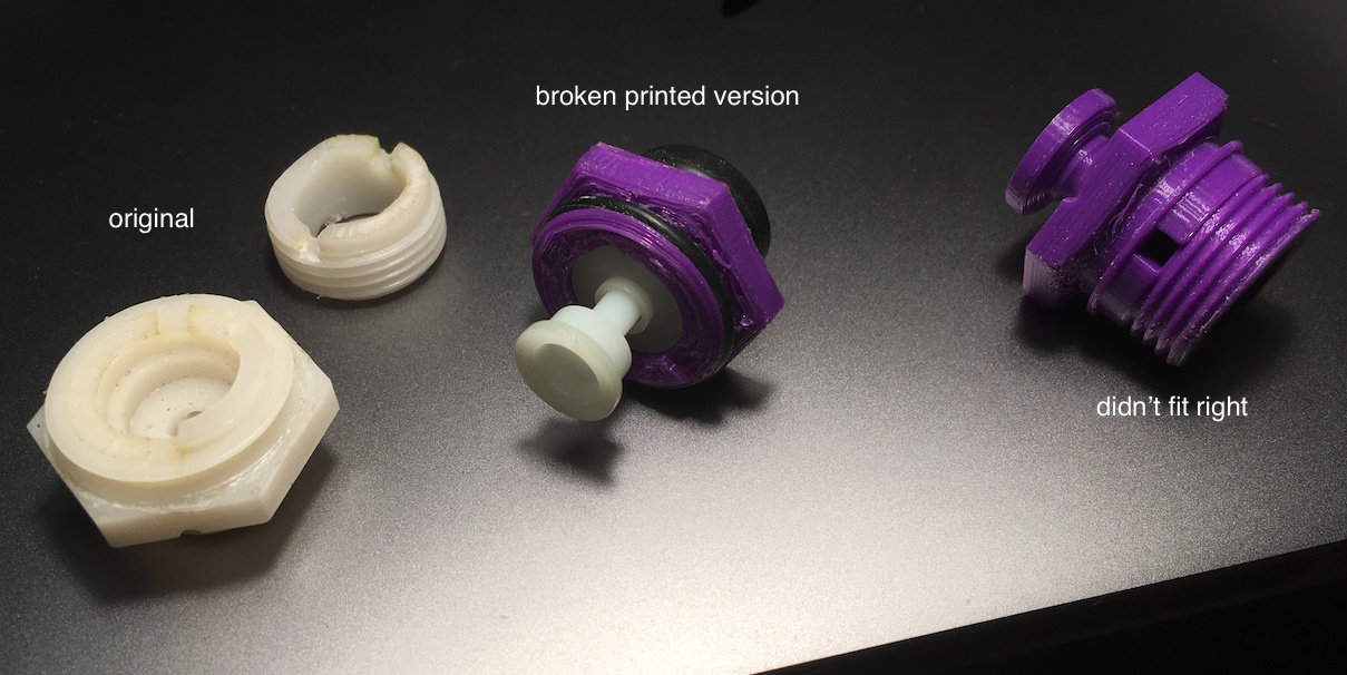

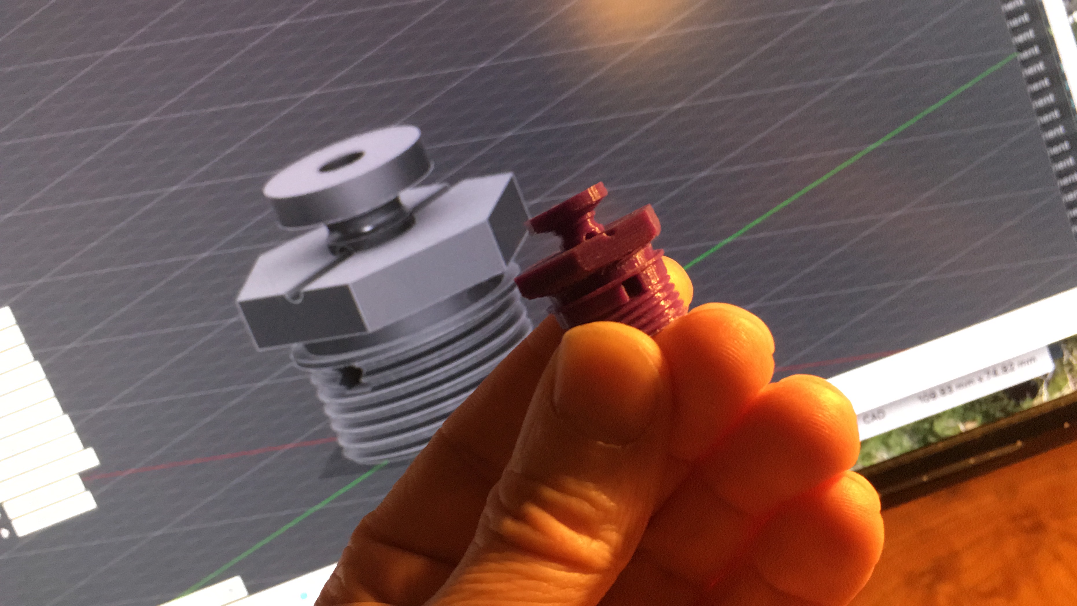

So my interest in this comes from a crappy pressure washer made in China with a Snap-On label
What makes it crappy is they used a plastic part for the pressure valve /switch which the original lasted 2 or 3 uses … so I drew up a new plastic part and the 3D printed version lasted 30 minutes ( in PLA 100% infill ).

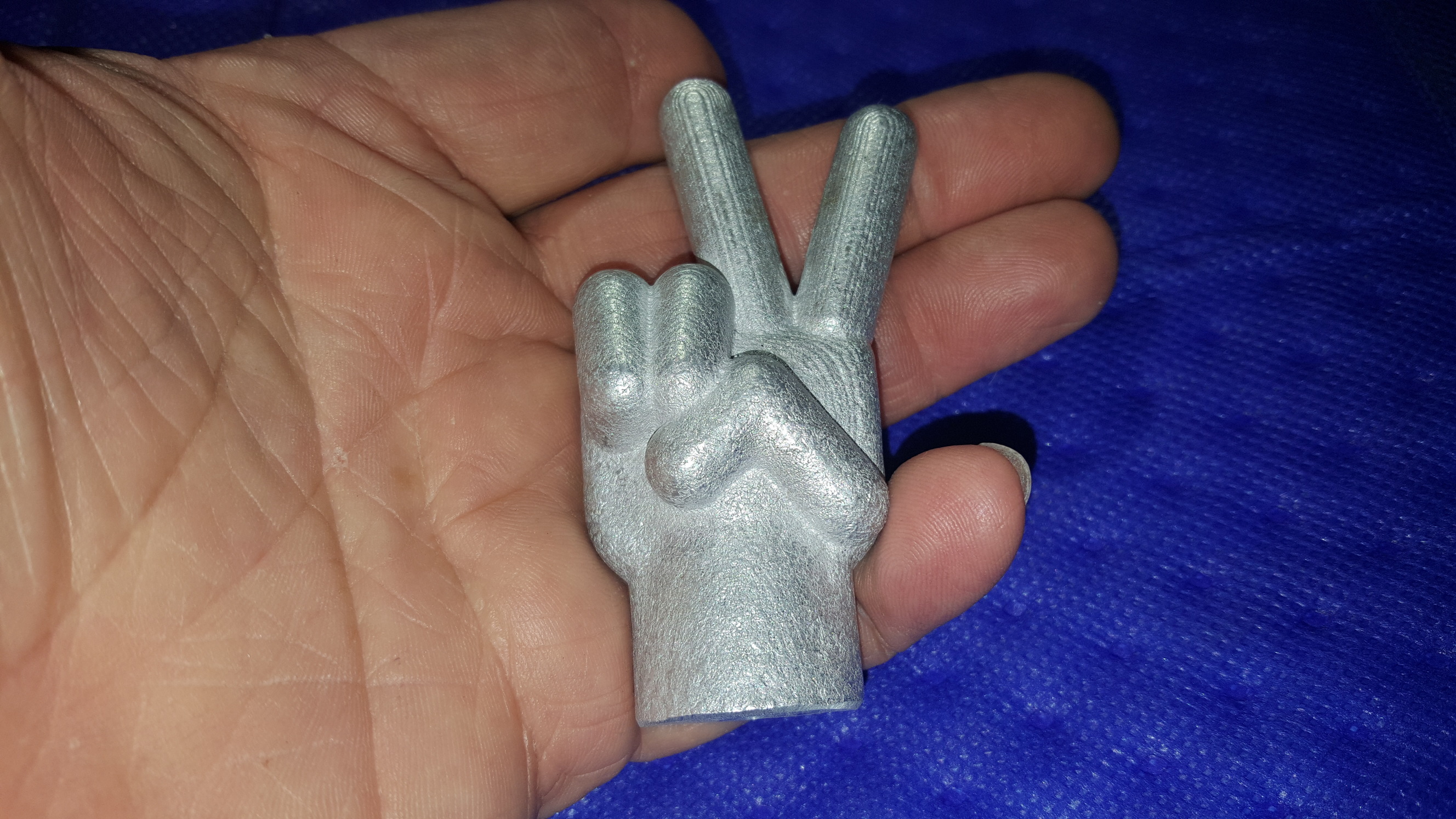

I’ve done some lost PLA casting.
It’s not hard to do at all.
Print thin wall and very little infill.

this piece holds that plunger that hits the electricity to control the motor when the gun is triggered
Is casting even the right technique for that part? It looks like you could make in by drilling and tapping a suitable bolt. Which dimensions are critical?

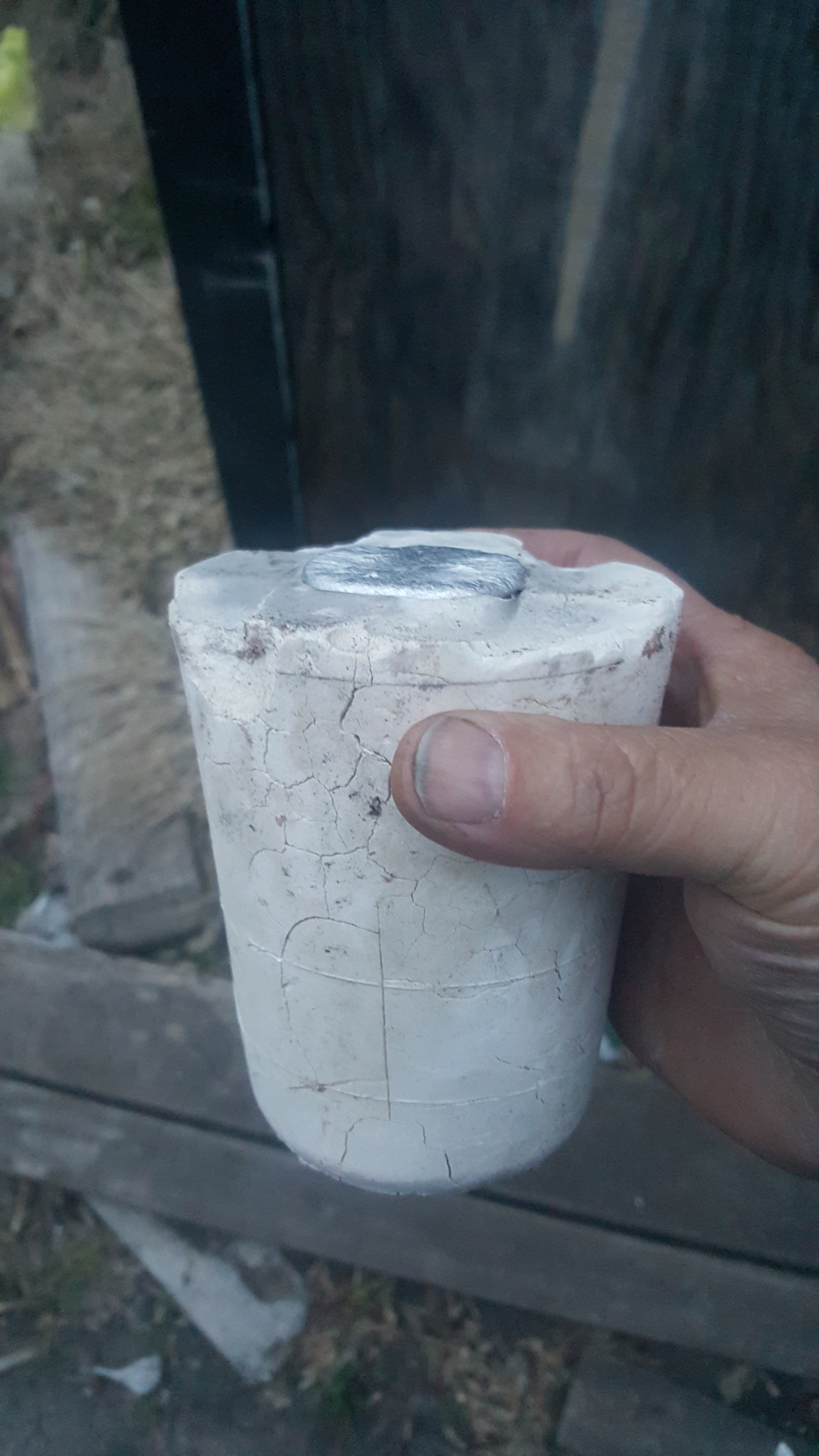

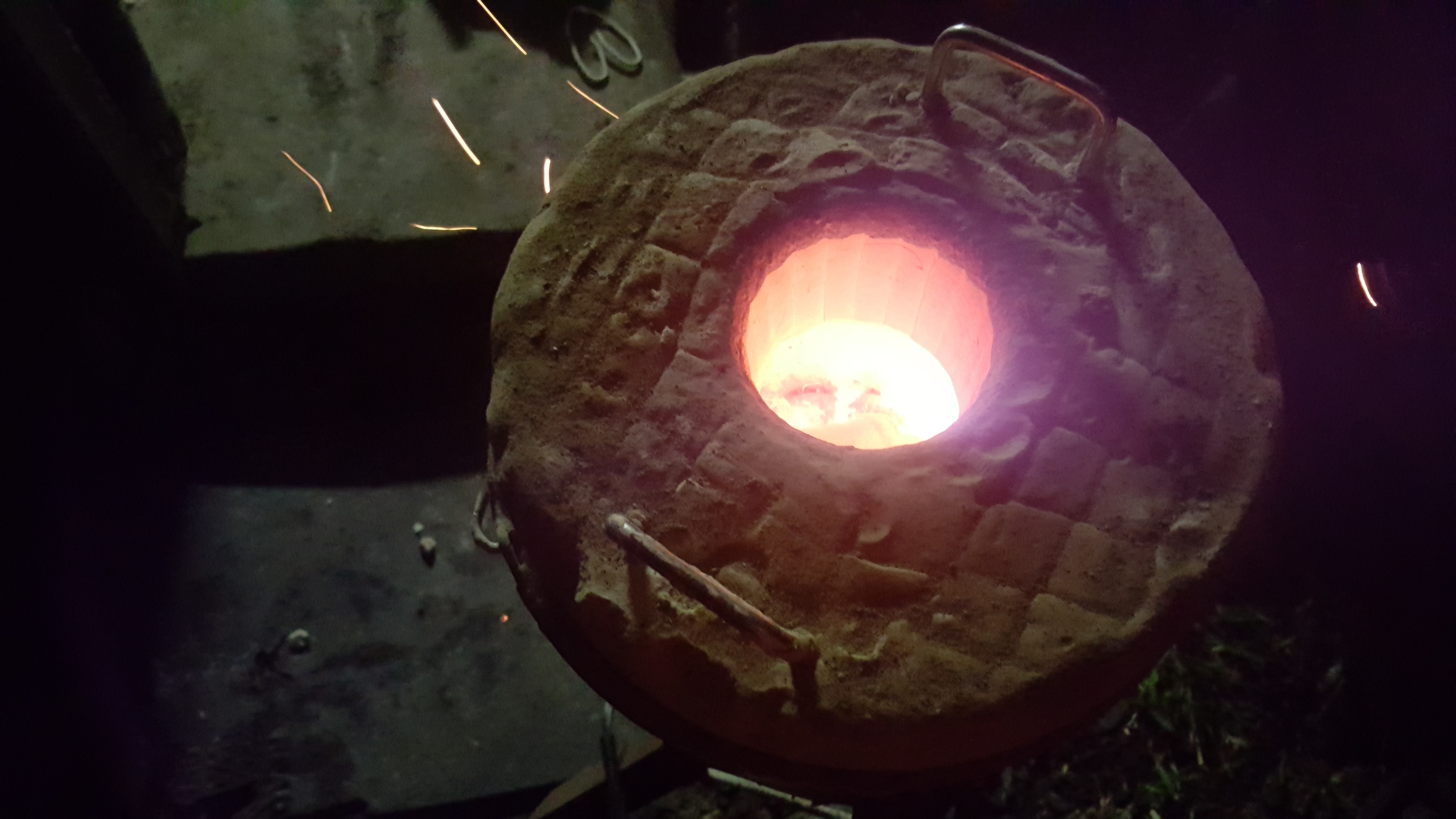

No, it’s a sand and plaster of Paris mix.
I watched a lot of videos on YouTube before I did anything.
First thing you need to figure out is how to melt your aluminum.
I made a foundry that the YouTube guy THE KING OF RANDOM.

Seems to break at the square holes, ABS or PETG might hold together better. Don’t think additional metal inside the would help much, there is a spring between the plunger and nut + water pressure pushing against the nut.

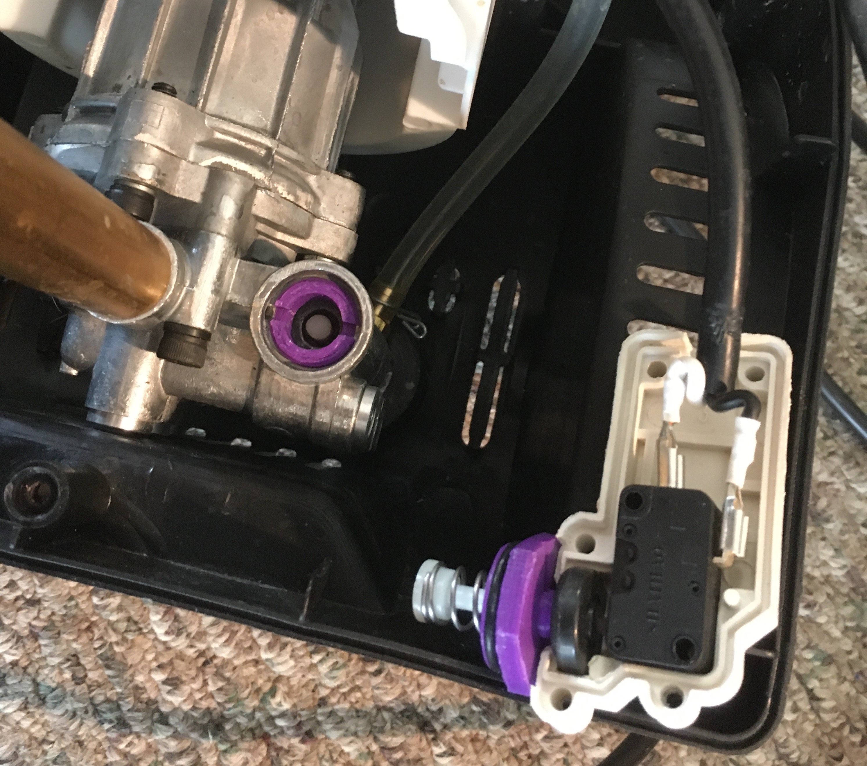

a good idea… though my machining skills would probably lack and would need some tools . The threaded length, diameter and square hole would be critical dimensions. this thing gets screwed into a metal valve body

picture of the microswitch and valve with the broken piece still stuck, to show how it fits together.
the “bolt” needs to be an M20 x 1.5
it can be done with a bolt. get the shortest one you can find, the shortest McMaster sells is 30mm.
you only need it to be 13mm.
a threw hole and 2 counter bores , o-ring groove, hole on the side and finally the groove on the top.
an aluminum bolt would be better.
if you do decide to make it just take your time and make sure the bolt spins as true as you can get it.

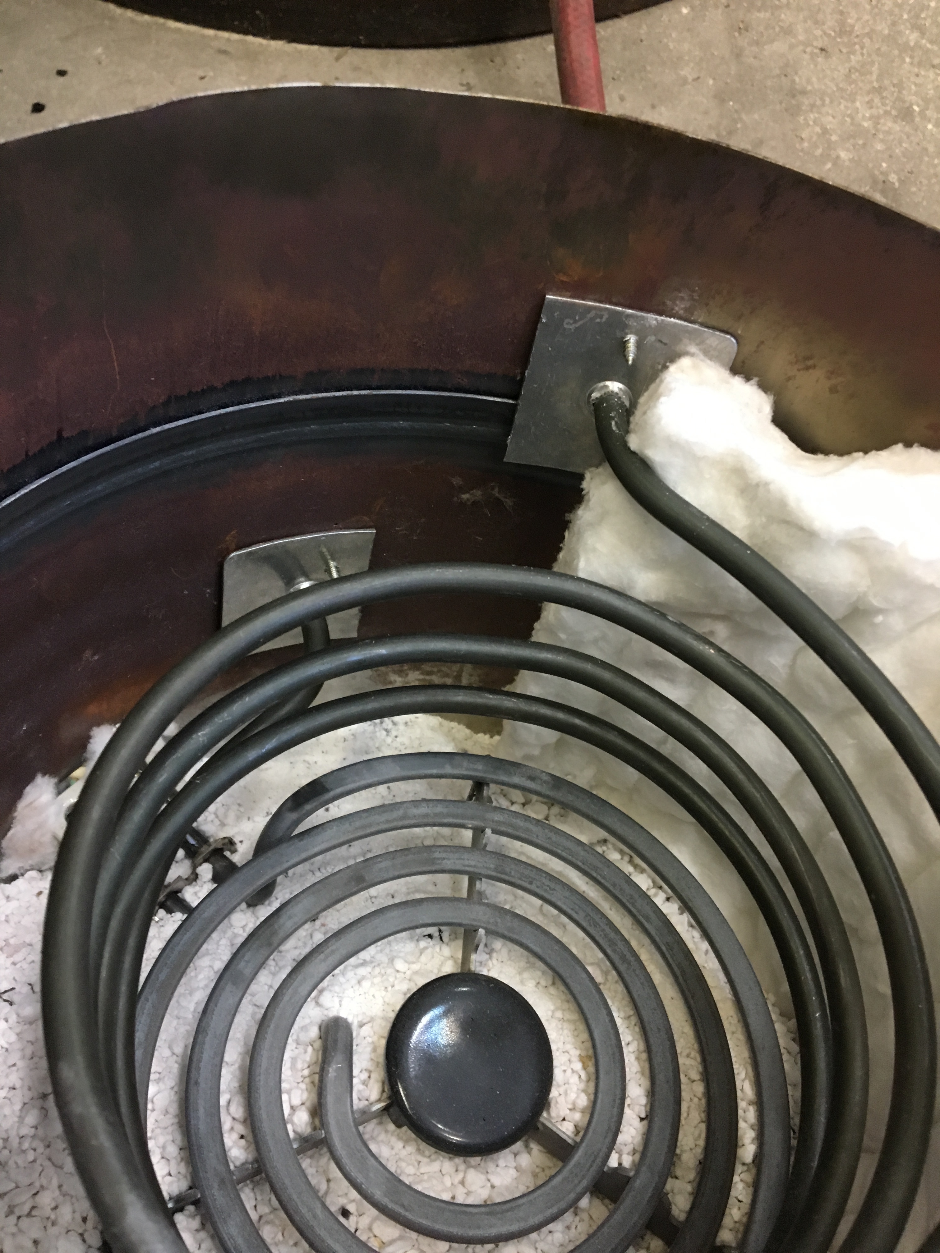

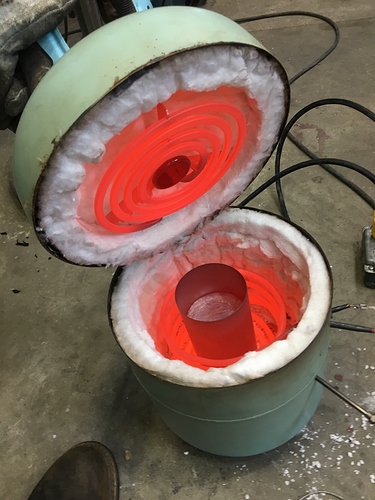

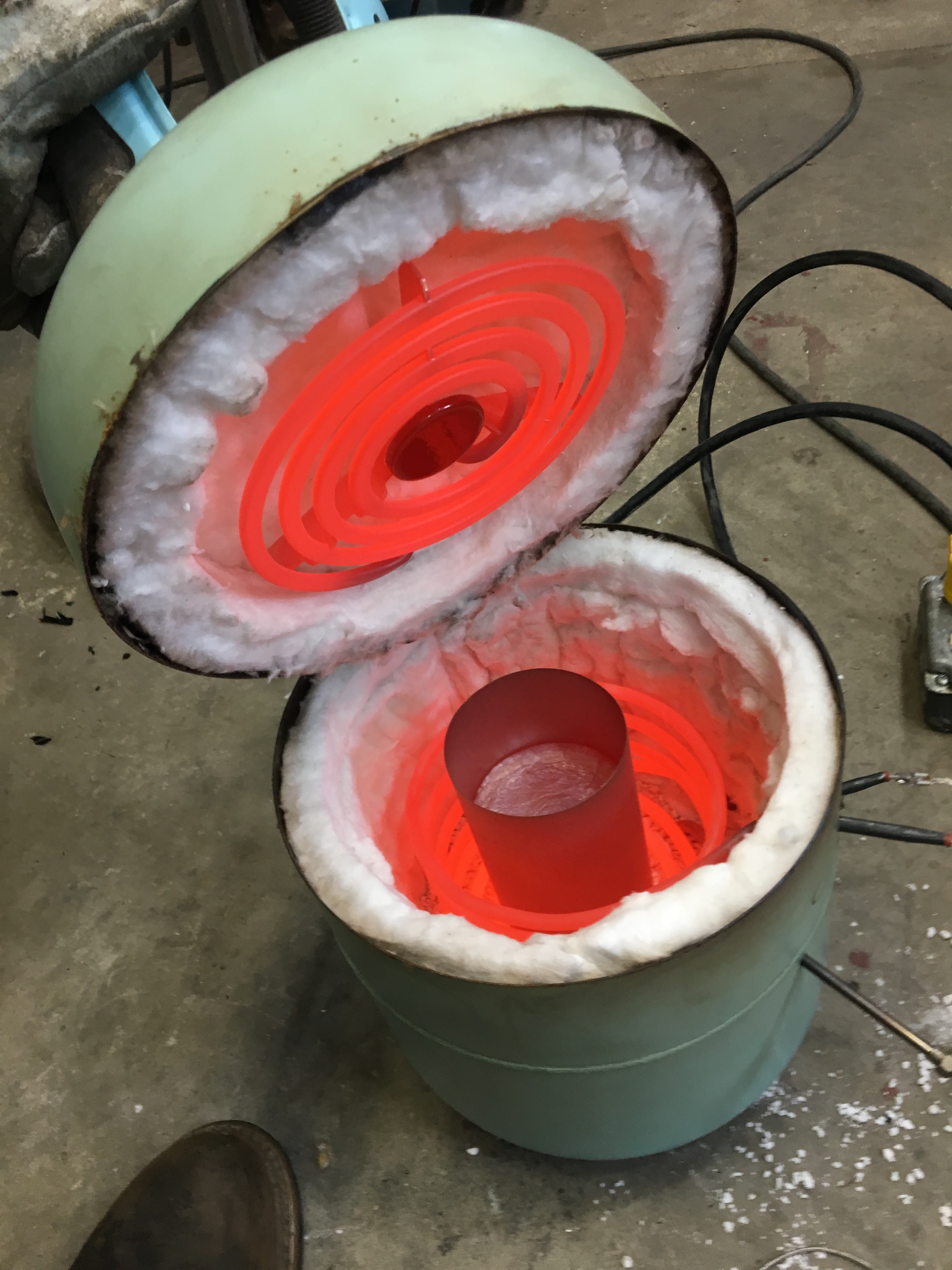

I’ve been tinkering with aluminum casting for a few years now, and it is the main reason for building my MPCNC. My best friend and I have both been experimenting with different aspects of the Hobby. I enjoy carving out utilitarian parts from Styrofoam and casting them in playsand, while my friend has been recently getting into more intricate stuff like veggi oil guy on YouTube and focusing mmore on casting brass.
We’ve constructed various foundaries over the years running off of propane, waste oil, as well as electric. We just recently constructed another electric for him to use for burning out PLA. They say that for curing the plaster and burning out the PLA that you want to ramp the temperature up in increments over several hours. Electric is far easier to control and more efficient to accomplish this.
I’ve done electric with kanthhal wire and fire brick, but I found that the kanthal is somewhat delicate. So recently I’ve put together a few with electric stove elements and ceramic insulation and running them off of 110 V instead of 220 V. Since they operate on less than 1000w it takes a little while for them to warm up but they will reach aluminum melting temperatures and operate for pennies in an hour, and i can plug it in anywhere.
I can post more details if anyone is interested.

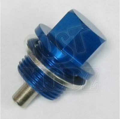

wonder if I should steal the drain plug from my daughter’s junk impreza :grin:
looks close to enough metal to play with
