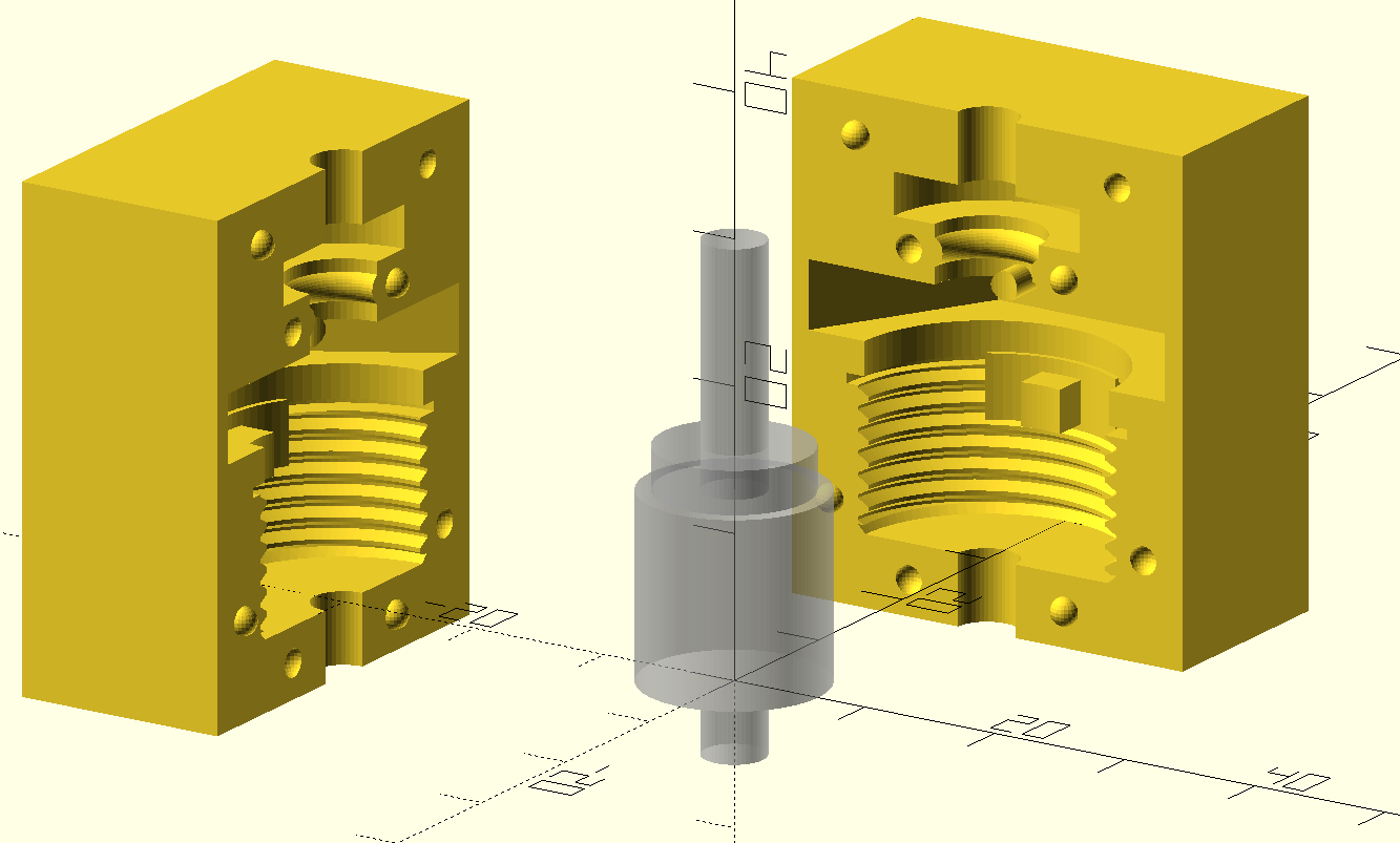

This is interesting as a fun challenge. I am guessing the original plastic parts are made (or could be made) using a three-part mold, with two halves and a core, like this.
The tricky part is getting the mold and part to release from each other. The standard approach is to design the parts with a draft angle, but you don’t have that luxury.
If you use plaster as the mold for metal, then you can destroy the plaster to get the final part out, so that’s not an issue. If you cast the plaster in PLA, then you will almost certainly have difficulty separating them without destroying the plaster. You could soften the PLA with heat and have a better chance of leaving the plaster intact, but then you are printing two molds for each attempt.
Another possibility is to use silicone instead of plaster, and instead of aluminum, to use bismuth-tin alloy which melts at about 281F (138 C). This is low enough to not damage the silicone, and it’s non-toxic and easy to do on the stove.

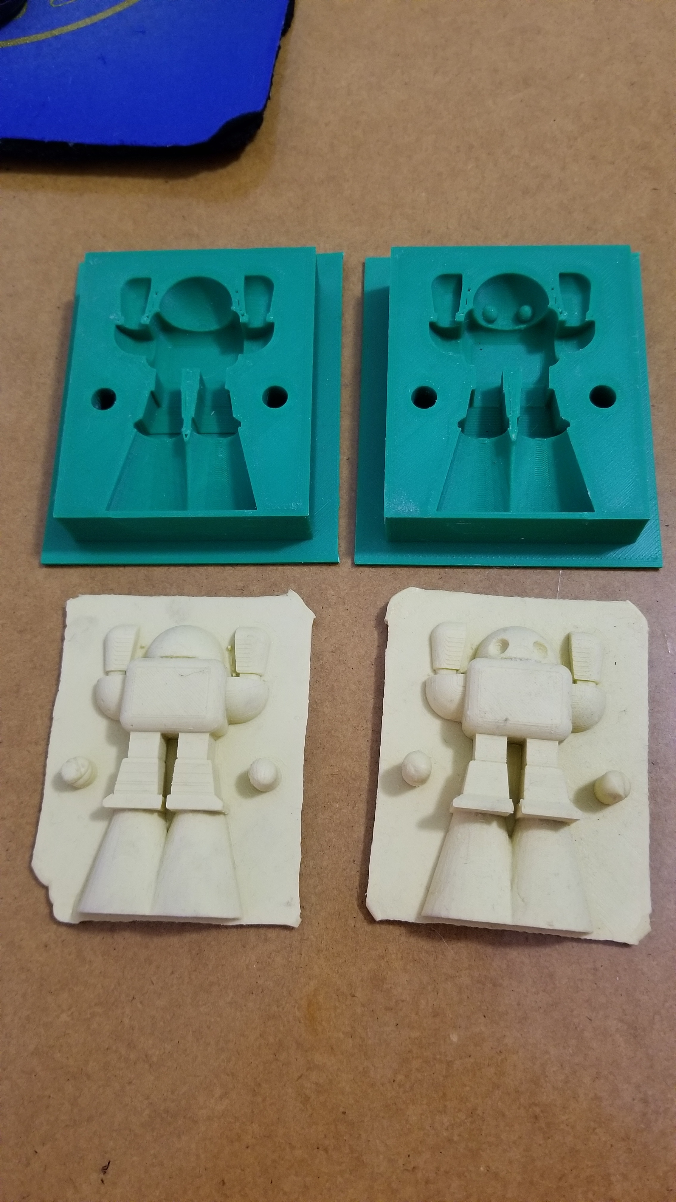

Another approach, if you do want aluminum, is to cast the plaster in silicone instead of PLA, which then requires a negative shape of that in PLA to cast the silicone. I still have the original pieces for when I used this approach to make that metal robot in the other thread. Specifically for the gap between the robot legs I was expecting I would never get that thin wall in plaster to survive without a compliant mold for the plaster.

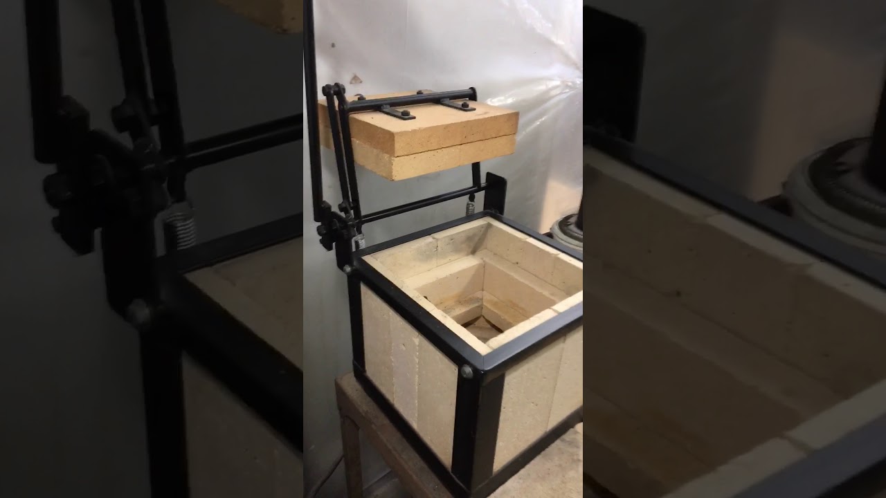

The foundry in the pictures that i posted above actually contains three elements. Two 1500w 6” stove elements and a 3400w oven broiler element that i wrapped in a coil. Each element has its own 110v power cord. The 220v elements only pull one forth the power on 110v, so in this configuration it pulls 1600w, 375+375+850. I run it with the two 6” elements on full time and the broiler element is controlled by the PID controller.
I used an empty 20LB(?) freon tank that has a 10” diameter and 1” of ceramic insulation. A bit of perlite under the lower element to insulate the bottom. The two 6” elements by themselves were not enough on their own to reach melting temp, but may be capable with more insulation. I added the broiler element to it and it will melt 4 pounds of aluminum in about 45 minutes. That might seem like a long time, but if i put a crucible full of aluminum in and flick the switch, by the time i have a mold or two rammed up it’s ready to pour.
Silent, clean, compact, cheap to build, efficient, and the temperature is easily controlled and maintained. Once it’s up to temp it runs around 400F on the outside. I have more elements to put together another one using a 20# propane tank, which are 12” in diameter allowing room for more insulation. The one we just put together for my friend is using only two of the 8” elements, which puts it at 1050w, and 2” of ceramic insulation. It did melt aluminum. It took over an hour to melt, but he will mainly be using it at lower temps for burn out so the power level is better matched for that. The 2” of insulation maintained about 200F on the outside after the aluminum hit melt temp, so a big improvement in efficiency.

A quick video of my first electric foundry that i built a few years ago. 4000w 220v in its original configuration. A real workhorse, but i could only melt about 1.5 pounds at a time, so i was limited to smaller castings. The exposed top row of kanthal being the only issue. One tiny drip from the dross spoon would ruin it. I could splice it back together but it was only a matter of time until it would burn off at the splice. The last configuration was what i had left of roll of kanthal. A single row around 1800w on 110v. Slow but worked, until my stainless steel crucible sprung a leak after years of faithful service. :frowning:
The delicate kanthal was the inspiration for the stove element approach. The actual nichrome element is protected inside of the stainless steel tubing. They’re dirt cheap, and no calculating involved. Just don’t try to run them off of 220v. Sure, they’ll heat up faster, but it’s faster than the thermocouple can respond and they fry within 15 seconds. Ask me how i know.
