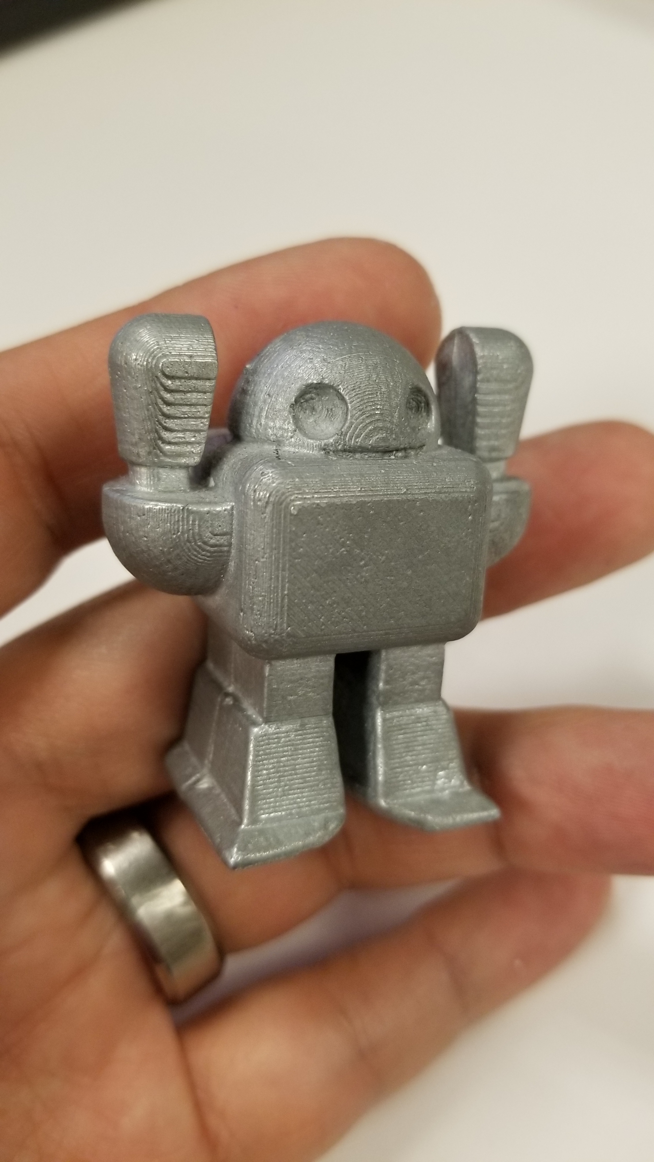

3d print a negative shape. Then from that, mold a silicone positive shape. Then cast a plaster negative shape. Then pour molten zinc. Thats how I made this guy:
Aluminum is so-so. It causes the plaster to dehydrate and makes an ugly surface. This happens even if it’s completely dry; it drives out the water that is chemically bound with the plaster.
