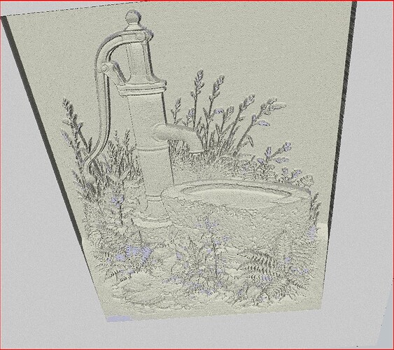

Creating depth map images using google
since Mill Mage has brought out v carve and 3d relief , ive tried a few ways to convert images using photoshop etc with mixed results., just couldnt get that fine detail right
i bit the bullet and decided to ask google AI. :frowning:
how do i ask you to convert an image into high quality depth map, it gave me a few sentences, which i than asked it with an image.
after nearly 2 hrs , i think that one was bit retarded didn’t understand plain old English
we got there, have attached final script at bottom of post for you all to try and tweak :slight_smile:

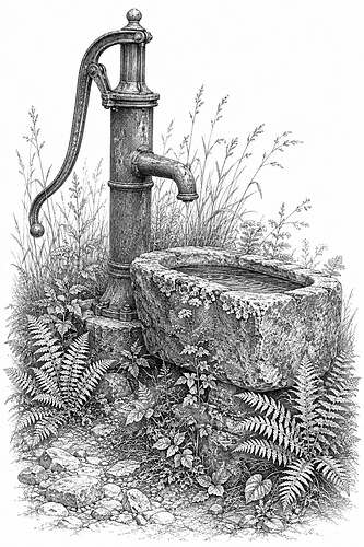

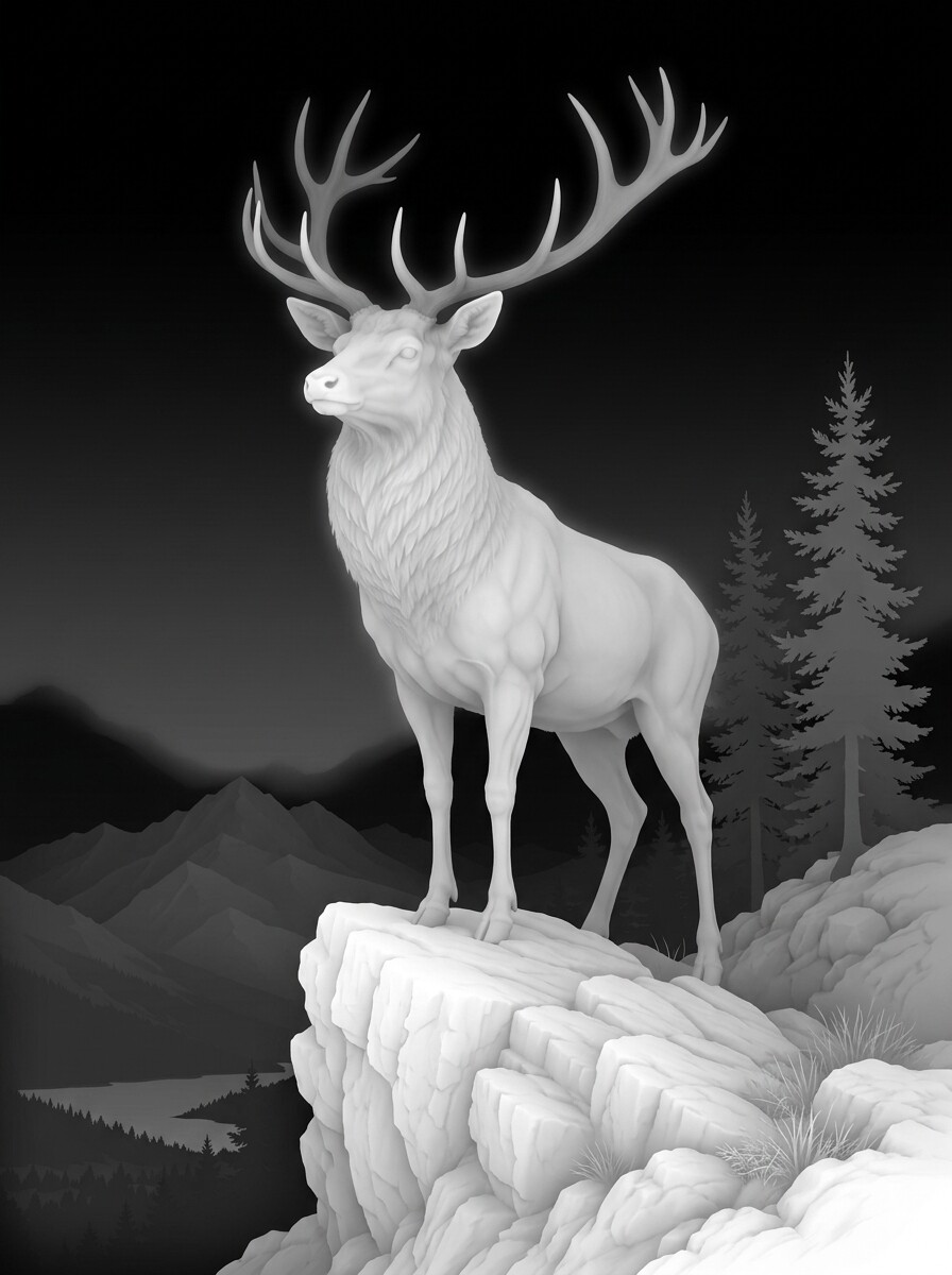

the original pic is one that i got of one of my FB pages i follow, this lady creates ai generated pics

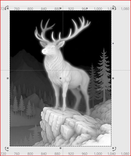

final depth map pic

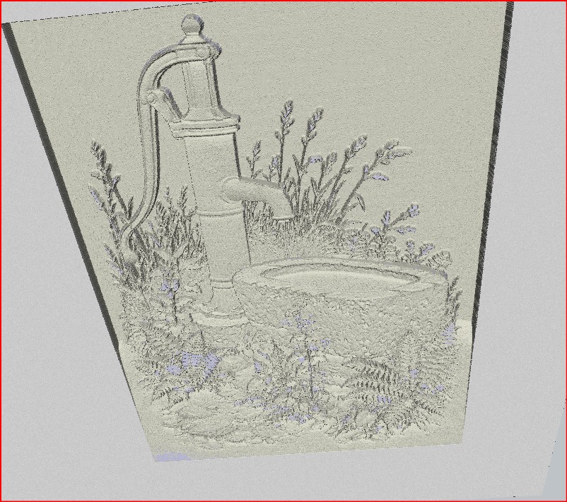

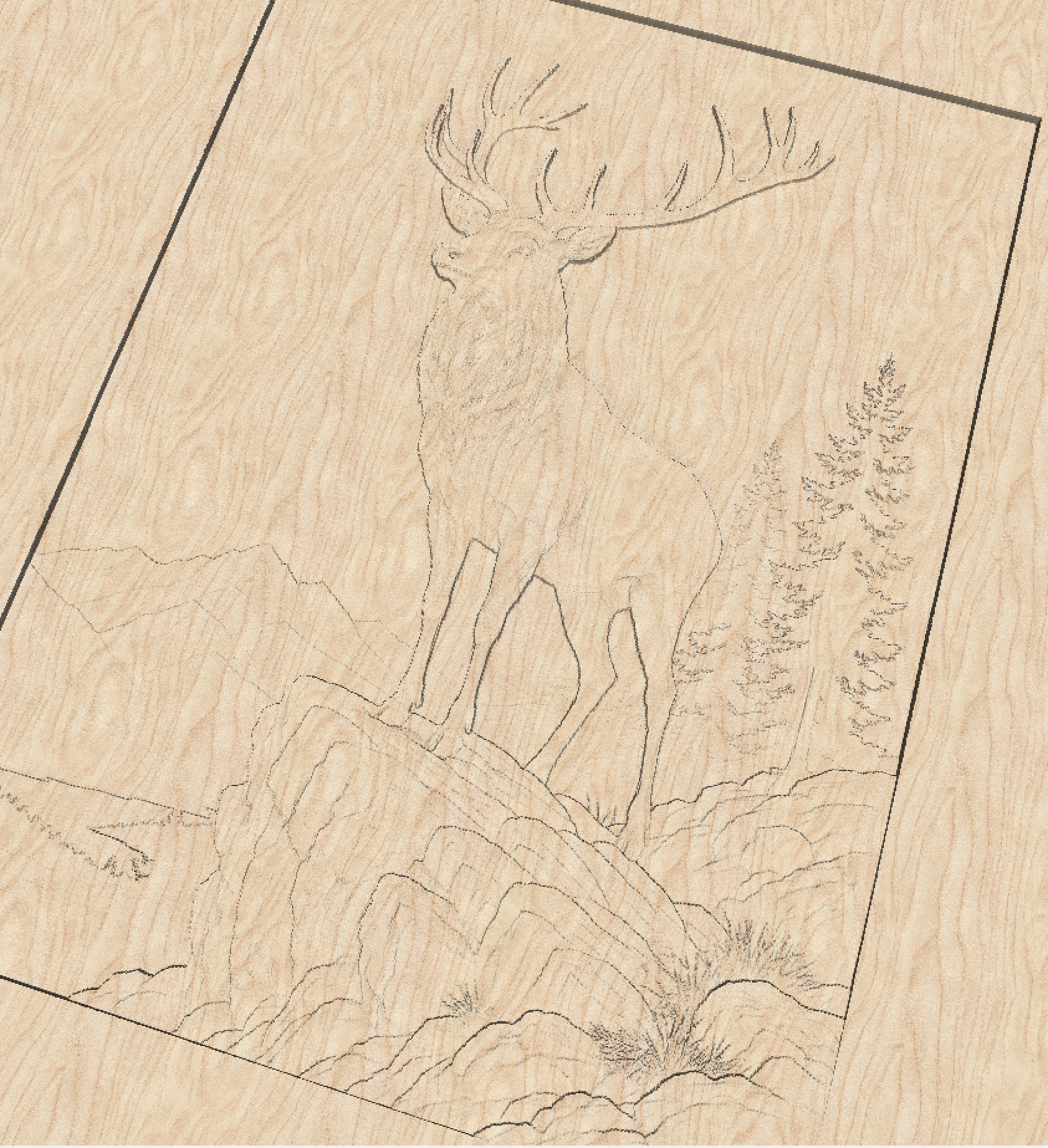

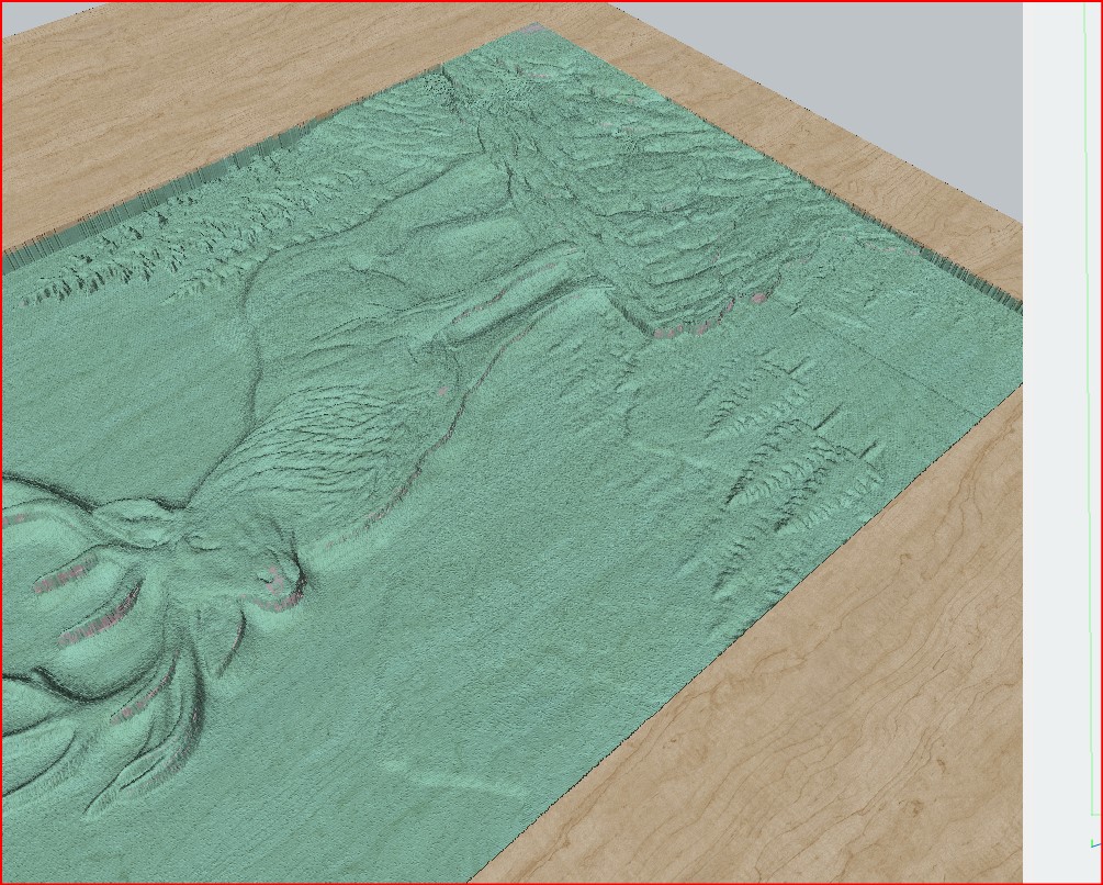

MM preivew
after got to that point i asked it to write me a script for further pics
this one was from asking the script
here is the script it wrote me , still may need some final tweaks , will see what they carve out like before confusing it more

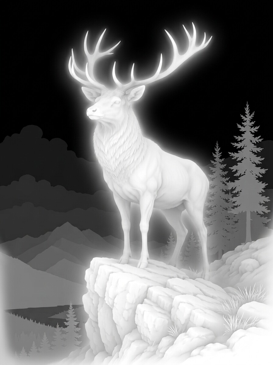

Generate a high-resolution, 8-bit grayscale depth map based on the provided image for 3D Z-axis displacement mapping.
Key Spatial Rules:
  • Tonal Gradient: Use a smooth, continuous gradient where pure white (#FFFFFF) represents the closest foreground elements and pure black (#000000) represents the furthest background or horizon.
  • Mid-ground Separation: Calibrate the contrast curve so mid-ground elements (like trees or terrain) sit at distinct grayscale values, separating them clearly from the background without flattening out.
Advanced Mesh Displacement Optimization (Dual-Zone Filtering):
  1. INTERIOR COMPONENT (High Definition): Maintain clear, crisp volumetric contours, muscular structure, and textural definitions inside the main subject (e.g., [INSERT YOUR SUBJECT HERE, e.g., “the body of the stag and the rock faces”]). Do not flatten or blur the internal features; they must retain sharp structural definition to drive localized depth displacement.
  2. OUTER SILHOUETTE (Ultra-Soft Rollover): Apply a heavy, localized feathering filter strictly to the outer perimeter outlines and narrow extremities (such as antlers, fur tips, or edges). The border transition from the subject to the background must be a broad, smooth, sweeping gradient.
The final asset must look crisp and detailed on the inside, but fade smoothly on the outer borders so that Z-axis displacement rolls over softly at the edges instead of lifting sharply or tearing the mesh.

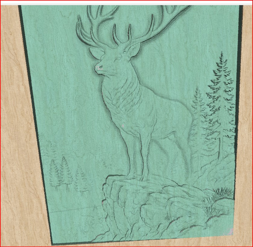

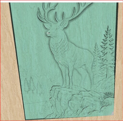

Thanks for sharing this Terry! I’ve been wondering I would generate a usable depth map. Your script works great. I downloaded your elk picture and ran the script. I then put the depth map into MillMage and did a 3D Relief carve. WOW, it only took a few minutes to complete from beginning to end.

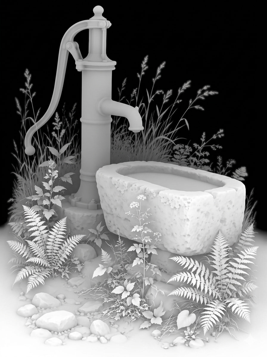

This is the script.
under the pic of the trough is the script

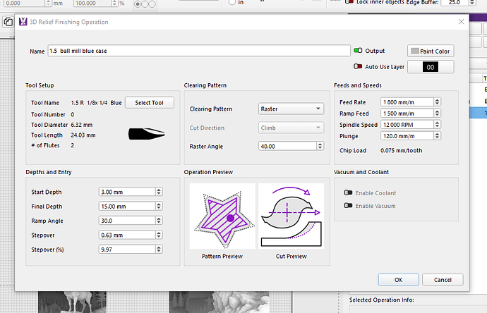

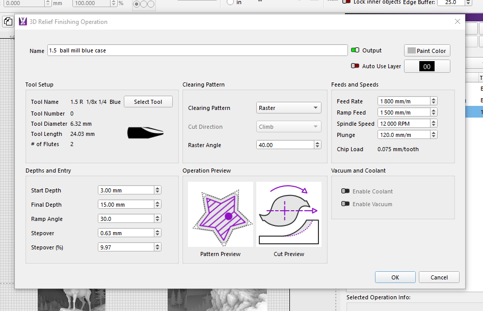

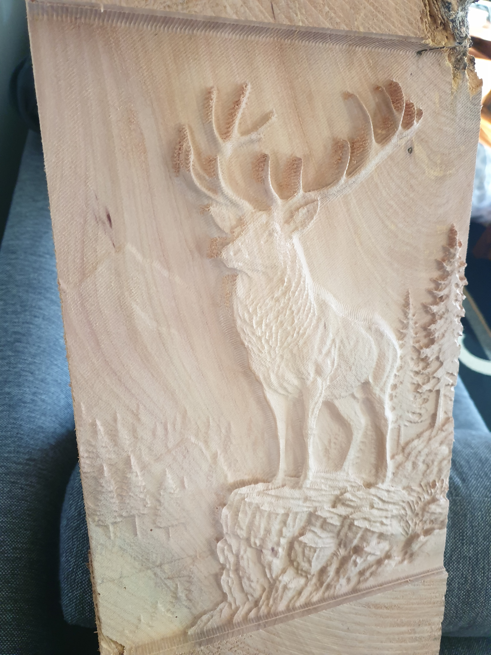

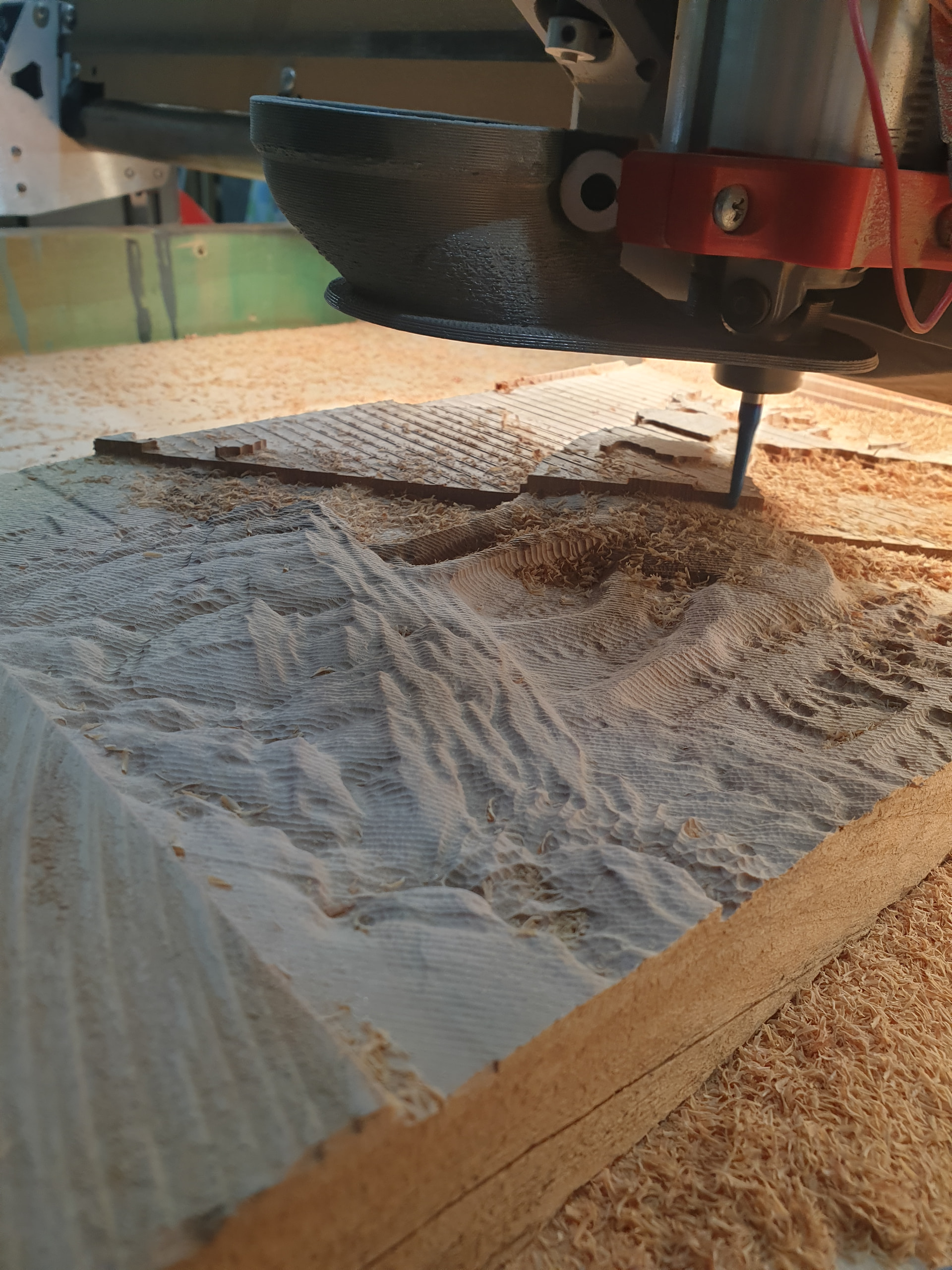

im in the process of milling it now
need to lower my step over on next one
thats a 1.5mm bull at 10% step
looking pretty cool though

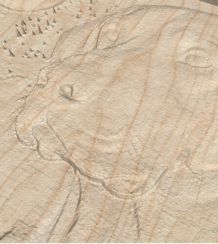

straight of the table , pretty stoked with the finish
the step over lines disappeared with some scotch pad 320

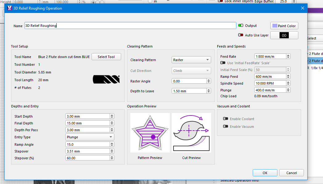

That turned out great Terry. What was your final depth?
cheers Britt 12mm
depth to leave going drop that to 1mm
i find doing raster on angle comes out nicer step over lines arnt as harsh and drops machine time a fair bit also , generally between 22 -40 deg can cut time down by least 30 min

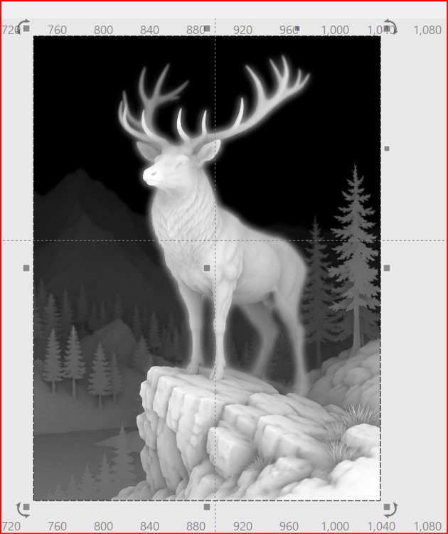

just re looking at your d map compared to mine
yours doesn’t have soft edges around antlers etc ? which is odd
at the bottom of Advanced Mesh Displacement Optimization (Dual-Zone Filtering) in script
it says to do this
picking you copied and pasted it all
ill run some more tests when get a chance and see what happens
maybe you got one of those lazy bots that only read half of the instructions, without the rolls off the antlers they would just get ripped off while milling
I redid the depth map and it looked the same. I then repasted just:
  1. OUTER SILHOUETTE (Ultra-Soft Rollover): Apply a heavy, localized feathering filter strictly to the outer perimeter outlines and narrow extremities (such as antlers, fur tips, or edges). The border transition from the subject to the background must be a broad, smooth, sweeping gradient.
and Gemini softened the edges like yours. I wonder why it isn’t following the entire script the first time.

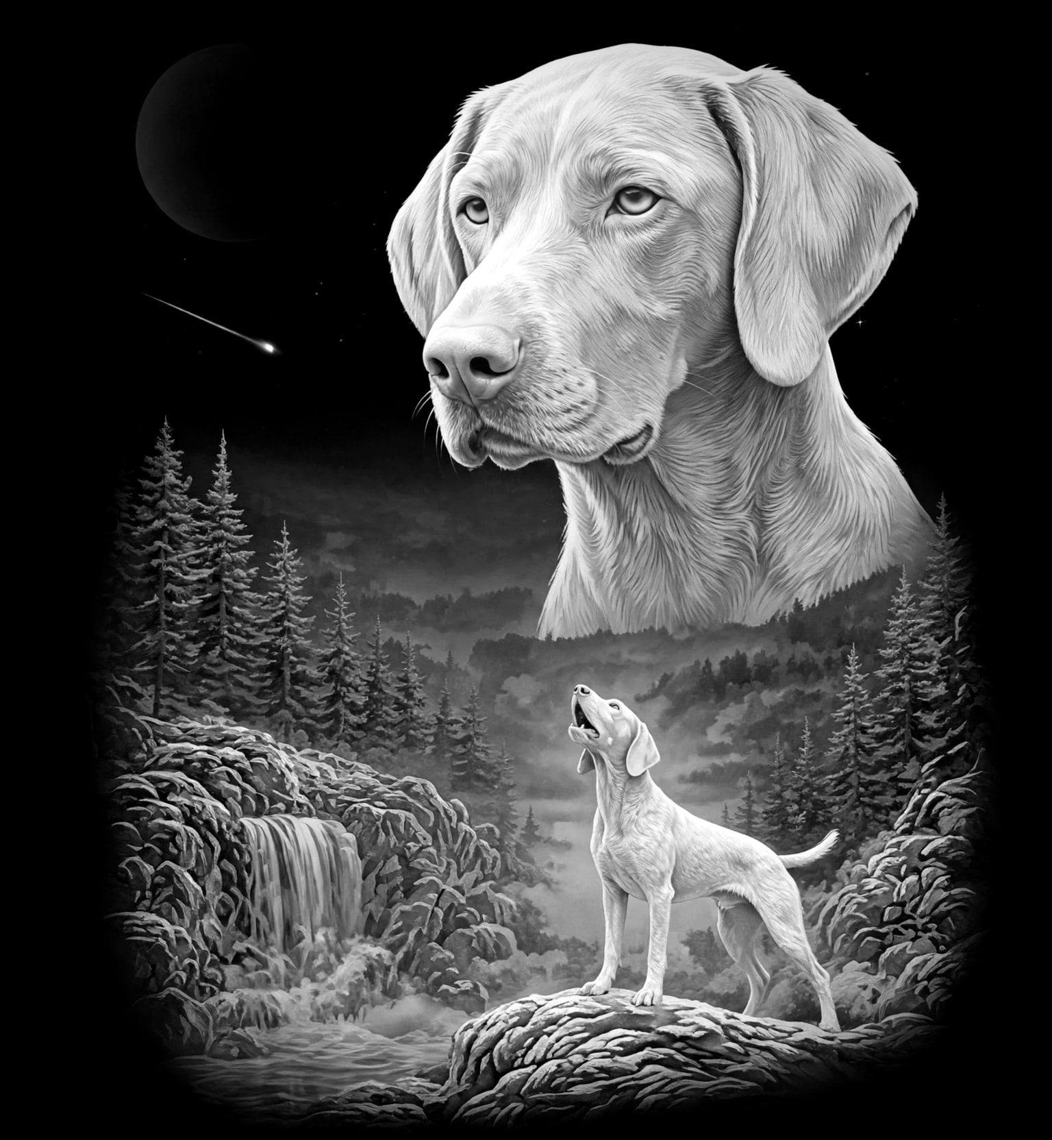

after reading a topic on grey scale, the consensuses is meta ai is way better when it come to image edits ,
so I gave it a go , and yes it is 100 times better the fine detail is crazy

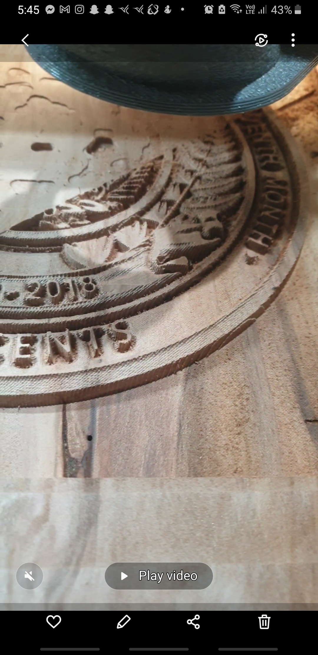

i took a screen shot of a very low image of a coin , usig the above script asked it to generate depth map to be exact to image , about 10 min and a few tweaks and this is it
that photos a photo of a photo of a photo of the depth map in millmage, i set that up on table so anyone watching my live can see what im making
final diameter of coin will be 225mm, that’s after 3 hrs , 7 hrs to go , 0.5mm bullnose, step overs still to big on softer wood think that’s 8%, but on med dentistry like Totara its mint

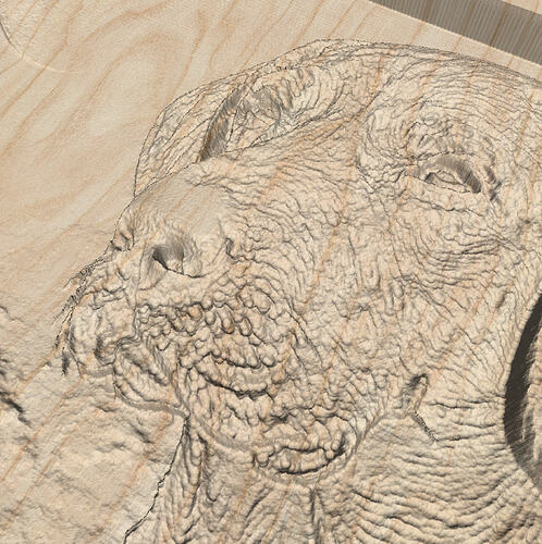

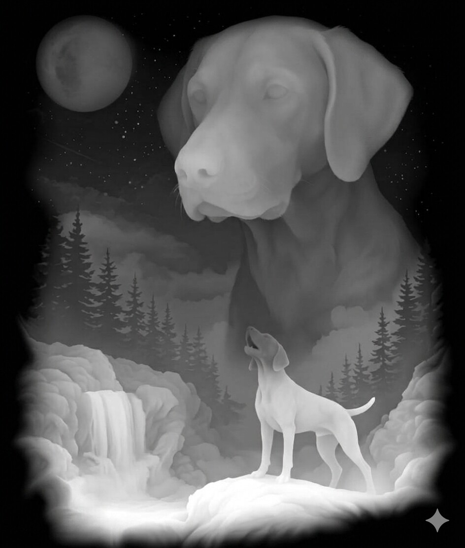

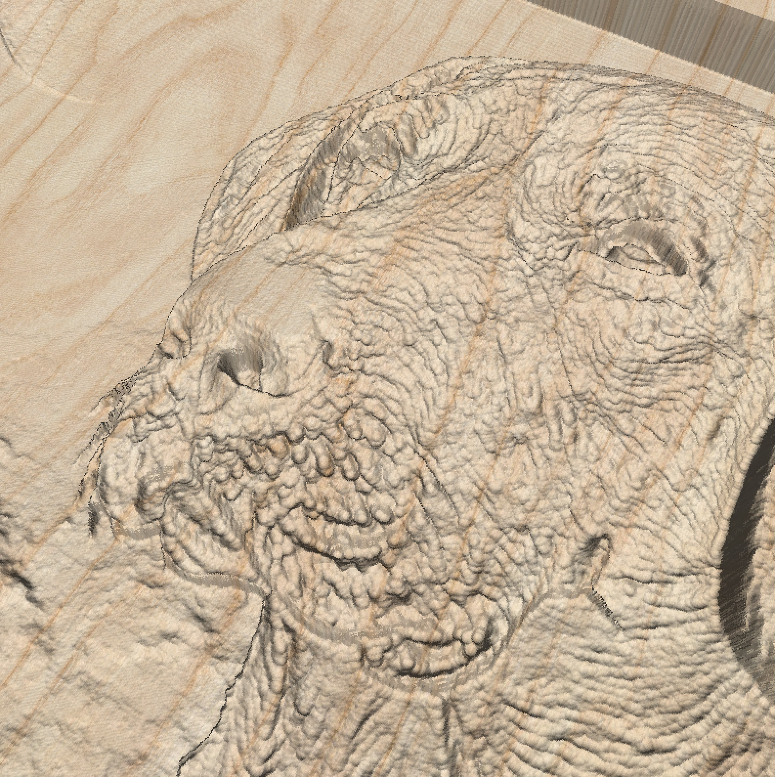

Did you try running the Bull Elk through Meta AI? I just did my GSP image. I feel like it has too much detail. The preview in MillMage has a lot of indentations.

Gemini image:
Meta image:
Did you change anything in your prompt for Meta?

that is its only down fall is it is so detailed , going to need re write some of the script
not to start with , did ask it to remove some of the finner detail and smooth it out after
to elemate what you see in dogs face in the preview . which helped
