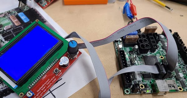

Crashing to Blank LCD Screen on Archim Board
I tried both the power supply you provided in the kit, and my bench top. Same results. I was using the green adapter that came with the kit, but after you posted I tried it without (benchtop supply connected to board) and it crashed within an hour.
Hey @vicious1 checking to see if you have any other ideas? In the meantime I’m keeping it turned on with Repetier on and the LCD disconnected to see if I can get it to crash and 2 days later it’s still stable. So somehow connecting an LCD controller changes that (and again I bought a new LCD to be safe, and it still caused same issues).

This is the blue lcd, not the touch screen right? Marlin sends data to draw, pixel by pixel. The knob sends step signals as it is turning and closes a pin when clicked. Marlin is doing the rest. The pixels sent to the screen are “fire and forget”. Marlin has no idea if they get there or not. The reset pin on the screen also just closes a pin to ground. The sd card is talking back and forth. Marlin sends commands to get data and then reads it back.
The pixels are one way. There isn’t anything the knob can really do to cause it to freeze (I think). The reset would reset it, not freeze it. The sd card… Maybe.
It does use power from the board. Anything can be explained by poor power. But that feels like a long shot.
@vicious1 this is getting weird. First day, it stayed on fine for the rest of the day (I don’t trust it to leave it on when I sleep). Today, it stayed on most of the day, but then finally crashed this afternoon. Since then it’s only stayed on for several minutes at a time (tried it 3 times). So it seems that sometimes it will boot and be happy for hours and hours, and then sometimes it’s just not happy. At all.
Which pushes me back to wondering if there’s something wrong with the board itself because I’m having trouble rationalizing why the firmware would be capable of running for hours sometimes and then crashing in minutes other times with no commands beyond turning on.

Note: the blue tape is strictly to avoid shorting out the alligator clips from the bench PSU, ground is attached with the same type of alligator that power is.
Notice that I don’t even have steppers or end stops plugged in at the moment (to minimize the variables).
And yes this is with the new version of 425 you attached
Crashed again, this time after ~2 hours.

Welllllll, it took a dump for me as well. Good news, probably just a firmware issue. Bad news that is some high level stuff I do not understand causing it. I can look into the previous fix and see if it helps, that and mess with the most current firmware and pass it along to ultimachine to see if we can get some help on this.
Making progress, after a few hours.
P.io works fine for compiling, won;t upload the new versions.
Run the bossac commands in the p.io file instead of the hal scrips thinkyhead moved them to, seems to work. Flashing the newest version right this second.
