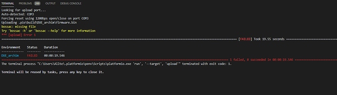

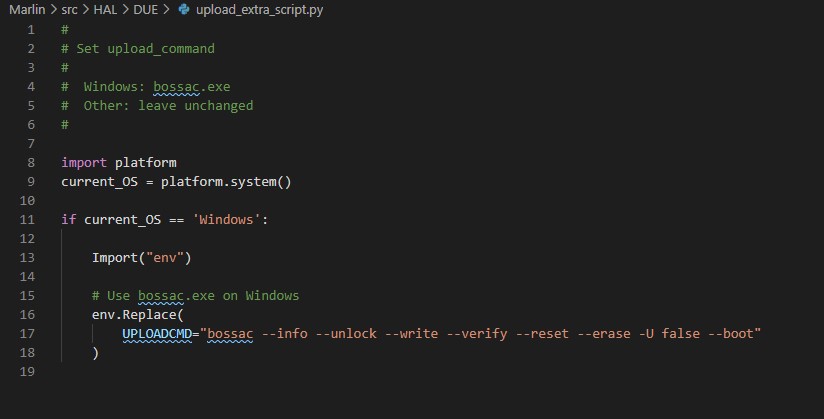

I think it is because the command in other OSs isn’t bossac. But I don’t know more than you’ve told me.
The file is setting the variable. Did the variable name change? Is it still setting it before it gets used? I haven’t looked at any of the pio builder stuff.
Oh…so he can use the “if windows” statement. Okay I get that, means I have some more digging to do.

So there are two issues, the bossa thing not working and the steppers not working. I have workarounds for both but need to figure out how to understand them to be able to submit a PR and not a work around.
This PR is huge because they have copied a whole config and then changed one line (and renamed some stuff).
We could add some code to MarlinBuilder to edit that line only in the archim builds. I would really rather get this upstream instead. You could also edit that one line and check it in on your 425 branch.
Can you share the exact issue when you run the bossa thing without your workaround? What happens in macos and linux, I wonder?

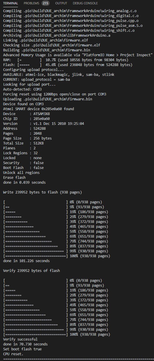

Good archim flash, the errors are a spell checker I need to remove.
Bad, several variants.

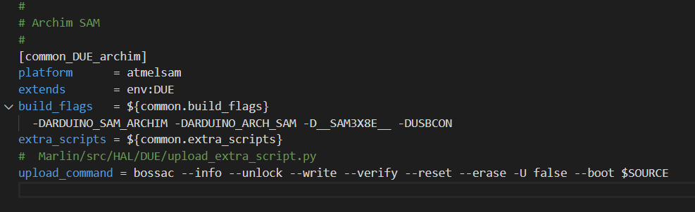

The location seems correct,
extra_scripts = ${common.extra_scripts}
  Marlin/src/HAL/DUE/upload_extra_script.py
It sees it I made a change and got errors so the location is correct.
That is bossac complaining. The format in the ini file has $SOURCE at the end of it.
I don’t think it is having trouble finding the extra script. I think it is having trouble sending the right arguments to bossac.
I swear I tried adding that earlier, trying again just to double check.
https://docs.platformio.org/en/latest/projectconf/advanced_scripting.html#custom-upload-tool
are you f’ing kidding me…that was it.
