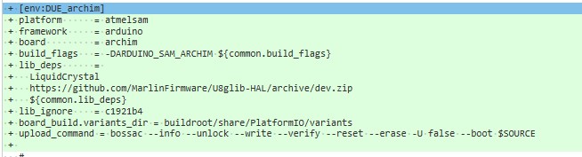

I don’t have the platformio.ini correct. Poop
Current, not working, new version
Archim SAM
[common_DUE_archim]
platform = atmelsam
extends = env:DUE
build_flags = ${common.build_flags}
-DARDUINO_SAM_ARCHIM -DARDUINO_ARCH_SAM -D__SAM3X8E__ -DUSBCON
board_build.variants_dir = buildroot/share/PlatformIO/variants/archim
extra_scripts = ${common.extra_scripts}
Marlin/src/HAL/DUE/upload_extra_script.py
[env:DUE_archim]
platform = ${common_DUE_archim.platform}
extends = common_DUE_archim
What he had,
ini
I tried without the archim directory as well
What if you used board = archim?
The board_build.variants_dir also seems like a smart thing to add.
