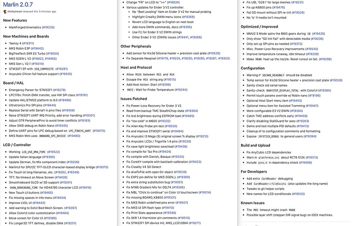

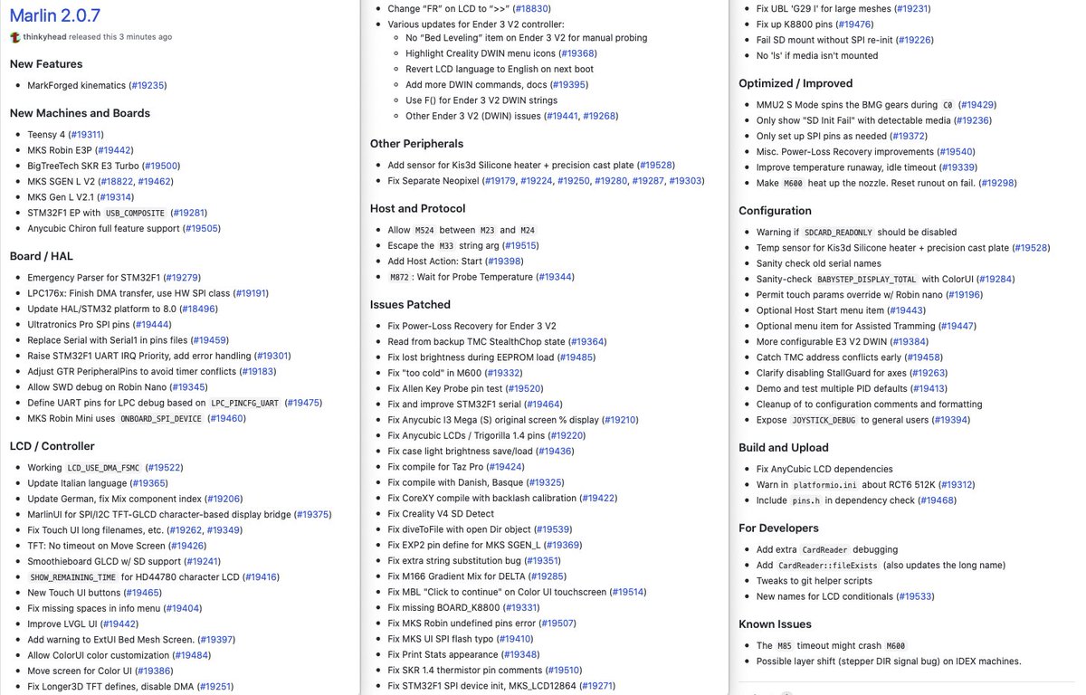

Even more marlin stuff tomorrow (not related to this):
Wow thanks @vicious1 Excited to try it out.
