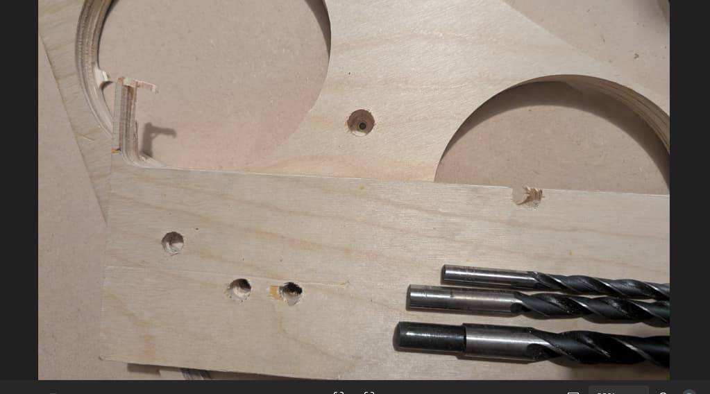

I am cutting some very precisely located holes in two separate sheets of plywood that need to line up perfectly with each other. A great application for a CNC machine.
I started with a set of 1/8" pilot holes, using a 1/8" drill bit in my Sienci Labs 1/8" Makita collet, and it all went perfectly.
Next I enlarged the holes to the desired final size using a 1/4" drill bit in the 1/4" collet that came with my Vevor 0700C router. This is where things went horribly awry…

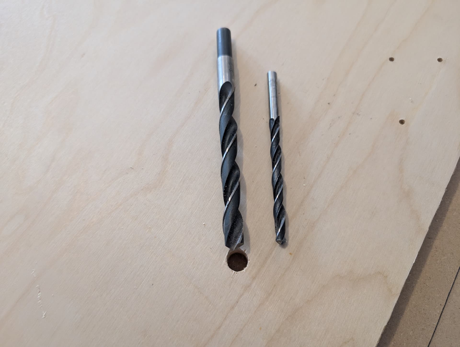

The 1/4" bit ended up cutting a hole that was 27/64" (just a shade under 7/16").
1/4" bit on right, 27/64 bit and hole on left
I double checked the g-code and all looked right, so I started checking and found that instead of rotating axially along the centerline, the bit was actually rotating in a circle around the axis.

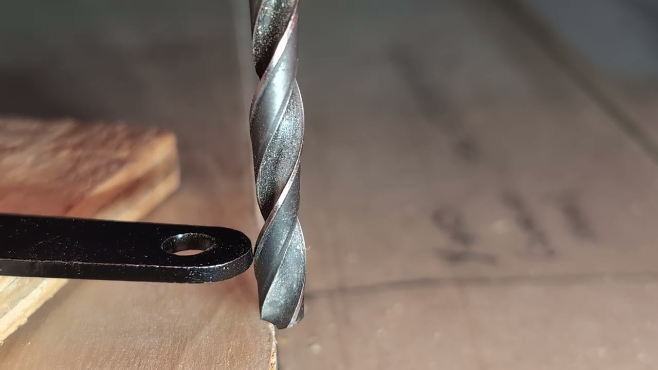

Do you have a dial indicator or anything like that? That’s the standard way to check for runout. You’d chuck something straight and precise like drill rod and check the drill rod at both the edge of the collet and as far away as possible. You’d be looking for both to show minimal variation as it turns, ideally. It’s also worth checking the inside face of the cone that the collet fits into with the collet removed.
If the cone face varies then there’s a bearing or bent spindle issue. If both the close and far measurement of the rod vary then the collet is machined with the bore off-center. If one is good and one is bad, then the bore is machined out of true or there’s something stuck in it.
If you don’t have a dial indicator then you might be able to take a bit of dowel or something and rubber band it so that it’s sitting against the rod and pivoting close to the rod. That way it’ll amplify any movement and you can see it against a ruler or something.

I put it into my drill press, and it is pretty straight and true there (maybe .001-.002" runout at the bottom of the bit)
There is zero variation when measuring against the cone face and rotating the shaft. This is good, as it means that the router shaft is not bent, and I don’t have to replace the router itself.
This isn’t the case, as far as I can tell. There is very slight variation (a few thousandths of an inch) at a point about 8mm below the nut face, and almost 2mm at the bottom of the bit 3 inches lower
As mentioned above, the variation increases greatly the further from the collet. There doesn’t seem to be anything stuck or obstructing the collet or the bit, so it seems that the collet is machined out of true (not parallel to the centerline axis).

I drilled a test hole with the 1/4” drill bit installed, and the hole ended up at around 21/64”. While that was a big improvement over the 29/64” with the original collet, it still isn’t precise enough for my application. I think that trying to use a palm router with a fairly flexible and fairly long drill bit is just allowing too much deflection.
So I drilled all of my holes using a short 1/8:” bit to make pilot holes, and then I bought a drill block to help me to with making perpendicular cuts with the larger bits using a handheld drill.
