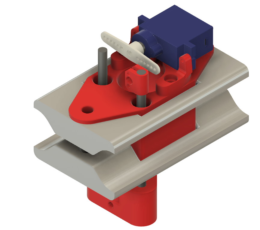

So this is the drag knife axis.
I had some 4MM rod left from the needle cutter project, and decided to try using it with some LM4UU linear bearings for Z axis motion. The servo holder is held onto the top with 3 M3x10 screws, and I could swap this for a stepper motor if it doesn’t work out easily enough. (I could probably even leave the drive similar, I suppose.)
downside is that I don’t actually have the LM4UU bearings, so I had to buy them, but I already had the 9g servo 4mm rods, and all the screws.
The plan is to use 1mm pushrod wire from the servo to the rod, which will serve as servo saver/spring for the drag knife to ride on the vinyl. I think it will work OK. The rod end is clamped down with an M3 screw. It should work just screwed into the plastic, but it’s so small it will be a cinch to use a nut. (It will also be a cinch to crush the plastic part, so … )
The process of designing this was made more complicated by the fact that I designed all of the original parts in FreeCAD, and this was done in Fusion360. I imported the sled STL model into Fusion360, and of course it came in a billion little triangles. There is a page or so of removing facets in the project history before anything else happens, and of course the curved portions are still faceted like crazy. I almost went back to FreeCAD for it, but stubbornness won out. (If I have to do it again though…)

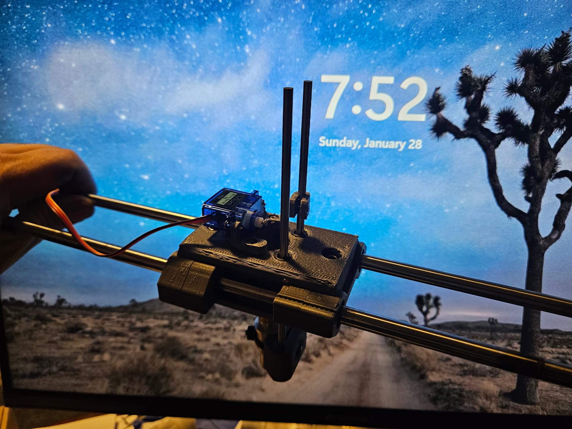

And here we go. A real world part.
My 400mm rods are beyond redemption, but the 450mm Y rods survived. Well sort of. I had to scrape some burned plastic and belt rubber off of one of them, but it seems none the worse for wear. Two of the LM8UU bearings seem OK, but I think re-using them would be pushing my luck.
I forgot how tight those LM8UU bearing fit into the sliders. It’s a super tight fit, needed to use more force than I probably should to get them in. I may have to re-do them if the rods don’t slide smoothly. I think I boiled or at least heated them last time to soften them a bit. I just put the rails through the X bearings for the carriage assembly.
It occurs to me that I could probably just drop a pushrod down that center hole to the drag knife, but I still need some sort of servo saver to give it a bit of springiness.
The background makes it look extra epic!
:rofl: :joy: :rofl: Windows logon screen. Looks better than my workbench.
