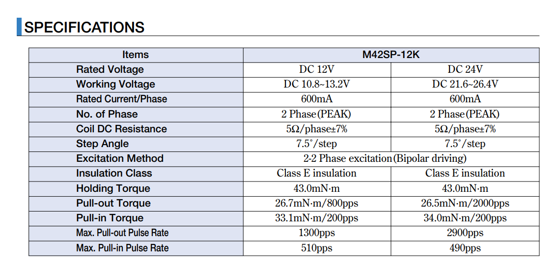

SHOOOT. I was trying to remove the metal spur gear from the stepper - and I RUINED it. It was quite fitting for this application. Now I only have bigger (uncommon) printer stepper motors, that are even bigger and only runs on 24V.
Edit: I guess I can try my luck with the 28BYJ-48, 5V, again. I didn’t figure out how to run it on the MKS DLC32, with TMC2209 drivers and fluidNC. Well well - the rabbit hole goes on and on!
Edit 2: I did try to convert to unipolar 28BYJ-48 to bipolar, to use it directly with the control board. But now it only hums when running it, with no movement.
Edit 3: OOOH - this one is nice!! https://www.aliexpress.com/item/1005005101736266.html I wonder if it has enough torque. But I sort of defeats the whole idea of building the plotter as a re-purposing of old parts.

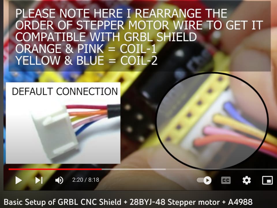

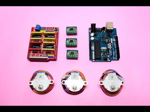

For completeness sake, I happened to run across this video… if you’re still interested in playing with the 28BYJ-48 steppers. He’s modified them for bipolar operation, of course, and determined the coil pairs… orange/pink and yellow/blue. He also had to rearrange the wires to directly plug into the shield.
It also appears he sets up the A4988 drivers with no jumpers so he’s using single-stepping IIRC. Later, and after he demonstrates movement, he shows that he’s using 250 steps/mm… which he later changes to 500 steps/mm for some reason. He never mentions his Vref settings that I could see… but it will be quite low, maybe 0.1V?
Could be fun if you like to tinker… and I did play with them enough to convince myself that they do work and, in some use cases, could be useful.
