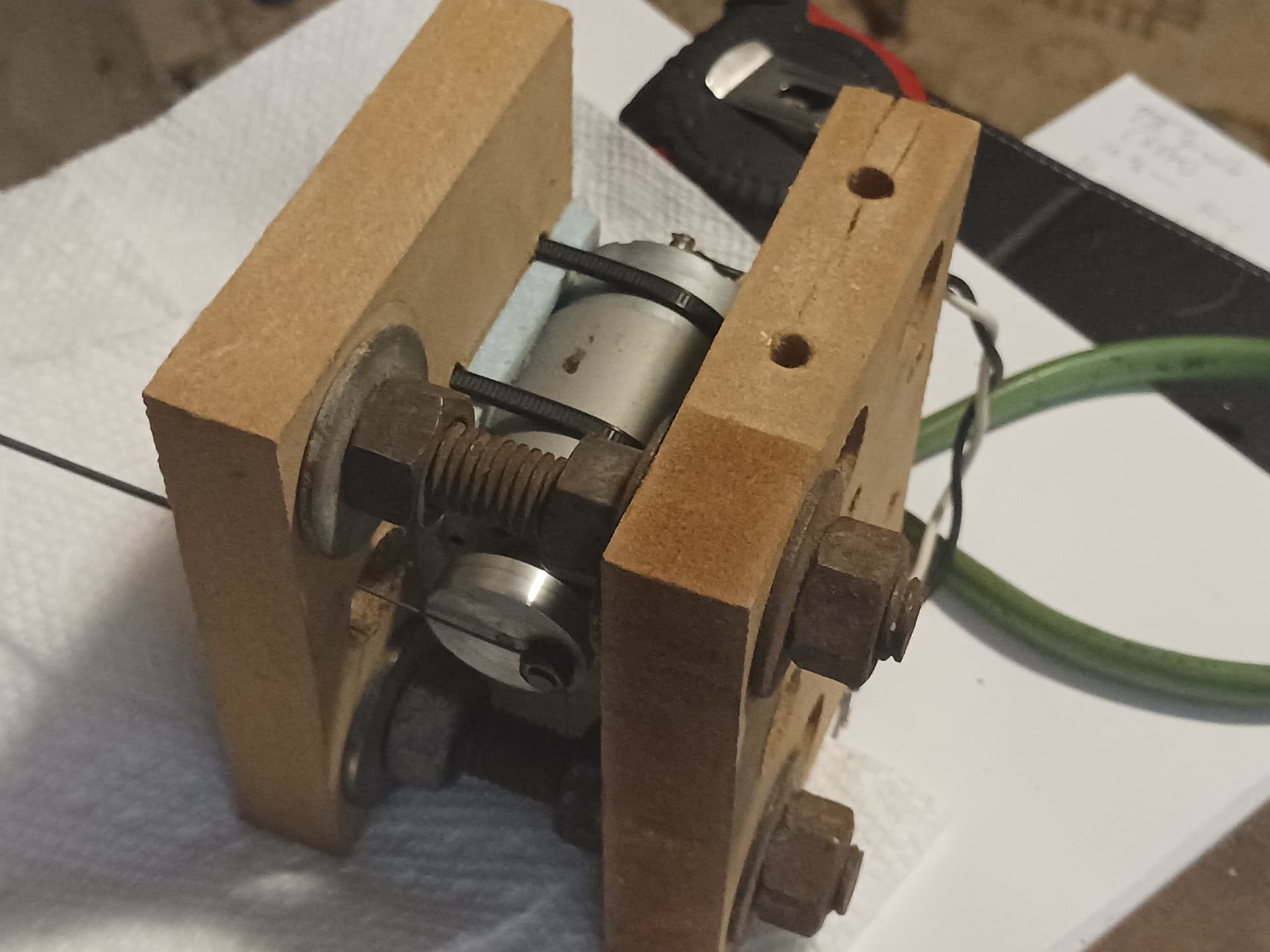

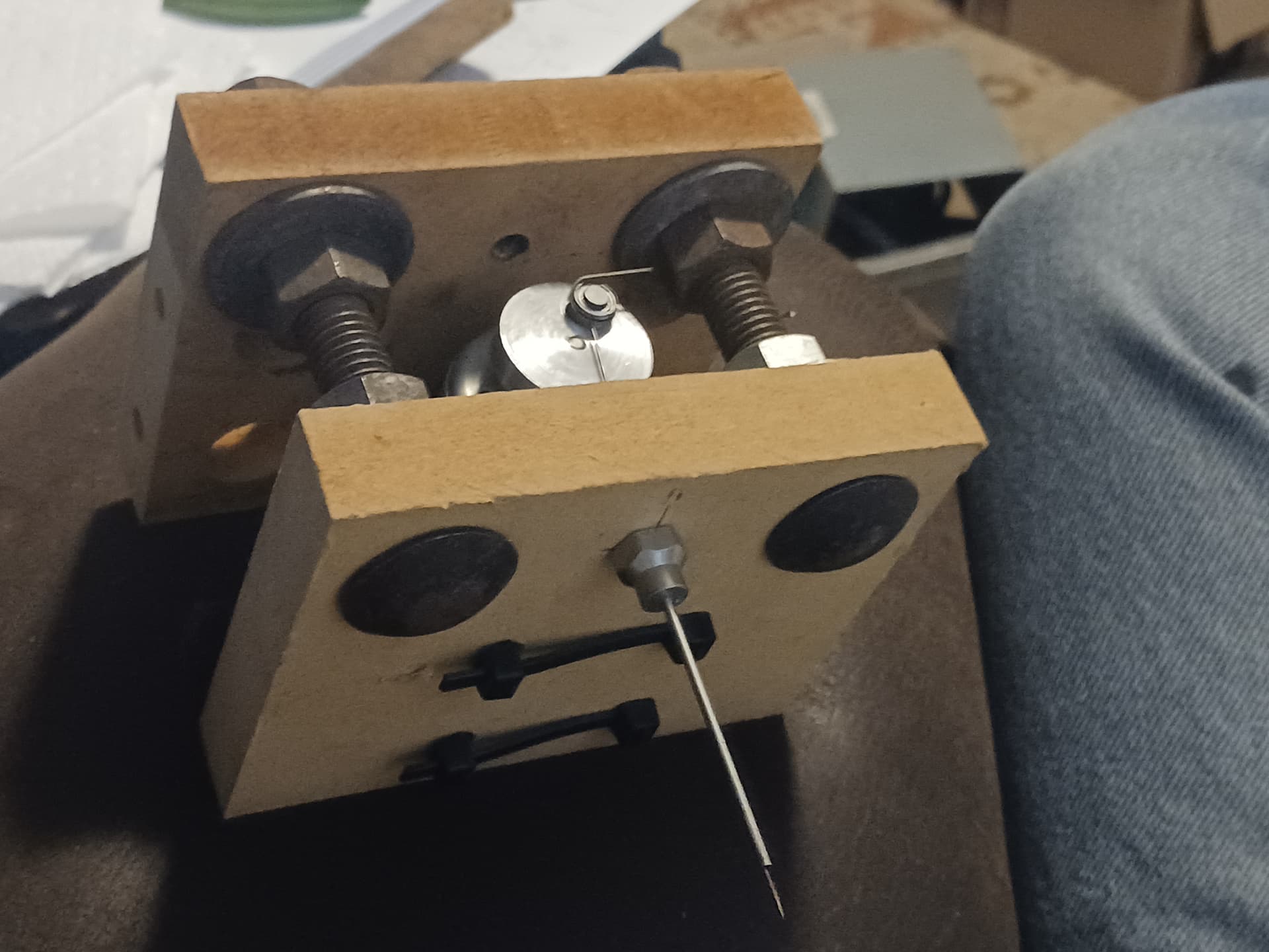

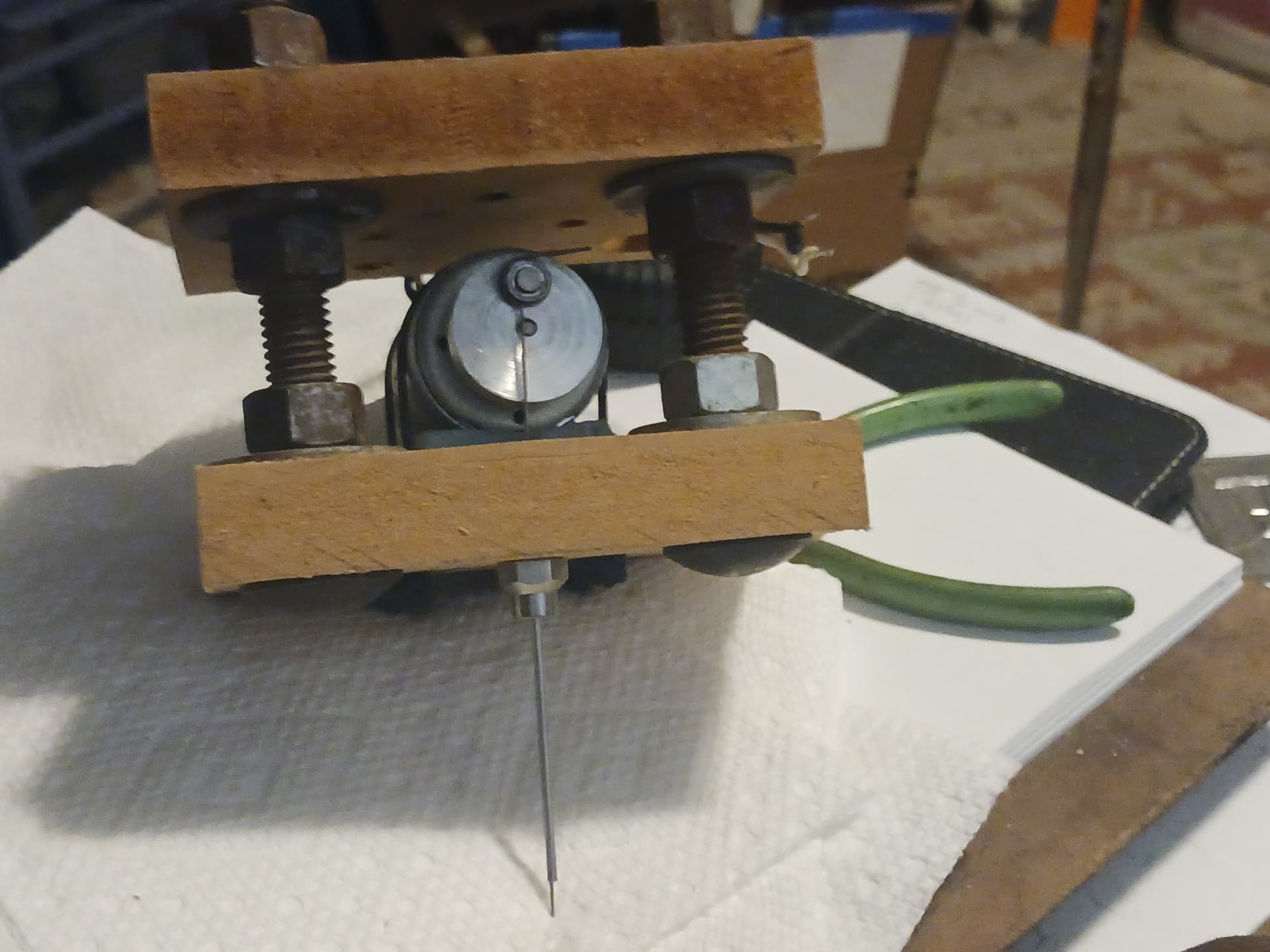

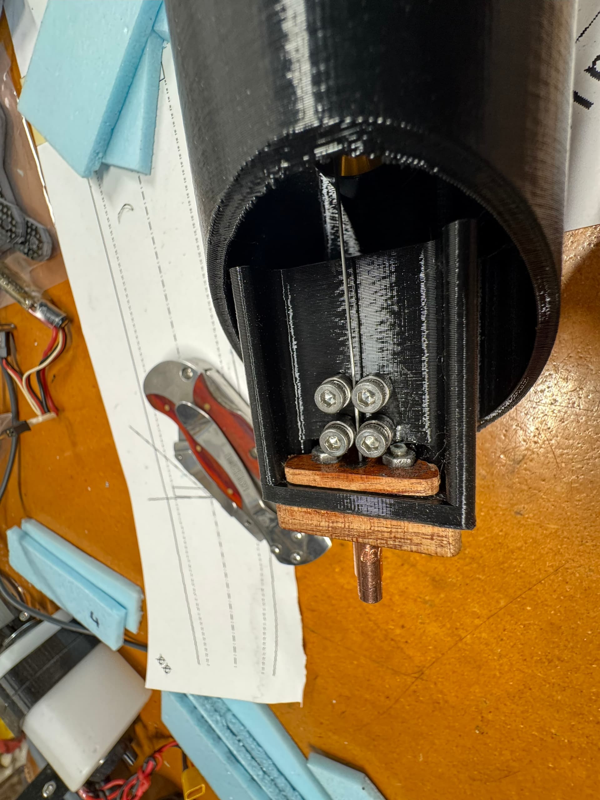

No problem, here are some photos of my current setup. I did grind the barb off the tip after cutting to length. I did this with a dremel sanding drum, rotating it so it sands from outside to in, to prevent any burrs. This worked well on that clothes pin setup so figured it was a good way to go still.
If you look on the sides of the first photo, you can see some really rough cut parts to the bottom left (top left are hand cuts), and smooth cut parts on the right. Those rough cuts are from a previous design, but my current design is still doing this. It’s just not as bad, and only happening in one direction.
I could try using a wetstone to get the tip even cleaner. I imagined though, the roughness of the face of the needle wasn’t so important. I figured as long as the tip is pretty square and burr free it should punch through clean. I haven’t tried sharpening to a point, assuming that could result in weird behavior, but I’m new to this.
Your needle cutter looks good and should perform well.
I’ve always preferred a symmetric conical point on the needle… like a sharpened wooden pencil. It should generate little or no debris and leave consistently clean cuts. A blunt point “punches” its way through the foam and blows out material on the backside, creating more debris and a less-clean cut.
Think “rapier” vs. “bullet”. A rapier blade pierces soft material like a needle and leaves a clean wound without actually removing any material. A bullet OTOH mangles and displaces material all the way through, creating both a nasty wound channel and exit wound.

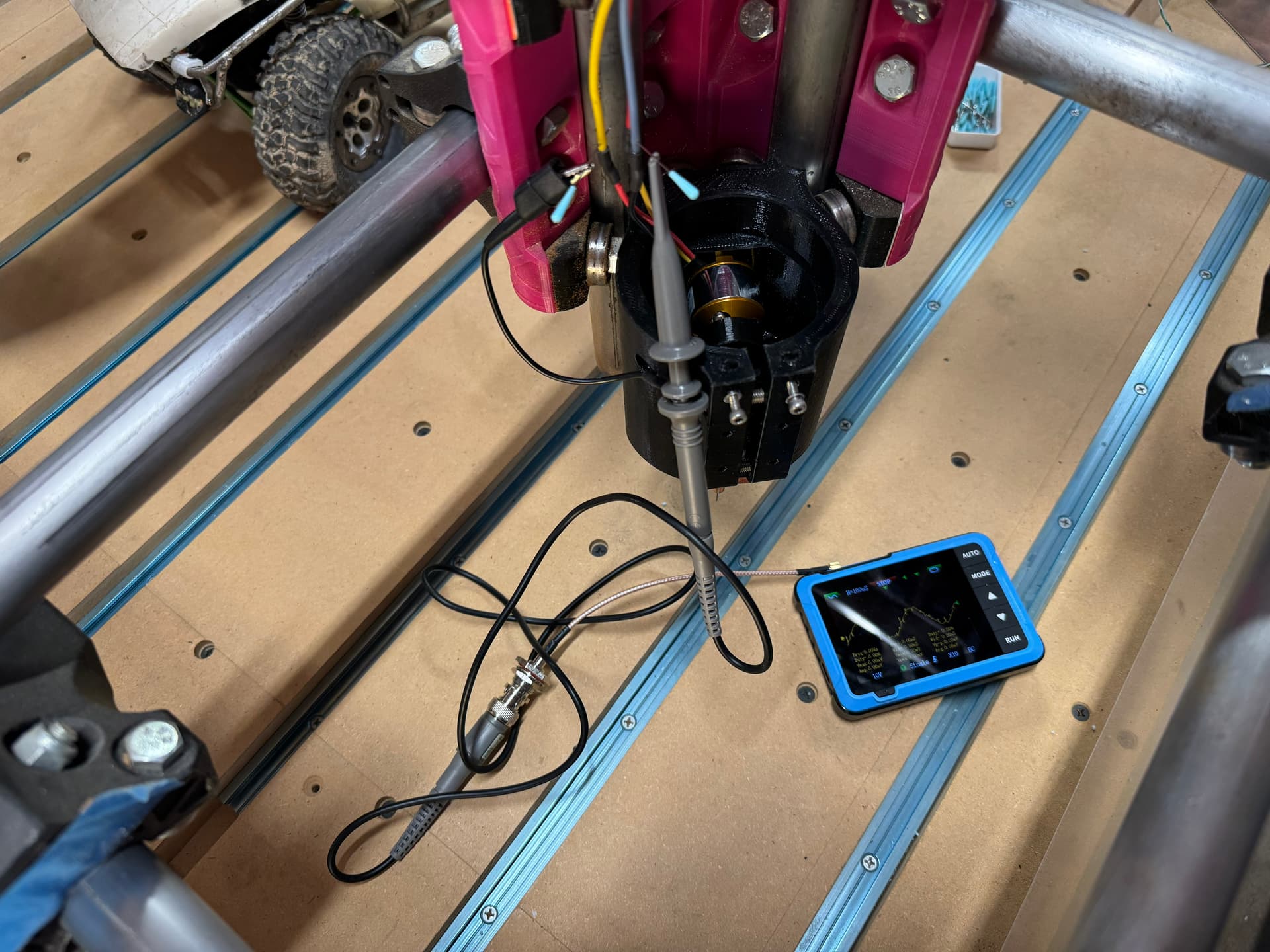

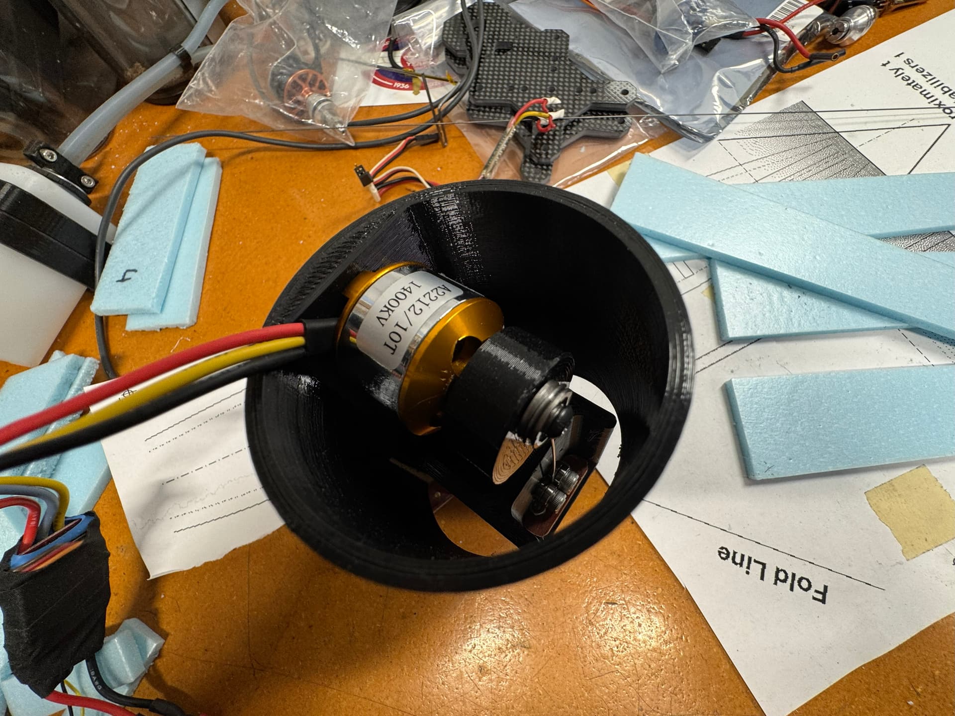

I like the bullet analogy… makes a lot of sense to me. I sharpened and polished my needle and it defnitely made cuts cleaner in all directions. While I was at it I decided to actually set RPM using an oscope. Looks like my RPM was a little low around 6000 and I was using a feedrate of 10mm/sec. That fits the 10:1 rpm to feedrate some folks mention, but I wanted to try 8000RPM since that a lot of you more experienced needlers seem to like. After sharpening the tip and correcting the RPM, test cuts looked absolutely beautiful. It looks like I finally have the silver bullet for cutting foam kits!

I did try using my old school GloBee brand photocell tach, but there wasn’t enough light/contrast for it to work. This is how I did no load rpm with my smaller scope for convenience… my bigger scope would have been more precise but I think it’s accurate enough (~550uSec period w/ 14 poles):
For reference, my 1400kV at 12V needed 85% of WOT.

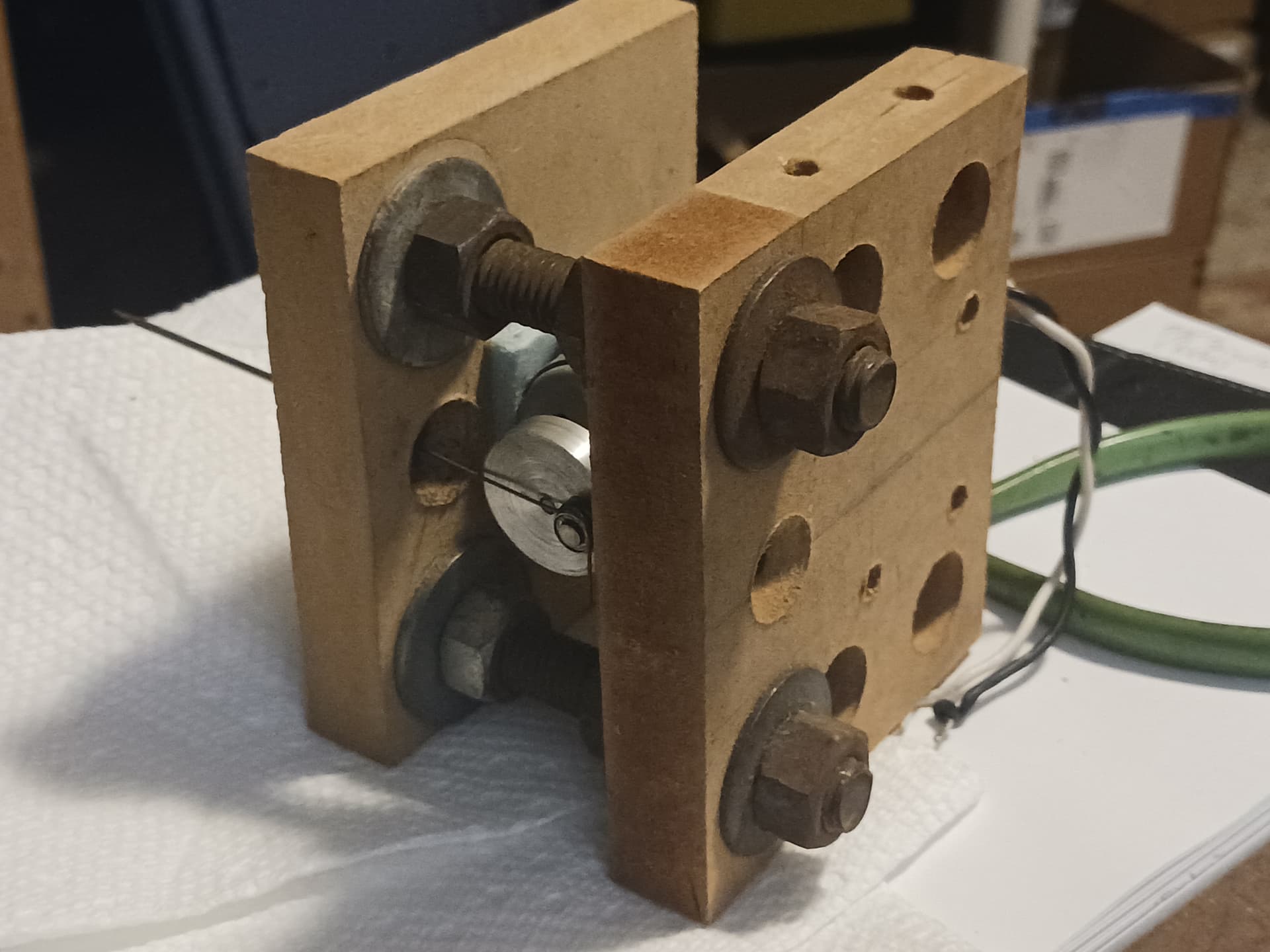

I did make a needle cutter, but mine isn’t very good…

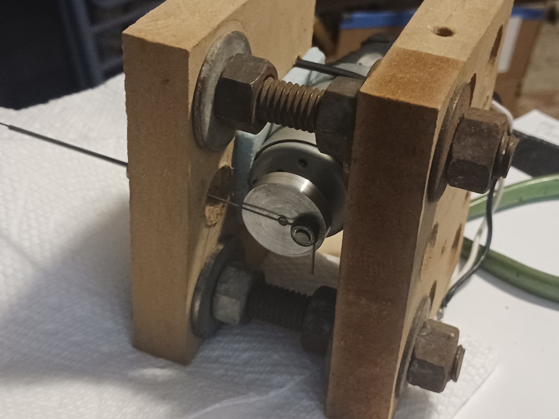

Instead of a brushless motor/ESC i used a simple DC motor with a PWM modulator. This itself actually seemed OK. A bit less power, but a simple circuit and decent control. The problem was a plastic gear as flywheel/crankshaft. The DC motor had a 2mm shaft. Perhaps with a larger shaft I would have had better luck with a crank to drive the needle.
I used a brass tube soldered onto a brass plate as a needle guide. With caveats, this could also be okay, perhaps with some lubrication mechanism. The brass plate was meant as heatsink, as well as a means to hold the tube to printed plastic, but the oscillation of the needle still wore the 0.35mm ID tube.
All this ended up with an inconsistent stroke over time and not good enough control over the point position.
I will.probably make a new needle cutter at some point, with lessons learned.

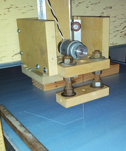

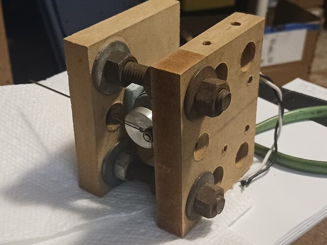

My early needle cutters used DC motors scavenged from HP printers. I think they were 24V motors but running at 12V resulted in a nice speed for a needle cutter. I don’t remember how/when I fabbed the aluminum flywheel back then but I cut “miles” of bluecore fanfold insulation foam with this cutter.
Still have it in fact. Slightly different layout but same motor and flywheel. No plastic, no heatsink needed. It looks as though that’s a needle from a livestock syringe my grandfather would have used on his cattle… but I often used sports ball inflation needles as well.

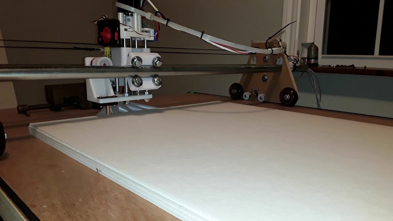

@dkj4linux or anyone else who has used a vacuum hold down… I’m getting ready to make a vacuum hold down for my needle cutter, and was curious what kind of hole pattern you went with, and how did you construct it?
I already have a nice laser vacuum table I wanted to make use of, but of course the alum grid will be ruined with the needle. I planned on making a foam spoil board to tape on top of it, with some pattern of holes to provide vacuum area on the work piece. I initially thought of just cutting a ton of holes, but then thought maybe just some lines in one direction might give more exposed area (therefore more vac force). Not sure if that would be durable though. Thoughts?
