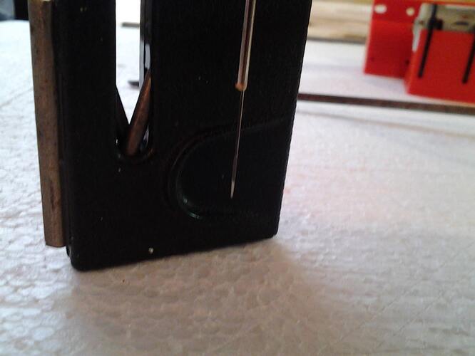

where is the needle breaking? Typically it will break at a fatigue point brought on by heat. If the stroke is too long and you are jamming the needle into the wood below the foam and it is bending in a buckle type of situation that could be causing it to snap after repeated motion. Or perhaps it is bending from “stitching” too slow and is actually bending as the core moves and it is stuck in the foam for a fraction of a second and bends. Hard to say, but where it breaks might be a clue. Does it break in the same location each time?
Sometimes it breaks right above the area that stays engaged with the guide bearings, but most often it was happening right at the crankshaft. I oiled it too… and there was heat discoloration on the crank to go with that. I ended up making a shorter crank with around 9mm stroke, and that cut a whole kit in one go without issues (kit consumed 24x24” of blue foam). I also put more care in to how I bent the crank end of the needle; no more slightly kinked wire in the load zone… I wrapped the pliers kink around until it was out of the way. Not sure if it’s the crank that helped the most or the good loop of wire, but fingers crossed I get at least a few more kits before I have to bend/cut another needle for it.

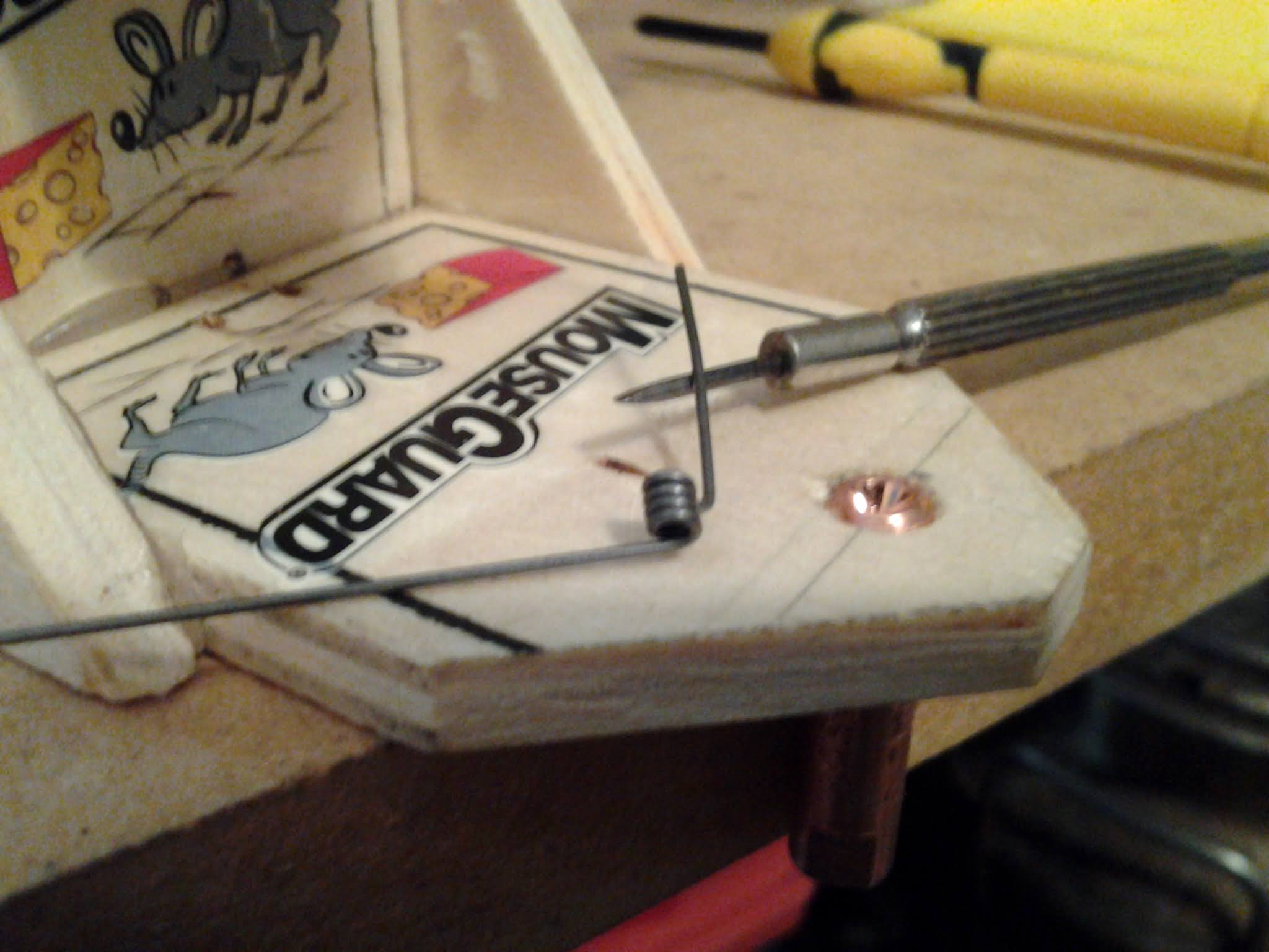

Kev, I’m afraid that you’ve latched on to something that “came and went”… if I’m reading you right. I’ve never really had an official “design”. If you came up with your design, based on information from the middle of my long-running FT thread… you’re out of date and kinda on your own. That thread simply documents an “out in the open” development of the needle cutter that covers several years of trial and error… and, chronologically-speaking, the most recent – and probably best – information will be toward the end of the thread, rather than in the middle or at the beginning.
The intent of that FT thread was, first (personally), to document progress toward a better needle-cutter than I started with… and, second, to show all the things I (and ultimately others, as they chimed in…) tried, to attain that end. The primary emphasis, above all, was to “use what you’ve got” and KISS. The needle cutter was, and is, DIY… all the way.
Along the way I tried using mouse traps and clothes-pins to illustrate how common everyday items might be used to cut foam. Though not always very practical or long-lasting, I was amazed they sometimes worked as well as they did…
IF I were to continue needle-cutter development now… I would start with my own last attempts with a slip-on “flywheel”. Other popular designs, our own @jhitesma had an “improved” design and Edward Chew actually offered a needle-cutter system kit until the pandemic brought that to an unfortunate halt.

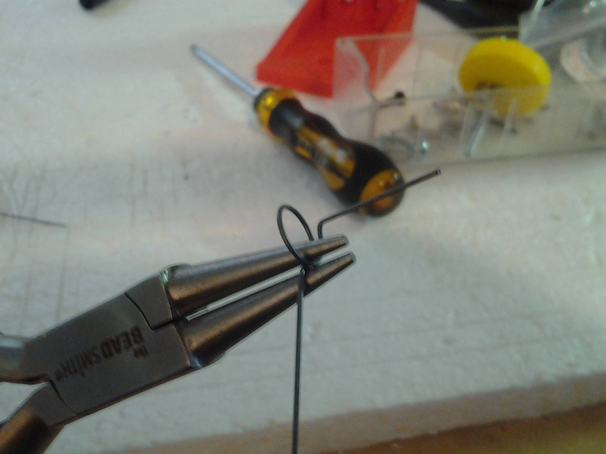

EDIT: BTW stress-risers from using pliers with sharp jaw edges to form the loops in the needle wire will also cause problems… use round-jaw pliers to form loops in the needle. And – never – try to adjust or unbend the wire… once it’s bent.

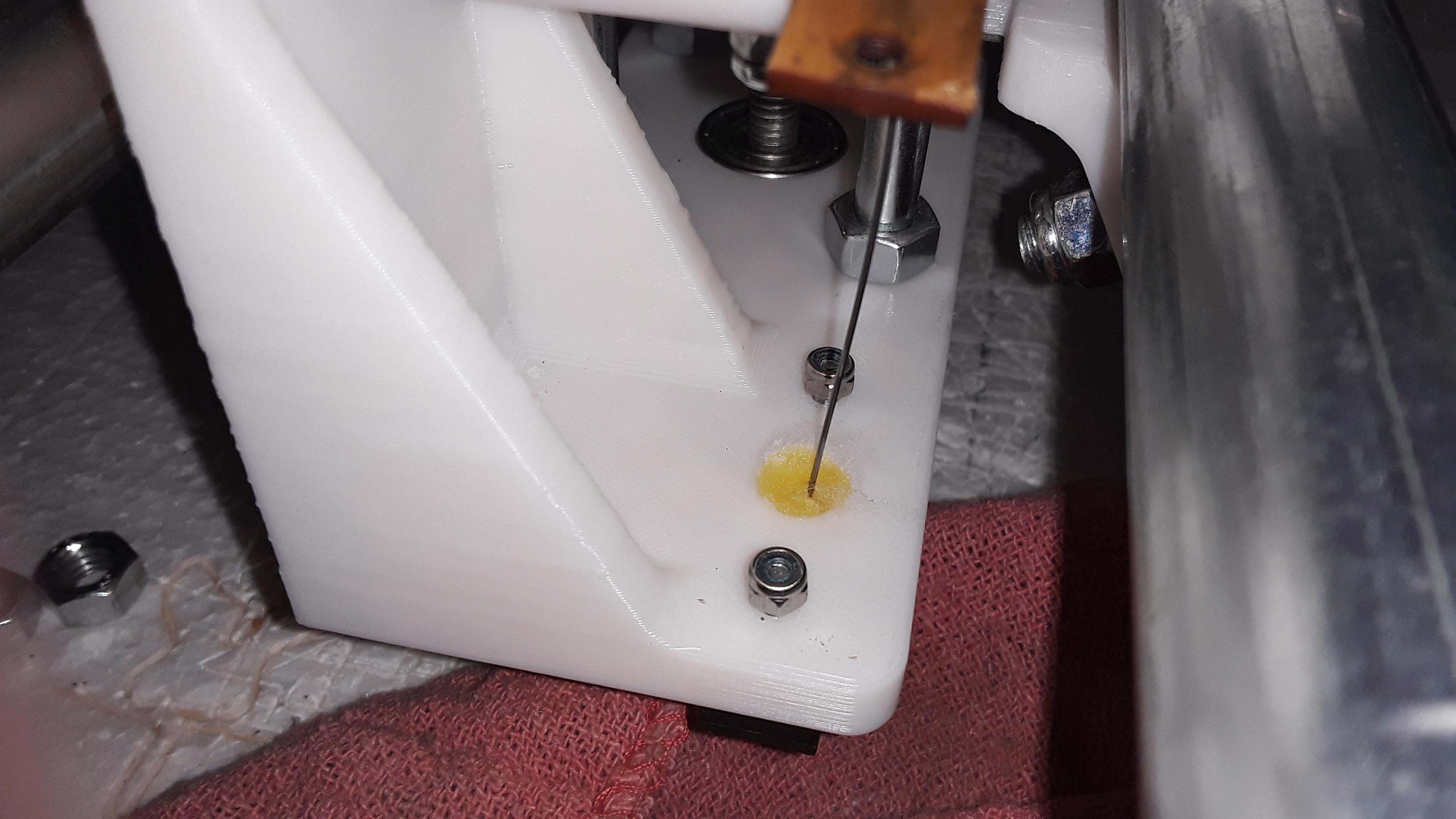

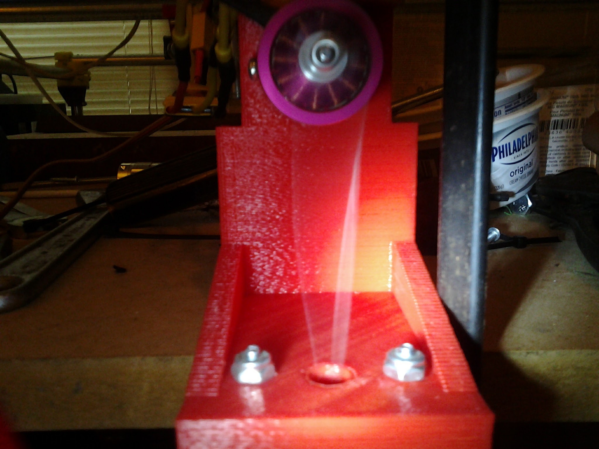

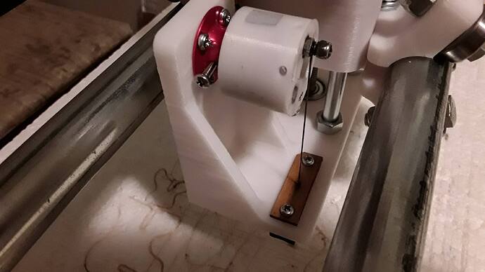

I did make my “improved” design taller as a few other people had experimented with longer needles to minimize the bending. I figured it doesn’t hurt - but I’m also not completely convinced it really helps that much. I’m pretty sure every needle I broke broke at the bend around the bearing/shaft point - not just along it’s length.
I did like that the longer length and the guide bearings resulted in a bit more “stable” needle at the cutting point. If that makes sense? Basically the bearings guiding it into the MIG tip and the extra length made things run cooler and the needle was more accurate giving a cleaner cut. Shorter needle and no pre-guiding I was initially using a inflation needle (like for a soccer/volley/basketball) and would wear out the sides of them fairly quickly since there was a lot of friction.
The MIG tip is a lot more metal so it’s harder to wear through, and they’re available in different sizes so finding one that matches the needle is easier.
So - while I’m not sure that the extra height and bearing guides are really necessary - I did wind up with a very reliable setup that worked without issue. It probably still works - I just haven’t used it in a few years since I haven’t had time to fly so wasn’t building any planes. I did fire it up a few years ago to cut some sights for my daughters girl scout troop and it still worked just fine.
As for the wire - I just used K&S wire I found at the local hardware store. Didn’t source anything exotic or put any serious thought into the metallurgy other than “Piano wire”

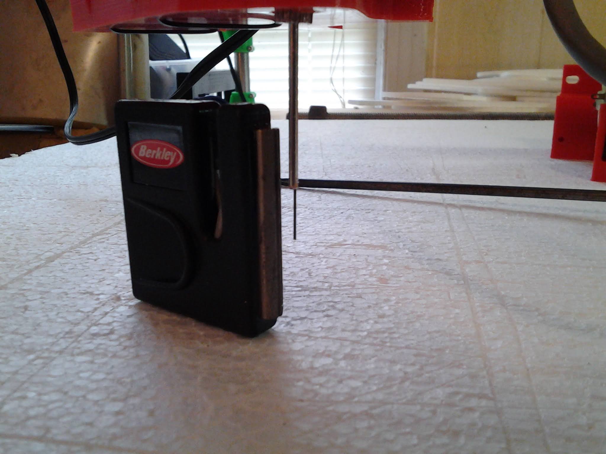

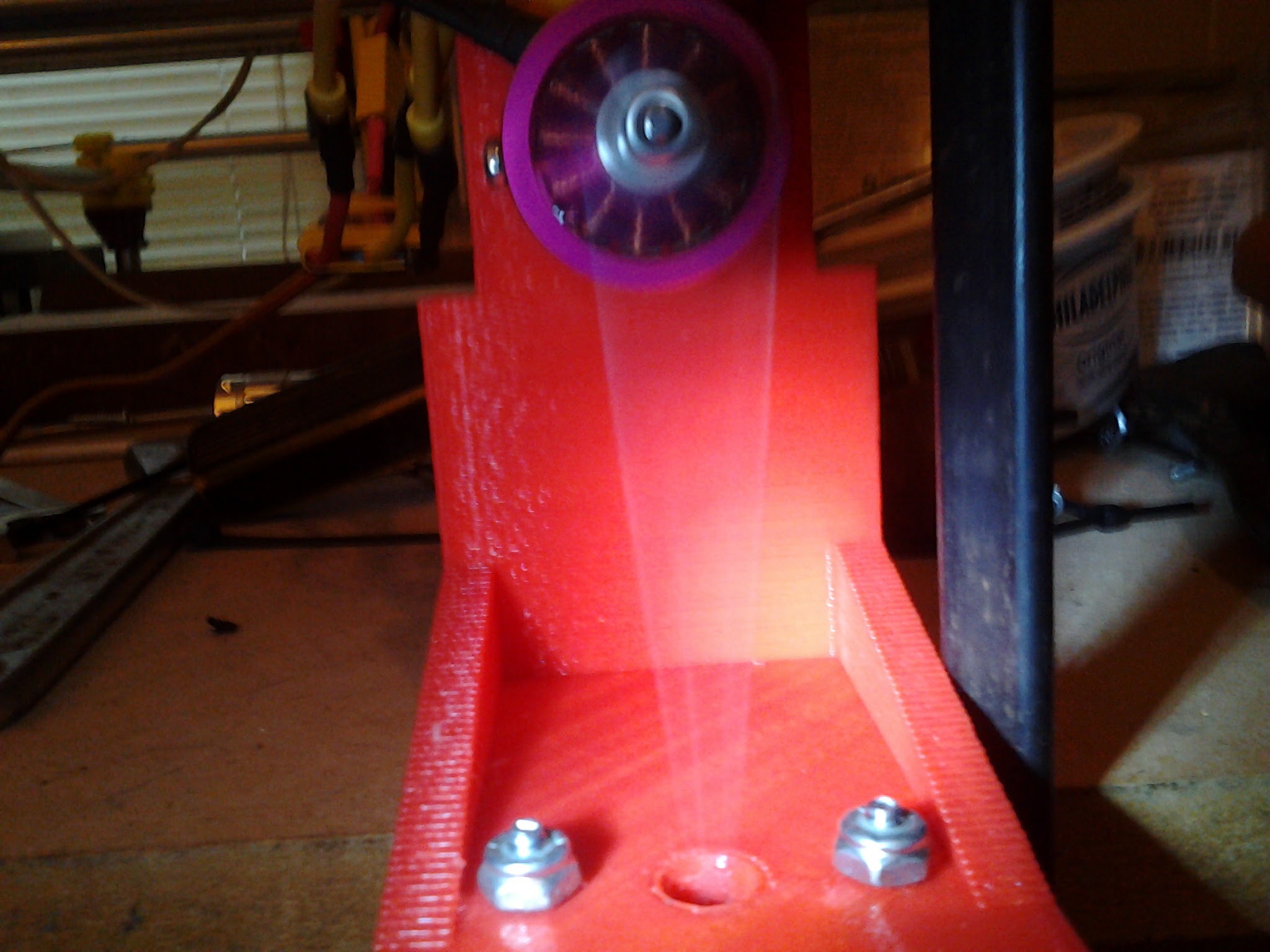

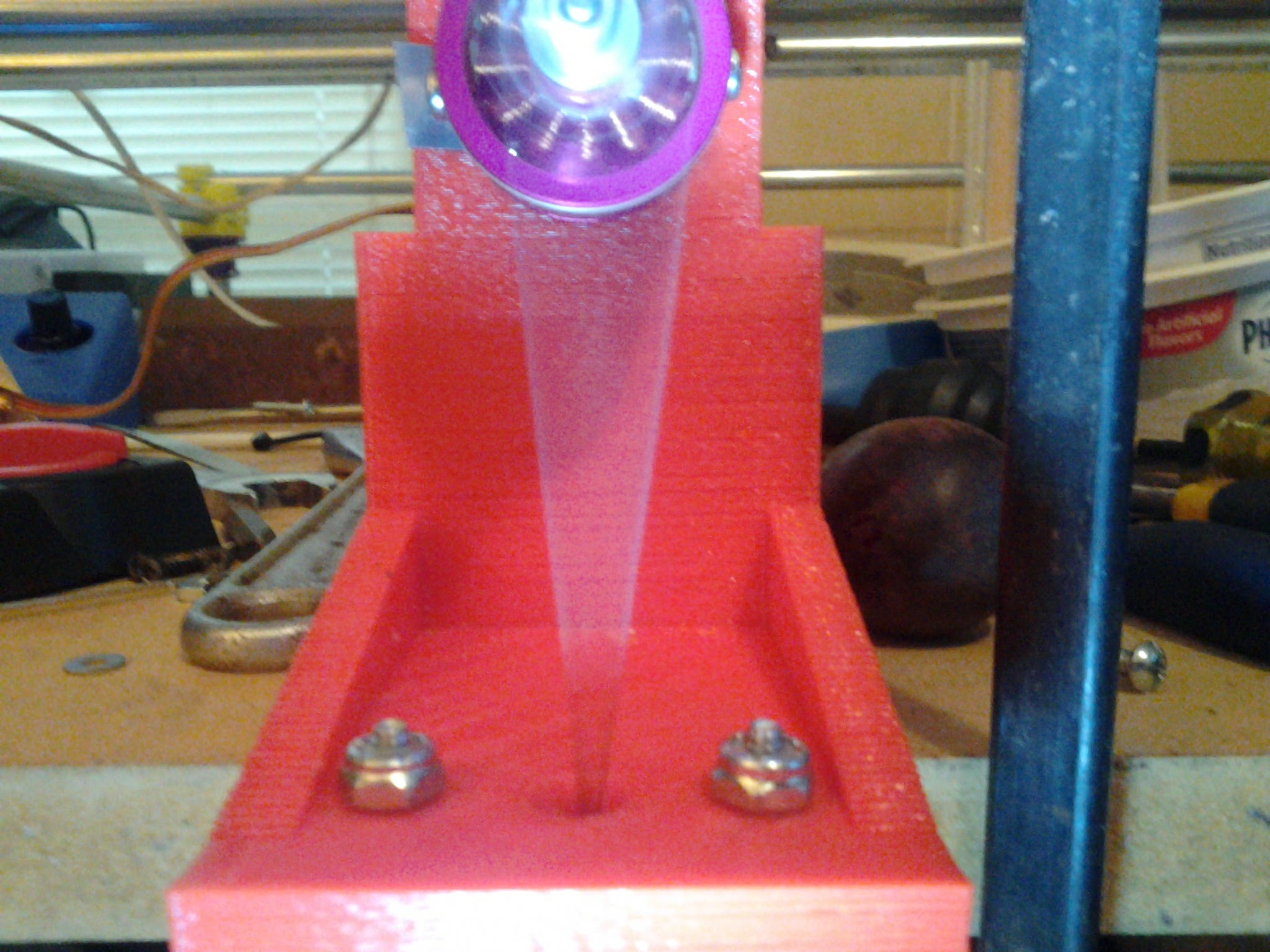

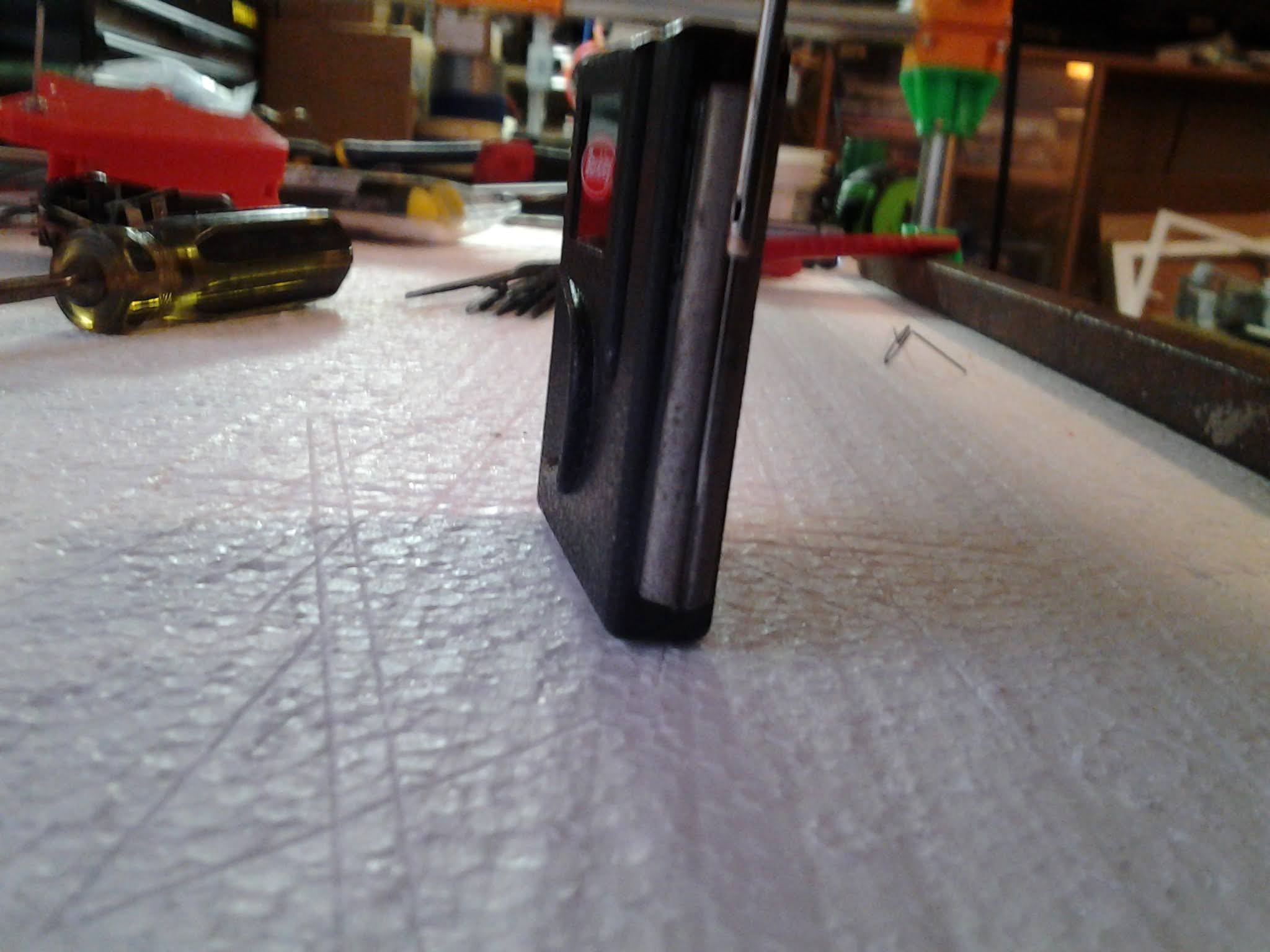

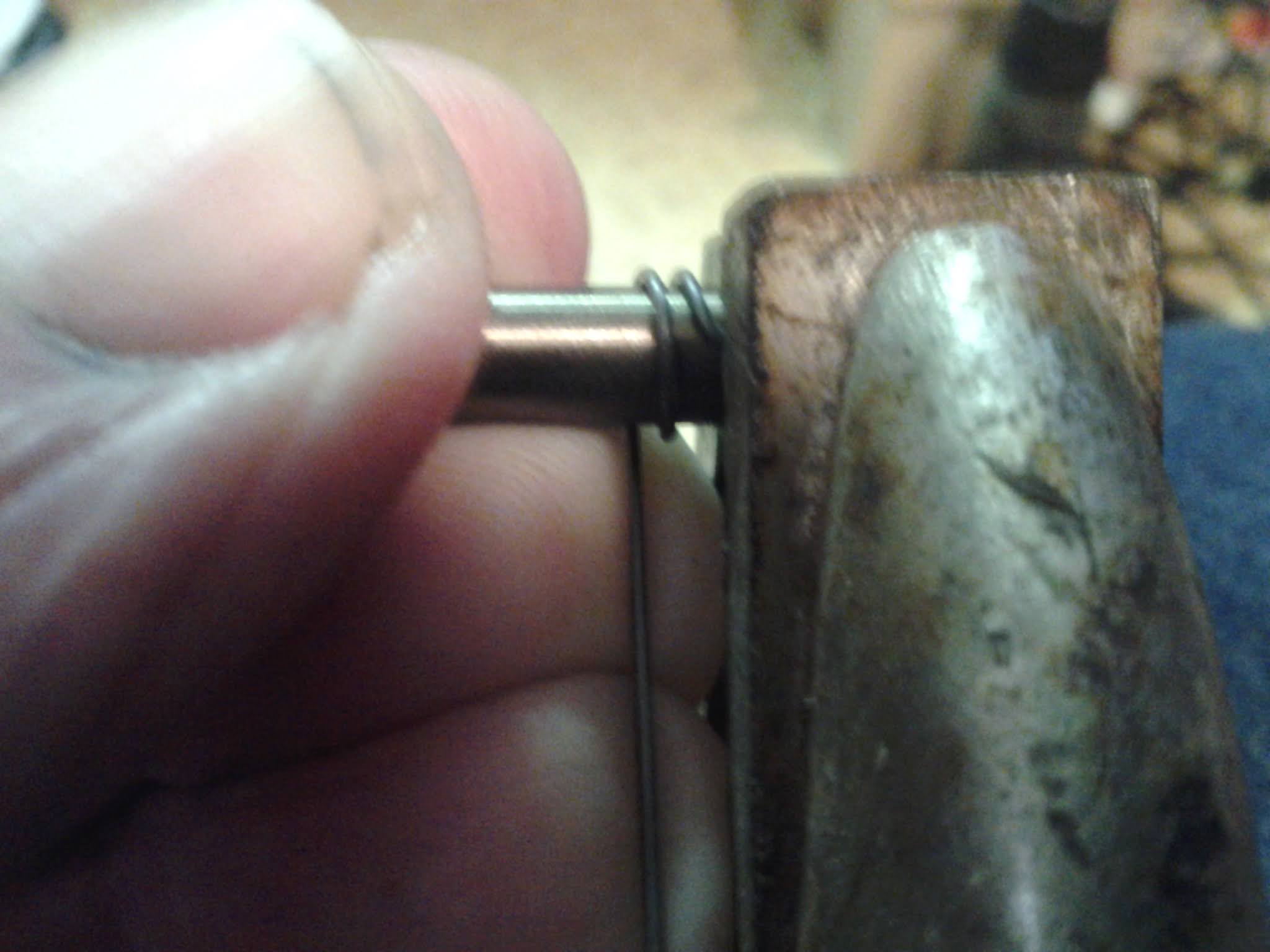

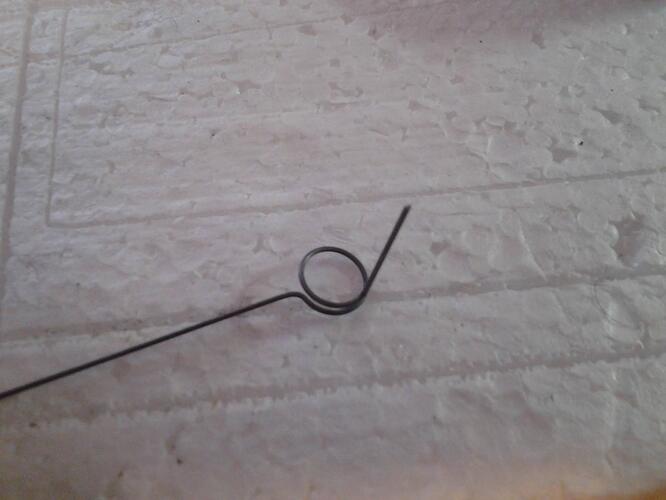

The clothespin crank setup came about in an effort to minimize the mass and imbalance seen in poorly balanced “flywheel” and eccentric setups. Initially, things seemed far better and smoother-running… even without effort to do any balancing at all. They could be made to cut foam quite well for a while… but longevity of the mechanism turned out to be quite poor for most folks.
When I was testing the clothespin crank, I would wind several close loops of the needle wire around a small jeweler’s screwdriver blade and then snip off the tail. I really don’t recall ever breaking a needle with this setup during all my testing. The biggest problem I saw with the clothespin crank was that a groove would form where the needle loops wore against crank pin and it would eventually cut the end off… even though I would periodically apply a small drop of machine oil to the needle loops.
I also went by the needle blur to judge whether things seemed kosher or not. I tried to insure the blur was centered and symmetrical and that the entry angle into the guide was as smooth and gradual as possible. This is where a taller cutter body can help. This is also where I judged that pre-guide bearings were not for me… as that would only increase the severity of the bend angle where the needle hit the first guide bearings or pins.
Using a flashlight to illuminate the blur would allow seeing any weirdness or lack of symmetry. I figured cutting forces would only aggravate any non-symmetry and lead to premature failure.
I still like this as a quick and dirty setup. The problem with doing anything to fix the slop at the connection point is that it would only add mass and cause imbalance. Elon’s “the best part is no part at all” comes to mind…
:wink:
Those are really good photos showing what can actually happen to the wire in motion. I figured it wouldn’t be perfectly symmetrical, and that cutting forces + friction would have some influence on the final path of motion.
It’s interesting to hear you didn’t have issues with breaking needles using the clothespin. I tried several times and even with a minimal stroke it still seemed to break too often. The bend of the needle seemed to have the most influence on longevity, and lithium grease helped a bit. I also see you didn’t use a counter bend on the wire… that could make a big difference removing that stress riser (and since the axle is so small the center is only offset a couple mm at most). Regardless which direction I go long term, I truly do appreciate how the clothes pin idea adheres well to the KISS principle (absolutely love the mouse trap parts too). :wink: It’s just that after playing with the clothes pin method for a bit, I can’t seem to make the thing reliable enough for my needs (~30min max needle life for me).

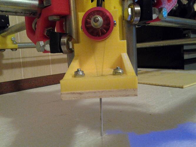

I do like the idea of the guide bearings though. Getting additional motor to first bearing distance is just a matter of drawing the design taller (my printer could do 220mm height if needed, and my latest design with more spacing is just 90mm tall). Having those bearings does help keep the needle in a more constant cutting position, vs having that wagging wire entering the mig tip which results in more of a side to side needle path. I have observed this side-side motion does lead to less perfect cuts… cuts are square when inline with the plane of the flywheel, but tapered on lines that are perpendicular to the flywheel.

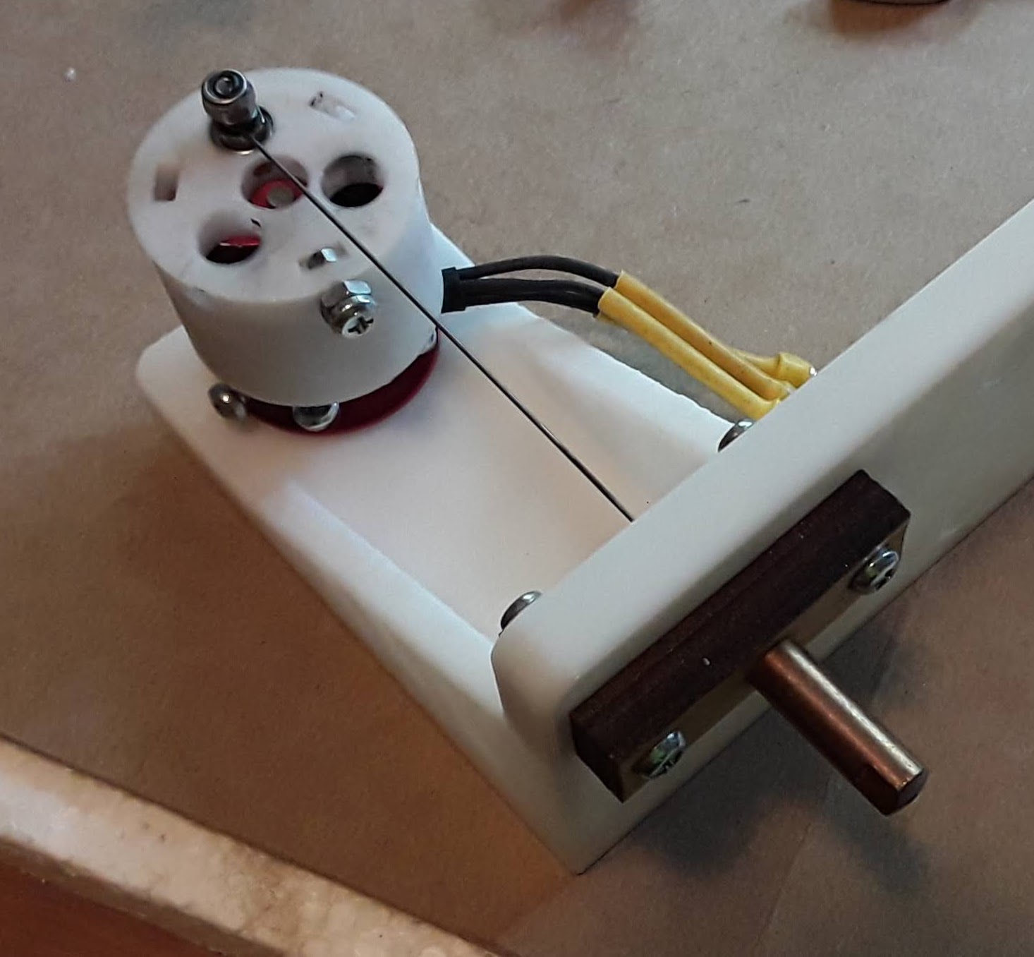

I am now printing a full redrawn cutter mount that has 55mm spacing between the motor shaft and the first bearings. This appears close to what Jason did on his, and it is more than double the spacing I had with my original remixed design. Doing the maths, assuming a 14mm stroke, the old design deflected the wire about 30degrees. My new design bends the wire less than 15degrees, and just feeling the wire out with my hands it seems 55mm won’t result in major buckling/asymmetry issues.

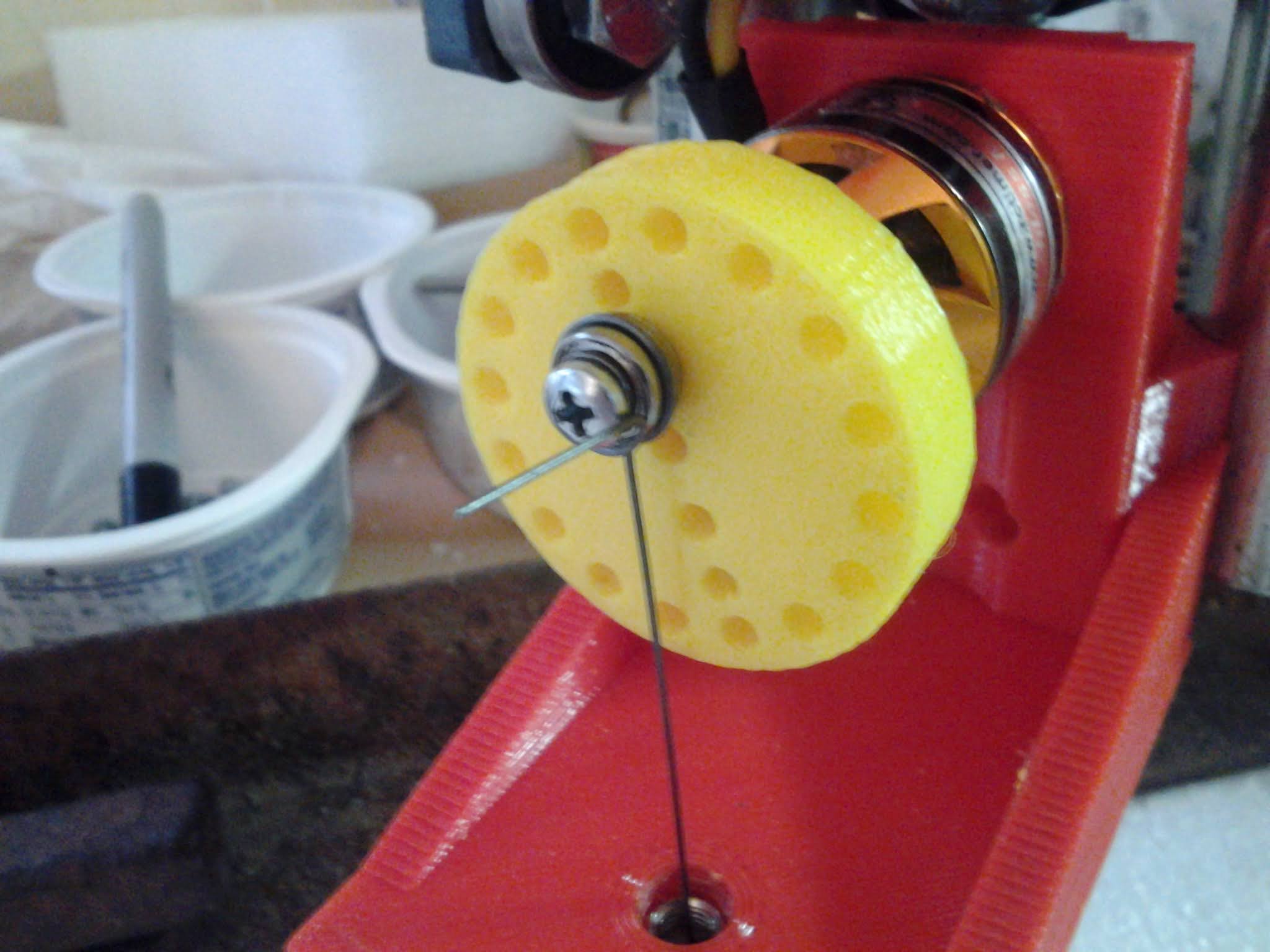

My flywheel design is going to be very similar to Jason’s as well… I just went with a 14mm stroke (to make cutting 9mm depron easier), and only has 3 holes; one for a press fit motor shaft, 2 for the wire bearing, and a third counterbored hole for a counterbalance/anti-rotation-pin bolt and bearing. I didn’t go crazy calculating moments of inertia for a perfect balance here, because my crappy motor already shakes a ton without even having a flywheel installed. I’m also relying on a press fit since my motor doesn’t have prop holes in front. If the press fit ends up slipping out, I will probably drill/tap some holes in the aluminum rotor face and use M2 bolts to hold the flywheel on like Jason did.
[edit: I found some 3x10x3 V groove bearings on amazon I’m going to try out on the flywheel. My first attempt using a bearing flywheel I had the wire slip off the bearing every other try. The larger outter race on the V groove bearing will add weight/imbalance, but if that’s an issue I can address that easily. I think having the groove might help make it more reliable. Thoughts?]
My early flywheels used a bearing that I cut a shallow groove in with a Dremel rotary tool and cutting disk. Keeping light finger pressure on the bearing to limit rotation speed, I’d let the bearing slowly spin on a 3mm shaft while holding the disk in the middle of the outer race to cut the groove. You’ll destroy the bearing if you let it free run… ask me how I know. :wink:
For the needle, I wrapped the 0.025" diameter K&S steel wire around a drill bit shank a bit smaller than the OD of the bearing to form a loop that needed to be slightly sprung open to slip over the bearing OD and then into the groove… and that little bit of spring pressure was actually enough to keep the needle firmly seated in the groove during operation. Also note that I offset the needle shank to “bi-sect the loop” with round-jaw pliers… this insures the symmetry and centered-ness of the needle blur.
IIRC I believe Jason put a drop of super glue on the loop after slipping it in place on the bearing’s outer race… without actually grooving it.

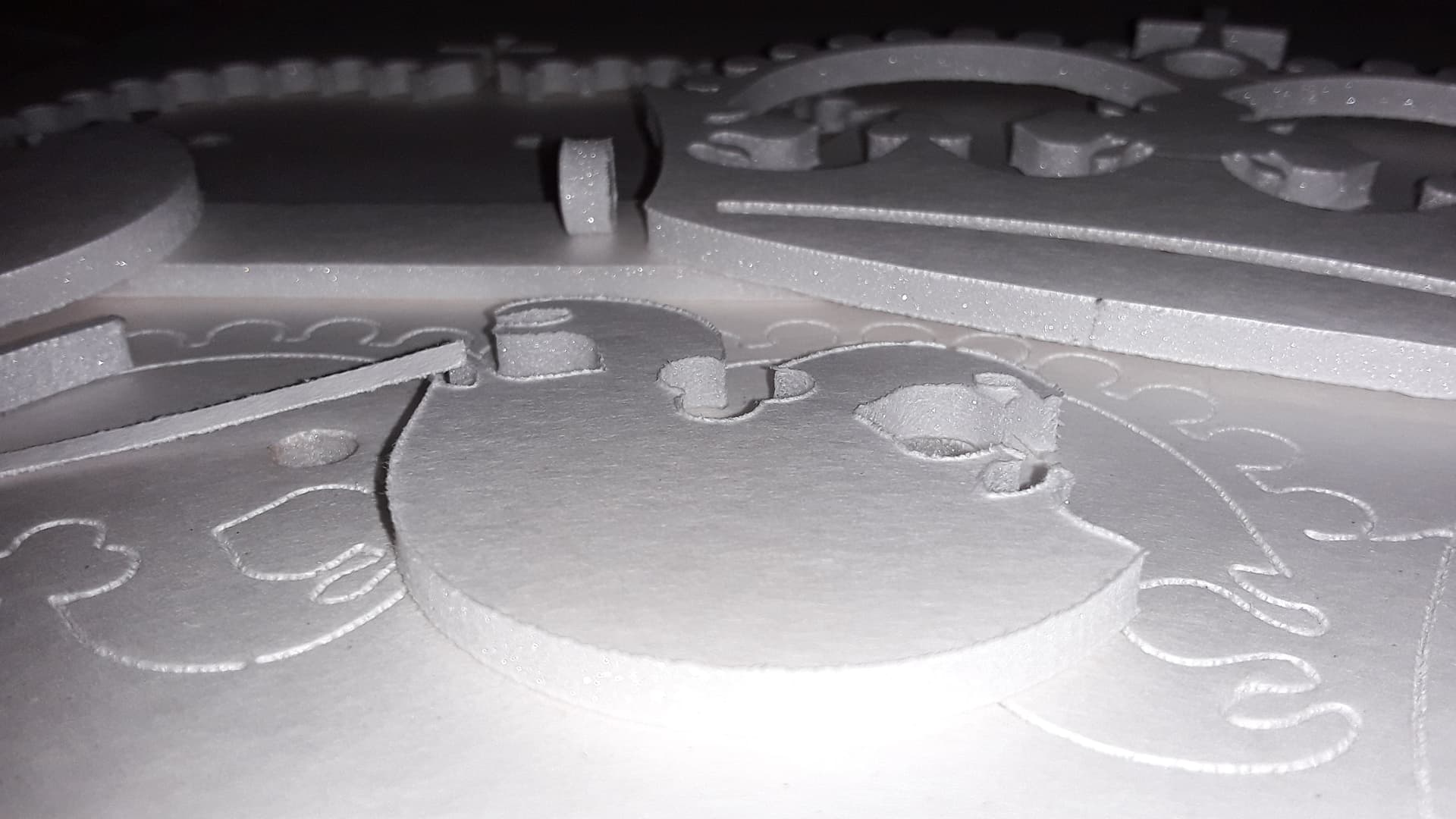

My latest and smoothest-running needle cutter doesn’t use guide bearings… but in a sense I guess it does use an “oily” wooden “pre-guide” above the entry into the main guide. The laser-cut wooden pre-guide had a ~1mm hole IIRC for the needle and along with a stack of wooden plates under the plastic platform for the MIG-tip to thread in to… formed a “sandwich” with the platform in the middle. That left a convenient “cavity” into which I packed cotton and then soaked with 3-in-1 machine oil. This cutter’s dimensions are ~63.5mm from motor shaft center to the wooden “pre-guide” and the eccentric offset on the flywheel of 8.8mm… for a total stroke of about 17.6mm.

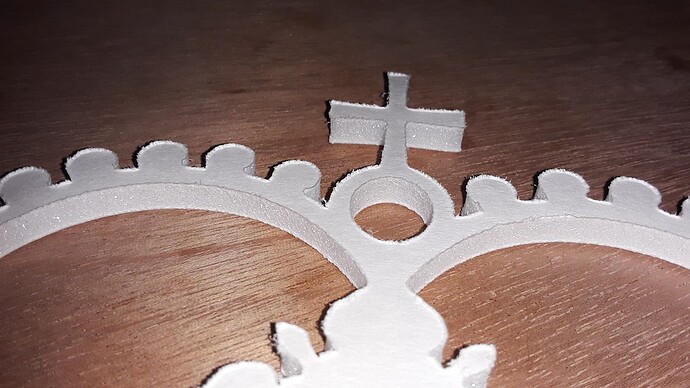

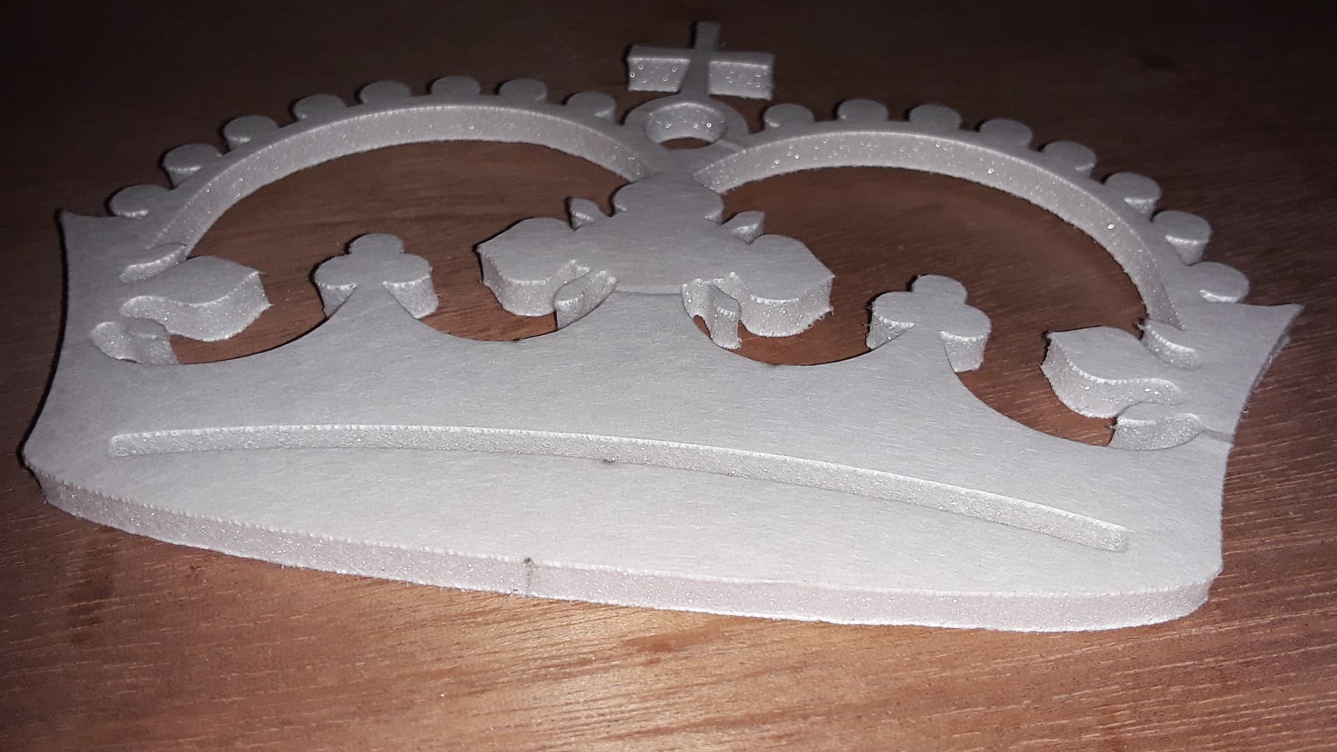

I was able to get some of the nicest cuts ever with this needle cutter setup. IIRC I usually set in ~8000 RPM on the cutter speed and 600 to 800 mm/minute feed rate.
I don’t remember side-to-side motion ever being a problem with the needle cutter… even with some of my earlier cutters. Though there does need to be some slop, I made sure that there wasn’t an excessive amount of “slop” of the needle in guide. I used MIG-tips marked 0.035" and 0.025" K&S steel wire that came in straight 36" lengths. While not all my cuts were “perfect” or even quite as nice as on the crown above… they were always “good enough” for RC plane parts.
Yep, I was going to add that I tried to groove a bearing like @dkj4linux but I had no luck. I tried a couple of different cutting tools but wasn’t able to do much more than dull the outside of the bearing.
I did make the loop in my wire undersized so it had a good bit of pressure holding it onto the bearing - and then VERY carefully added a drop of super glue (avoiding getting it into the bearing itself) on the off chance it may help (I doubt it actually adhered to the outside of the bearing but I figured it couldn’t hurt unless it got into the actual bearing.)
I seem to remember a few people did use V-groove bearings I was just too broke/cheap. a
I did use a little oil soaked ball of cotton like @dkj4linux for some lubrication and it did seem to make a difference. Similar setup - I had a piece of wood that the MIG tip threaded into which I then bolted to my 3D print which had a hole about the same as the OD of the MIG tip where I put the cotton.

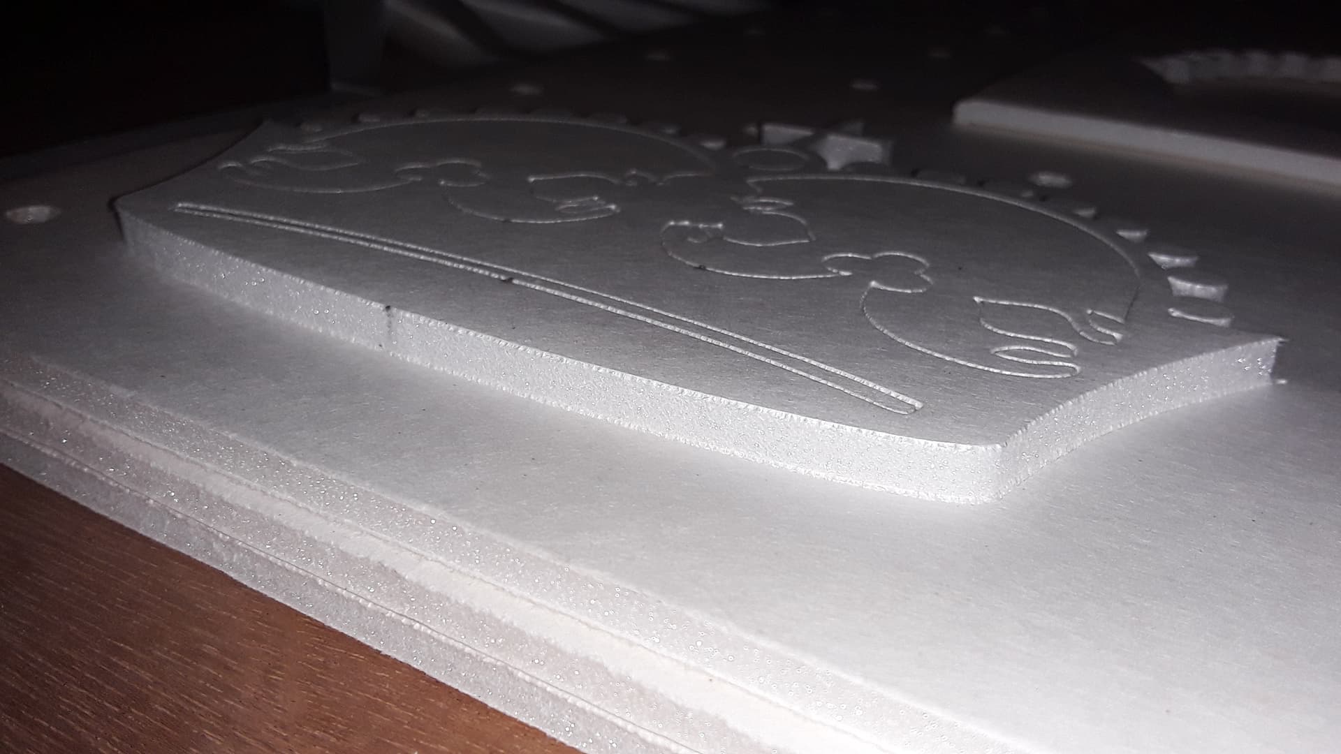

I started off using a bit too much guide bearing spacing (~1.0mm), which resulted in relatively rough cuts regardless of travel direction. Narrowing that to 0.8mm seems like the ideal number… I observed the same rotational patterns as Jason, and have much cleaner cuts. I also started off with just a 3x6x3mm plain bearing on the crank, but the needle fell off after some cutting on 2 occasions. The second time the wire got hung on the bearing bolt, and created enough heat to melt the flyweel, sending the bearing and bolt flying across my garage, lol! After that I decided the 3x10x3 slotted bearing would be well worth the added weight. I was using a bolt and 2 nuts to counterbalance, and only had enough room on my design to fit 3 nuts. There was still an imbalance, but the whole thing ran relatively smooth and quiet with the slotted bearing, and now the needle seems like it’s never going to break or fall off.
I did note however, that the cuts with this assembly appeared rougher depending on the direction it was cutting. It is hard to tell exactly why; I suspected it could be needle heating is worse in some directions than others, but the foam does not appear melted at all on the rough cuts. There is a definite ‘snagging’ sound when it cuts rough. I figure maybe the problem was my feed may be too high where the needle gets jammed when cutting certain directions. I will experiment further with feed rates to see if it results in better cuts. Has anyone else observed this sort of behavior from their needle cutter WRT feed rate, or is it something else I should be looking at?
The clean cuts though are pretty much perfection… you literally cannot tell the difference between the needle cut and a careful ruler guided cut with a new razor blade… just beautiful what it is capable of. Ironically, my clothes pin rig got the smoothest cuts all around, but I’d be lucky if I didn’t have to use 2-3 needles (with 2-3 more operation cycles) to get a full kit cut. Could my rougher directional cutting now be due to having a 14mm stroke vs the 9mm of my clothes pin (too much needle speed maybe)?

Would love to see a few photos of your needle cutter. It would go a long way toward helping us see what you’ve now got. Sounds like it has great potential if you’re getting some really clean cuts on occasion.
WRT to the “directional snagging” closely inspect the needle tip. Depending on how you snipped it to length, you might have a “harpoon point” with a barb on one side? I used to use a sharpening stone (with a fish hook groove) to dress the tip… lightly holding the stone against the needle while running and working it all around to remove any barbs.
