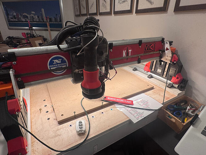

I have a LR4 with a JP. I use a Windows 11 notebook with MillMage which I am absolutely loving.
My issue is on a few occasions, about 1-2 minutes into running a job the FluidNC WIFI connection drops. Not horrible because the cutting just stops. And I don’t lose machine coordinates. So I reconnect and just restart the job. But irritating.

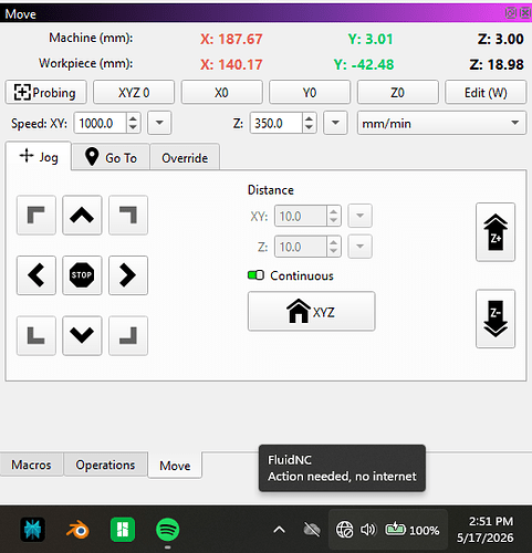

Any thoughts? I am warned “no Internet connection” but that’s normal. I also have no automatically connect WIFI’s set. Just manual.

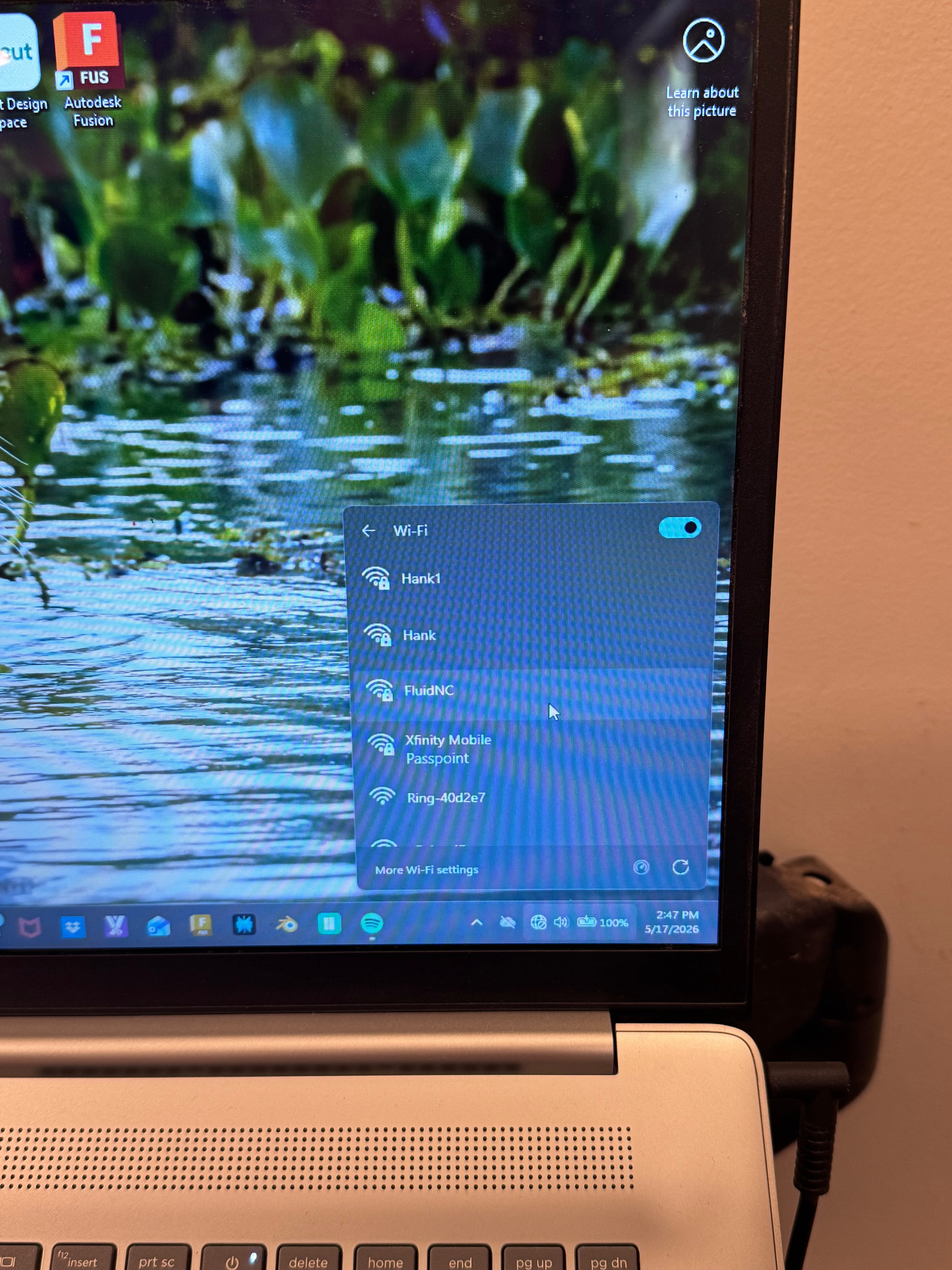

This is my setup:
LR4 w/ JPv1 and a Windows 11 Notebook mounted adjacent.

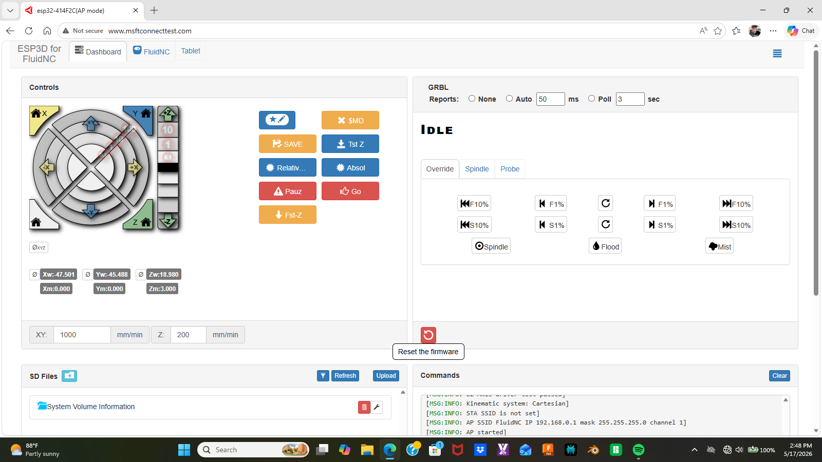

Sorry I just took picture but here is my FluidNC next to my home network (Hank and Hank 1)
My Windows 11notebook is RIGHT next to my LR4 (JPv1)
So …I just log onto FluidNC WIFI SSID
Go to the ip address which open automatically for me after a pause of being redirected.

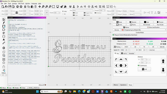

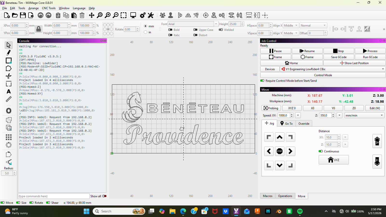

I always test by just homing Z to verify they are linked. Then I minimize the browser screen.
Then I open MillMage and all is good. And I do my XYZ Homing, Probe, etc then run a job.
So all is good. EXCEPT on occasion I Drop the FluidNC connection. But no harm I just reconnect and re-run the same job.
So my only remaining question is:
Once I am directly connected to my FluidNC Jackpot isn’t my home network WIFI basically irrelevant?
I would think I could even turn off my Home wifi as it’s not in the connection between my Notbook to LR4 Jackpot? Right?
Anyway TIA as always.
-Craig

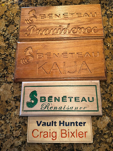

Just a shot of some fun jobs for a couple sailing friends. We all have the same sailboat. Ignore the stupid “Vault Hunter” plaque is in reference to a video game Borderlands. :zany_face:

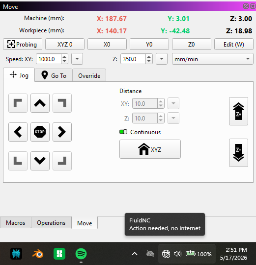

This one is still not fully connected, you are in the captive portal.

It’s not stupid! I am going to tell on you, Tina’s going to be mad you said that! :scream:
Sorry not sure what you mean? Fully connected with MillMage?
I really liked the ability through MillMage to control my CNC.
I’m pretty sure he means the part where the web address you’re connected to is www.msftconnecttest.com - I believe that means you’re not fully connected. That page is the “captive portal” Ryan’s talking about.
I think you need to go to http://192.168.0.1/ once you’re connected to the wifi to have the full connection.
