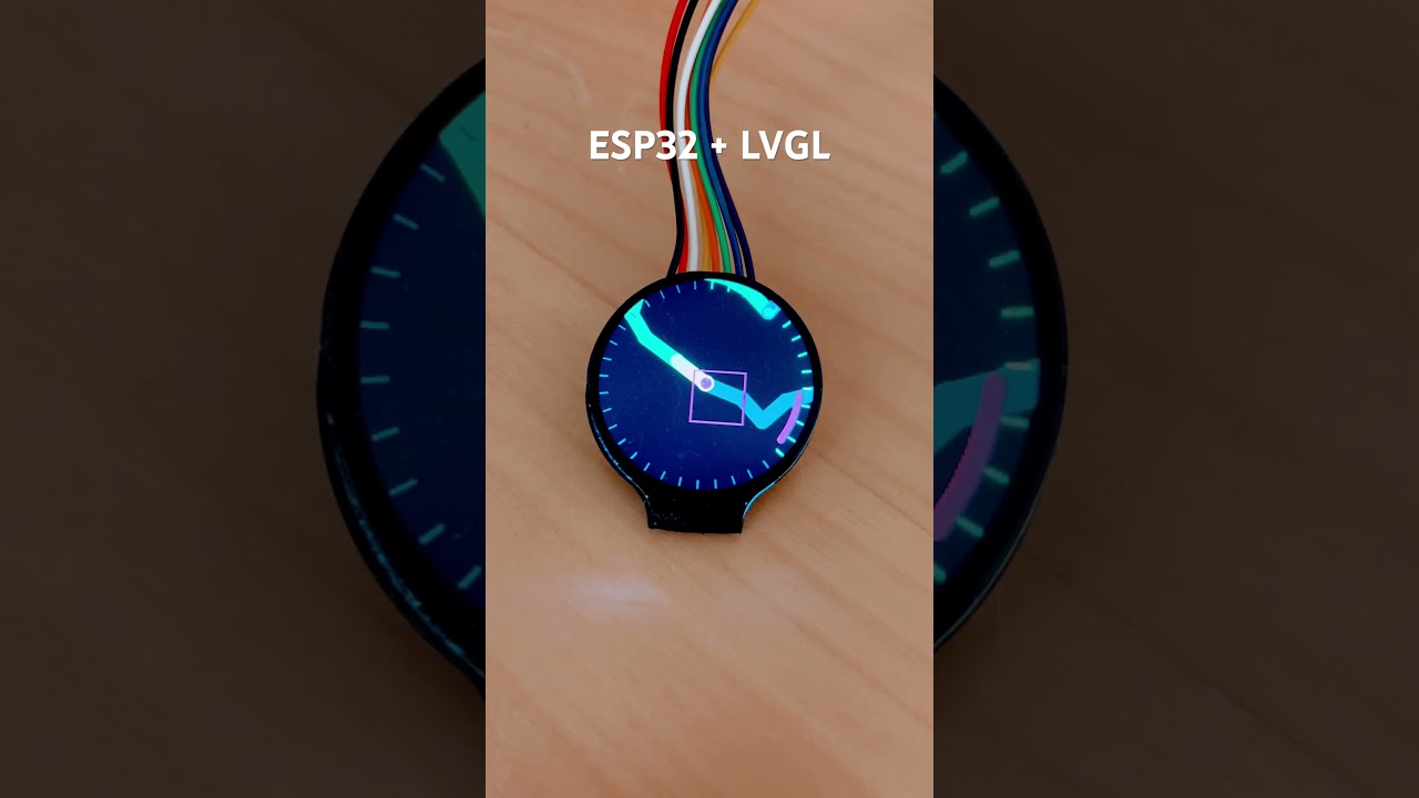

Compass Router UI prototype with path preview
I spent the morning working on a prototype for the compass router UI, and I’m really excited about it. I’ve been thinking about how great it would be to have a G-code preview. See it in action here:
I’ve attached my initial prototype and would love to get your thoughts on it. I’m especially curious about these things:
  • What improvements can I make? Did I get core concepts wrong?
  • Will this kind of UX be too resource-heavy?
  • Do you have any tips for making it run more smoothly?
  • Is there anything I’ve overlooked, or any other features that would be cool to add for a better user experience? (For example, I haven’t included the second drift ring that Cam made .)
Some notes: the direction arc glides way too much in and out of the center in this example, that’s just for the animation. In real life it would only concentrate around the center when you are almost running out of compensation-room.
Looks sweet!! What are you using for the example path? Is it just running pseudo movement?
Looks pretty accurate off the bat. I dig the way it looks. One thing to note is the range is actually a square, not a circle. I think we’d actually have to implement it on the machine to see where it can be made more intuitive.
This is the main things hahah. In the firmware’s current state, this will 100% have to be run on on its own processor. Mayybe if sensing and motor control were put on interrupts it could be possible, but this would cost a lot of relative time in the loop. I bought a GC9A01 module with a built in processor a couple weeks ago with the goal of making a more complex UI, but I haven’t gotten around to it yet. If you’re curious at messing around with it, this is the display I used. They are pretty common on AliExpress because people use this display for smart watches all the time.
Are you using a specific library for the graphics? I’m not a UI expert, but I’ve seen a few examples of cool libraries that help to make nice, smooth graphics. This is one that I stumbled upon that seems pretty common:
Looks pretty good at the moment! Like I said, I think we’d just need to test it out to see what needs to be added or taken away :slight_smile:
That was just pseudo movement, yeah. But I actually converted some of your sketch so it works with real gcode movement as well! It simulates the path that we read from the SD.

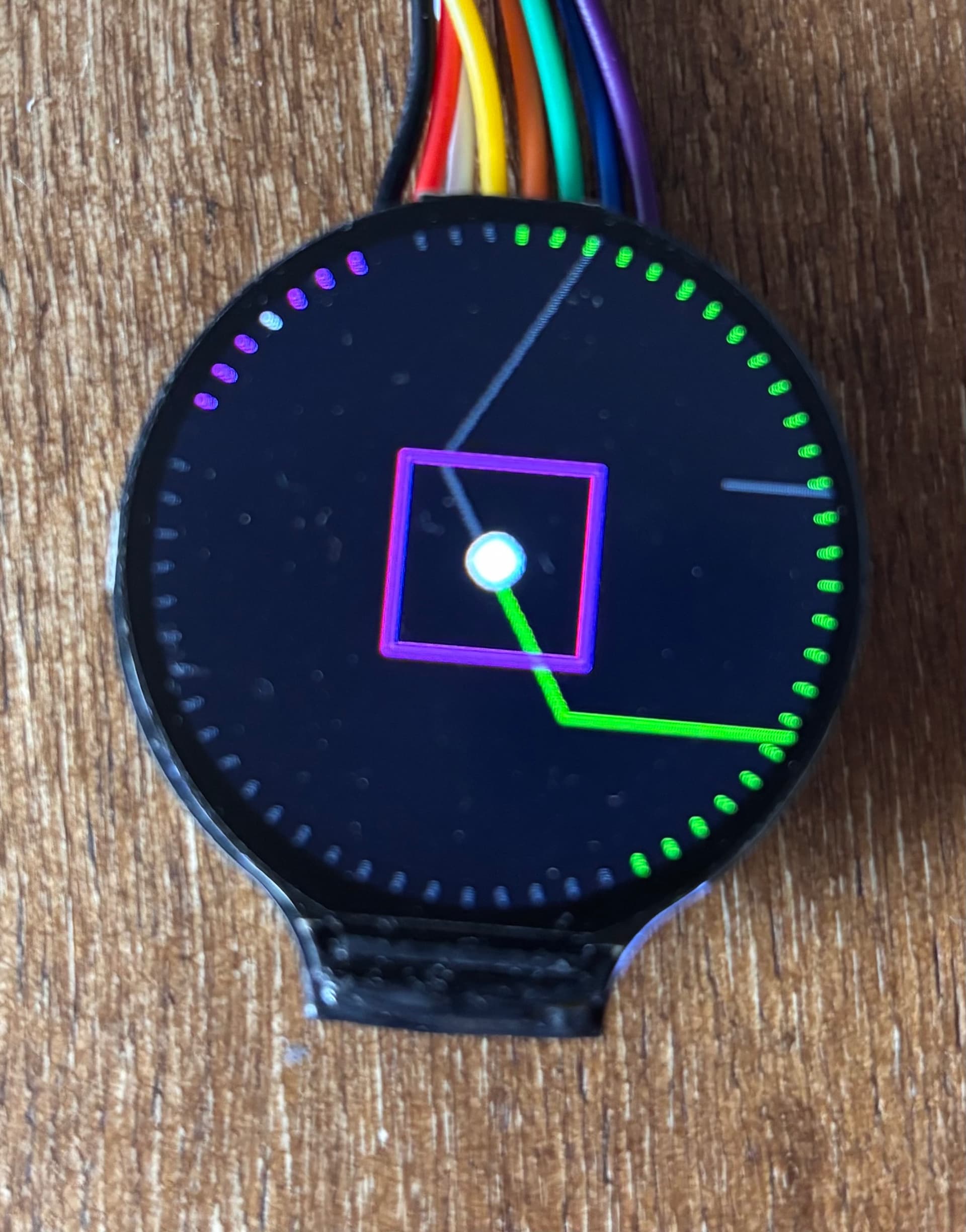

So another day another prototype. I soldered some pins to my ESP32-E wroom board that I had laying around. It’s not ideal as it only has 512Kb of ram and virtually no documentation, but after a couple of hours of troubleshooting and rabbit holing I got it working! The display is connected to the GPIO and not soldered on.
next up is try and scaffold a proof of concept UART connection from the teensy to the ESP32.
This is what I got now:
Couple of things:
the rectangle movement is random and way too jittery still. + it’s overflow in its container gets cut off.
I don’t like how the path is intersecting with the progress and compass, going to make a fading backdrop for it.
the rectangle still needs a more ‘danger’ blinkey mode if almost out of the compensation zone
  • haven’t touched other UI elements. Currently this simple heart takes up ± 30% of ram. But my esp has no other flash which others on AliExpress do. (Got them coming in the mail) that is probably way enough to buffer a lot of paths that we can get from the teensy.
Idea is that the ESP32 keeps a constant connection and updates its UI based on the array of coordinates it gets from the teensy. They can also communicate for example for file lists and communicate back on which file needs to be chosen.
@camchaney is there a loose 5V connection somewhere on the pcb which we can use to power the esp? It takes around 300ma I think.
The ESP needs 3v you probably don’t need 300mA unless you turn on the wifi/bt in which case it can need more
I’m working on a ESP32 (C6) board that replaces the teensy board so we can download gcode over wifi, I have boards but wont touch them until I get my teensy version up and running (almost there) - the big problem with ESPs is not enough pins so you need some external support, still far far cheaper than a teensy
Thank you! I tried it on the teensy’s 3.3 output and it works no problem! That’s handy, so we don’t need a buck converter.
The rudimentary UI currently already takes up 30% of the pram and I see it struggling to get great FPS. (Though the code can probably be a lot more optimized). I feel like the teensy is more expensive but also more powerful in that regard, especially on pram. Are you running into any troubles already?

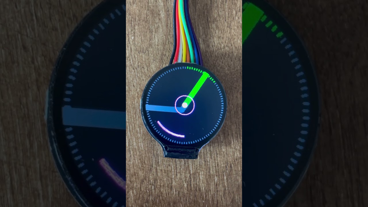

So, I am really sorry guys… I’ve been working on getting the new ESP32-C3 Mini communicating with my Teensy via UART, but I’ve hit some roadblocks that are eating up too much development time.
I had things working pretty well initially. The ESP32 powers up nicely from the Teensy using pins 0 and 1 with a soldered header, and I actually got full debugging operational at one point where all the Teensy debug and sensor data was displaying on the ESP’s screen through LVGL. The basic UART handshake also functions during setup.
The trouble started after I stashed some buggy code via git and lost the working communication. I haven’t been able to restore it since then, even though I think my new code should be correct. I remember just dumping everything to serial1 originally, but even now changing each Serial to Serial1 didn’t work. To debug the issue, I connected an Arduino Uno to the RX/TX lines to test whether it was a code problem, but the Uno’s 5V logic may have been the final blow to those ports.
Now UART communication only works during initial setup, not in the main loop, and even using Cam’s debug and serial handling functions doesn’t resolve the issue. I’m not sure if this is a code problem or if I actually damaged the hardware.
I’m pausing this ESP32 UI project to focus on solutions that won’t interfere with our existing motor feedback loop using only the teensy. If anyone manages to get reliable RX/TX communication working on pins 0 and 1, I’d be happy to revisit this project!
The ESP32 code for LVGL with the ESP-C3-Mini-U1 and GC9a01 display is available at: https://github.com/darkmattericecoffee/esp32-c3-mini. Also was an adventure to get working, haha! The code should mirror data over RX/TX, but currently isn’t functioning - unclear if it’s software or hardware related.
