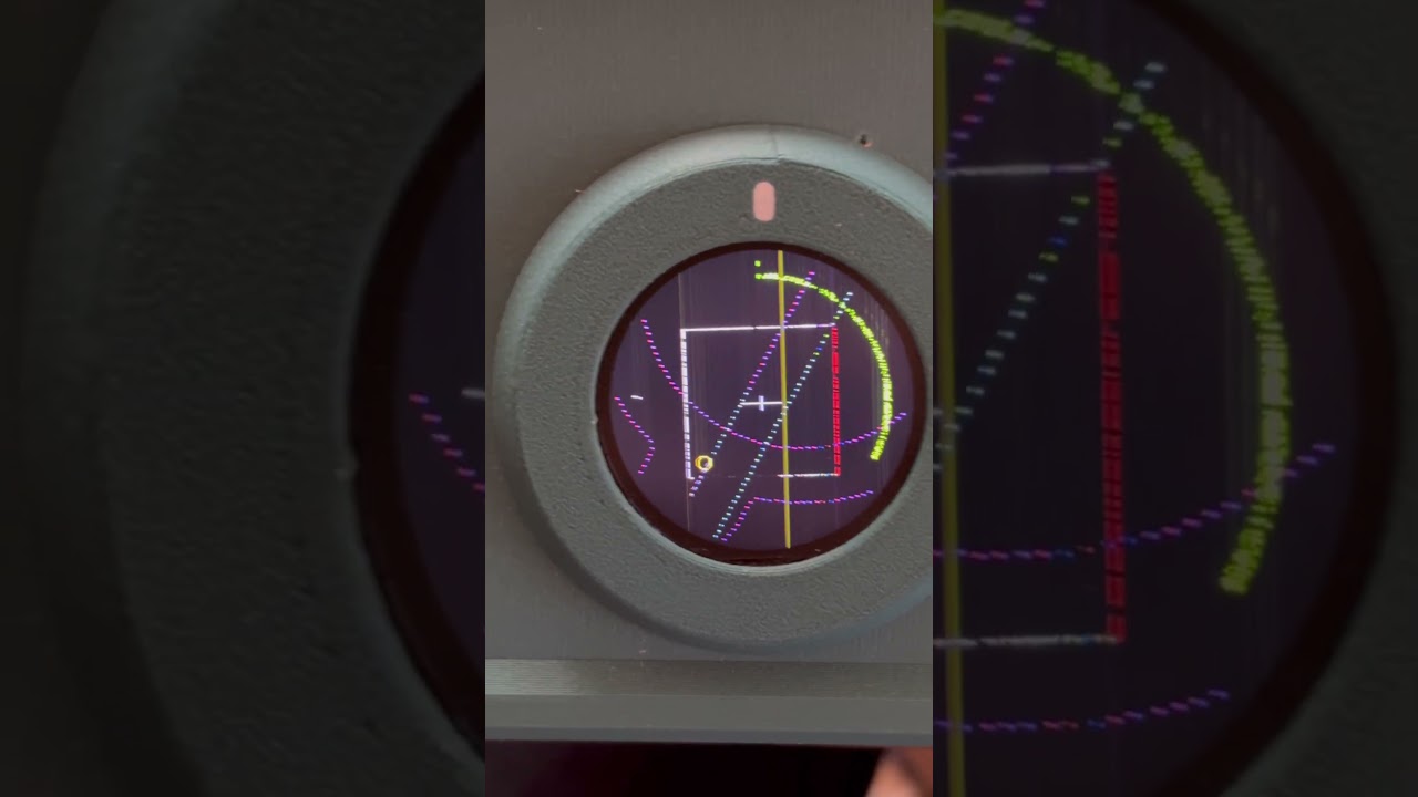

So another morning of tinkering.
Got path preview fully working on real gcode as well! Different colors for different moves.
Cutting paths are dynamic as well: they are color coded purple/green based on the current index. They get green when they are cut.
I’ve added caching for larger paths, and dynamically reload that cache based on the distance traveled, so in theory we shouldn’t run into slowdowns on larger cam files.
I also redid the sampling engine, so it uses real world coordinates to determine the path dots. It currently is set to dot every mm. But that is configurable in the header files, maybe later in the UI itself.
I pushed the changes to the fork.
You need to uncomment my fixes for my chicken head movement, for some reason mine are totally inverted, but homing works as intended..
see it in action:
Wow, amazing! Thanks for the in depth explanation. The stippling makes a lot of sense, drawing individual points instead of the full lines. I’m stoked that works so well.
Very cool. I like that submenu a lot. My current menu logic is admittedly very clunky. I want to refactor the whole thing at some point. If you have a sec in the near future, maybe we can chat and brainstorm this.
I actually just uploaded a modified version of that design (with 3D contours) a couple days ago. It seems like you found it!
I’m curious why you decided to go this route. Does this offer better optimization than basing the sampling off of pixels?
Hmm that’s strange. I’ll look more into that when I go through the fork. I initially thought it might be a mishap with stepper wiring, but if homing is working correctly then that couldn’t be it.
I just tried it on my device and I gotta say again, nice job! It looks great.

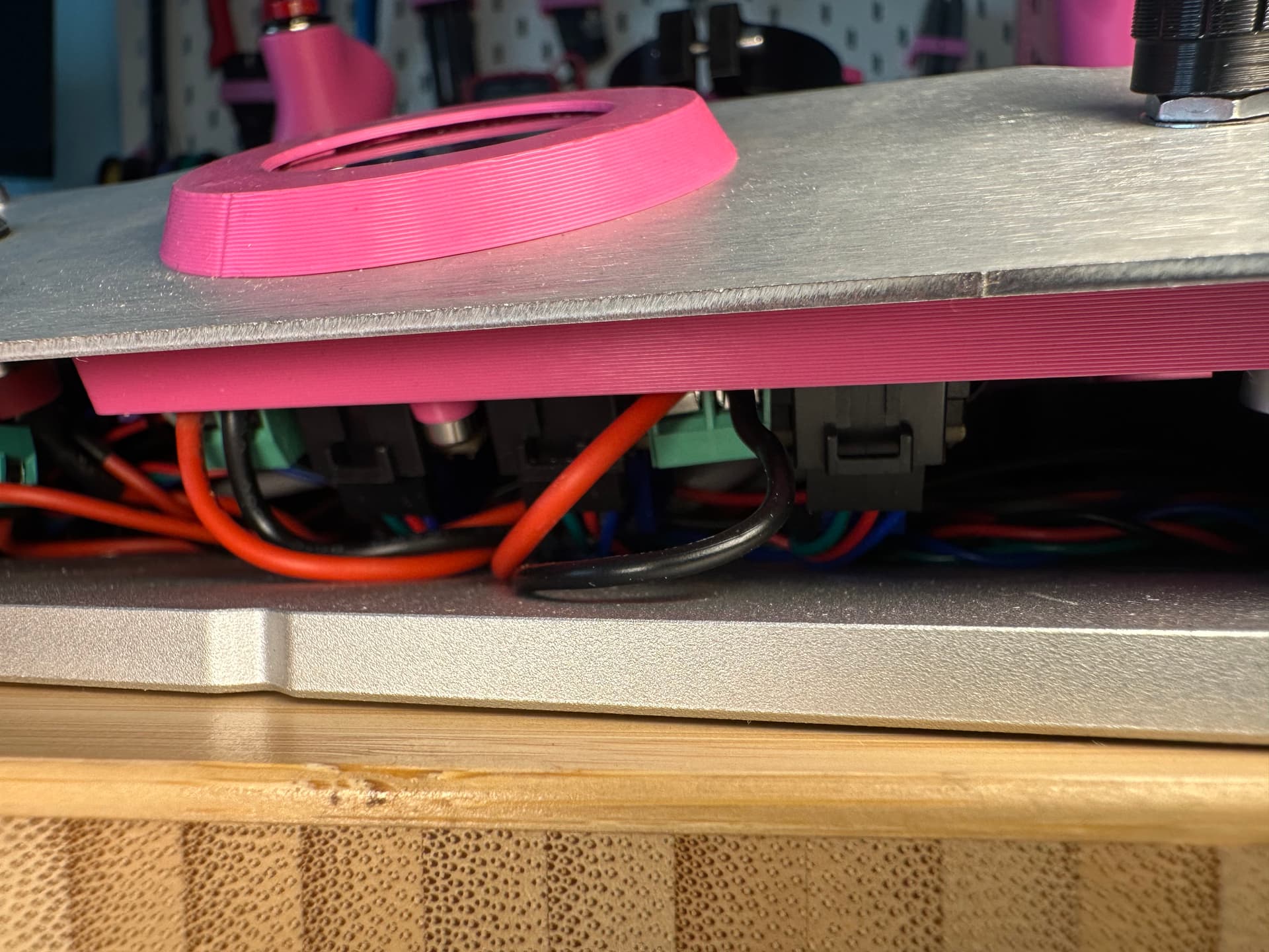

I did have to uncomment those lines in order to get it working correctly. It makes me think that your steppers are wired incorrectly. If it’s not too difficult, could you send a picture of your stepper connections into the main board? You can just get a picture from the gap in the front like this:
Also a video of your homing process could be useful.

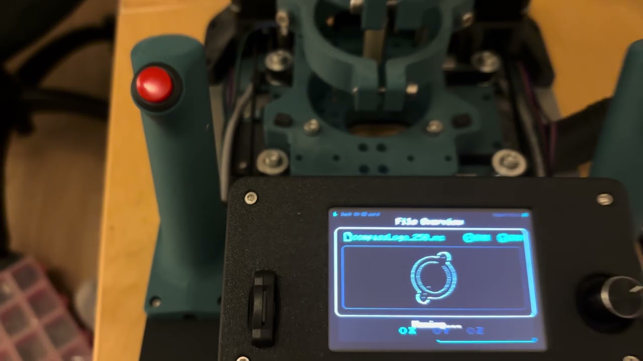

So a long lasting update, sorry, been busy with a lot of stuff. But I build a new display setup and today I did a giant overhaul for its UI. Added a lot of nice to haves as well!
Hey nice. Do you have the code on GitHub? wold love to see how you have done it. Because i am about to make my UI now as well. Does it still run on a Teensy?
OMG
Amazing work !!
Do you need another BETATESTER ?
What must i buy and print new parts ?
Awesome work. Is it the same Hardware just different screen?
I would also be interested to test your UI.
Great work! I’m starting a Compass build these days. Would love to implement this display solution. Do you have it uploaded to GitHub yet?
