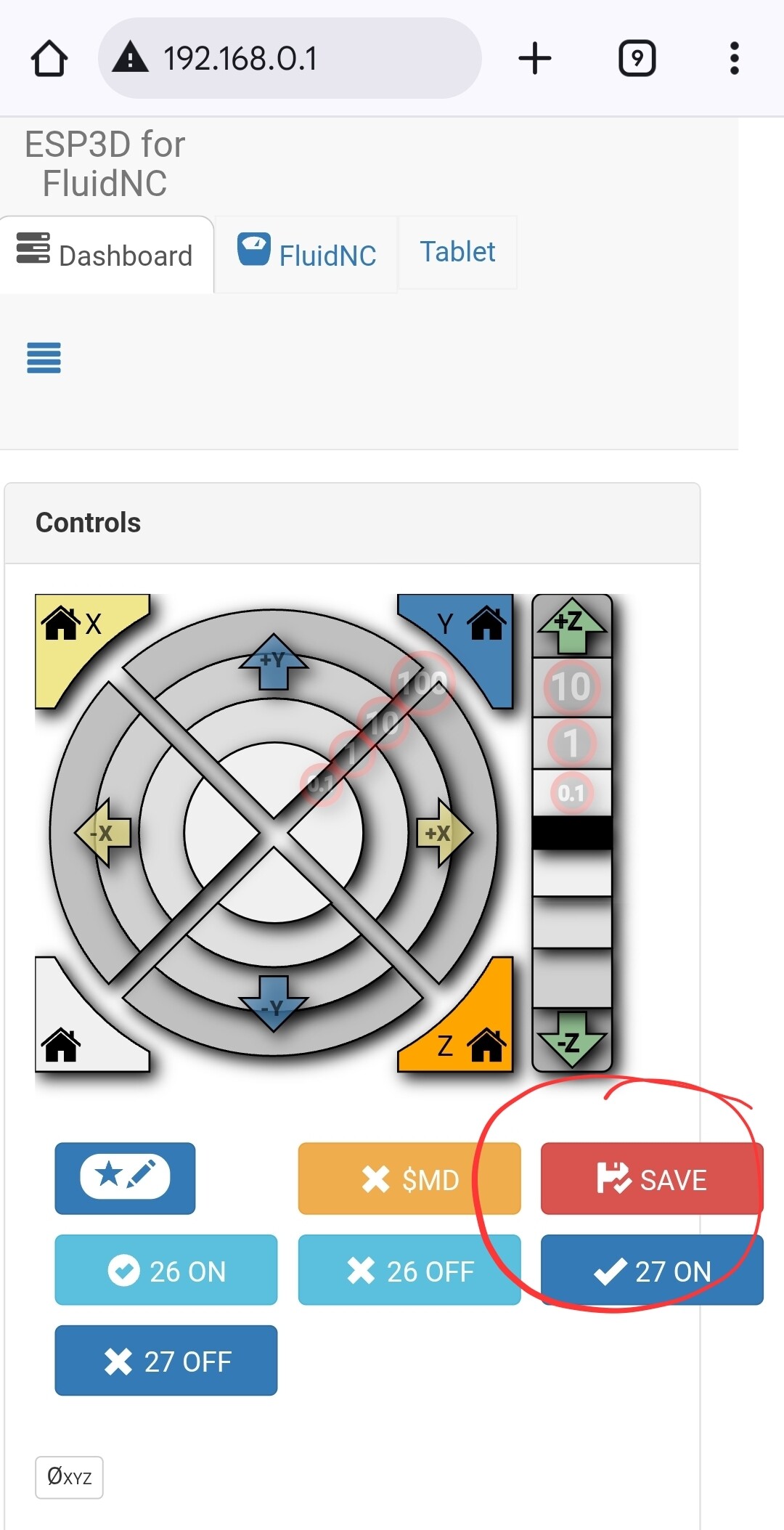

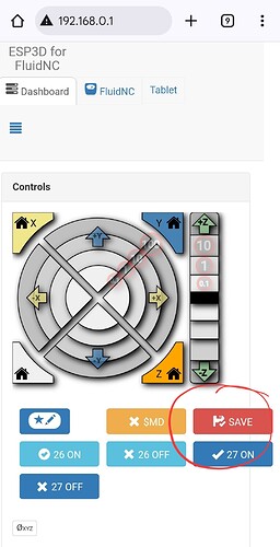

I tried to increase the homing amps ever so slightly to see if it made a difference, but it doesnt seem to save and as soon as i come off the config page and back into it on the web ui it reverts back to the default.
You need to use the ‘save’ macro to save to save any changes or edit and replace config.yaml
Suspending the hose and power from above is bit of a challenge, because you will need enough slack to be able to reach all four corners of the usable area without having excess slack when everything is in the center. Some kind of retracting spring might work, but…
My suggestion was to only do this temporarily, to see if it was causing the issue. Something a simple as tying a rope to a screw hook in the ceiling, or constructing a makeshift tripod, anything just to hold the hose above the gantry with the core placed at each end of the X axis (without having to move along the Y axis at all).
Once you determine if that is the source of the problem, then you can re-position the hose along the gantry hooks to ensure that nothing is adding pressure to the core.
I was clicking this after editing and still nothing saved?
Have you changed the name of your config.yaml by any chance? Clicking that macro will save current settings to config.yaml - if you’re using another file name it won’t do anything (ask me how I know :grin: )

I hadnt, anyways, i got it to save, no i wasnt forgetting there was z motor 0 and z motor 1 and reading different ones each time :sweat_smile: i definatley didnt do :face_with_peeking_eye:

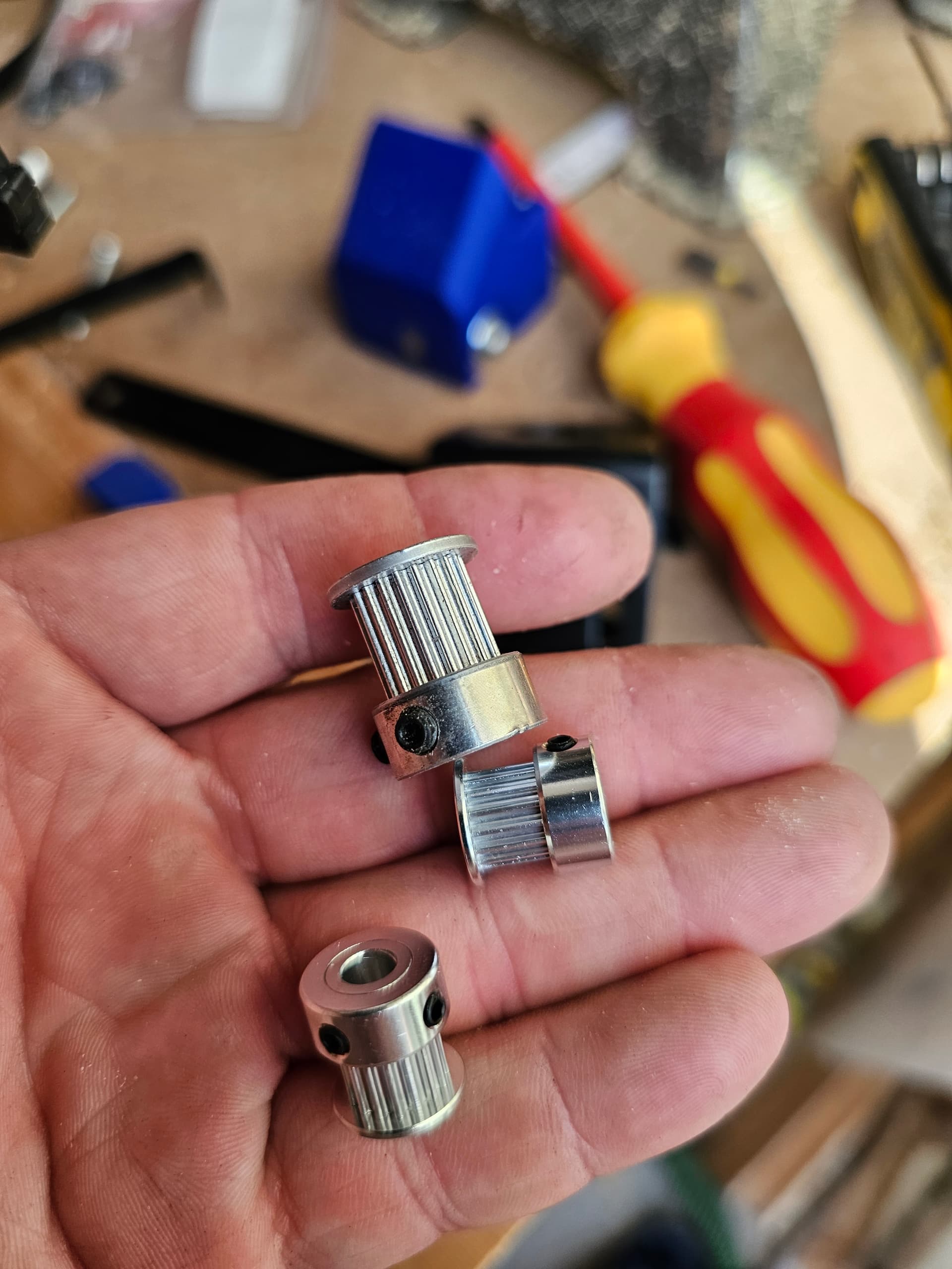

So i ordered the 16 tooth 10mm wide belt pulleys last night off amazon, or so i thought i did.
They arrived today…anyone spot the problem…
Also, its a bit of a pig sometimes trying to swap things out whilst trying not to fully dissasemble the machine :joy:

So i swapped the pulleys, eventually.
I had threadlocked the grub scews on when i intially installed them. Which made it near impossible to undo so off them.

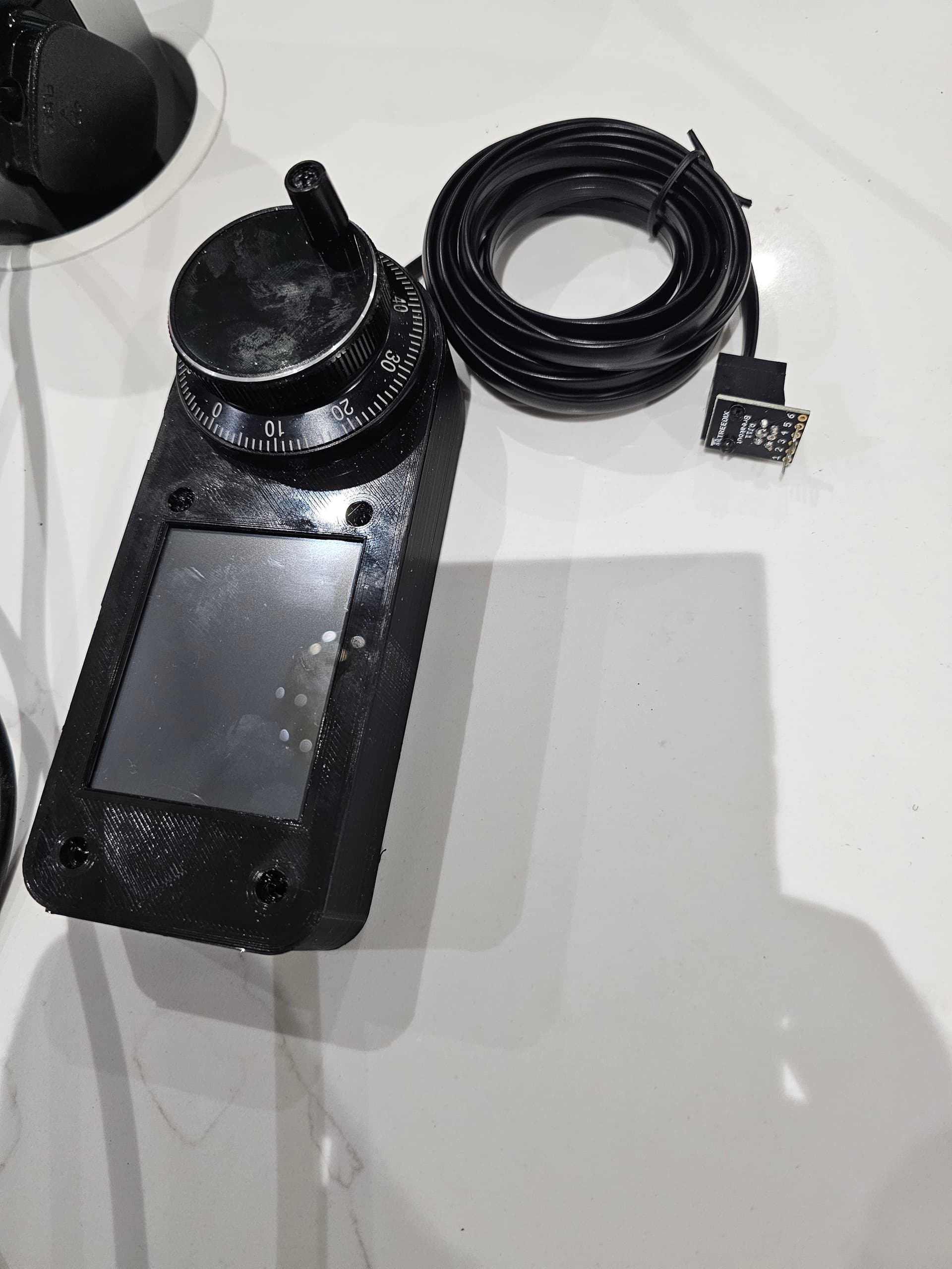

I also made a thing. I dont know if it works yet but i made it…

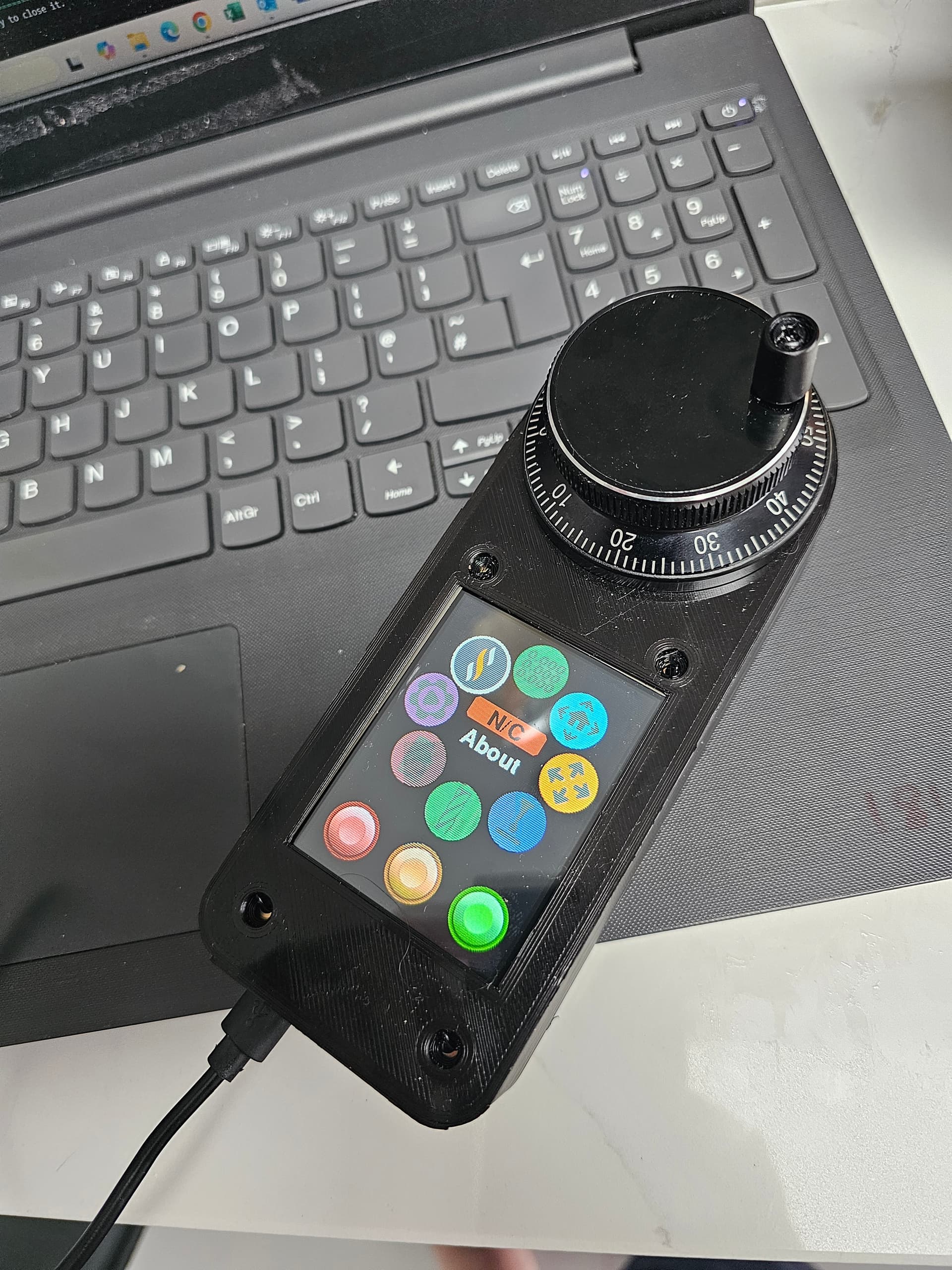

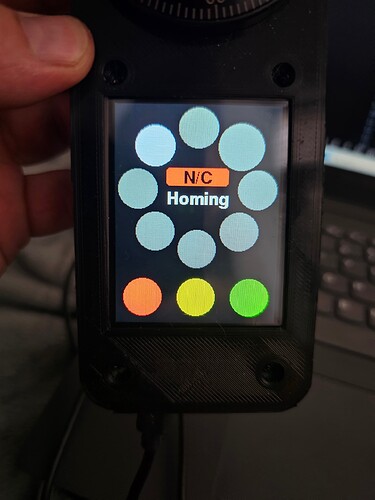

It seems to work the wheel works with the display and the display touchscreen seems to operate how it should.

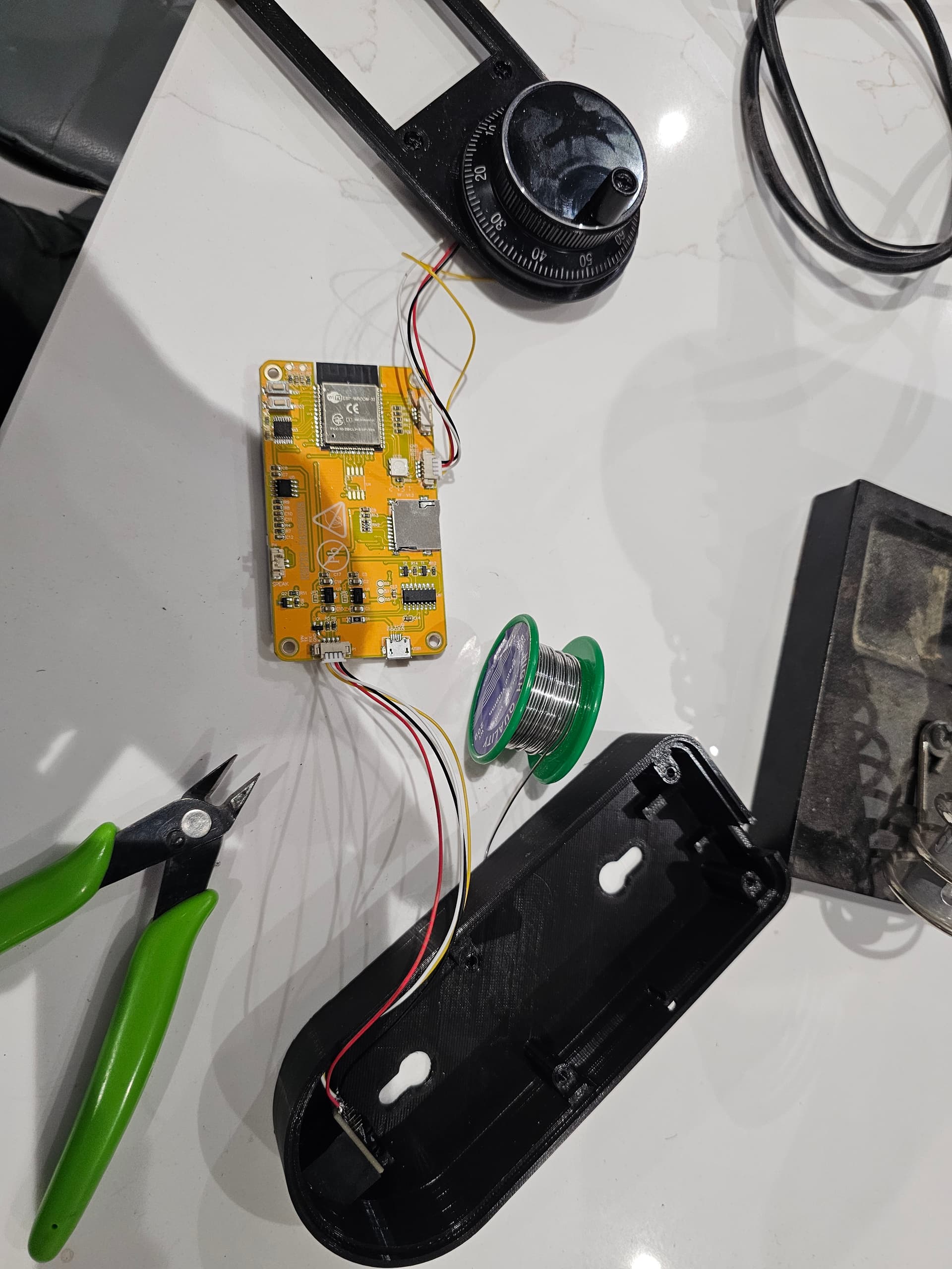

It was a pain trying to upload the firmaware to the screen as i have zero experience using vscode or platform io. There was also a problem with the icons when i uploaded the build, However a little assistance and troubleshooting with Chat GPT we got there.
Has anyone done one else built the fluid wheel with the Lr4 and jackpot board? I read somehwere about it blowing the esp32 chip when connecting and disconnecting the controller, is this right, is there any do’s and don’ts?
Plenty of us.

An FYI for future reference, you don’t need vscode anymore. Joaquim has added the FluidDial installer to the Webinstaller. https://installer.fluidnc.com/
I have made 3 of them so far. I have cut the second pin on the RJ11 Breakout just to insure it doesn’t get any power from the vmot on the Jackpot.
