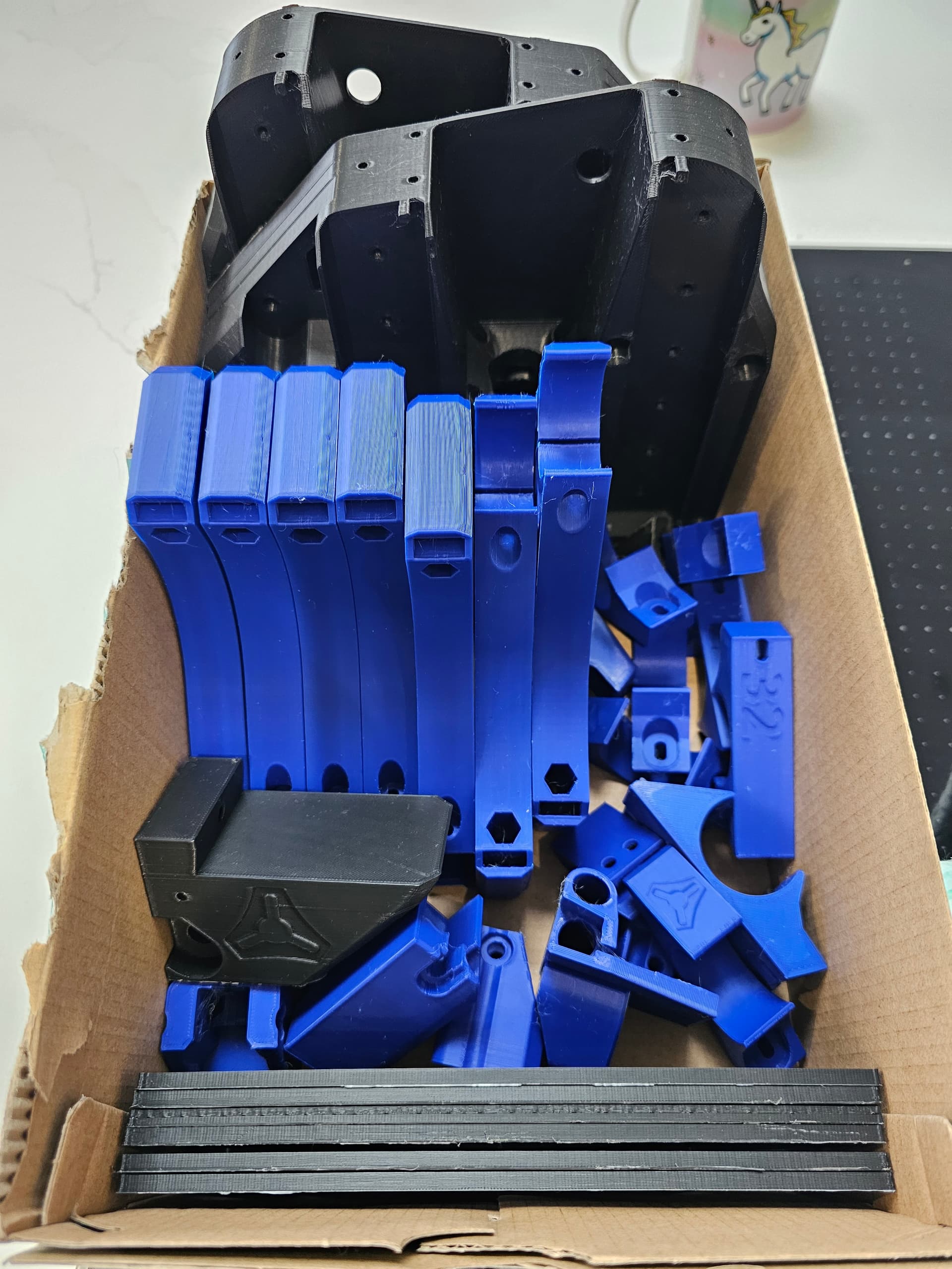

First time builder, currently in the process of printing the parts for the Lowrider V4.
Had an Ender 3 pro since the first COVID lockdown but haven’t used it for the past 3 years.
Spend first few days (in the spare couple of hours i had in the evenings) calibrating and trying to dial the prints in.
Printed Z nuts with success first and then tried the back wheel min although sucessfull, i slowed the print settings down due to the amount of artificats being left in the print.
Working up in size/ print duration and i’m now 60% through the YZ plate max which has a 24hr print time for me.

The last print turned out really well, this was even on draft qualtiy at 0.28mm layer height.
Unfortunalty prints have been on hold since this finished as ive a busy few days ahead with work.

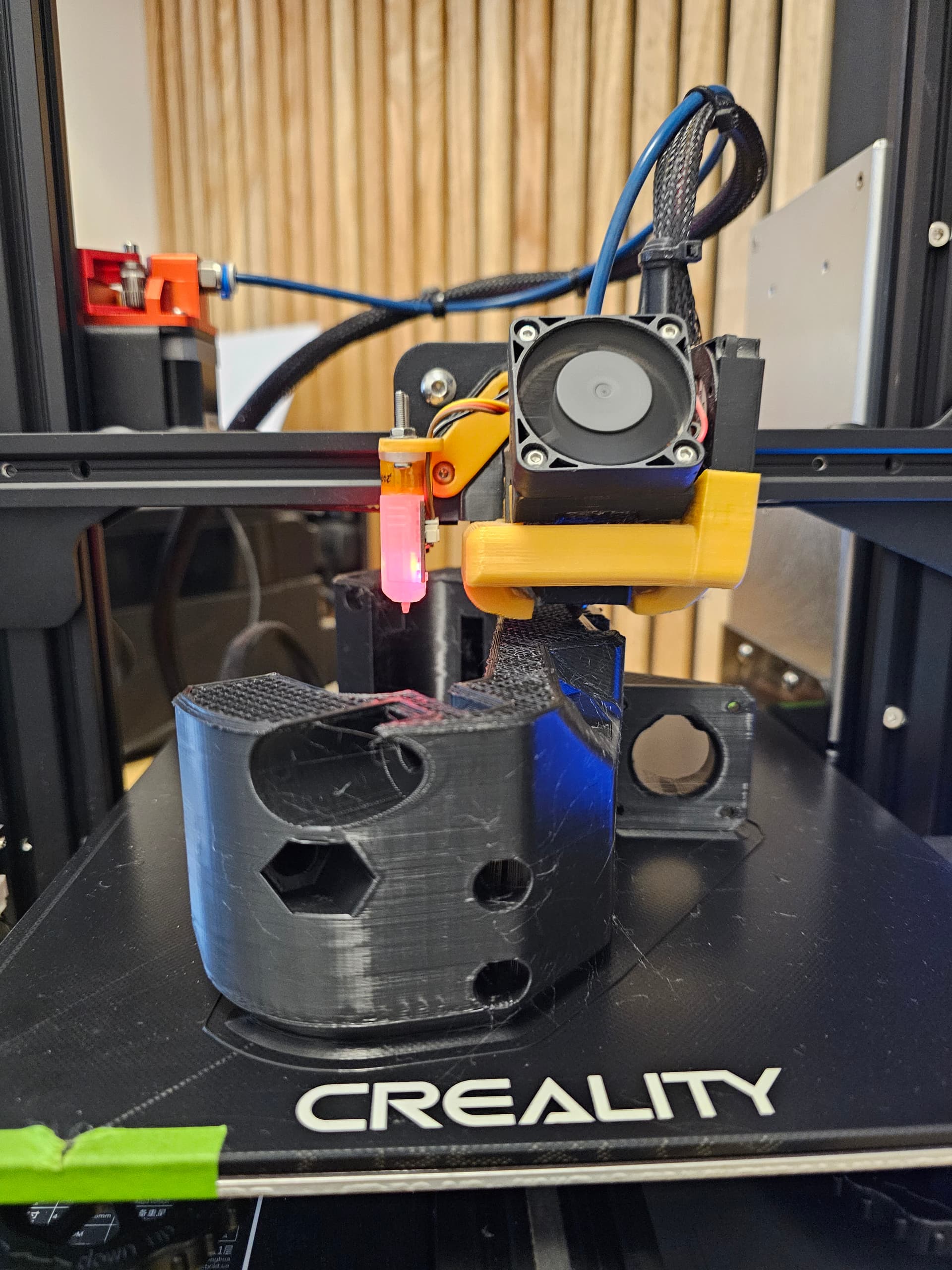

Every 3d printer persons 2nd worst nightmare,
Woke up this morning to check how the core was getting on and it was printing in mid aid.
Stopped the print and kept the bed heated whilst scrolling youtube for a fix
Anyway after watching a couple of videos and editing the gcode file to resume print on layer 61.53… it seems to have worked, other than a little bit of layer squish on the resumed layer… i think i have saved it!!!
