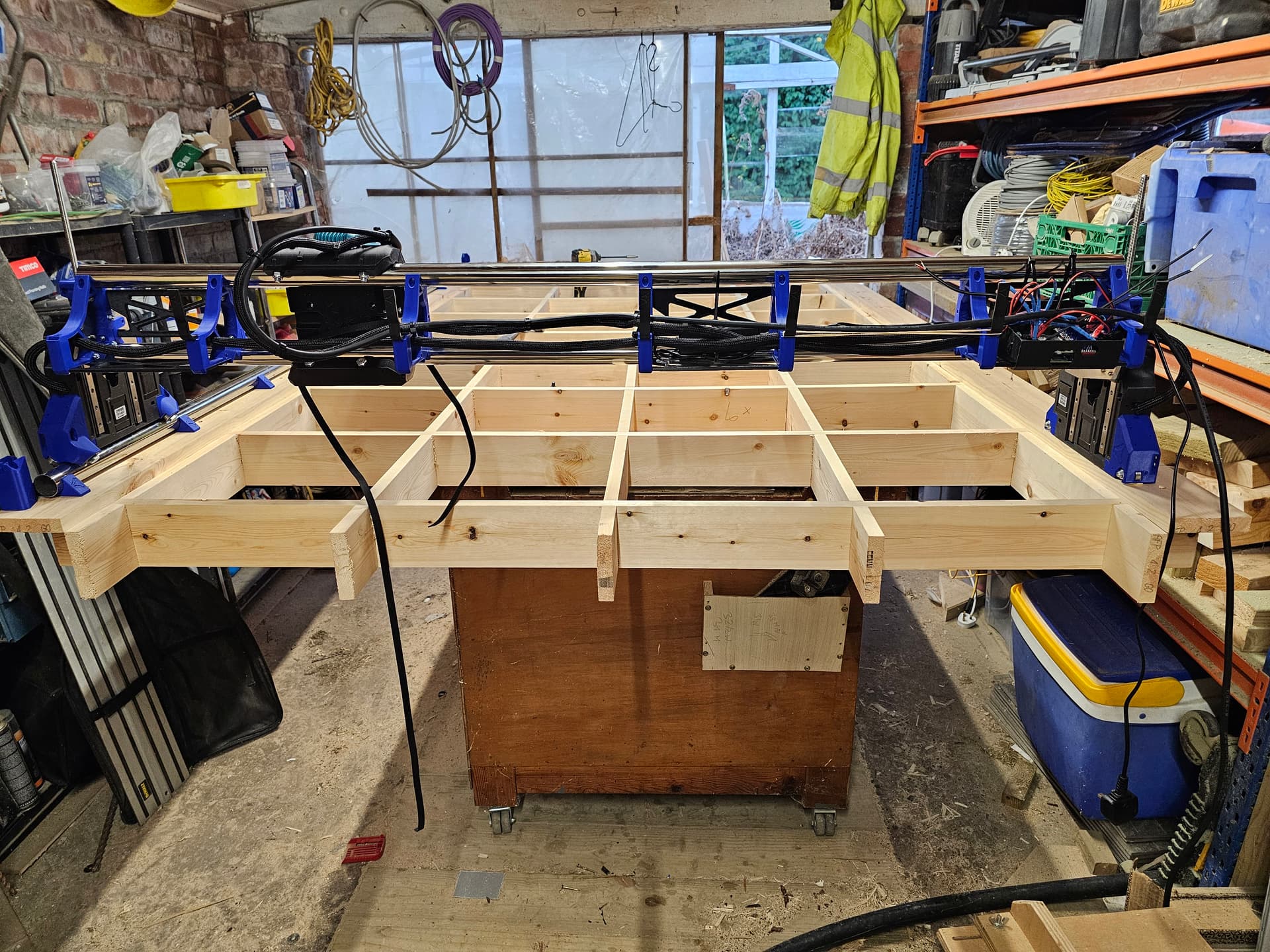

The build is really starting to take shape now, still waiting on 2 more linear rails turning up from amazon. Once here i will tranfer to the garage where i have already mounted the Y rail to the table
When i extended the cables to the board from tbe YZ plate, i didnt quite leave enough to route them correctly, was trying to avoid having loads of slack at the board. Im hoping that once i cut the strut plate and the braces are more evenly spaced i can moved the board box closer and fix my problem.
Looks great so far! Using it is a lot of fun. :slight_smile:
The top rail seems to stick out by 0.5mm though, make sure that it isn’t the case with the bottom one or the whole LR will be crooked.
Thanks i cant wait. Yeh i notice that and will double check everything when i transfer it to its table.

Hey, nice to hear that the machine is moving, but is that tree pine or spruce? Based on my own experience, I would recommend something harder where the bearing presses on the wood. E.g. mdf.
MDF density 800kg/m³
Pine density 370-550kg/m³
Spruce density 300-470kg/m³
Cheers man, its Redwood, but ill probably swap it out for some MDF having seen your image.

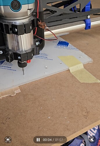

So I finally got round to finding time to square the machine up and do a test cut.
i was going to cut the strut plates out of the Perspex however the offcut i picked up wasnt big enough.

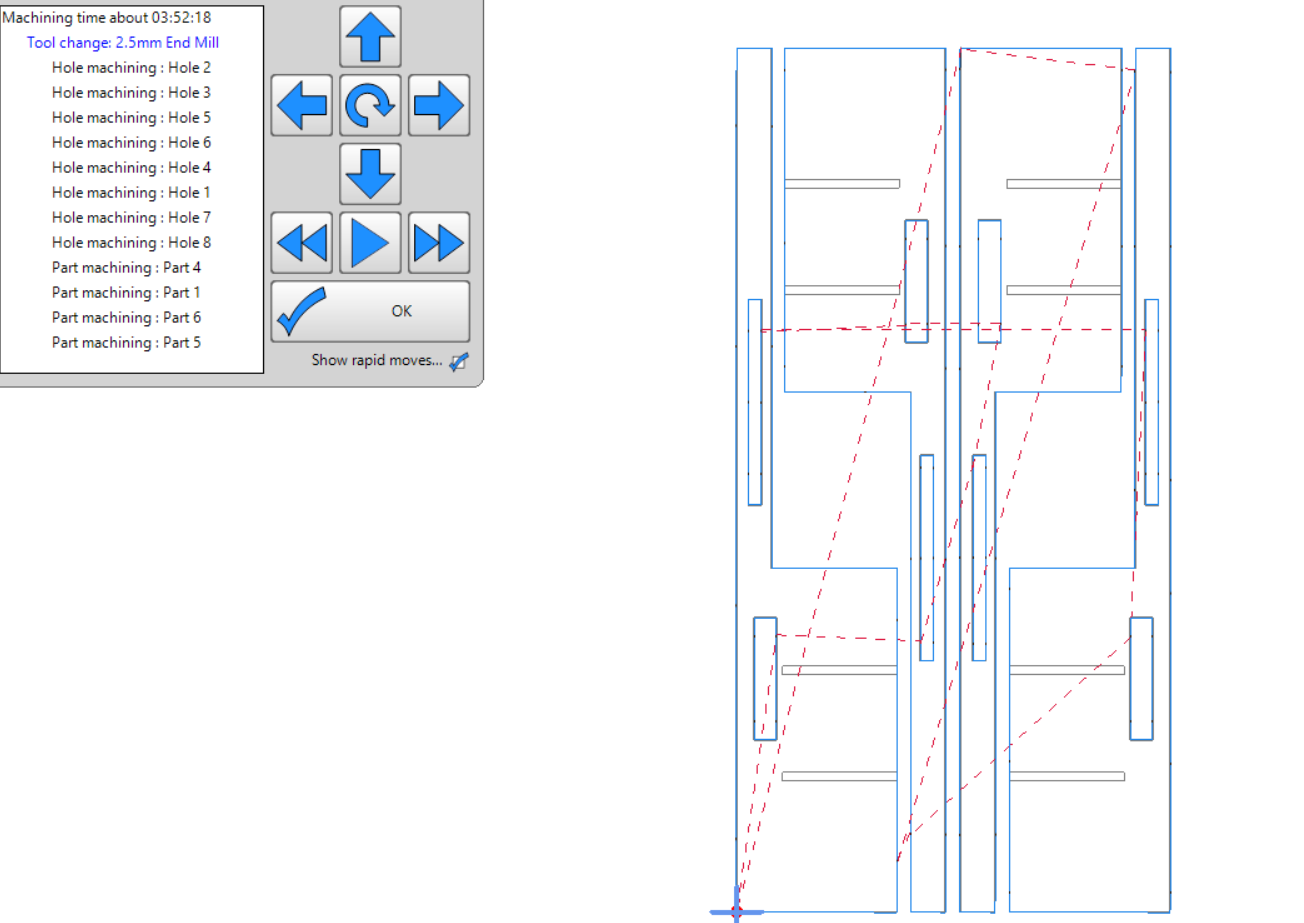

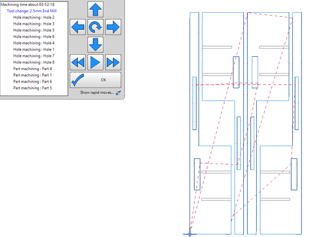

once those are cut i plan on running a sheet of ply through it cutting theses components out. its approx 1800 x 900 in total size and estlcam say about 4 hours to cut. is that right? seems a long time for what it is.
is there a way of getting the times down, obviously I understand it may take some playing around until I get used to feeds and speed but realistically what can I expect. these are all full depth cuts through 18mm cutting at 1mm depth per pass.
I would not do all of that at once until you have a little more time under your belt.
To speed up your times unfortunately you need to do test cuts. Slow tool RPM, increase your depth of cut slowly until you get to at least one diameter deep, then keep increasing your feedrate until you need to back down a touch.
4 hours is too much, but 18mm is very thick, so it will be a little tricky, make sure you are using a single flute endmill. I would guess that should be around an hour or less.
so i cut the strut plates as per the generated file, and only when cutting the tabs i realised its way longer than needed, i re generated the file but before printing decided to check that when i move the cnc on the webUI 100mm it actually moves 100mm, but it doesnt, its more like 120mm
how do i sort this
That means you bought 20T pulleys instead of the 16t that are specified.
You need to change the X and Y stepper steps per mm in the firmware by 20%. On the jackpot you just go into the config, make them 20% less, save and reboot.
