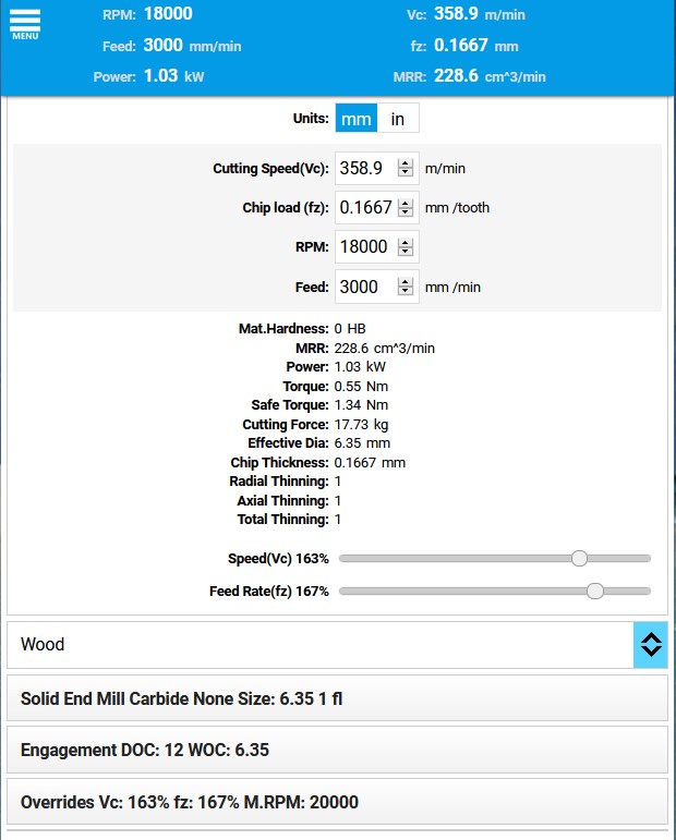

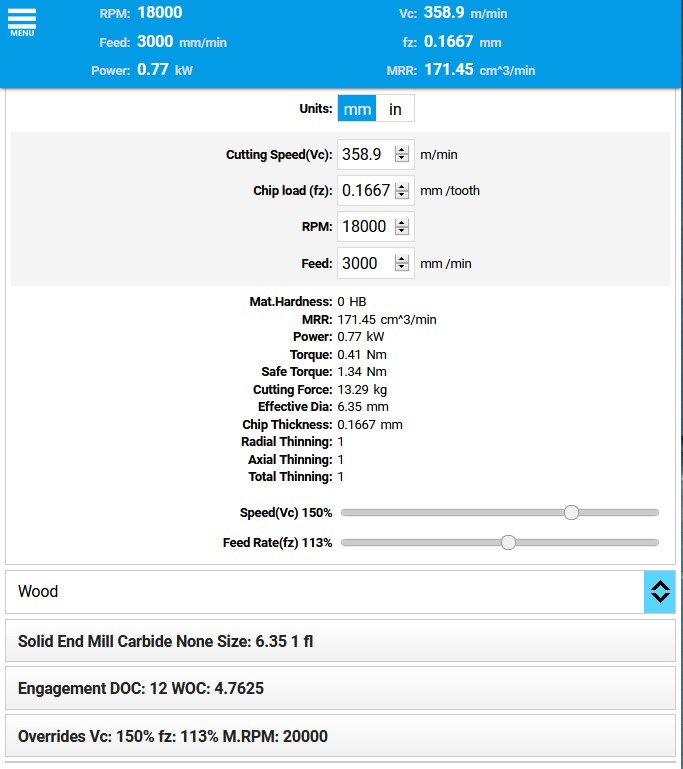

75% stepover
Slotting
The cutting forces are higher than expected

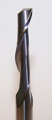

Can I ask what type of single flute 1/4" mill you use? The one I’ve been using is clogging and charring. It’s somehow a different shape than the 1/8s you sell.
Let me check it was a random(expensive) purchase that has been sitting in the drawer for a while for me to get up the nerve to use it.
onstrud 65-023
Now you have to find a cheaper one and tell us if it is any worse.

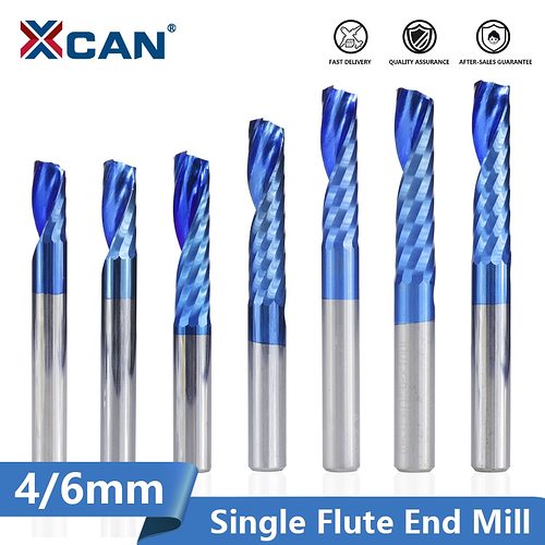

Anyone have some links for some inexpensive 1/4" single flutes?
OLIVER TOOL COMPANY | eBay Stores :rofl:
Dang they are all just expensive. I have a two flute here as well. I could try that and just lower the RPM a bit to see how it goes, they look much less expensive.
If you were to pick one of these, which would you prefer?
Here is a batch of ten for under $4 each.
