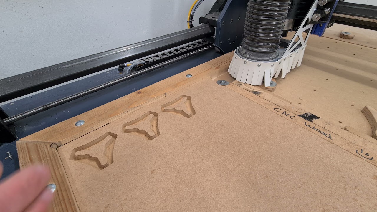

Firstly, a big thank you to Ryan for being a good sport and inviting me to play with the V1 Engineering lot! I hope we can have some friendly competition here.
About my results - I made a rookie error and added a work offset, so I cut 13mm deep instead of 12mm. the width didn’t turn out great (you’ll see in the video) - but my next one will have a clean up pass.
Total machining time = 01.48 (mm:ss)

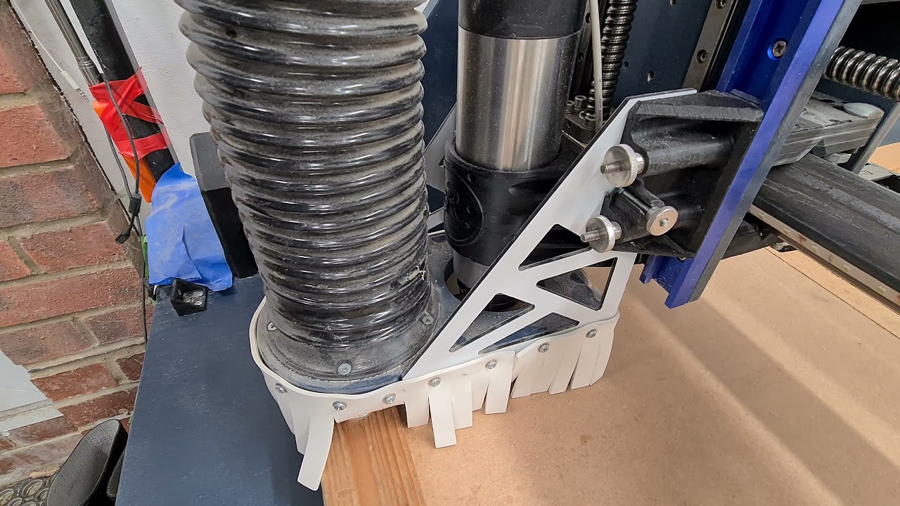

(I want a vacuum that knocks the dust off the filter, FANCY!?!)
It gives you a heart attack when you don’t realise its going to clean itself! it sounds like its distorting itself.
Here is my final entry for tonight:
Total time 01:36 (mm:ss)
I think a bigger bit is needed to bring the time down.

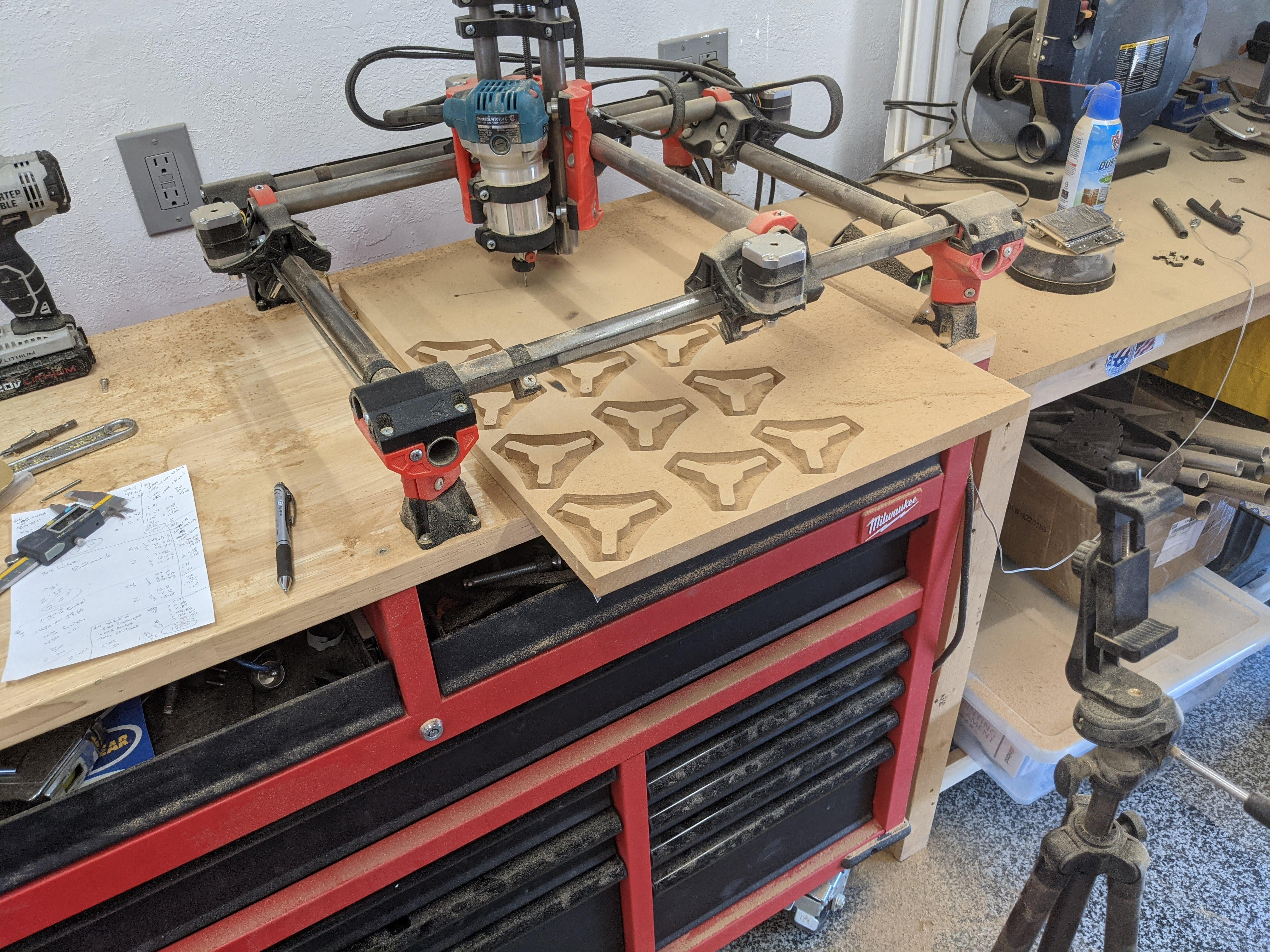

Okay people, I am going for another run.
In ESTLCAM if you choose, edit, machine order, automatic, Optimize, it really shaves off a bunch of time in travel moves.
On top of that I manually edited out the two Z hops it kept in for the finishing pass and shaved off a couple more.
OMG!!! 1 more 1/8" and I will upload a video I put on a fresh endmill. :stuck_out_tongue_closed_eyes:
Okay
1:21, 1/8" endmill, I am pretty happy with it. Starting to make some noise so I think there is not too much more to eek out. (I know, I know…I should break something to prove it.

100mm_drag_racer1828 modified.zip (1.9 KB)
I modified the gcode to get rid of the first set of finishing passes (the ones after roughing, before the actual finishing passes), got rid of two extra Z hops. Super fun gcode to modify I just edit the first numbers to say where to start, and then find/replace the roughing and finishing numbers.

First run with a 1/4"…1:07!!! @20mm/s 12mm DOC.
Max deviation 0.38mm…not amazing but okay.
Here goes a few more tries.
30mm/s…50 Seconds.
Shoving some food in my face then another run or two!
Okay, 40mm/s no problem, ~:45 seconds
50mm/s, the firmware limit ~:40 seconds…Well crap. Now what?!? Full depth (12mm), in MDF, 75% stepover, no finishing pass, still within 0.4mm deviation or less, with a single flute 1/4" endmill. The only way to go faster is re-gear, 20T pulleys.
Running less stepover will not shave more than a second or two off If that.
DANG I maxed out the machine. Trying to let that sink in.
