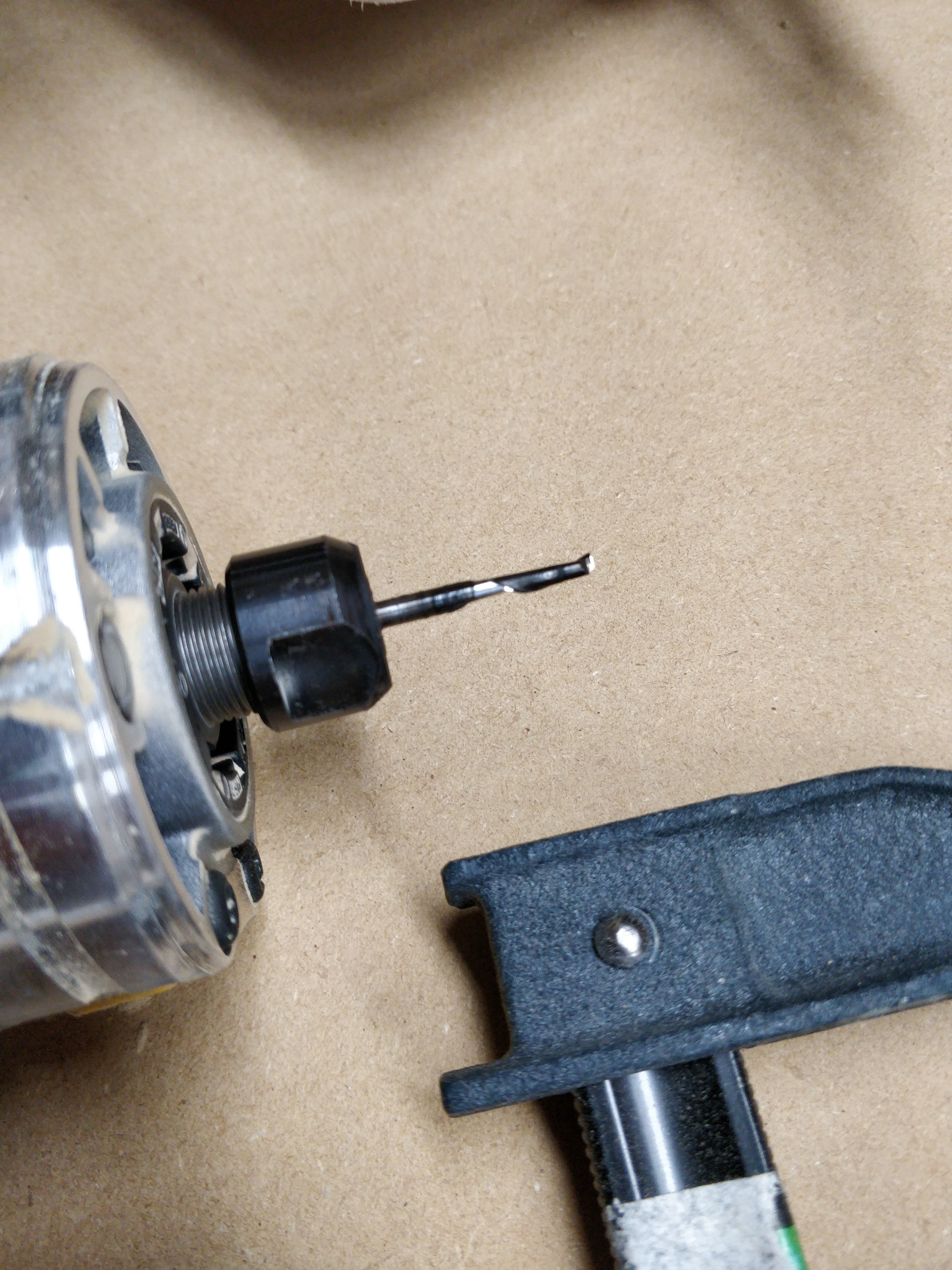

Would you think that we need a 2 or 3 flute mill for this? My single flute doesn’t seem able to keep up at this point.

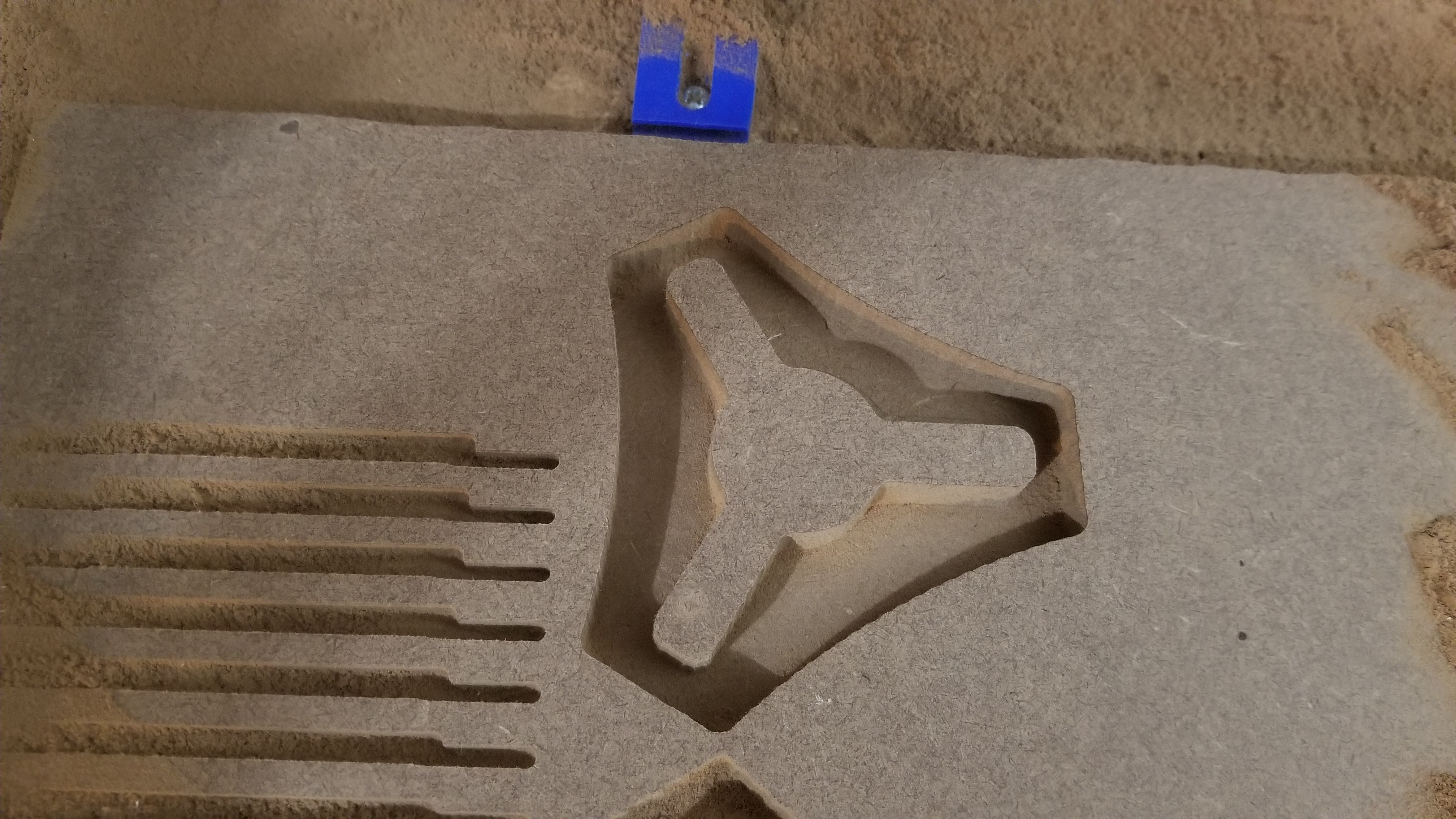

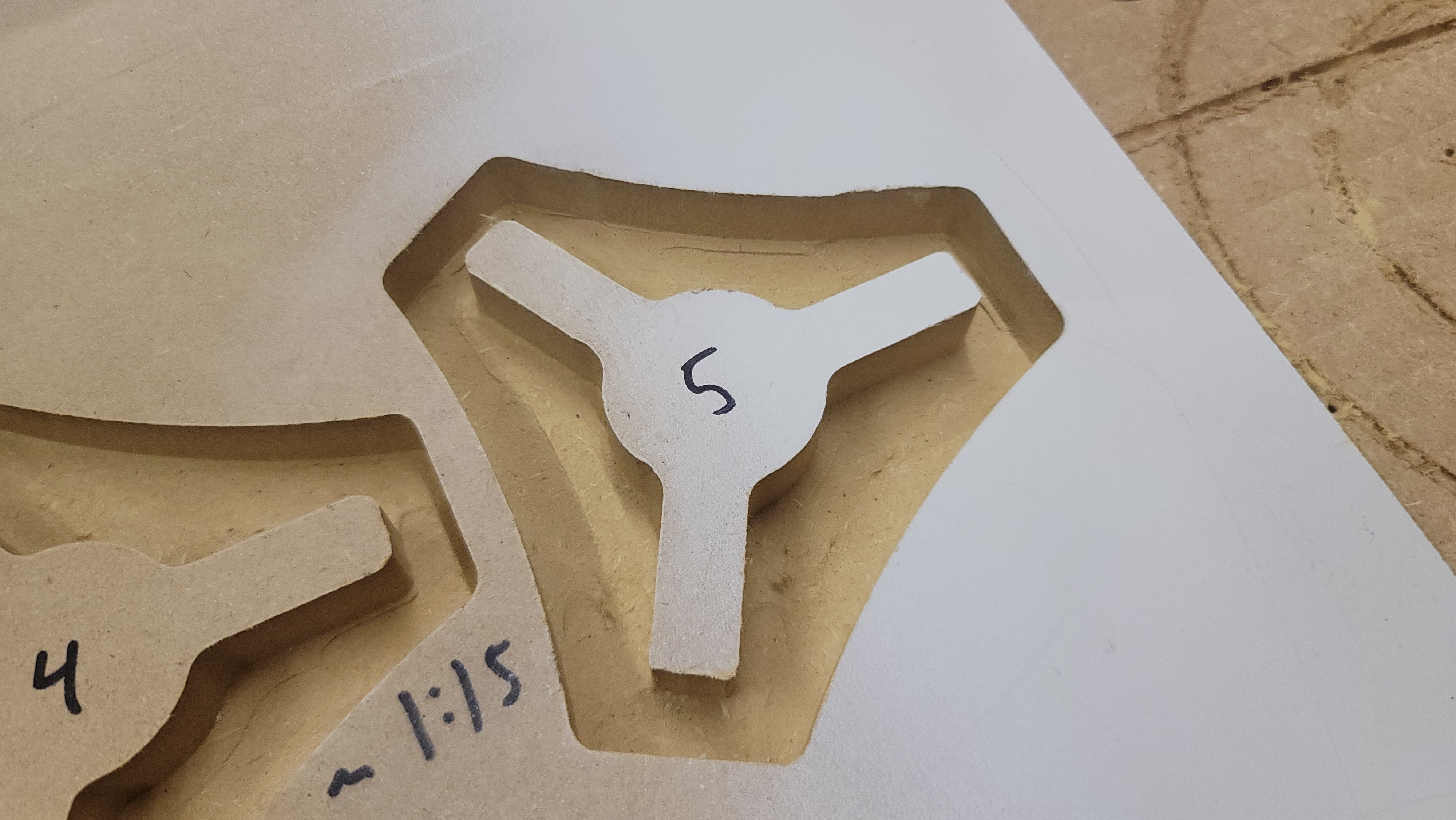

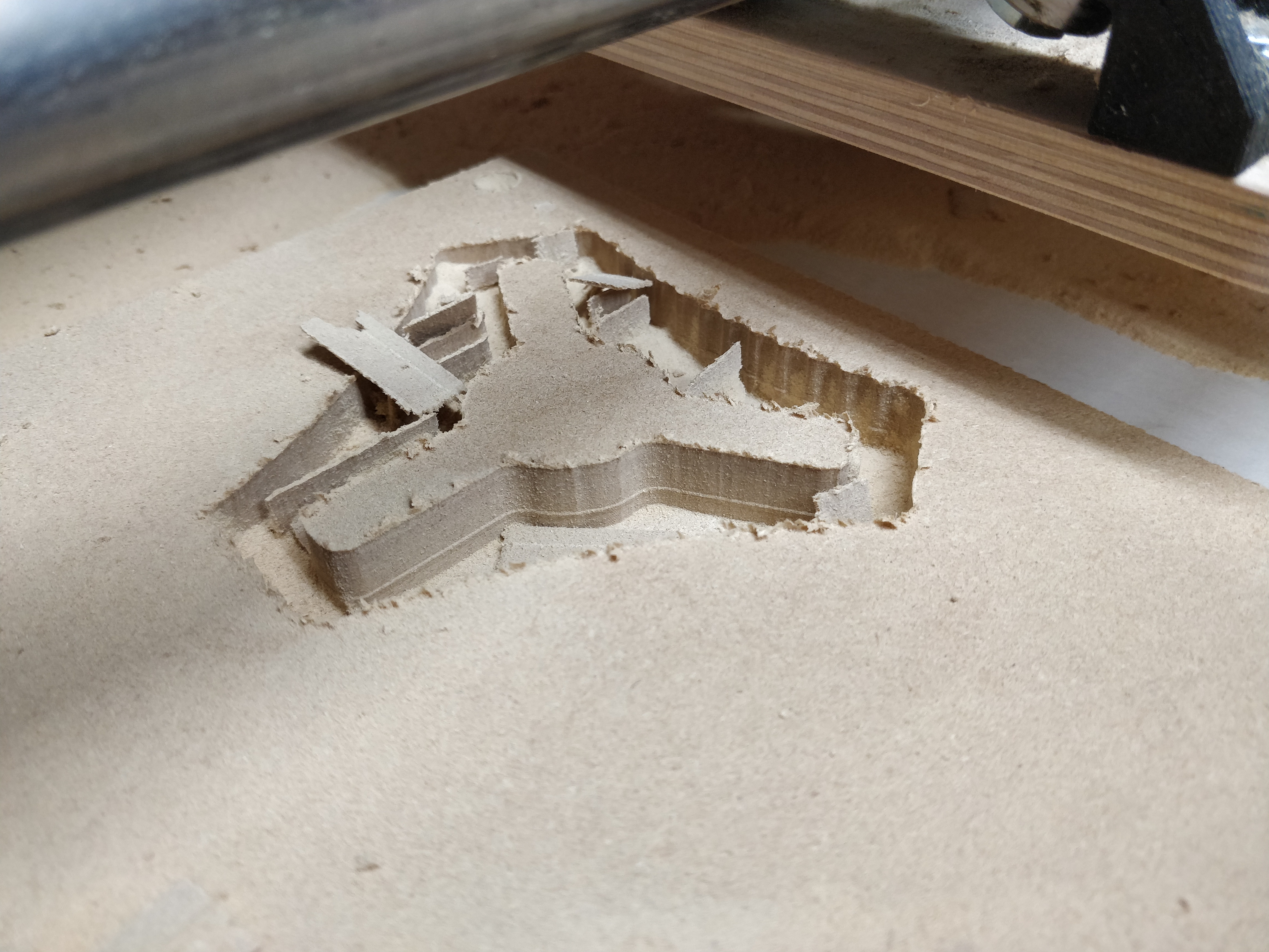

I’m calling this decent at 1:41 with 1/8" bit in the DW660.
There is a bunch of wobble but it mostly cleans up with the finishing pass. Full depth at 2000 mm/min (33.3 mm/s) and stepover about 2.5 mm. I tried higher feedrate and higher stepover but it started to get too rough so I backed off for the full attempt.
I took Steve’s idea and planned the whole job as offset contours. And then I modified the gcode to remove the Z raise and plunge which were unnecessary.

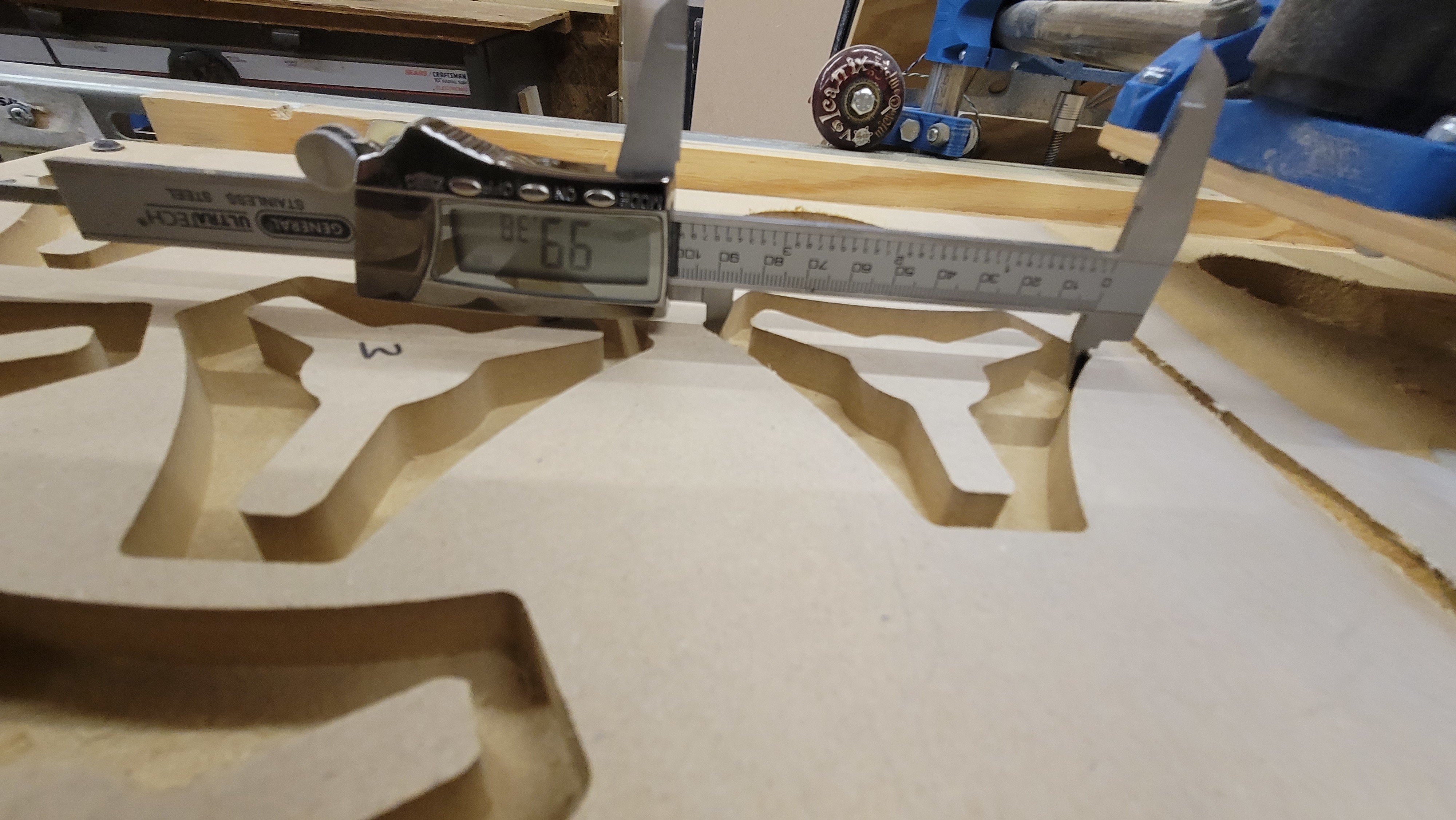

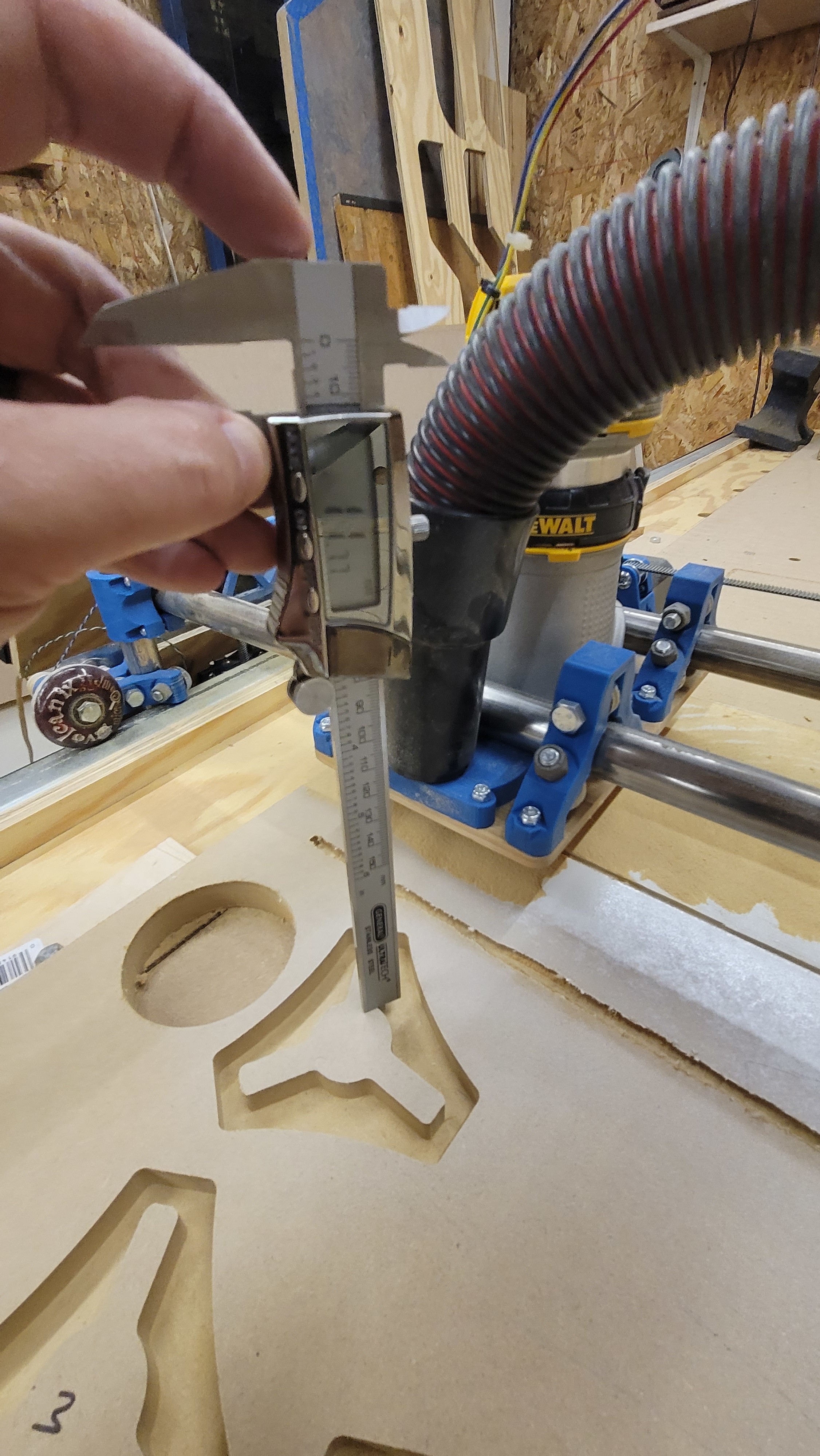

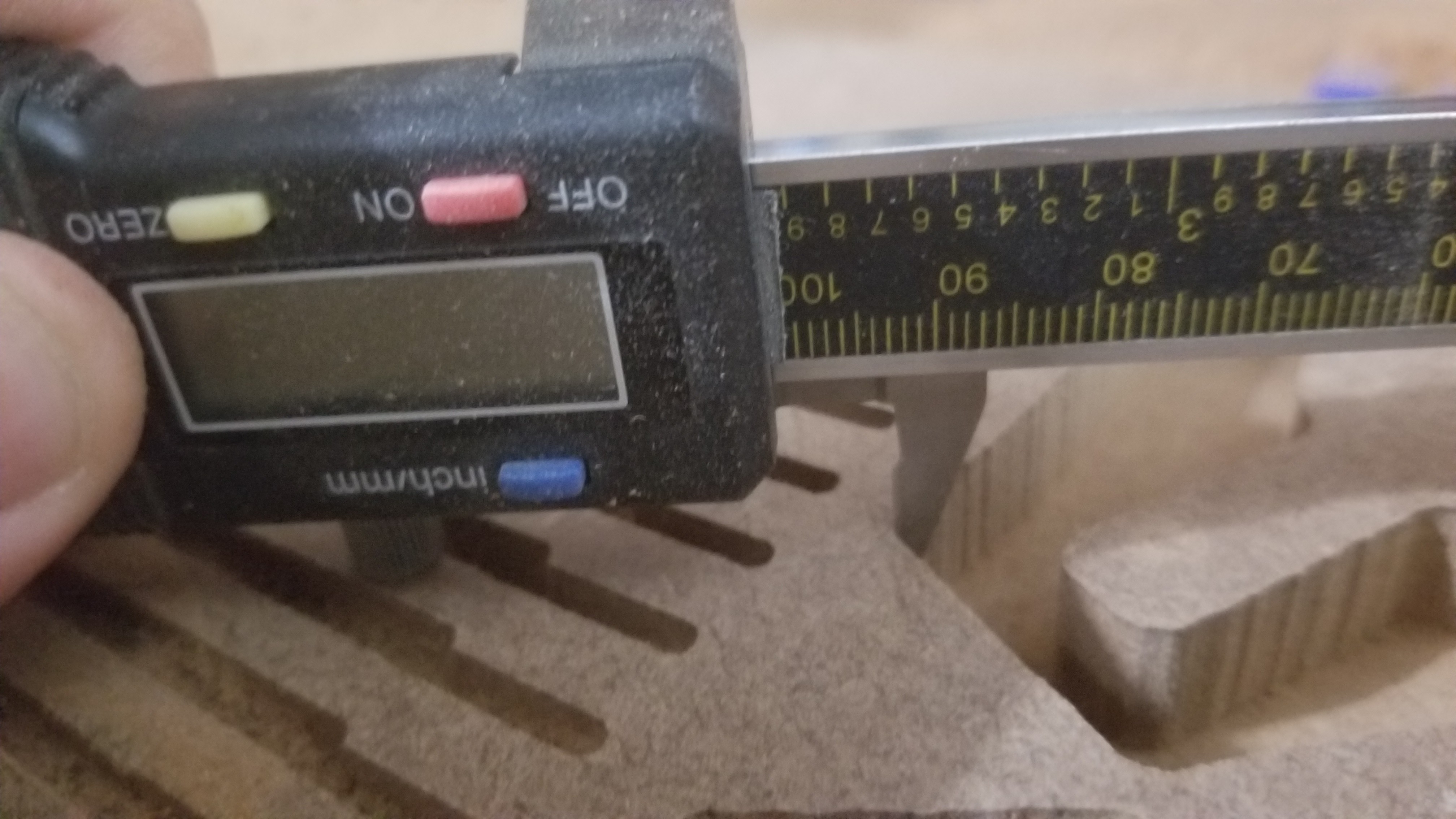

Unfortunately my caliper battery is dead but I am pretty sure the dimensions are close enough to qualify as decent.

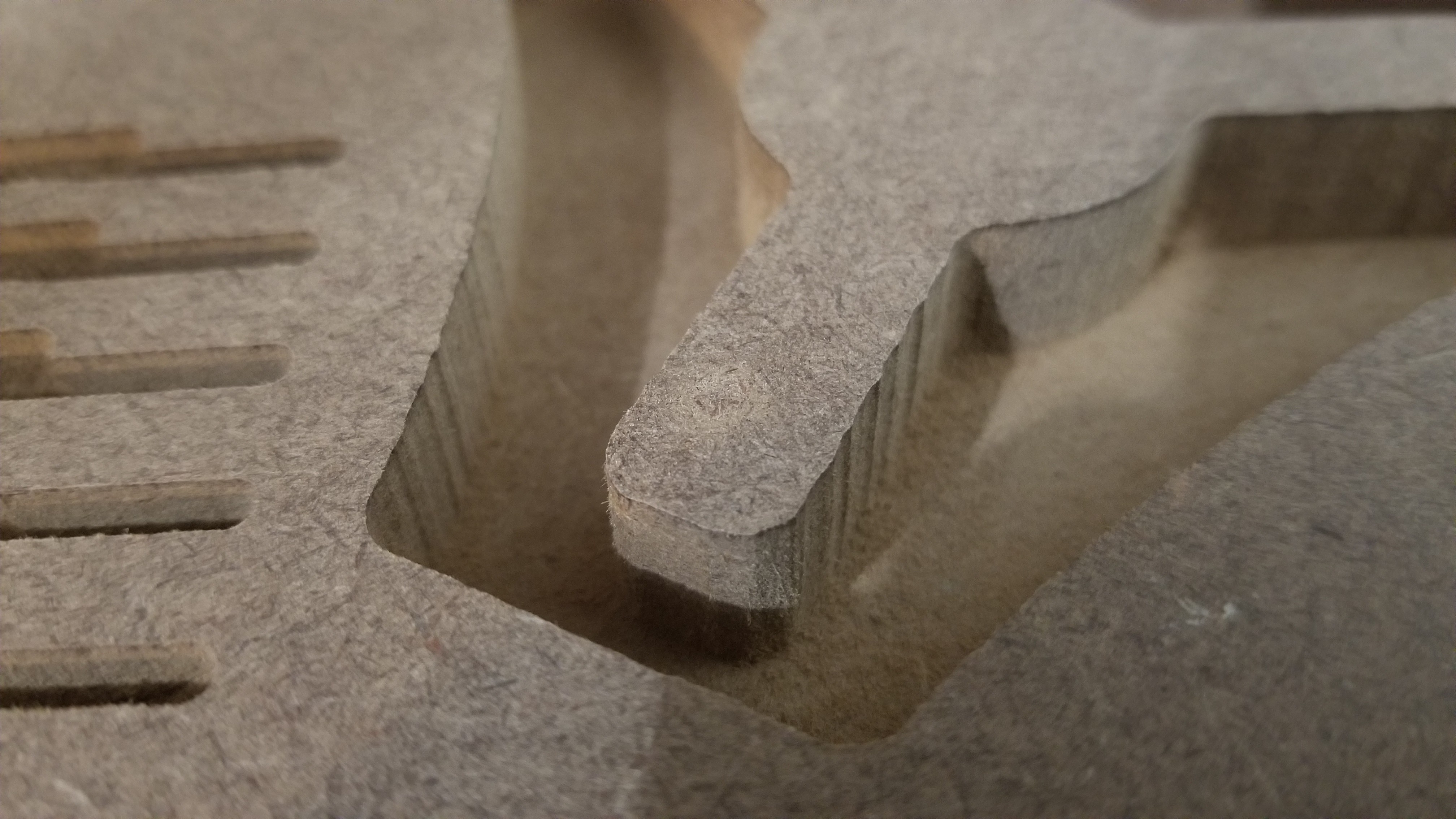

The surface is better in some areas than others…
I had not left an offset for the finishing pass to remove with the assumption that the climb milling would push the tool away from the final edge and that would serve as the finishing allowance. I think when the tool gets to wobbling it can violate this assumption and a bit of finishing allowance could leave a cleaner shape.

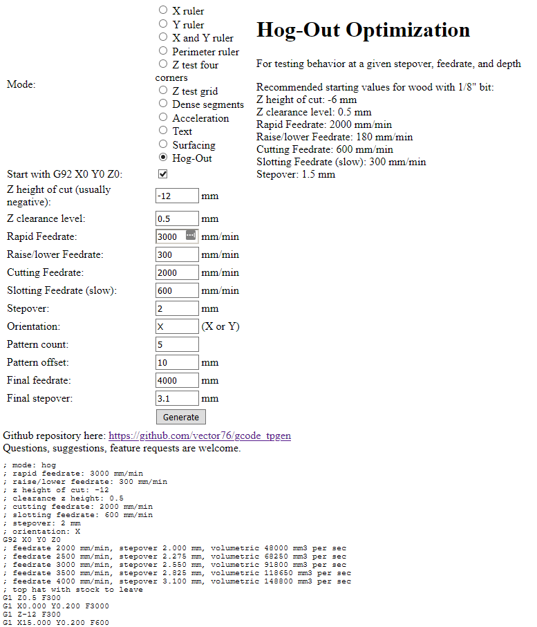

I’ve updated my test pattern generator so you guys can more easily try aggressive combinations without needing a full CAM + upload + workpiece for each attempt.
Here is the link again: https://vector76.github.io/gcode_tpgen/
Here is a sample set of parameters.
Given N patterns (“pattern count”) it will sweep stepover value from “Stepover” to “Final Stepover” and it will also sweep the feedrate from “Cutting Feedrate” to “Final Feedrate”. The slotting feedrate is used to set up the test cut and should be slow to ensure it’s relatively precise.
Mine is a 2 flute.
Awesome!
Me too! Odd wobble, almost looks like it is stalling, and the arcs are slow? Man this is going to be tough to match or even get close too with an 1/8". Is this with the double decker?
Hard to say, a load calc should be checked I suppose. Mine is still making powder so I know I can push harder until I get decent chips so I have not bothered with checking. More flutes mean less chip evacuation ability though so it is a balance.

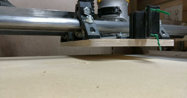

…done. Yeah it is a 24x24x6.
Ultimately if the motor has the torque and the gantry can handle it, going up from 1 to 2 flutes can allow doubling feed rate (half the chip load). At these feeds the flutes are getting pretty full even with 2, so 1 flute probably won’t be very competitive.
What you don’t want to do is go up flutes if your chip loading is already low.
Dude, that is really good for 1/8!
I used a 3-flute but it does not have very good chip clearance (shallow channels). That is why it smoked during the straight down plunges. My favorite 1/4" 2-flute upcut endmill has deep grooves for excellent clearance. I didn’t use it for this race because it is quite long, and I would be sad to see it broken.

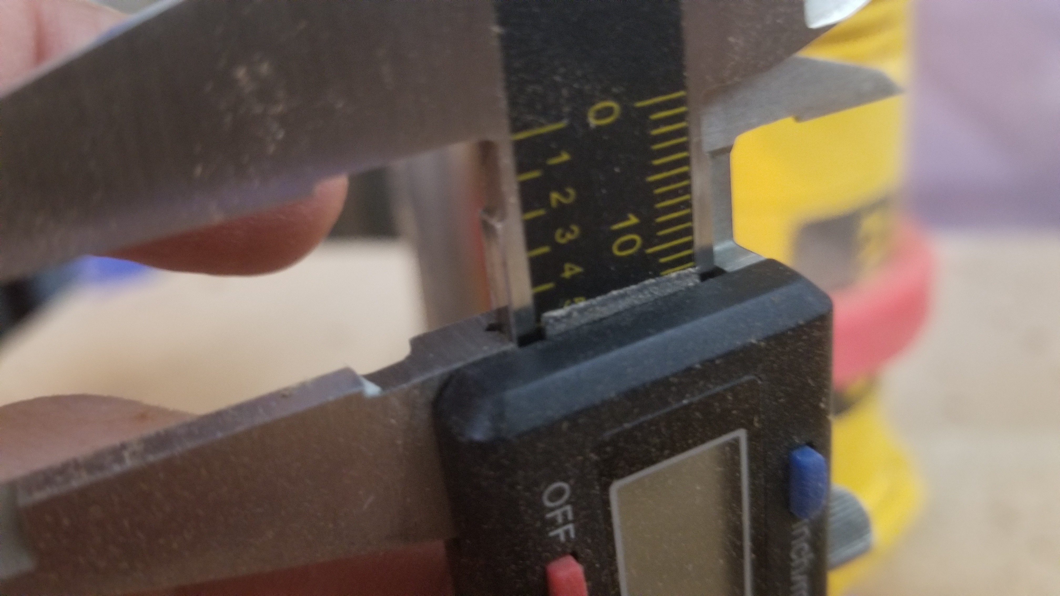

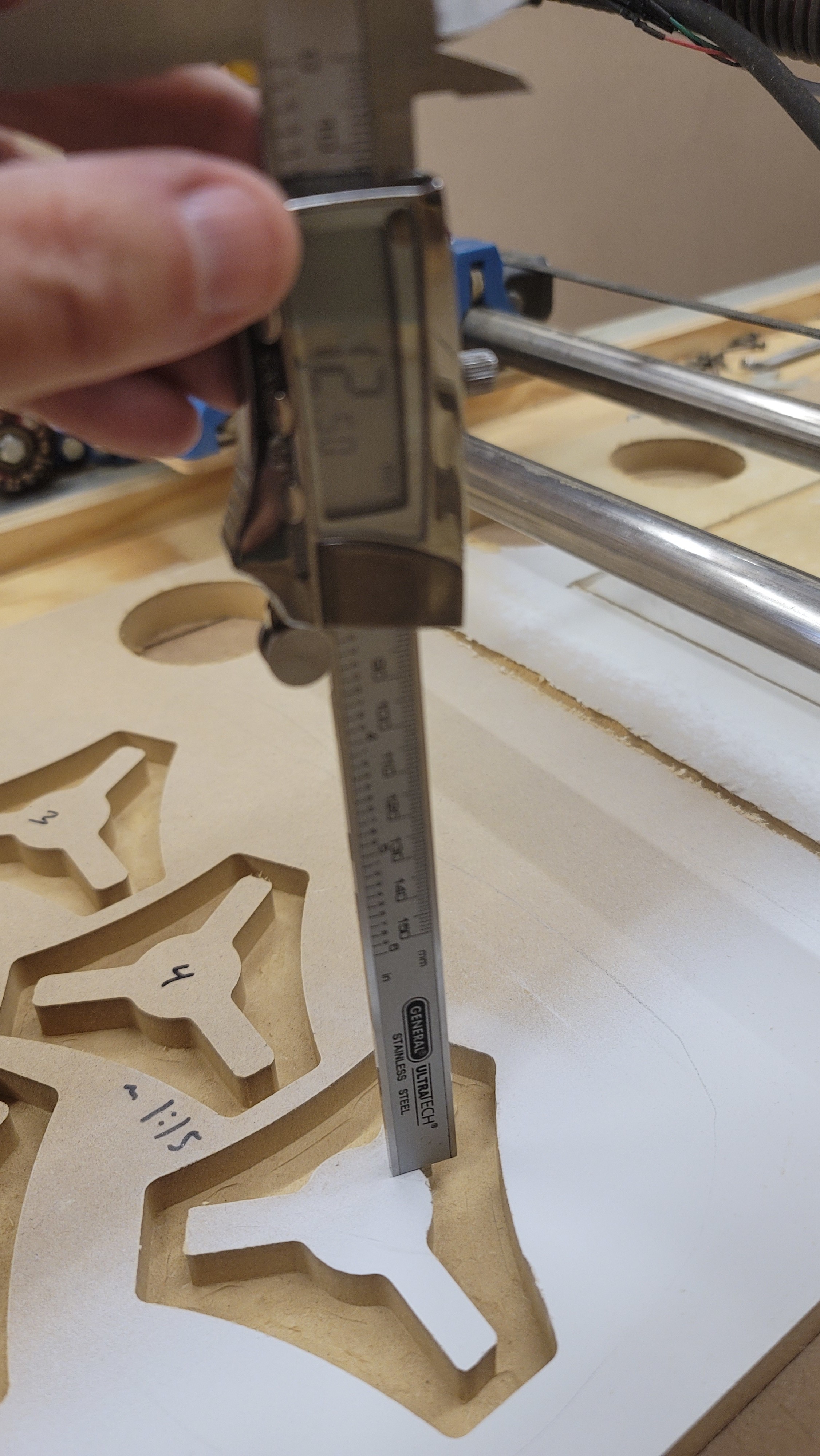

99mm
12.5mm
The bottom is pretty rough too. It was definitely deflecting.

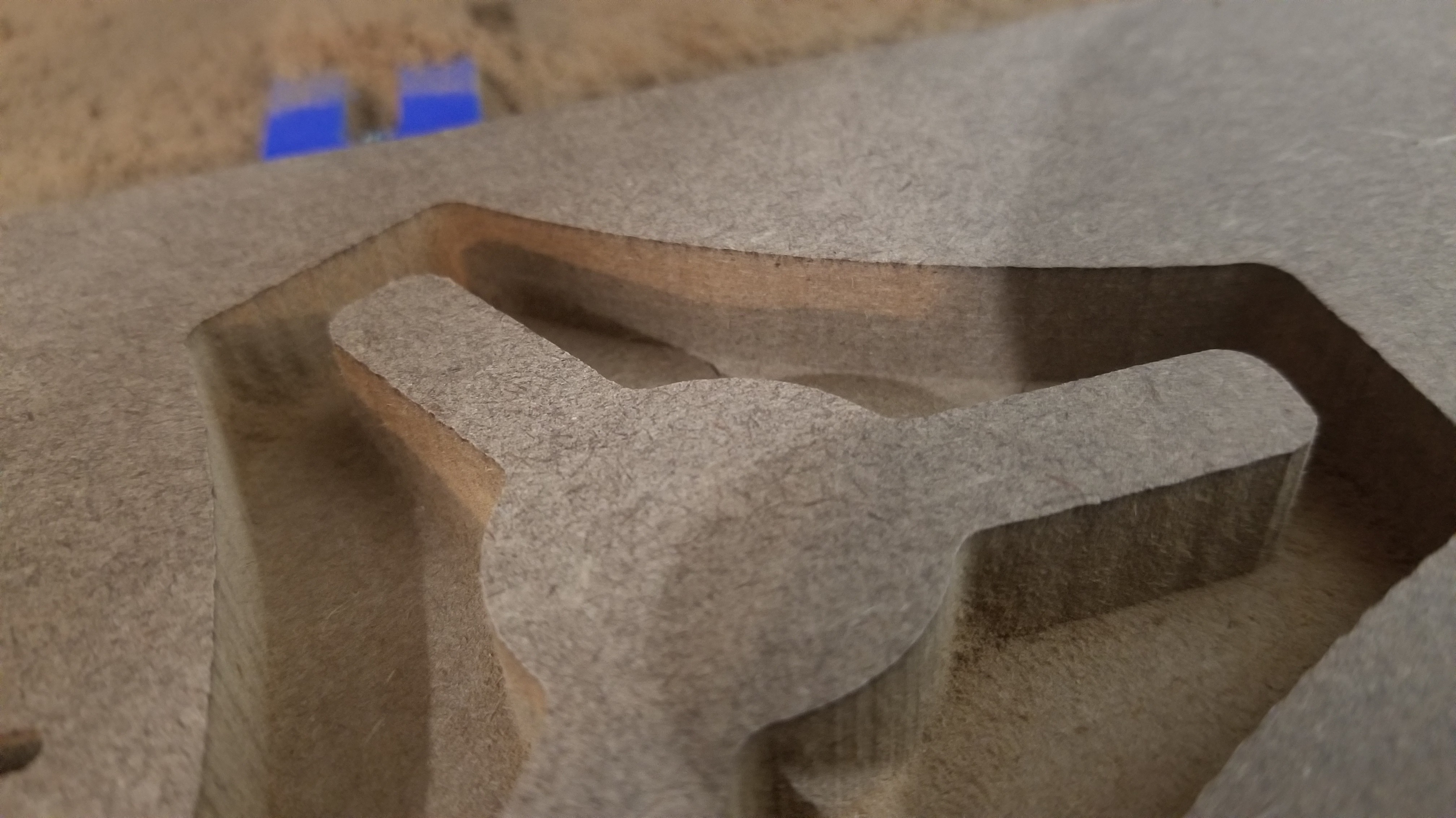

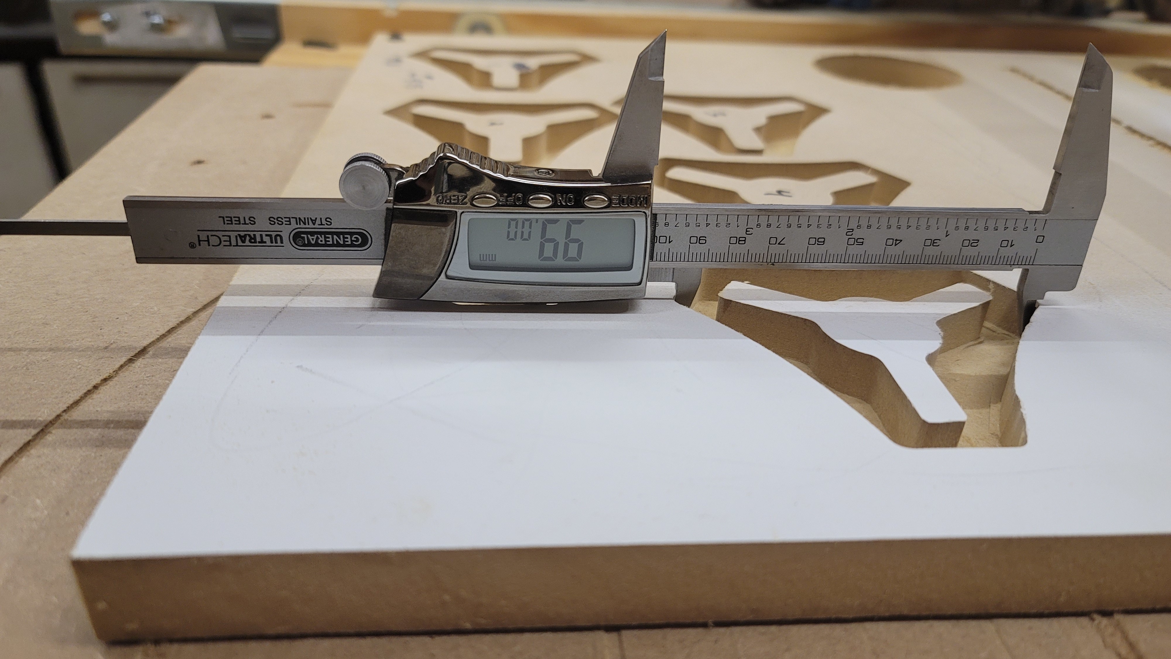

Okay, I lied. Tried it again with the same speeds, but linear pocketing.

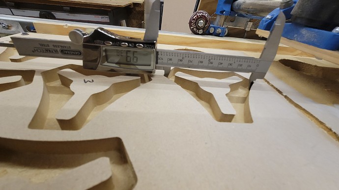

99.38mm
11.77mm, I cheated the endmill up a touch too far.
About a minute and ten seconds.

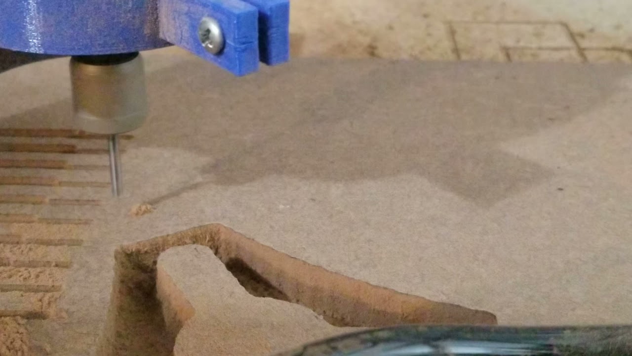

It looks like when it is under the really heavy load it is getting pulled down, or maybe that is just the dust cloud.
AWESOME!
Paint is dry, going to add the protection stickers might get a cut in this evening!
Yea, it’s pulling on the router, this is waaay too fast.

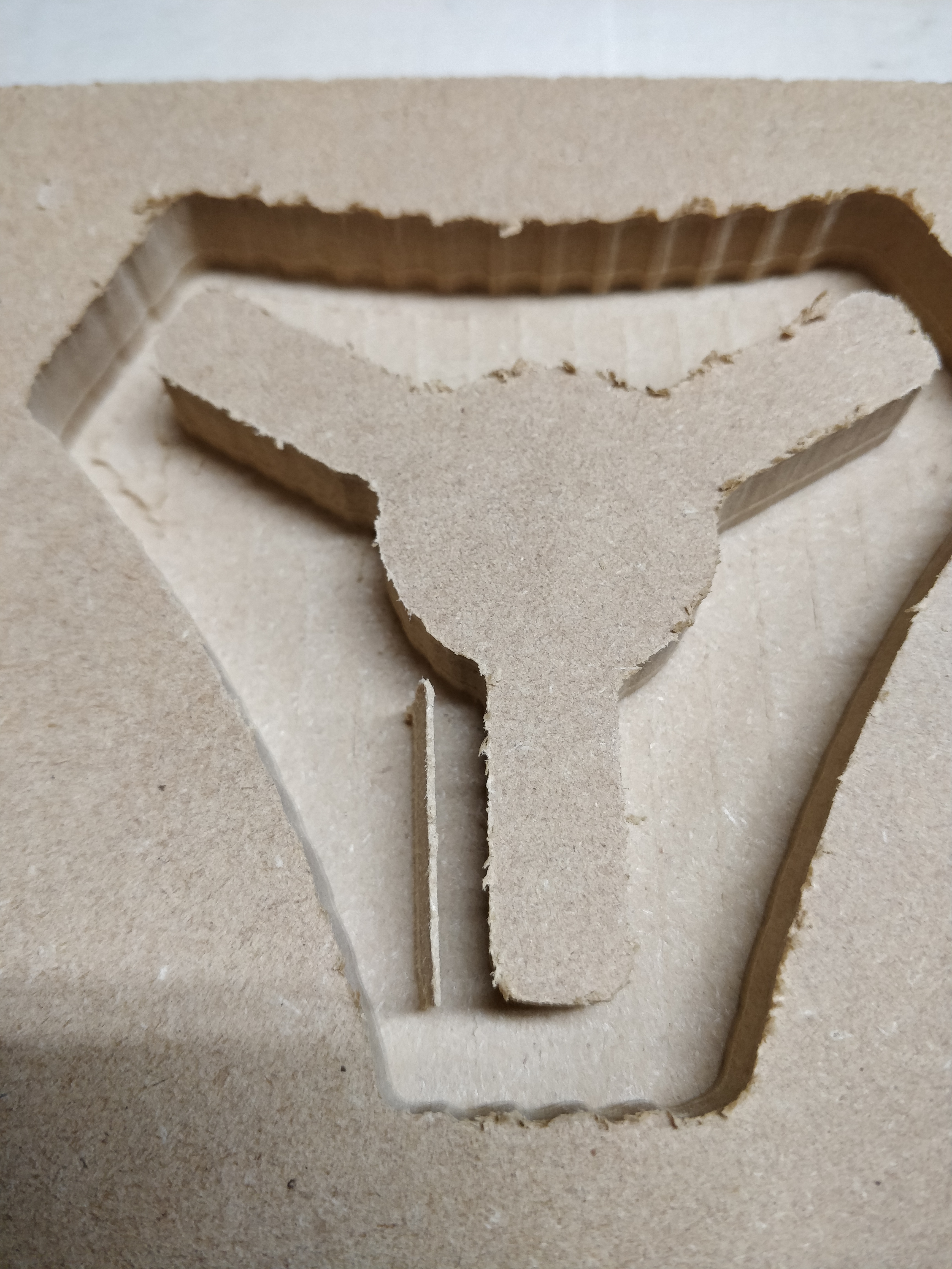

I did a run. I poked around in Estlcam for a while, looking for what I thought was a good balance. I used the old bit, thinking I would probably regret it.
After some light vacuuming:
This was 20mm/s, 90% stepover, and 12mm DOC. 1/8" single flute upcut. Way faster than I have before. Nice to know it will at least finish at these forces. No skipped steps.
It clearly has a nick in the bit. My X belt was also a bit loose, so I tightened that. I think the dull bit and the loose belt caused those waves, but it might also be where the linear pattern stopped and turned around, IDK.
Video doesn’t show much. I measured 2:05. But the results are too poor to count. I didn’t even go get my calipers, I want to make one with a smoother surface.
