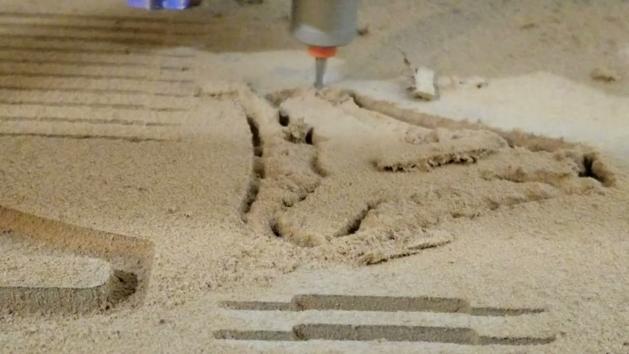

And the winner for the best carnage so far goes too…

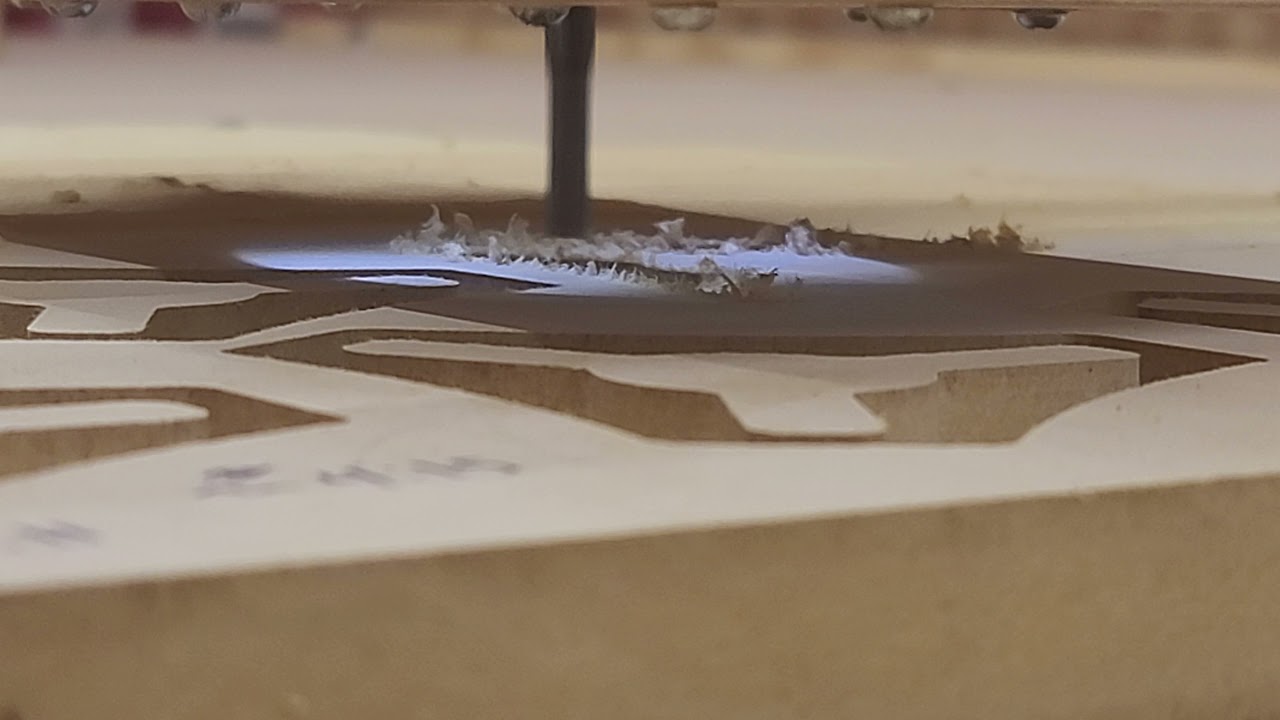

Bad ass! I can see your travel moves are almost half the cut, that is insane. Your optimizations are going to really lower the time I bet. It almost looks like you need to slow down your RPM’s a bit…maybe.
I love this! I really didn’t think we could get under 2 minutes so this is already blowing my mind. I am going to have to see what I can do.
Okay, since this is getting nuts I figure we are going to need to get a bit more specific.
Time start when the plunge starts, and ends when your bit clears the surface on the final retraction (not when it gets back home).

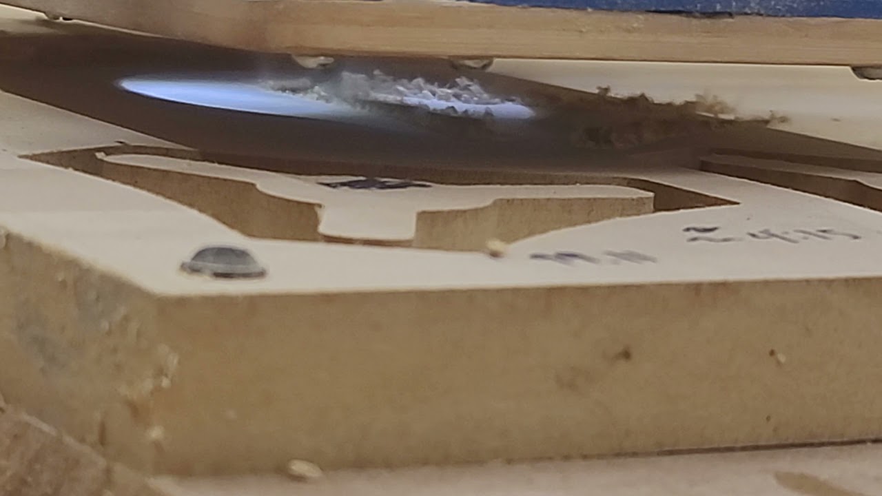

Well not close enough even with new rules to win, but here is my third try…
Three flute I think is needed, as my CMT 2 flute was groaning enough already.
Note this was with 2 half depth passes… and I worked on cam settings to minimize travel. So it is down to bits at this point for me.
(Edit: Those spoilboard marks are not from the drag runs. :wink: )

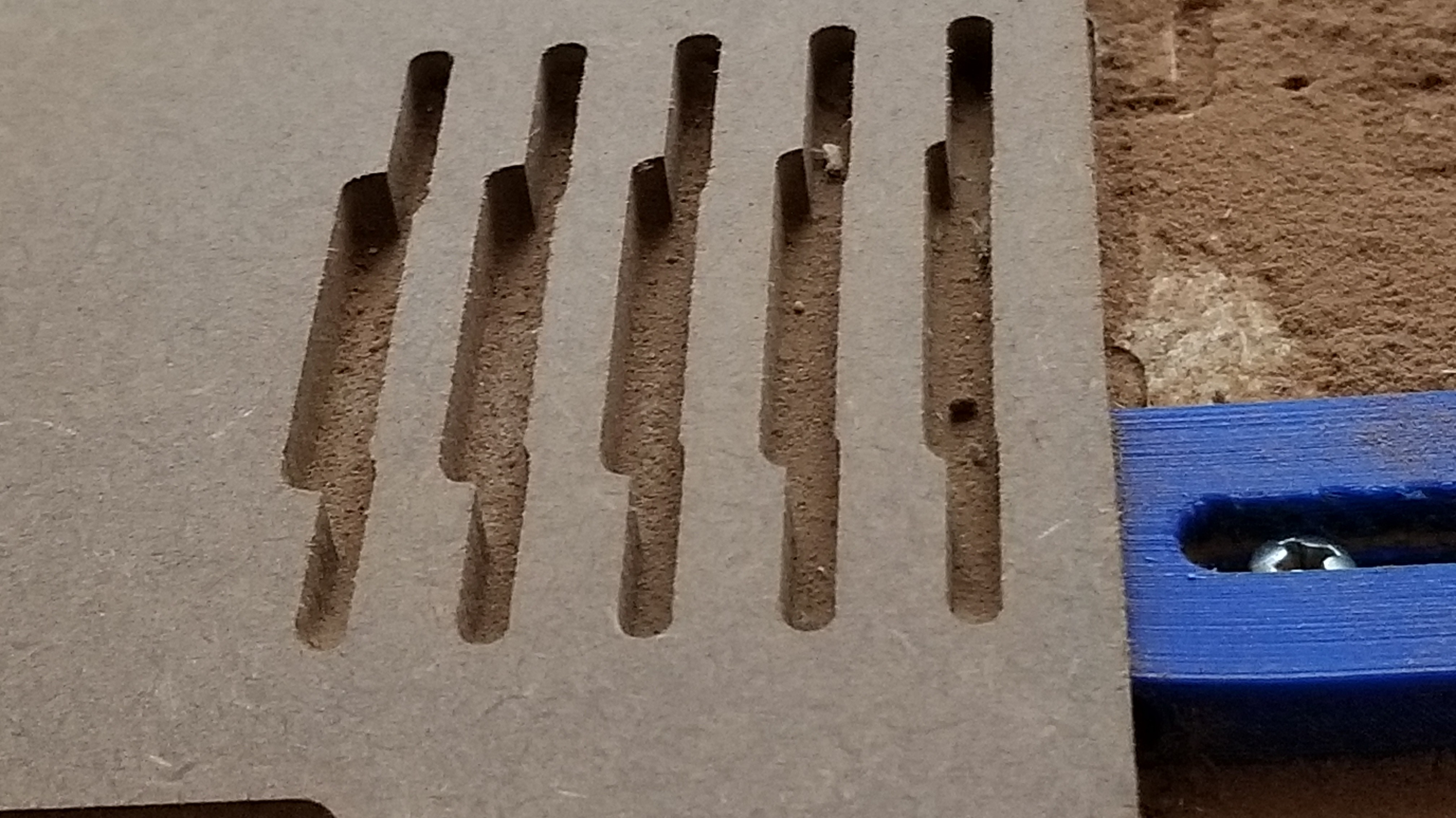

With my test pattern I am cutting at 6mm depth, 3000 mm/min with 3.1mm stepover and it’s plowing though like nothing. This is about 750% of my baseline (600 mm/min and 40% stepover).
These conditions are
1500 mm/min at 1.5 mm stepover (13,500 mm3 per min)
1875 at 1.9 (21,375 mm3 per min)
2250 at 2.3 (31,050 mm3 per min)
2625 at 2.7 (42,525 mm3 per min)
3000 at 3.1 (55,800 mm3 per min)
Part of the design of the test pattern allows me to measure the deflection under each condition, which is visible here:
The bit I’m using doesn’t have 12mm of cutting edge but I can switch to a longer bit and try some more.
Or maybe I will try these settings first and see what happens. The corners could potentially behave different from the straight segments, so that would be worth seeing.

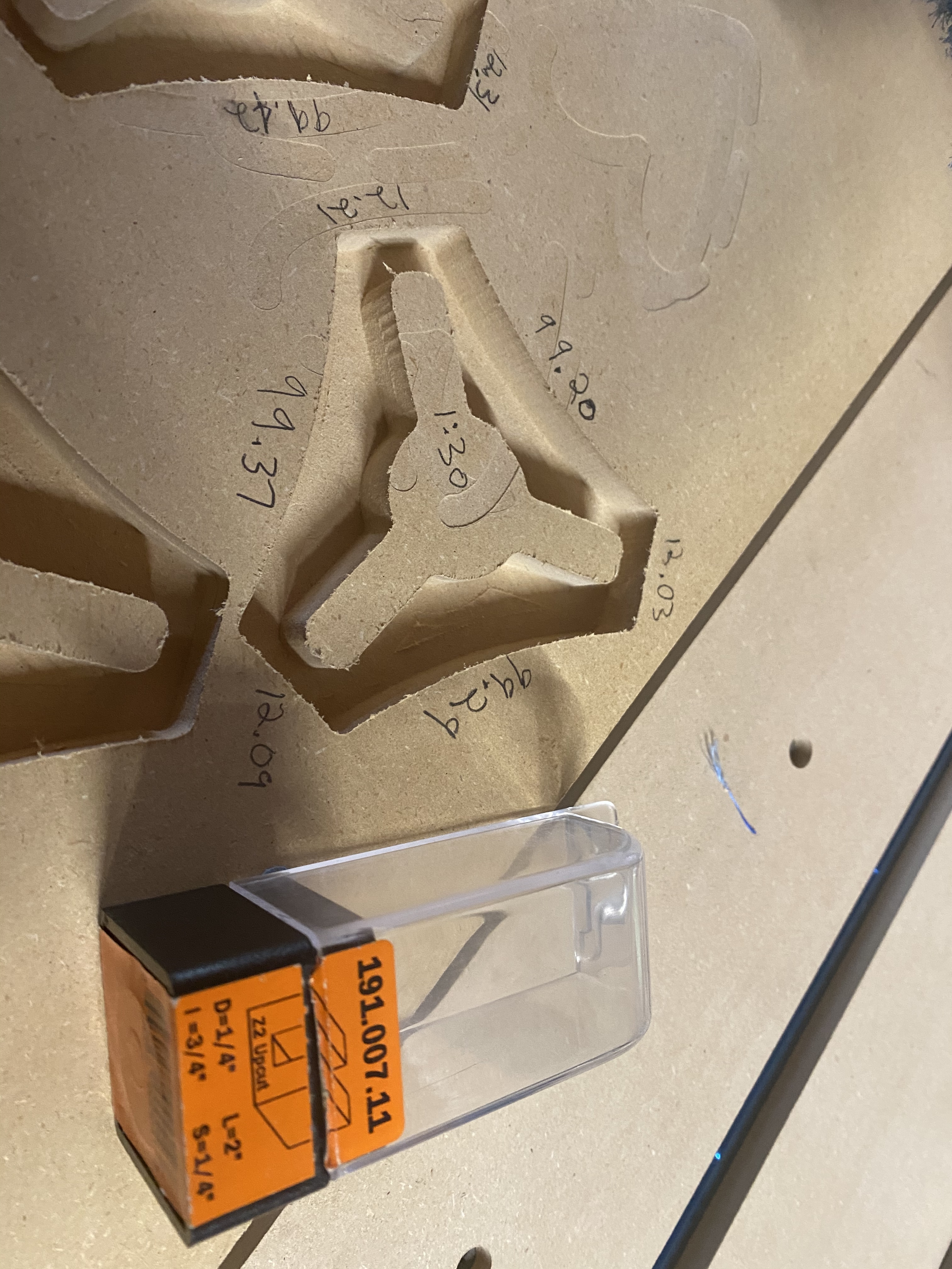

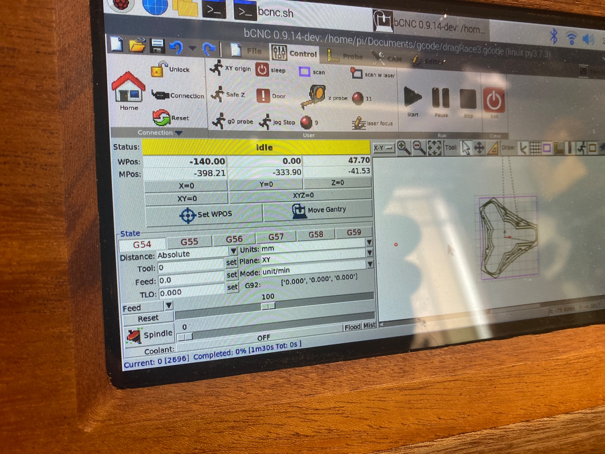

Woo! about 2:05!

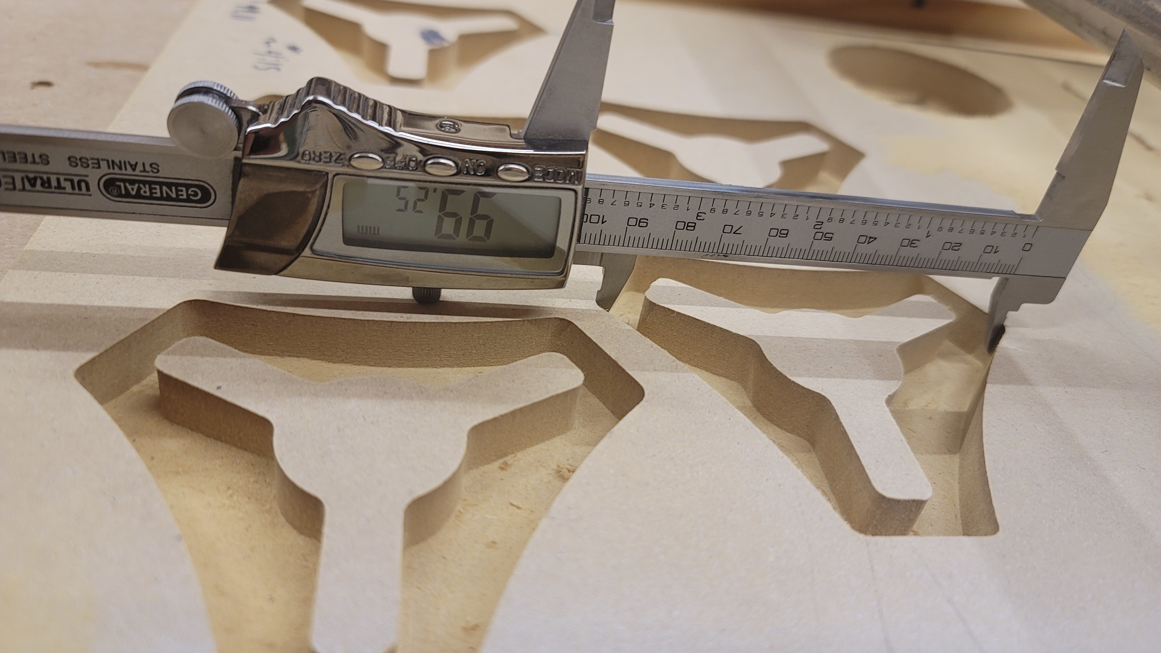

99.22mm

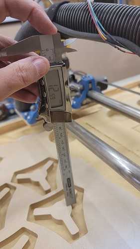

12.87mm I probed in the corner, should probe closer to where I’m cutting…

99.25mm

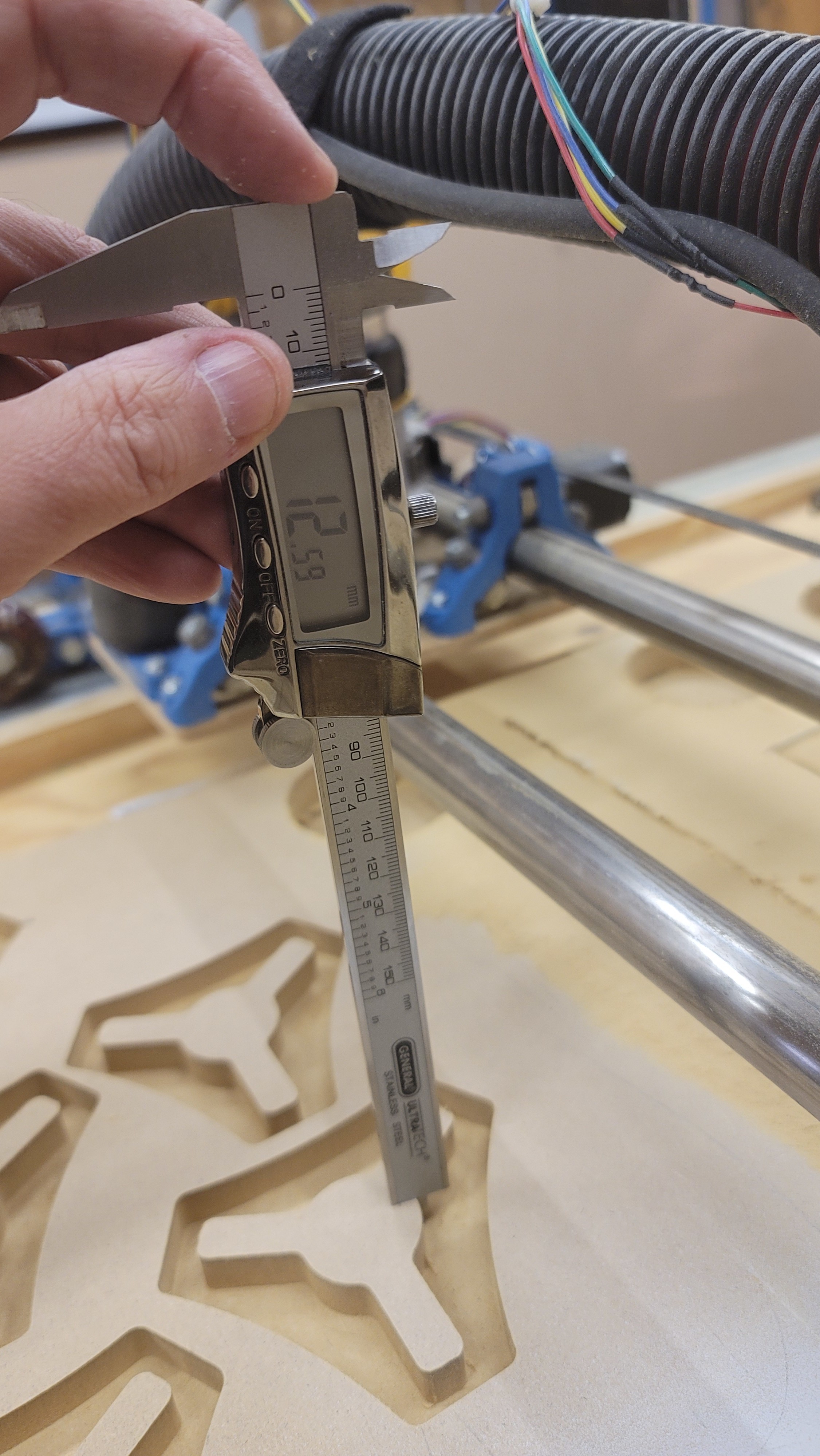

12.59mm Okay, now I’m not sure why I’m cutting so deep. Wonder if it’s tube deflection now. I’m out closer to the center with these cuts.

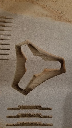

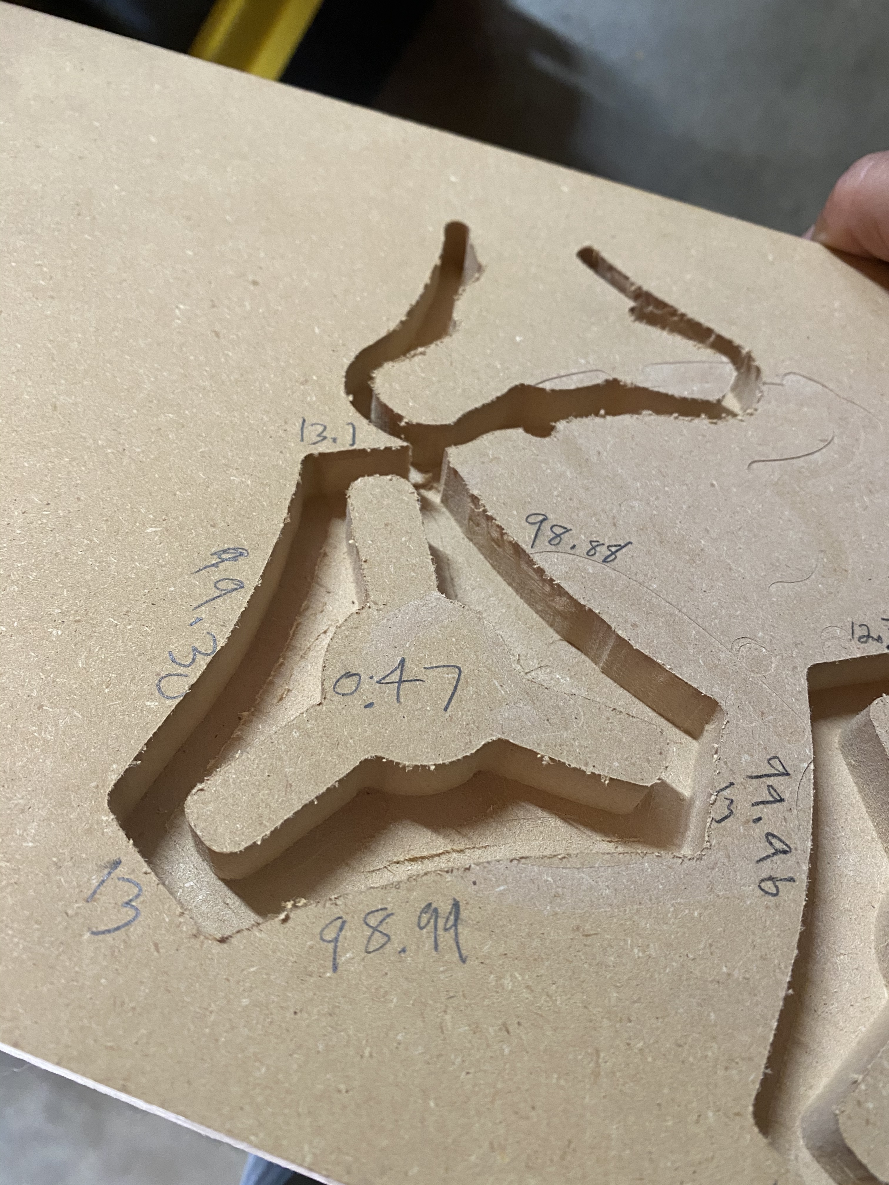

I’ve got anout 2:55 (with 1/8" bit) but I’m thinking this “doesn’t count” because I’m not happy with the quality. The edge has a severe ripple and the floor has artifacts left over from the high stepover. It is deflecting so much that the linear fill pattern is leaving thin-wall pieces behind.
I definitely need to use a longer bit. Perhaps an additional finishing pass and I can get results that are faster and better quality.

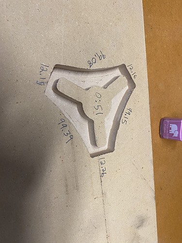

My last run was 1mm too deep, but looking back the previous attempt had a hard stop glitch, which reset the control. In my haste to rerun I did not probe z. So I think I lost position was all, and I have room to eek the corners out with feed optimization (which was disabled). Feed optimization is a thing in f360 that slows the feed entering sharp corners. That would allow for higher speed through the unmeasured areas where bit flex doesn’t count, yet allow the bit to dig in for final dimension right where it matters. My next run will be about 50sec with optimization on… wish me luck.
Whew… barely made inspection!
OHHHHHHH, fifty one seconds… :exploding_head:
We have a new time to beat…
We need to see the video of that please, please, please!
