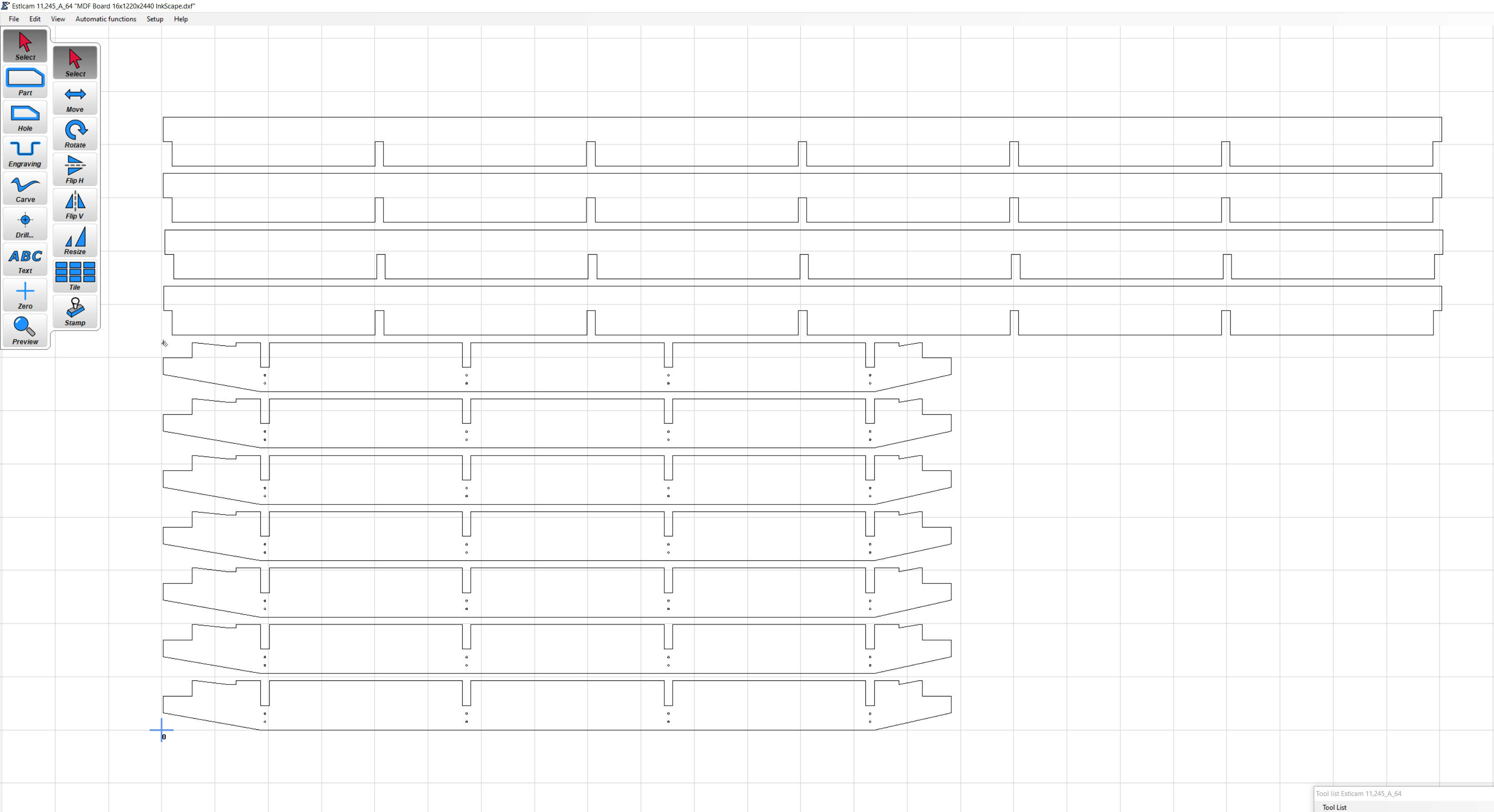

So how do I combined them on a sheet for cutting them all at once. I use Estlcam and CNCjs for compiling and cutting. My LR3 is not finished yet but getting there slowly!

Since I’m not a CAD type of guy more a hands-on and hardware dude I not sure how to compile th ribs and spars to a single board and would humbly ask for help with that?
Thanks in advance! :thinking:
Usually it is done by using a vector illustration program, importing the individual DXF files, copying and pasting as needed, and moving them around on the screen, and then exporting it all as either as a scalable vector graphics file or a DXF file. And then that gets imported ESTLcam. There is a free vector illustration program called Inkscape. Paid programs include CorelDraw and Adobe Illustrator.
Do you want me to give some time for you to try to do that layout yourself? It’s a good skill set to have as part of your workflow on the CNC.
Each profile shape that you plan to cut as a separate part, in this case, ribs and spars, should be far enough apart that there is more than one “bit width” between them.
Also bear in mind that on this, I started by setting the page size in the vector illustration program to be the same size as a full sheet of material (in my case plywood, but you could size for MDF). That way, as I was placing the content on the page, it was mentally the same as placing the parts on a sheet of material.
If you are interested in an automated placement of the parts onto a given sheet you can also take a look at DeepNest, which is doing a really good job to efficiently lay out all your parts to minimize waste.

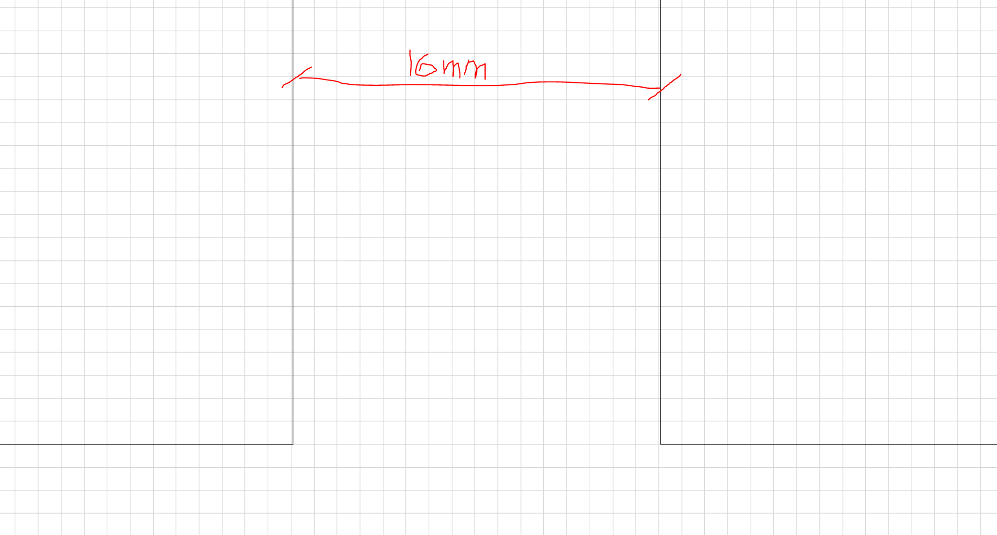

This is what I was able to do in inkscape. No idea how to get rid of the A4 sheet, as well as how to make a standard 1220x2440mm (48"x96") board. Of course it doesnt matter in Estlcam but it would look neat.
It is 14mm between the parts that should be enough for a 1/4" straight bit.
And in Estlcam like this, showing a grid size of 100mm square.
And a closeup on the slots with a grid set to 1mm square counting 16 squares.
Should work
Awesome.
Make sure to test for proper slot width for your cross joints - or there might be a lot of sanding and probably cursing involved! And also please remember to add overcuts/dogbones so the corners fit completely! The 1/4“ bit can not cut the 90 degrees at the bottom of the cross joints!
