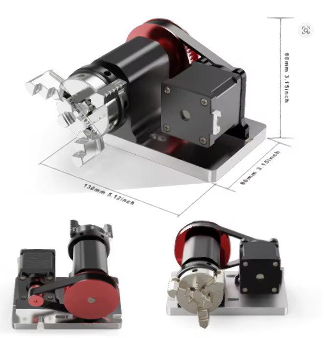

The rotating axis I have mounted is the one in the picture. It runs freely, the wires are plugged in. the driver is mounted. I don’t have the exact measurements you are looking for until tomorrow, as the wife requires attention the rest of the evening.
It was NOT purchased via this link, but from amazon.
: Twotrees 4. Achse Rotationsmodul-Kit für ttc450/ttc 450 pro cnc Laser gravur maschine Rotations walze für zylindrische Objekt dosen - AliExpress 7

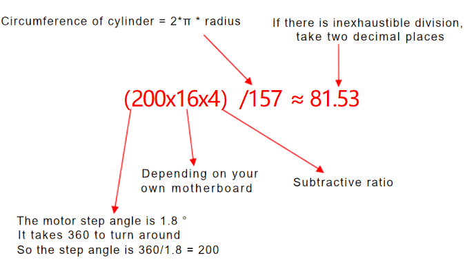

According to TwoTree’s own wiki, I can see that pulses of the motor is 200. (nema 17) The subtraction ratio is 4: 1 and the large pulley is 50 mm in diameter. (157 mm in circumference)
They provide information with the calculation shown
So according to the math should, steps_per_mm be (200x8x4) /157= 40.7643
But wouldn’t it actually be better to use 16 microsteps across everything?
