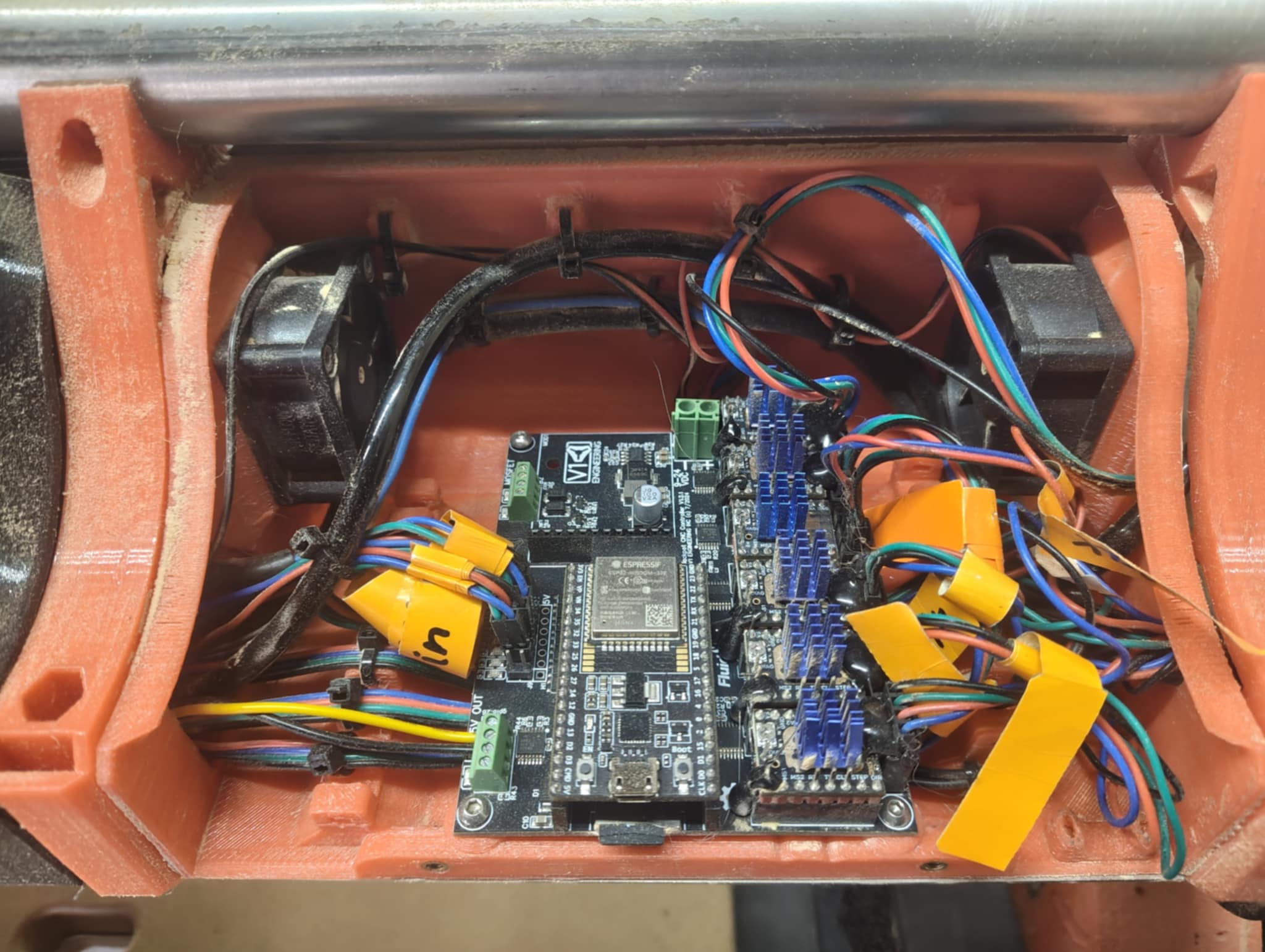

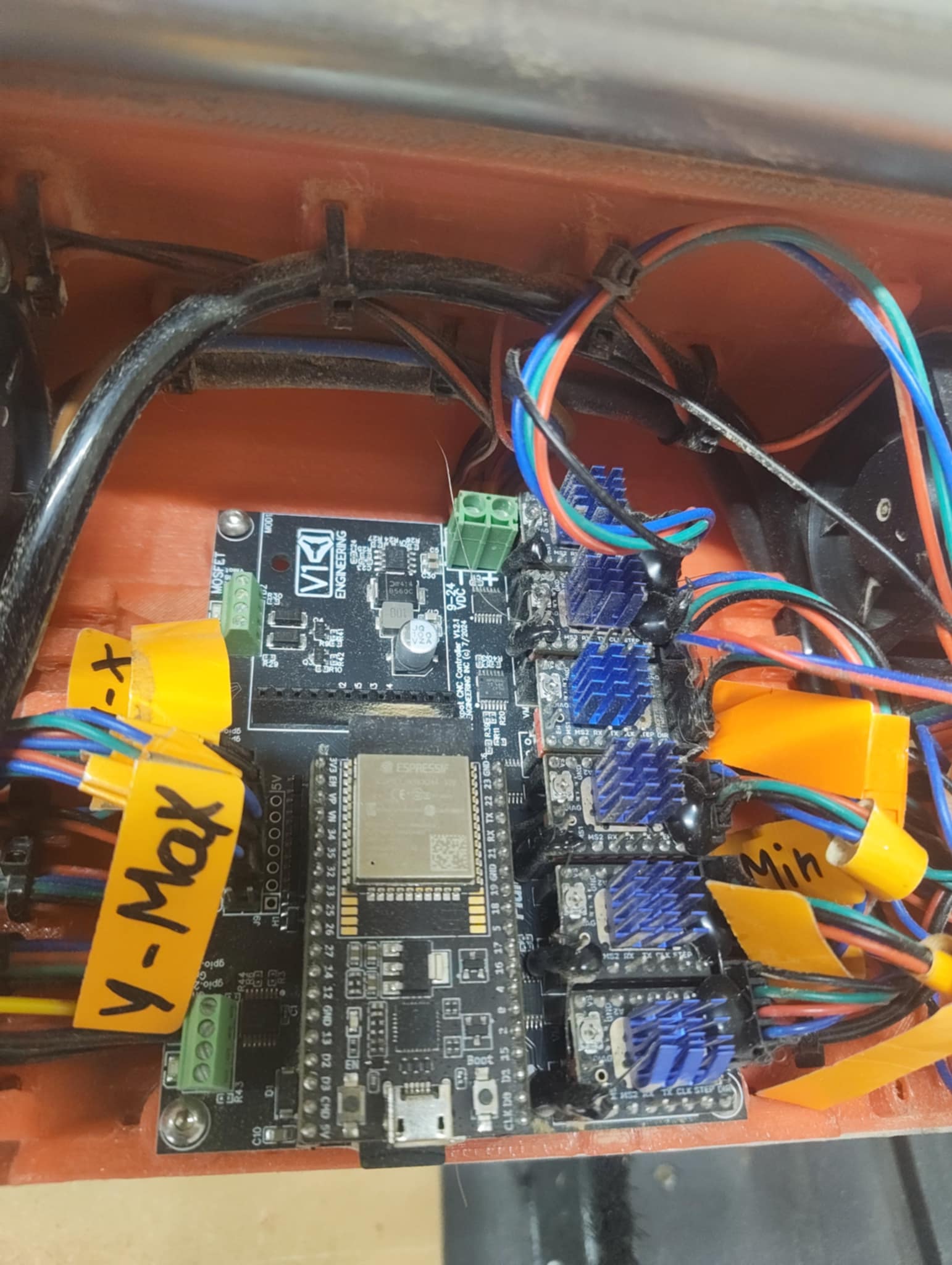

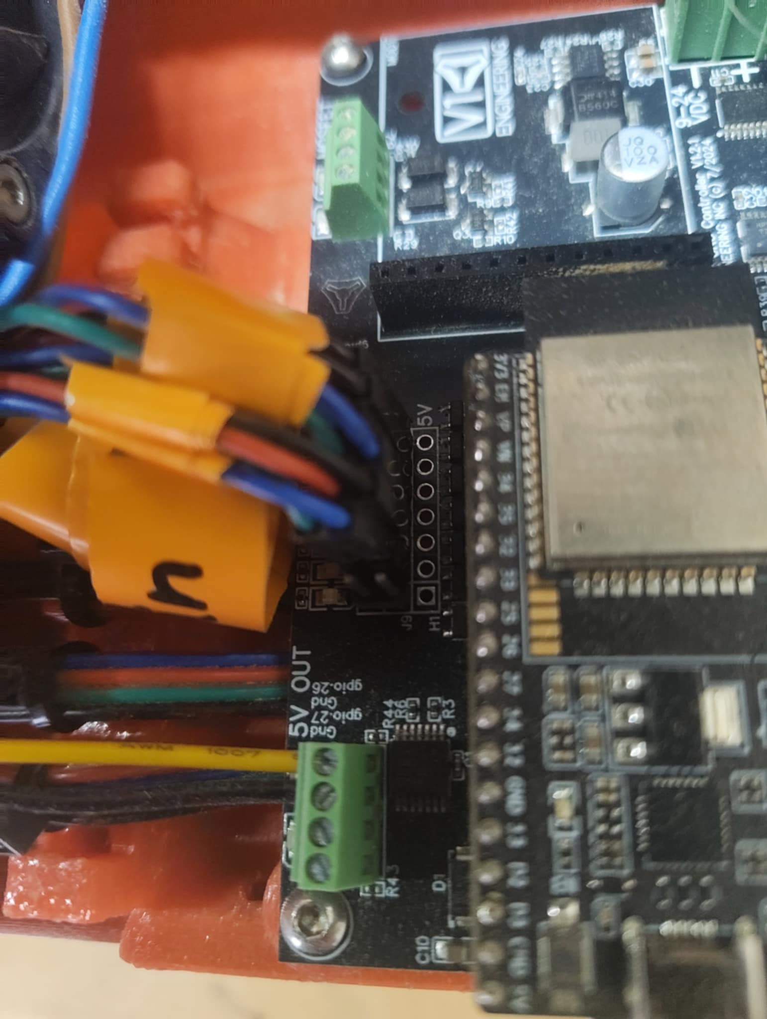

Can you post a high-resolution picture of your controller as wired in your machine?

You have a Jackpot V1.2.1, so a Jackpot V1.

This is from the Jackpot Docs:
Quick note, gpio.26 can have a quick pulse when starting. If you are using a 5V pin for your laser pin 27 is the better option for your enable pin.
I use gpio.27 for my laser.
