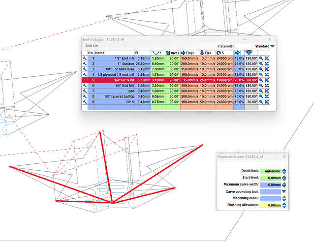

I think you need a bigger angle and/or diameter V-bit (or smaller drawing), that Estlcam is going as deep as it can (and cutting a flat at that V-bits max depth of cut/5.5mm) with your chosen tool/drawing.

To see if ChatGPT got it right (that a 60deg V-bit would need to be >= 20mm in diameter to work) you could temporarily change the 60deg V-bit diameter… and v11 max carve width to 20mm and see if the Estlcam Preview Max depth (double click to side view) is 17.32mm (max cut depth for a 20dia 60deg V-bit per my Carve Calculator)… Using v11 you’d need to manually rotate and measure.

Automatic/Ask (v11/v12) allows the tool to go to the maximum depth possible, e.g. 5.5mm for that 60deg 6.35dia V-bit… Any manual entry larger than that Estlcam calculated max depth will change nothing (despite such a claim further down the page).

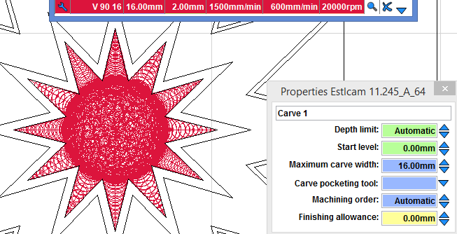

Used one of my drawings resized to work with my 16mm diameter 90 degree V-bit. Note: CAM will have a gray area in the center if the tool isn’t big enough. I don’t know what I might have been doing wrong, but I couldn’t get this to work in v12.

The example above measures about 1.1” across and required a 16mm diameter tool. As my first post said:
As my second post said:
side view is pointy. Reduce the diameter until it’s no longer pointy and you’ll know the minimum diameter tool needed. You could also use the main CAM window and decrease the diameter until the gray center reappears (post 4). You could also post the drawing and let us figure it out (post 3).

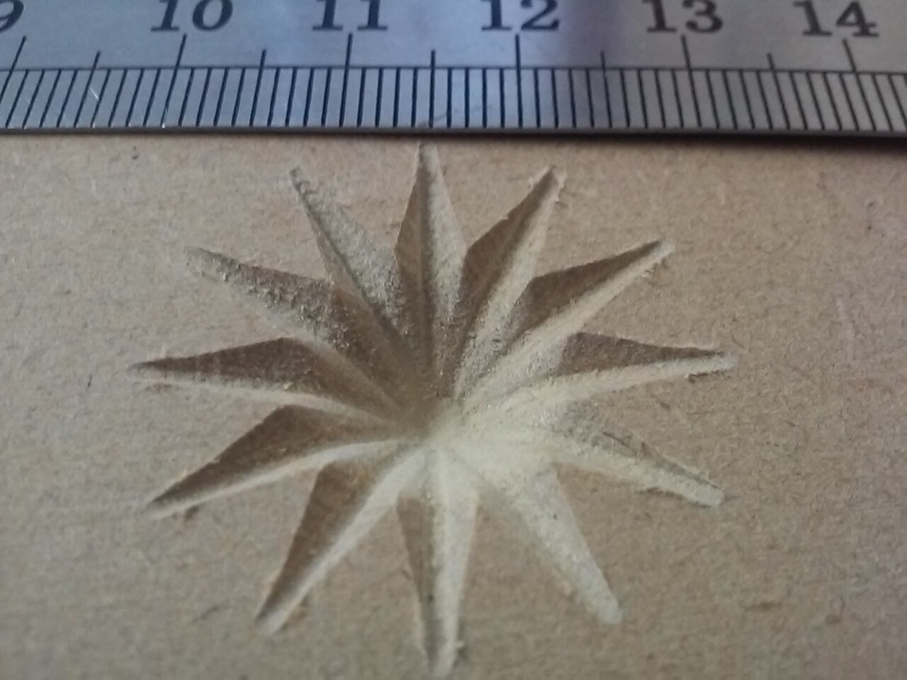

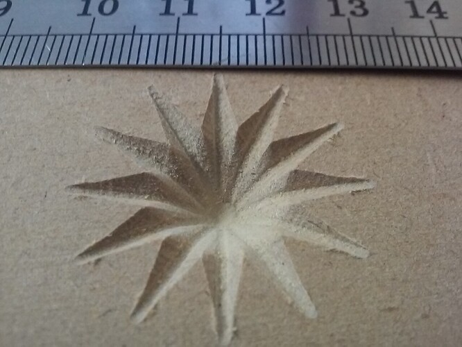

Well, today was not all bad. Got the new 32MB C4 micro SDcard and popped it in, fired up the machine and attempted to connect via WebUI. And ….. it worked!
I quickly, before the machine decided to pull a fast one on me, loaded up that one test star where I defined the depth to 15mm, well in excess of what was normal for the 1/4 shank 1/4” this was actually a 90-degree v-bit, (not a 60* V-Bit). And it worked without issue. Actually too good as the pit in the center of the star is too deep (or deeper than I would prefer). Will play around with this some more after dinner.

Yes, you can calculate it yourself using the link in my second post. The results will match v11 internal calculations, v12 typically calculates a slightly smaller max depth.
The only way you can increase the Estlcam calculated maximum depth for a tool is to lie about the tool diameter and max Width (>= tool dia). Estlcam will not exceed the maximum calculated depth (used when Depth is set to Auto/Ask) no matter what you enter in the Depth field.
