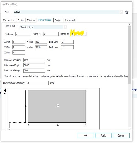

Yea, it picks up the G92. I’ll give cncjs a try.
CNCjs is pretty slick though.

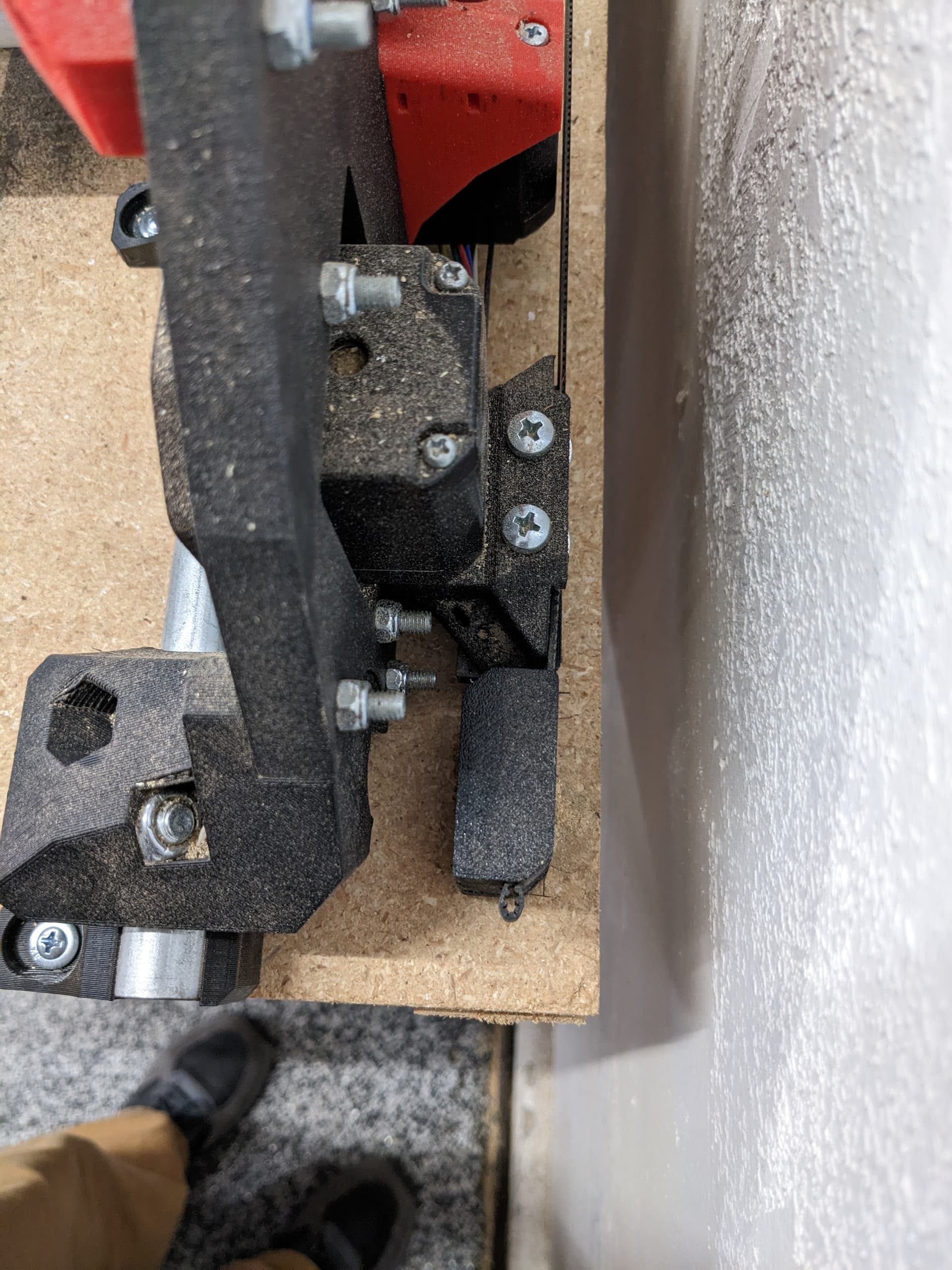

Missing the blocks?
Not enough room for them. Shifted the rail over an inch. Also have to reprint them. Can’t get the belt through. Feels like the top didn’t bridge right.
Actually showed me I screwed up anyway. I measured off the edge of the table when I mounted the rail. Forgot, I cut that side with the shitty saw guide. There’s about an 8th inch bow to that side, so the rail also had that bow.
The belts go to the inside so they will fit.
Get rid of the bow though!

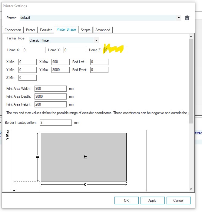

Those are microstep counts.
I had no idea

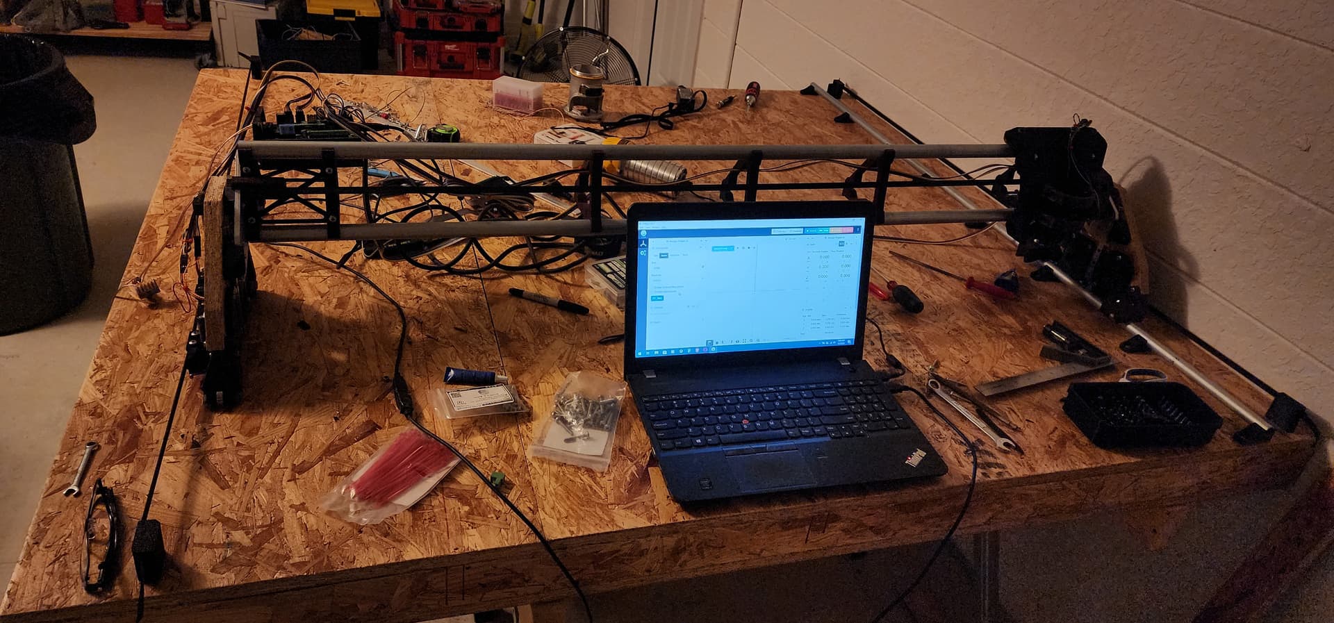

It lives! Also, this table is freaking heavy…

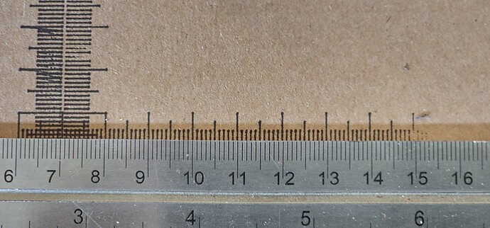

Holy crap, it’s a Christmas miracle! It draws square squares without having to adjust anything. :rofl:
Jackpot
:four_leaf_clover:
That was all me, perfect design…no luck involved.
:rofl:
Now I gotta get some mdf for a spoil board and some luan for the gantry plates.
Not too bad for it just being a cardboard box taped to the table.
Why did you make a ruler if you already had one?
Making sure the ruler I had was accurate.

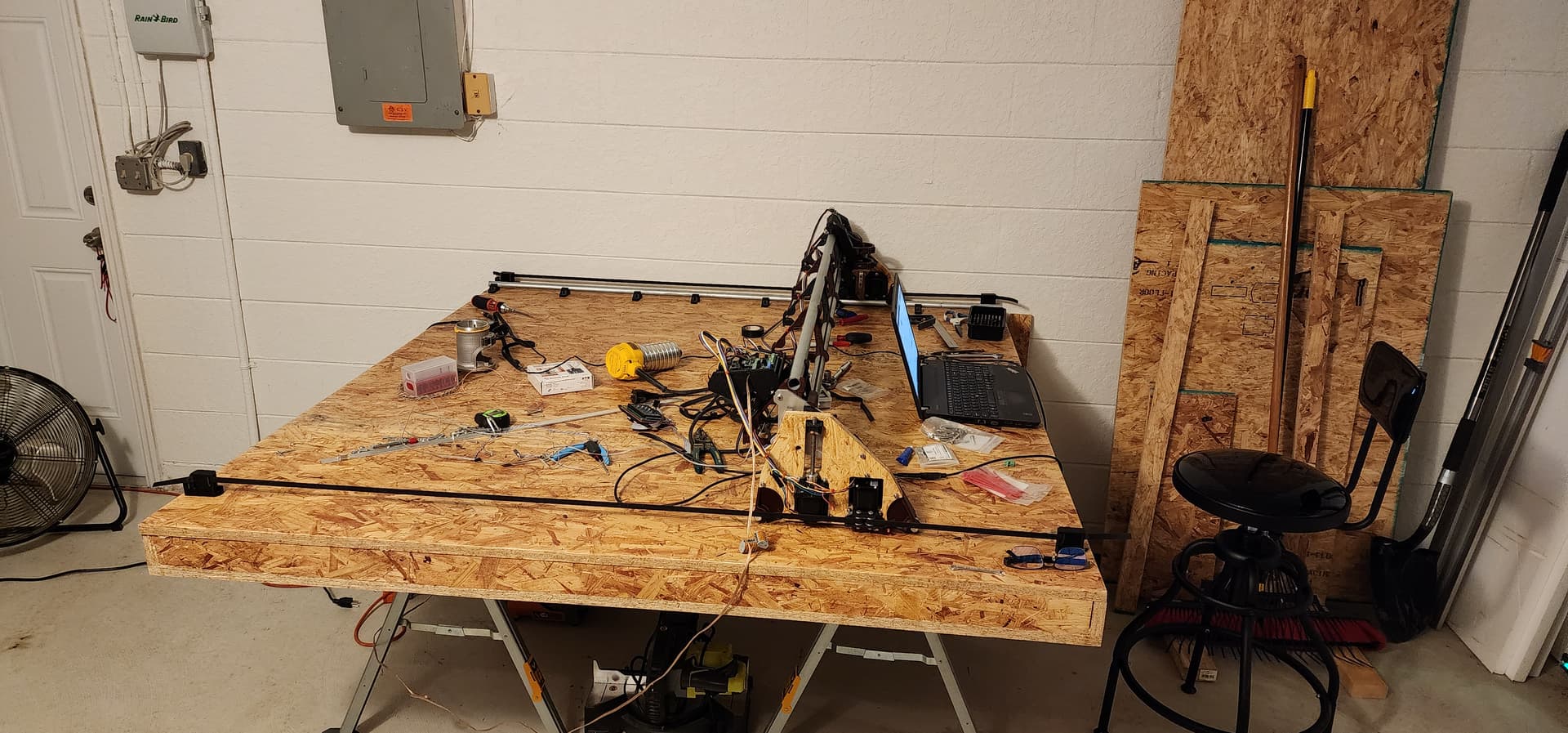

Now that I’ve added an extra 40 pounds to the top, time to build a proper set of legs. :rofl:
