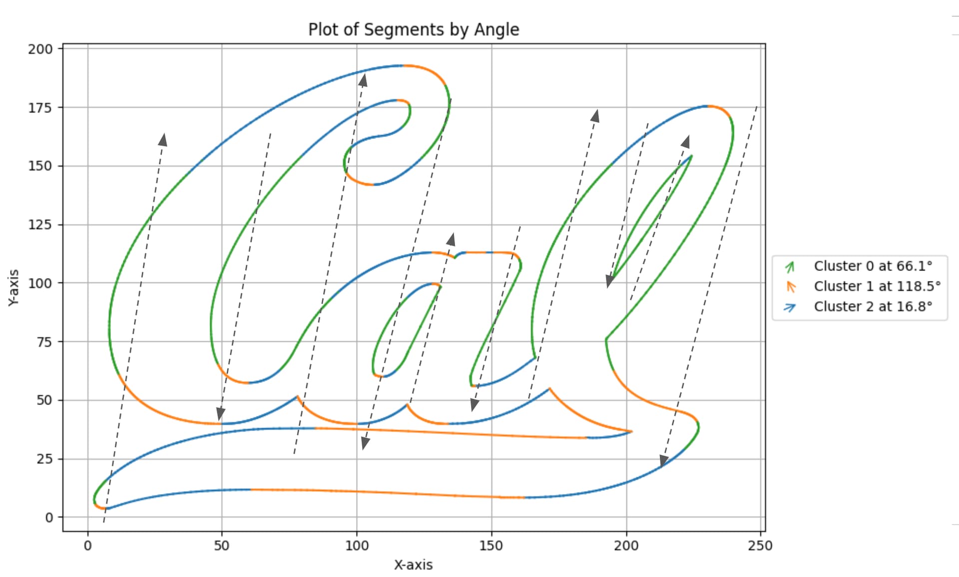

Also trying to finalize the path planning script that has been quite a bit tricky for me. This graphic shows how I’m planning to split up the passes for different orientations.
Now I just have to sort the groups of paths into practical passes for the machine to take. I drew little arrows on the graph output to show what this might look like for an arbitrary Cluster 0.
