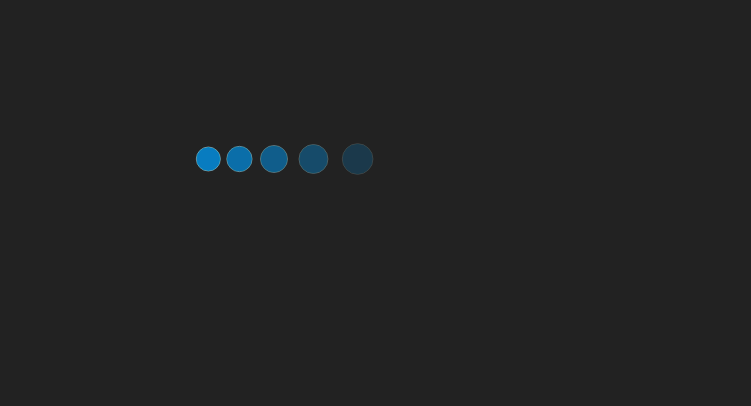

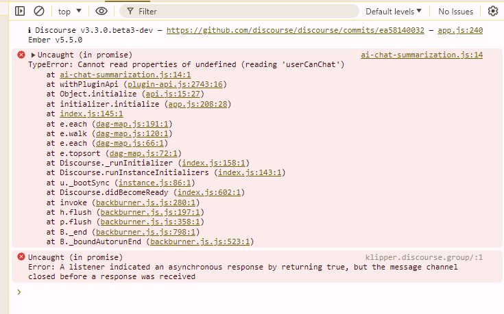

just get blue dots
Same here. Looks like their server is down. I cant get to my post from yesterday either, same blue dots
I don’t see any mention of it on the Discord, but the site looks hung.
This forum is on 3.2.2 of Discourse.
They seem to be on a beta version
Not sure if that has something to do with it or not
