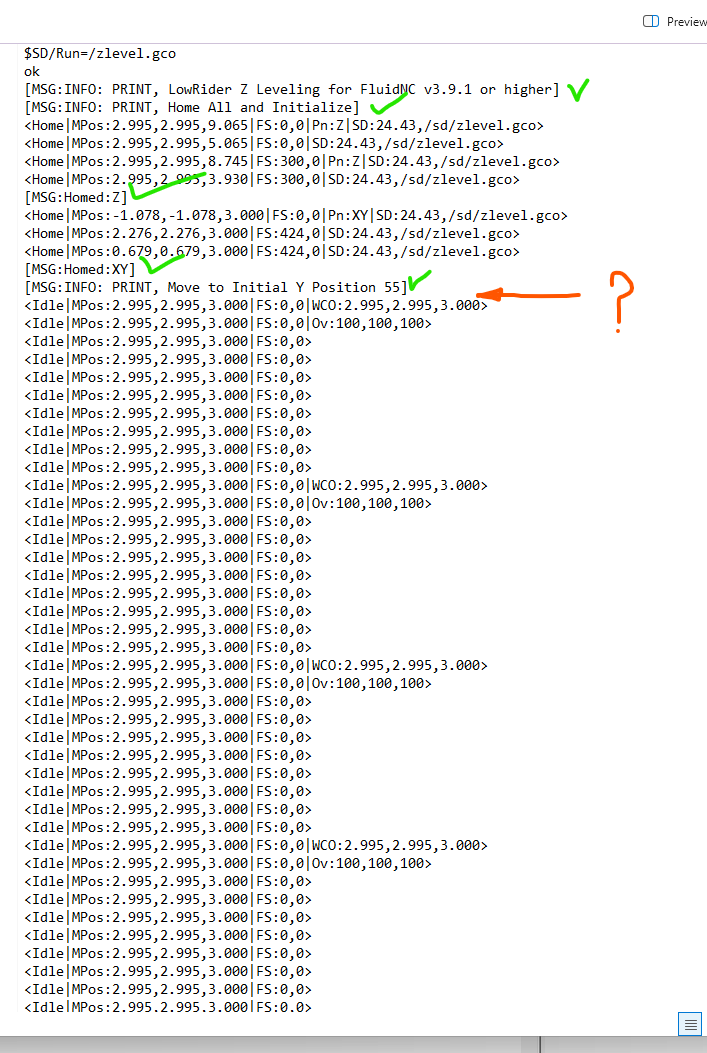

I’ve not got your very cool macro/extension to work yet.
I am using V3 of the GUI on a PC. I have tried running it as a file and also as a macro.
The code runs, it homes x,y and z. Then it stops with the following message in the STATUS panel,
“INFO: PRINT, Move to initial Y position 55”
So I guess it’s not running the following line
G00 Y# F#
I have also installed your Hold Monitor extension, which is working but not displaying anything except for first HOME message…
Am I doing something daft? do you know what the problem might be?

Could this be a problem with v3 of the GUI/FluidNC parsing things differently?
Post your gcode and I’ll take a look.

My version is very similar but I have some updates to use G1 instead of G0 in a bunch of places because G0 ignores feedrate and uses max feedrate. Let me go test it since it’s been awhile since I’ve used it.
Hmm, I get the same behavior as you. This definitely worked before. I’m wondering if it’s a firmware issue? What version of FluidNC do you have? I currently have 3.9.7 which I think has some known issues. Going to try different versions.
Well, I get the same behavior on 3.9.9 (released this morning) and 3.9.5. I see that if I remove a couple messages, it gets further.
It’s very odd. I turned on debug and it outputs the one message and the job ends.
[MSG:DBG: Homing done]
<Idle|MPos:0.000,0.000,0.000|FS:0,0|SD:25.33,/sd/_zlevel.gcode>
[MSG:INFO: PRINT, Move to Initial Y Position 50]
[MSG:DBG: /_zlevel.gcode job sent]
<Idle|MPos:0.000,0.000,0.000|FS:0,0|WCO:0.000,0.000,0.000>
[G92:0.000,0.000,68.730]
I see that if I remove both “Move to Initial” print messages, it continues further but that’s as much as I had time to poke it.
I think I was running 3.9.4 a long time, so I might see if that behaves any differently.
