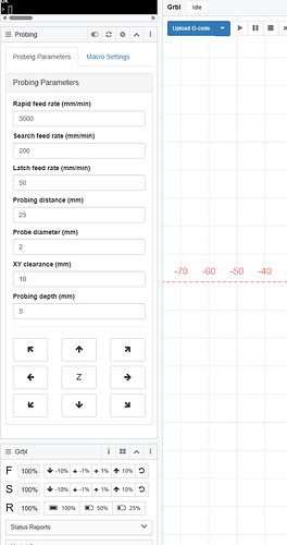

I wrote a set of probing macros to probe corners, edges, and Z for my own use case (3D probe) and I thought I’d share it in case anybody else wants to use them
FluidNC-Probing
Just realised a bit of context is needed on the usage. 00-Probing-Parameters needs to be edited for your specific use case and also executed at the beginning of every session to set the parameters used in the other macros. You can also set this as a startup macro so it’s executed every time your controller board is started.

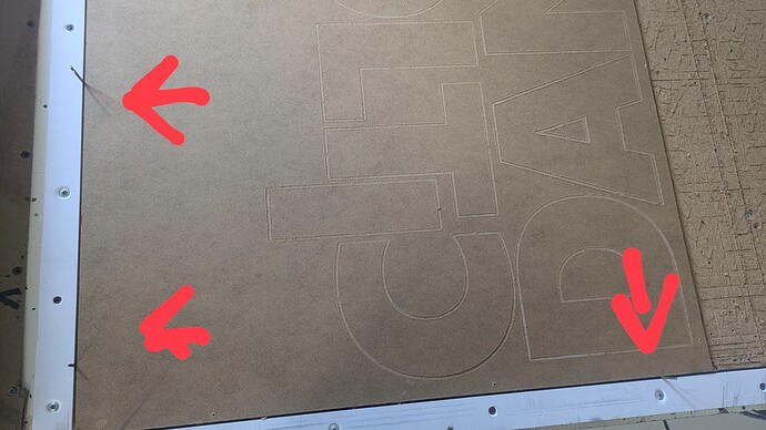

I solved this using a fence on my machines Xmin and Ymin as a reference using a 1/8" bit i cut all the way around on the outside and i use 1/8 bit shanks to place the material.
That said: i mostly work with full sheets.
After i did this fence my xyz probe only functions as a z probe
Could do this is by setting an oversized piece of stock on the machine, and carve out that fence to exact machine coords. As long as it doesn’t move, the fence will always be at exact 0 either y or x.
Then you could carve out a grid pattern in the spoil board so you visually know where you are pretty quickly.
Oh and a member already wrote a program to generate the path for you. :+1:

I have the front half of my cutting area set up for work holding through the use of threaded inserts. When I did this, I also made locating holes all along Y on both side of the cutting area so I can line things up. Unfortunately FluidNC doesn’t support G68, otherwise I would’ve made a rotation correction macro too.

I run the macros through custom macro buttons in webui3 that basically trigger macro files stored on the SD card.
Does this way effect the performance in either direction? I could see it being faster because it doesn’t need all the code stored. But u could also see it being slower because it has to access the file remotely.
I’m just starting out with all this stuff so try to use small words like talking to a toddler. Lol
I run all my gcode from the SD card and have never encountered any issues. I believe that’s pretty much the default way that most people run ops if they’re running FluidNC.
In any case, with these macros, I haven’t seen or experienced any delays in the 100+ testing sequences I’ve run.

I couldn’t let it go and started creating a probing widget for CNCjs. Once it’s fully tested, the plan is to make a rotation correction and Z compensation one as well.
Just spitballing, what it you could probe the wasteboard and then only surface the high points?
Say you start the machine, then it probes the spoilboard and then it surfaces the points that are above?
Yeah, technically you could do that once I have the Z grid widget going. Instead of modifying the loaded gcode, you could just take the lowest Z value and set that as your 0 point
