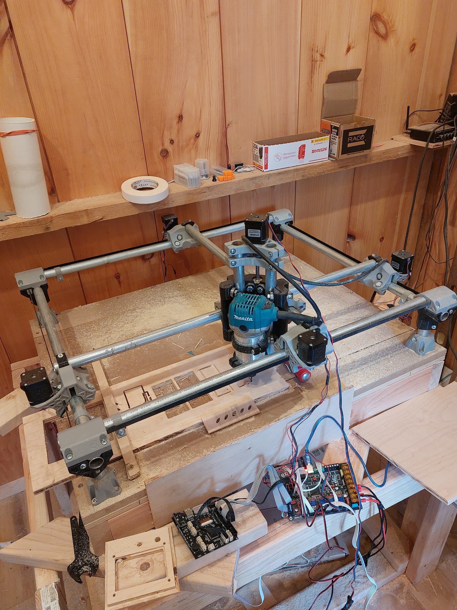

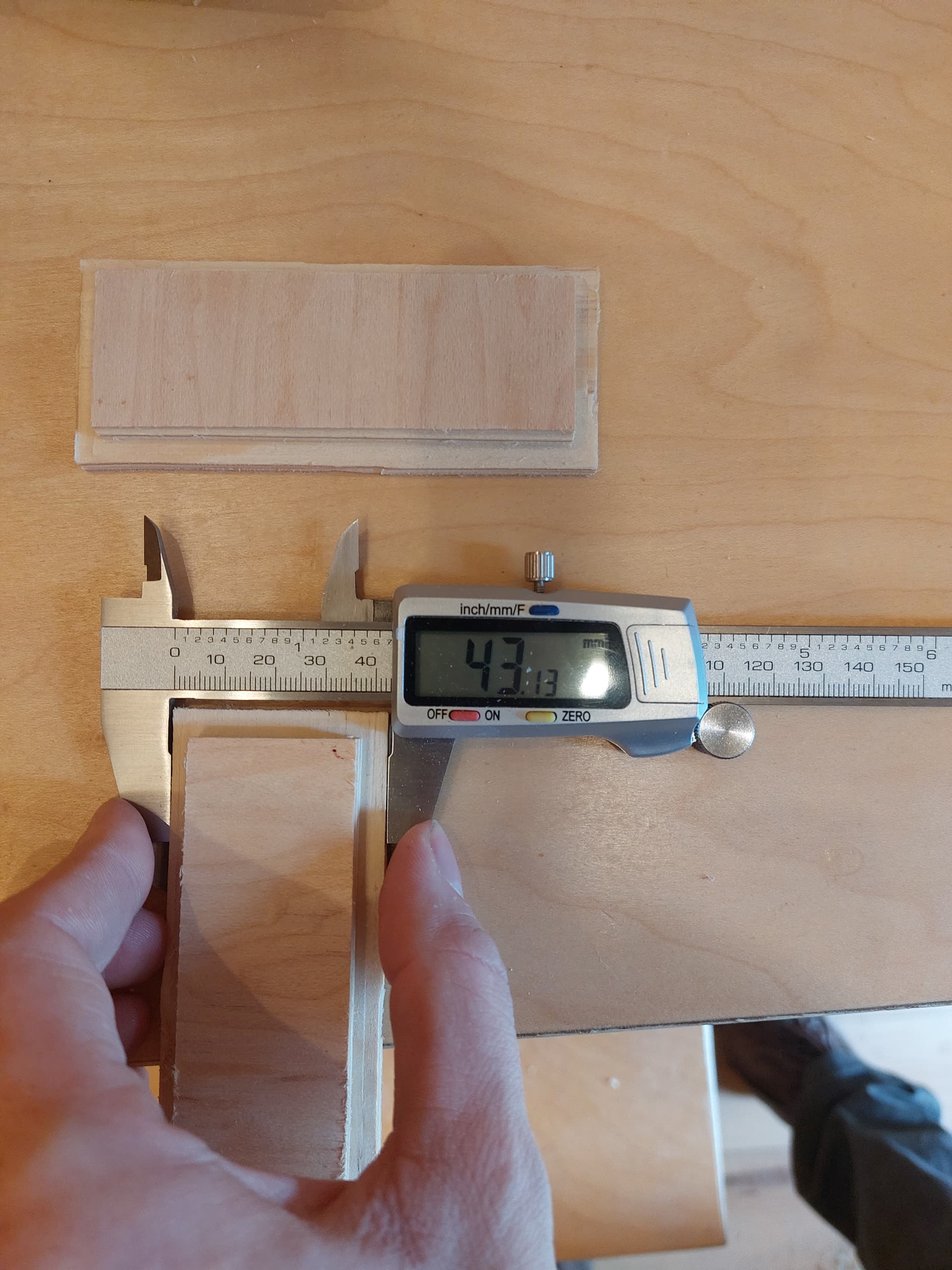

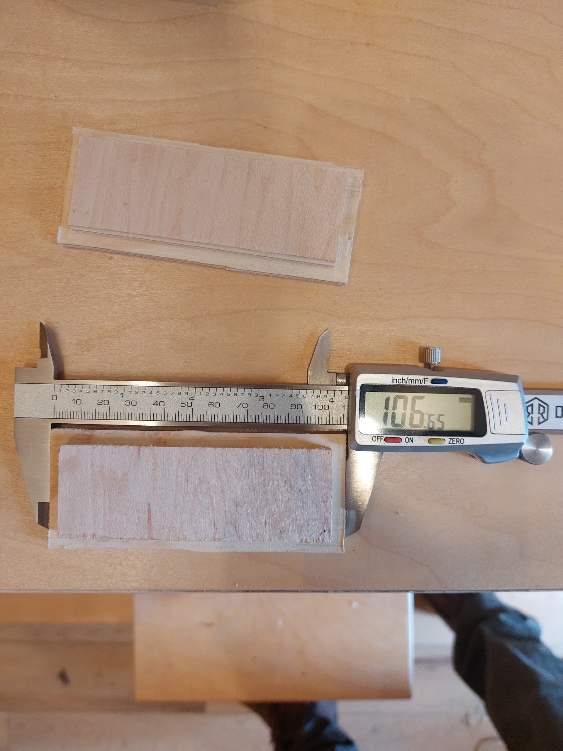

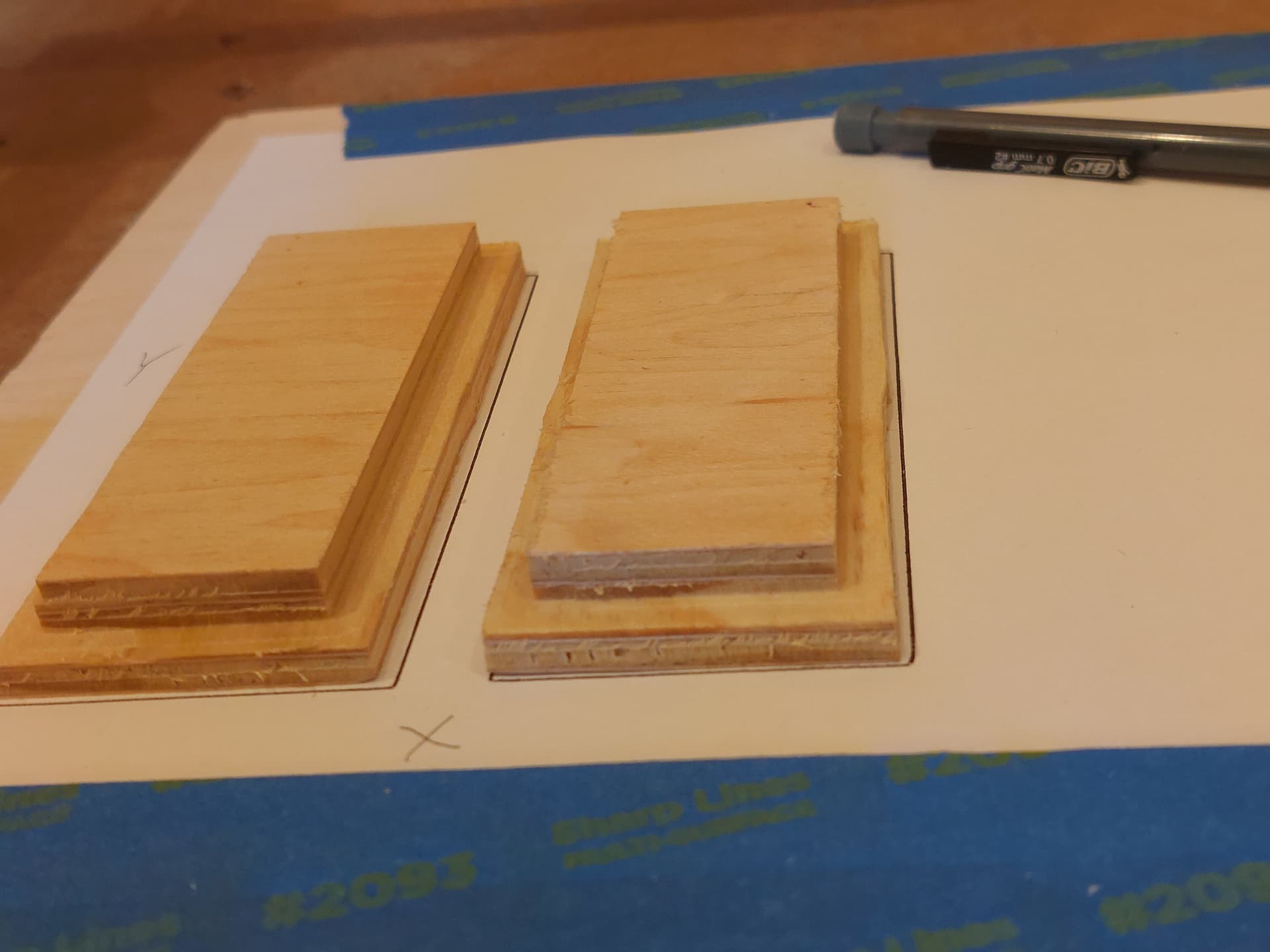

Alright, I just setup my first mpcnc and things went fairly smoothly through the crown test. The first thing I wanted to build is a simple little box, I quickly noticed that while it seems square it is a bit too small all around. The length that is supposed to be 110mm is 106.65mm and the length that is supposed to be 45mm is 43.13mm
What are the steps too troubleshoot? I did briefly try to tighten the belts but very quickly it started to chatter and skip.
Thanks in advance for any help I will post some photos from my phone in the first comment.

Oops looks like I was in a hurry and made a typo, the longside Y was supposed to be 108, which makes it closer to being off in even amounts.

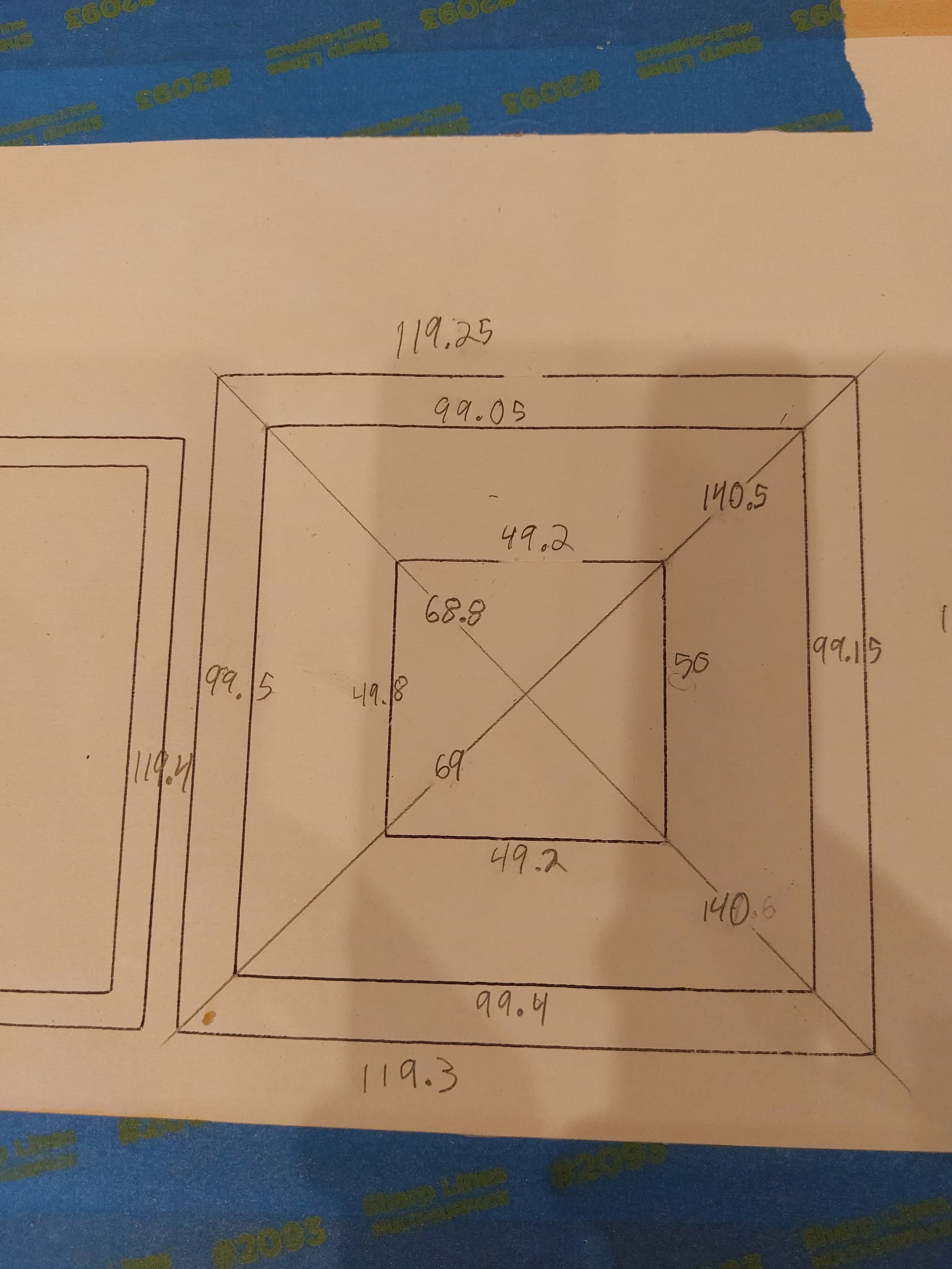

I did put the pen back on and drew some squares, I also had it draw the same piece to see if it was similar. I got a perfect 45mm on the X and slightly closer Y at 107.3
This is the result of the square test I ran, I expect there could be a bit of wiggle room with my measuring but should be pretty close.

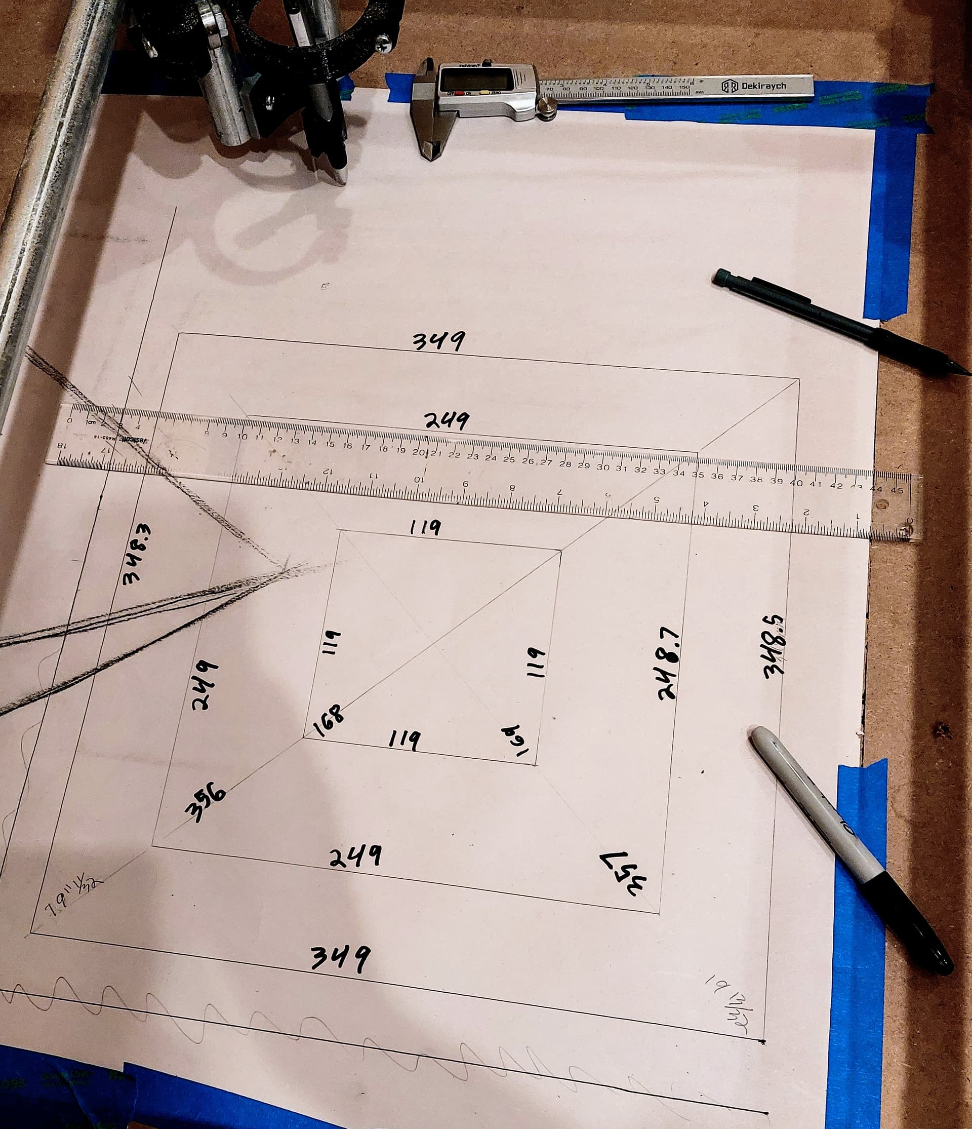

Can you run a couple of pen square tests using most of your spoilboard? The larger format squares will be more accurate, and I’d like to see if the under sizing grows with a larger size square.

As for your g-code, it is correct for an engrave, so I don’t need to see any additional g-code files. Your measurements should be taken from the center of the ink lines. It is hard to tell from a picture, but it looks like your lines may have a width of 1mm or more. That can make it hard to get an accurate measurement when looking at discrepancies around 0.5mm. Also, what pen holder are you using? There can be some flex in some of the holders, though typically that flex in the direction of travel, not sideways to the travel.
I would like to see you do a large square and measure the result. I want to see if the issue scales in any way, or if you are consistently too small by about 0.5mm no matter what the size. Also, a large square will allow you measure the diagonals accurately to see if this might be a squareness issue. If your machine is out of square, then the lines will be closer together than specified.
I am puzzled. A lack of squareness is the only thing I can think of that comes close to matching your symptoms. Your measurements of the diagonals of your small squares do indicate your machine may be a bit out of square, but I don’t think the amount is enough to account for the smallness of the measurements between the sides of the squares.
Alright I did some larger squares. Per my luck the pen gave out halfway through but I was still able to measure. Using a clear ruler was as exact as I could measure at that size although there is certainly more margin for error. When I measured the smallest square which same size as the largest on my previous test with calipers I got 119.3 which is the same as I got before.
For the diagonals it does seem to be slightly off, I had to switch to an inches tape measure for the largest square which as exact as I could get it I seem to be off 1/16" about 1.6mm.
UGH I have half a mind to strip it down and rebuild.
No, you don’t need to strip it down and rebuild it. You just need to 1) move the endstops to physically compensate and/or 2) use an M666 to compensate in the firmware. There is some information on making the adjustments on this page. Personally, I’d start by adjusting the endstop stop blocks until you are a lot less than 1.8mm off, then (if necessary), use M666 for the final, small adjustments.
