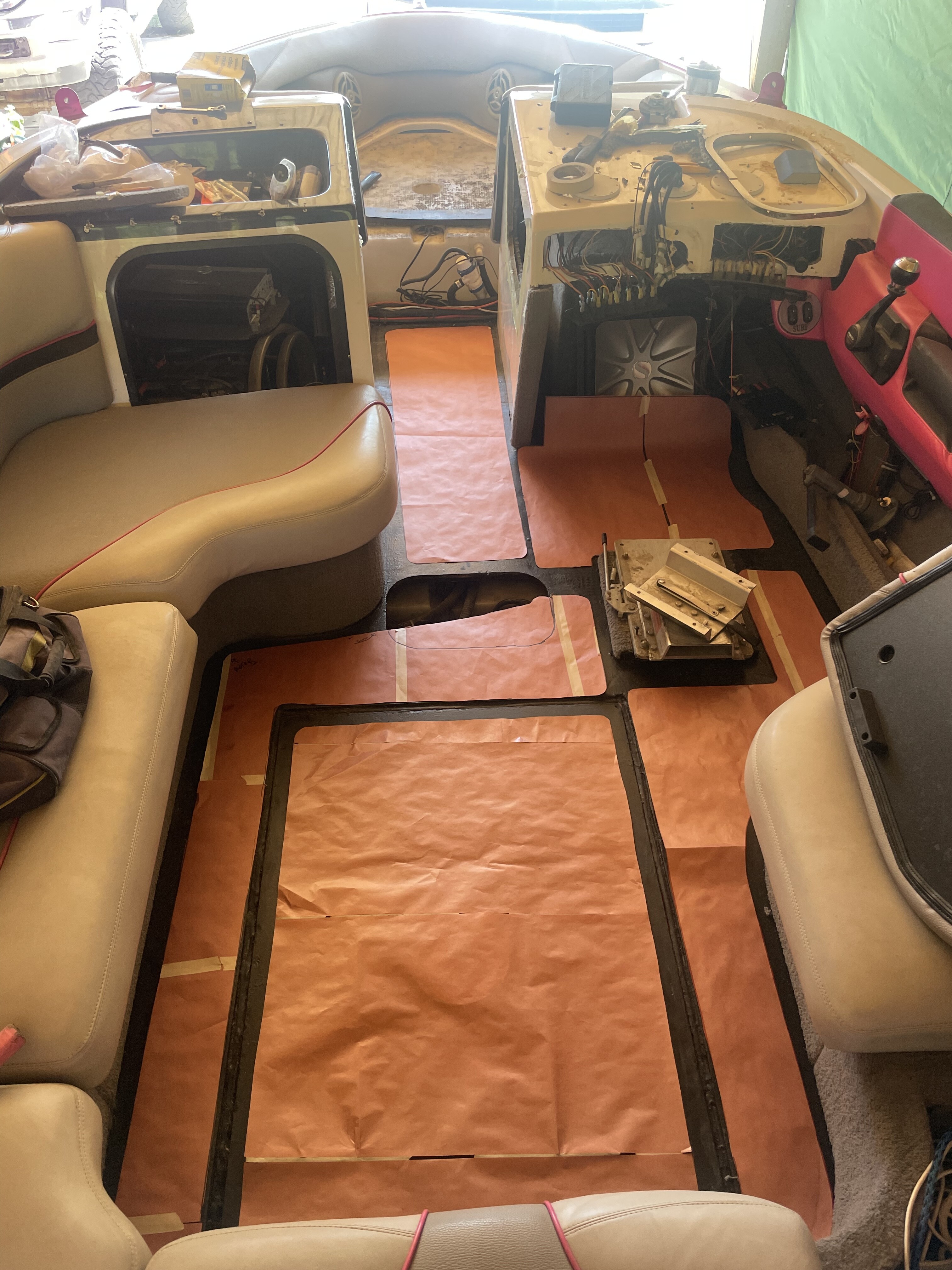

Well carpets out floor glue is all scraped up and I have a couple layers of gel coat I tinted and waxed up on now. And it’s time for the fun part. Digitize the floor and section it for border and multi pieces. (So if I need I can remove fuel tank lid with out cutting)

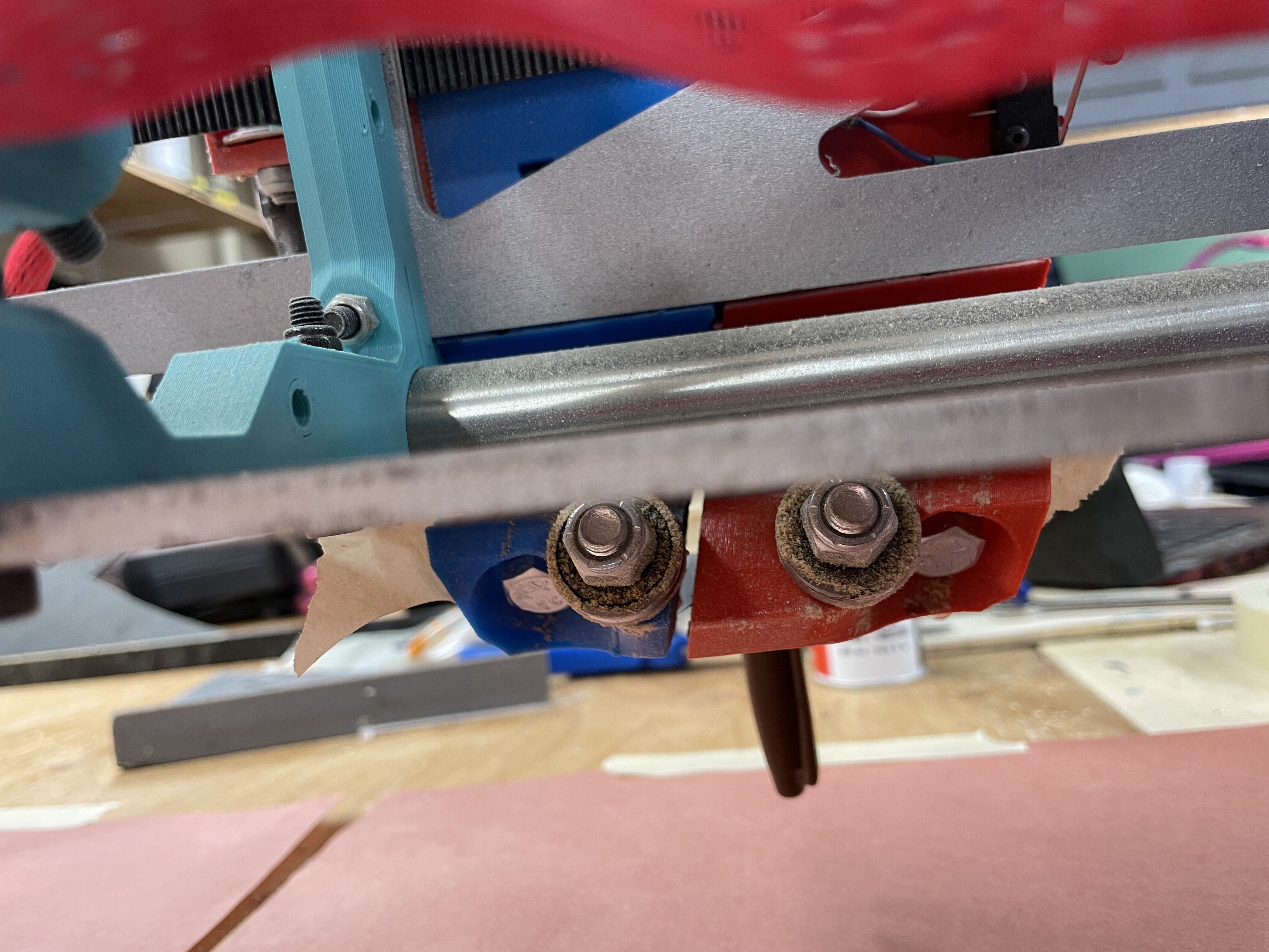

First off I got a speed controlled cheapo router for the lr3. Trammed up my very odd portable table and did some test cuts.
I went with basic cheap v cut router bit the ones with two blades. Material is 5mm Eva foam floor teek texture surface. I went 18mms 2.5doc and speed was set at 5 on my router I have no rpm yet.

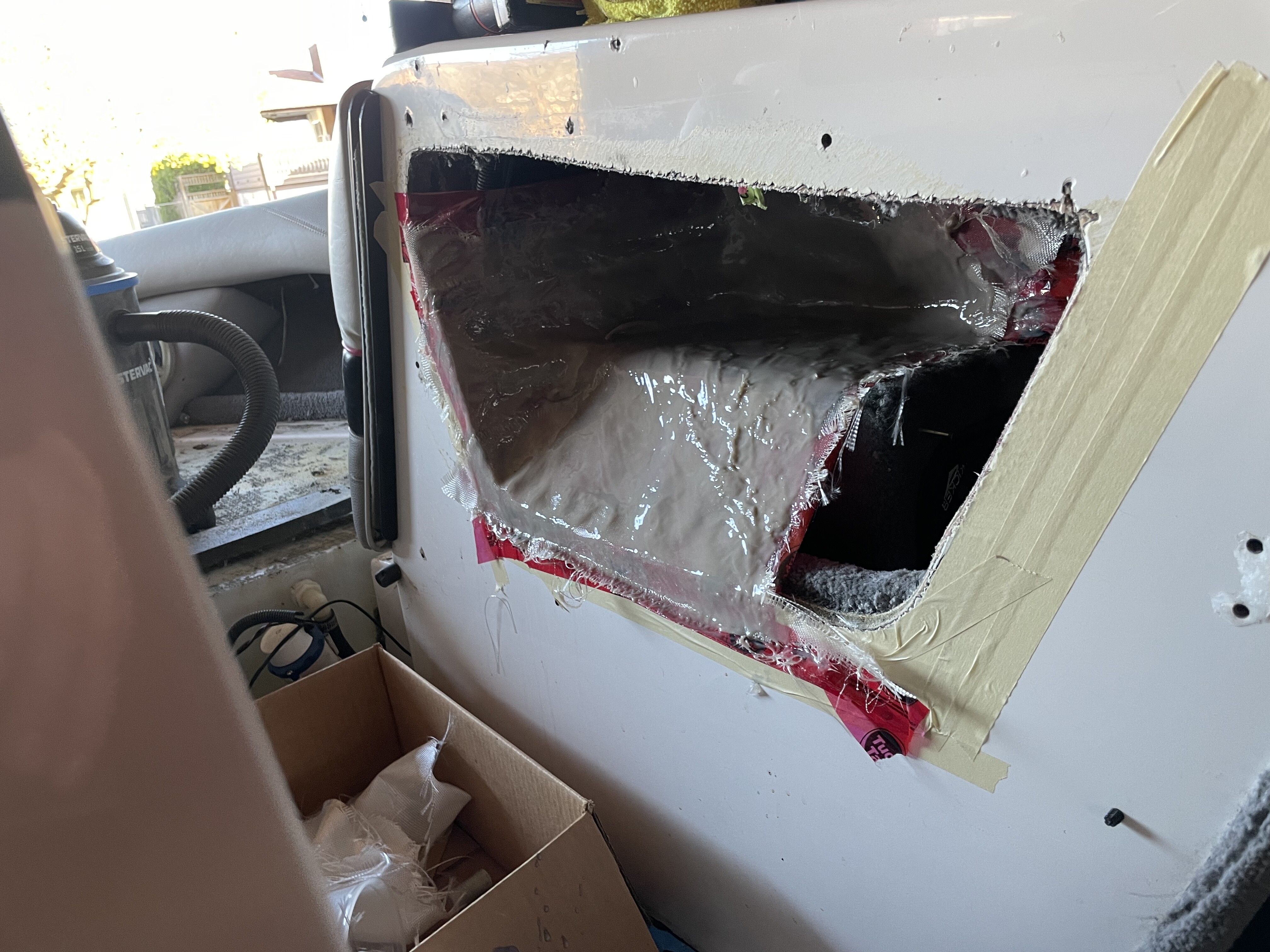

Here is a example of my side panel I have built a fibreglass box for.

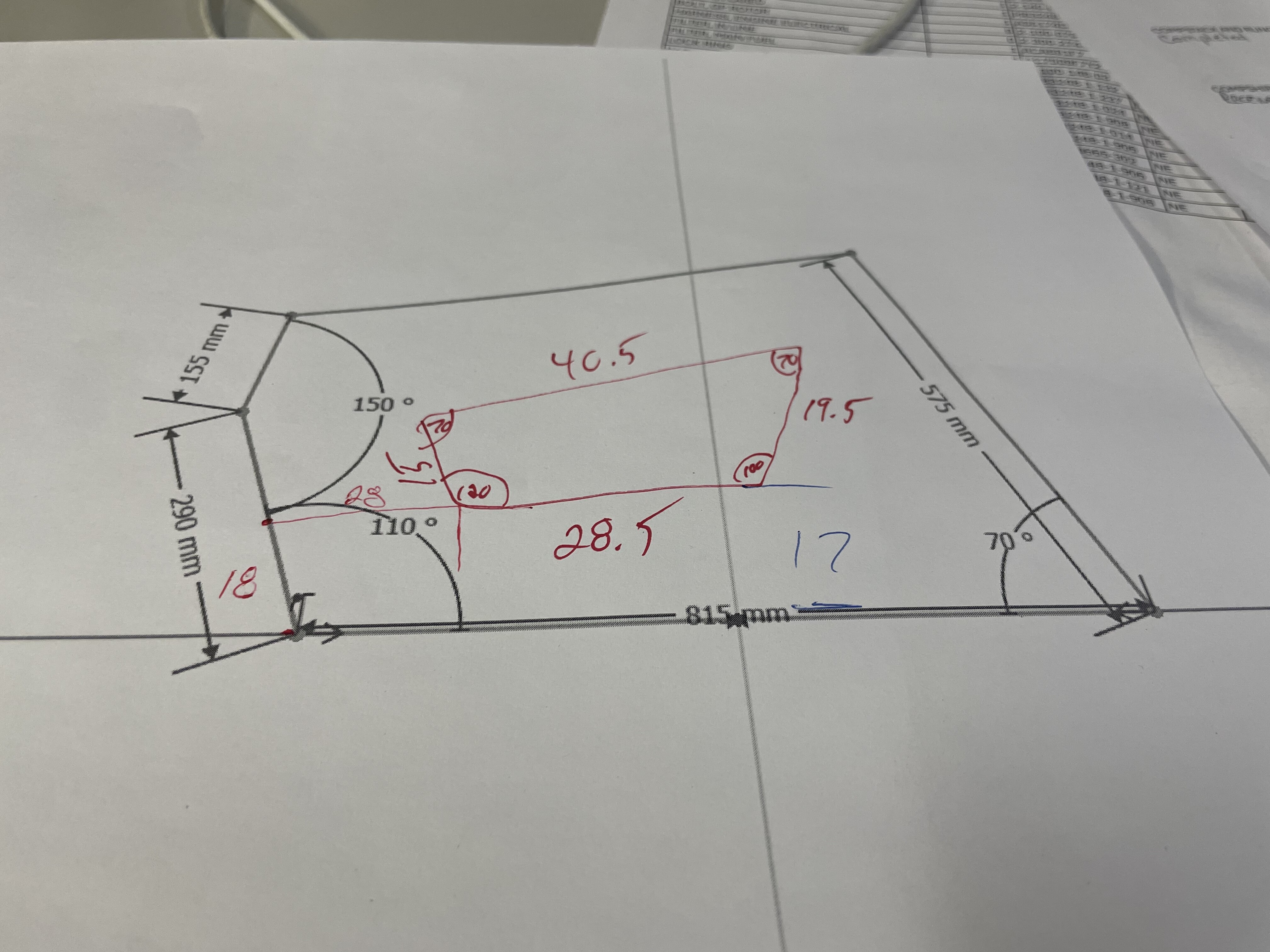

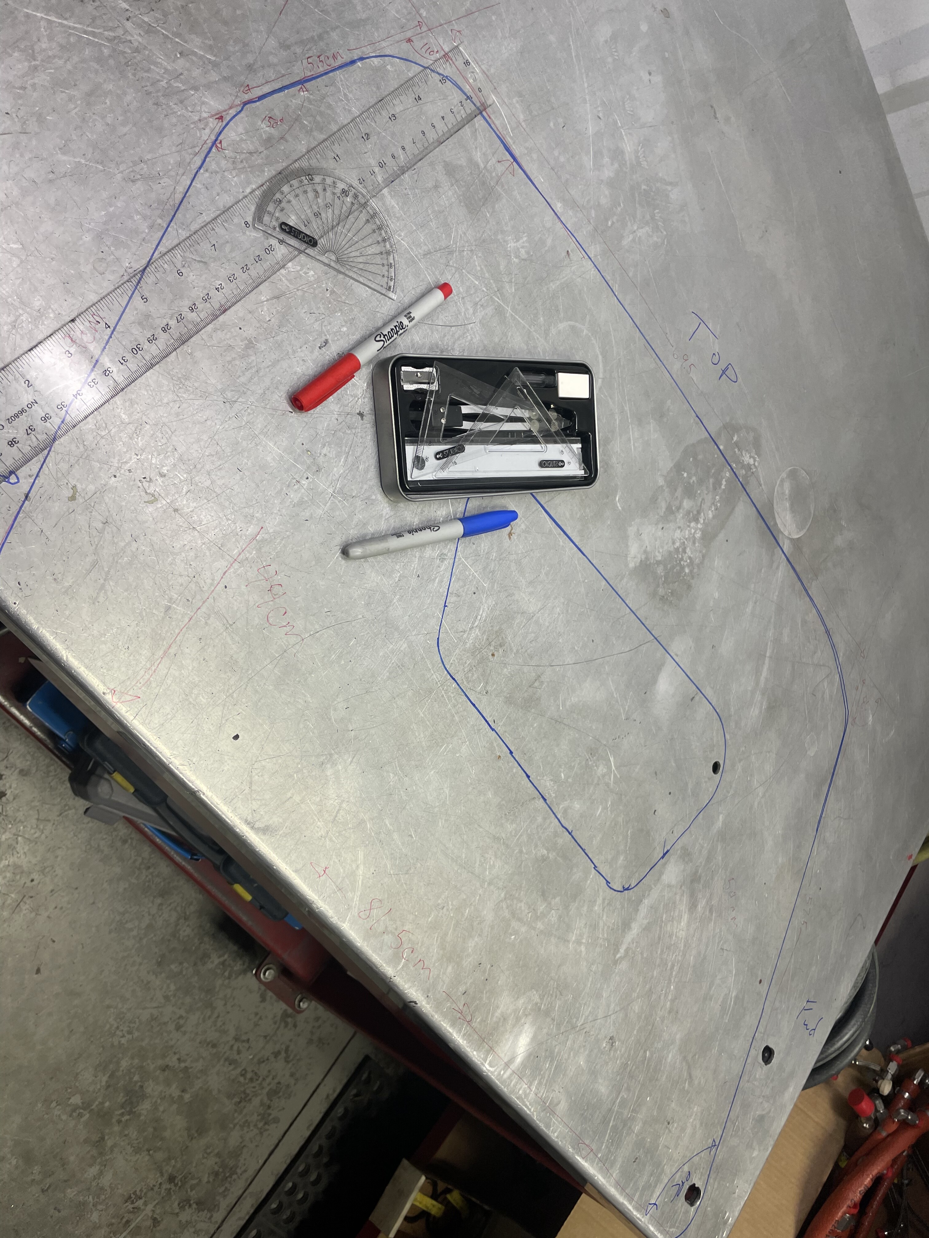

I layed the panel on the table at work and traced and broke out the old protractor. Then put it all into freecad. And cut a template out of thin ulay plywood. I was close but had one angle a couple gldegrees off so I modified and went on.

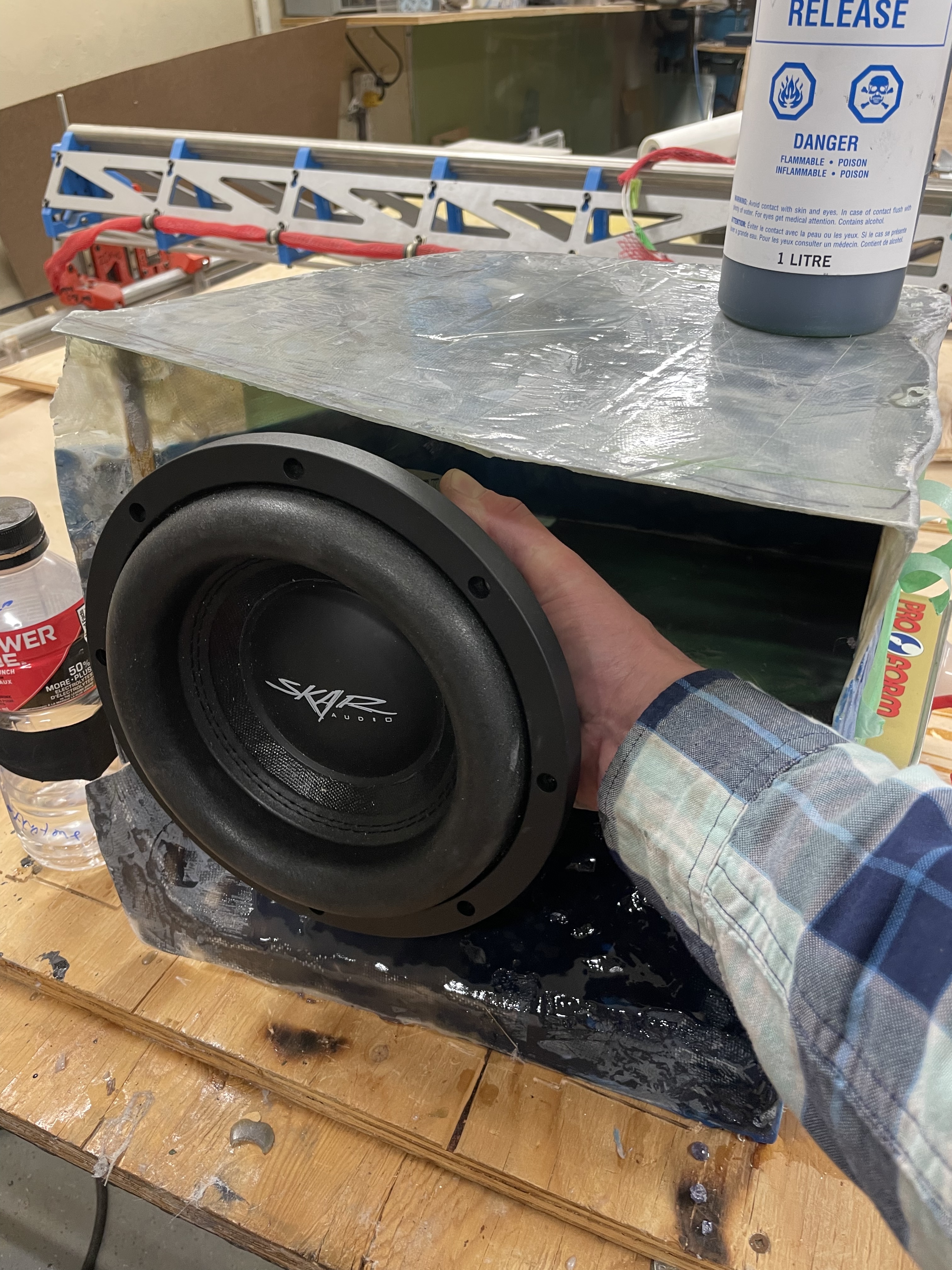

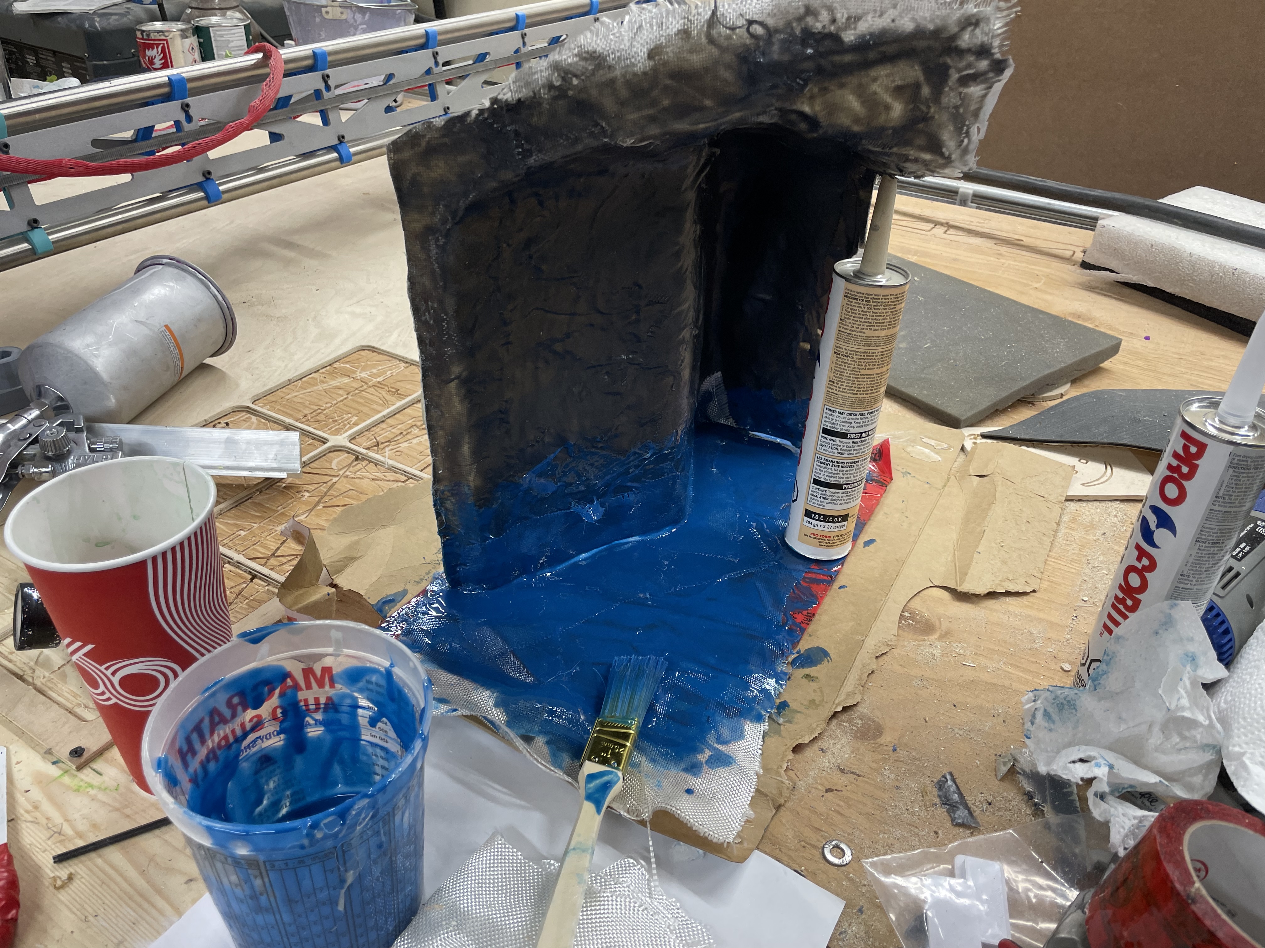

So I have a 8” dvc skar audio and it wanted .34 sq ft for a sealed box (which I don’t like sealed ones but I feel the birds kids and critters will utilize the port I am sure) anyways I thinck that was 9liter water volume I managed to squeeze 11 litres volume in. I used un waxed gel coat and a lot of cloth.
This is the start of the floor design and idea. I went with a 4mm border on edging and a 2mm for hatches. I did this so I could mix up the seams and not have to align one perfect. (That’s the idea anyways ).

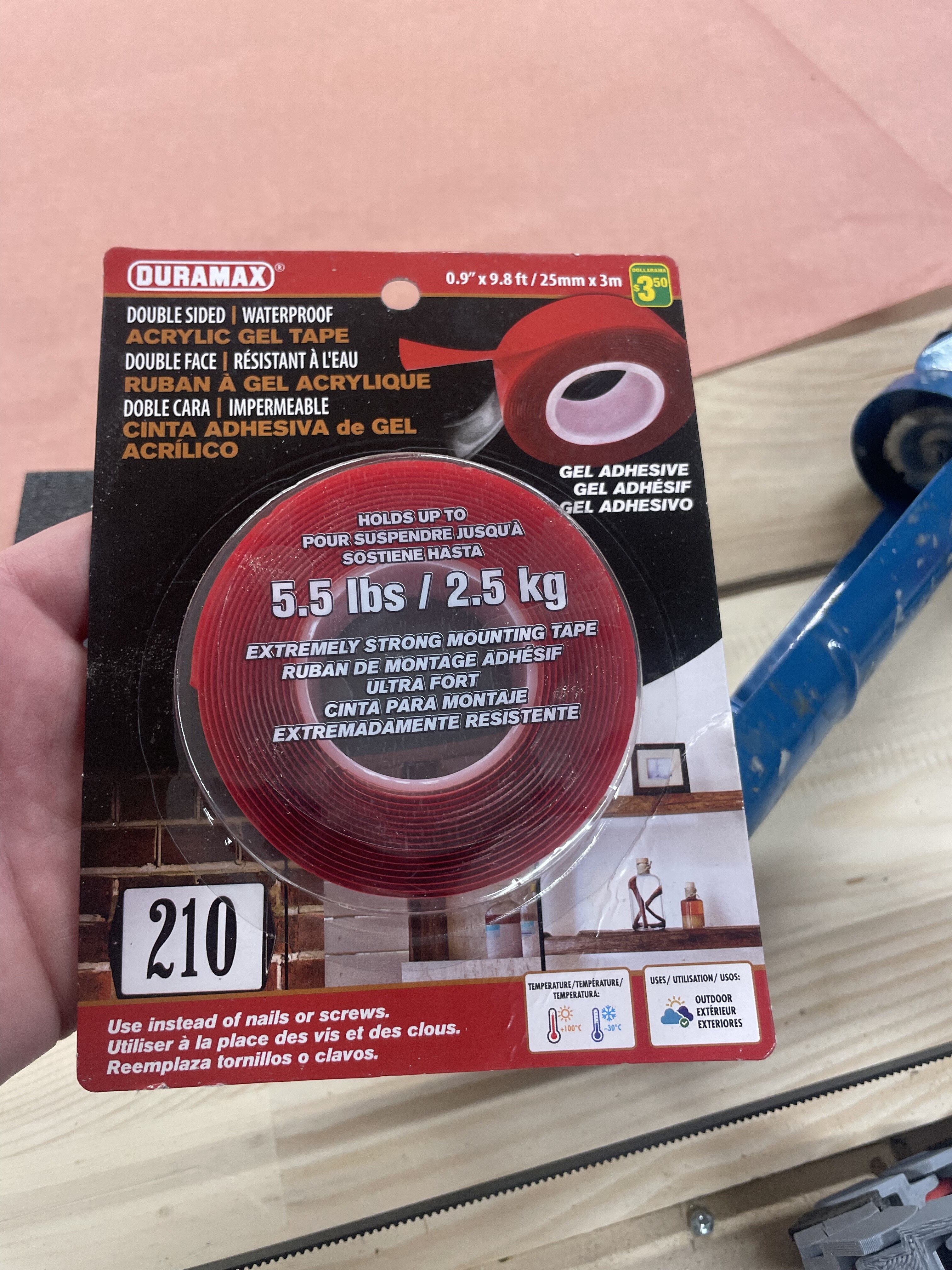

I have the same stuff I put on my swim grid 4 years ago. It has held up surprisingly well for the price I got it on Amazon. It’s pretty hard to find the non cut stuff these days it seems. It is in a rolled package right now I am going to use the clear glue kind of sticky tape. I get it at the dollar store it’s similar to that alien tape.

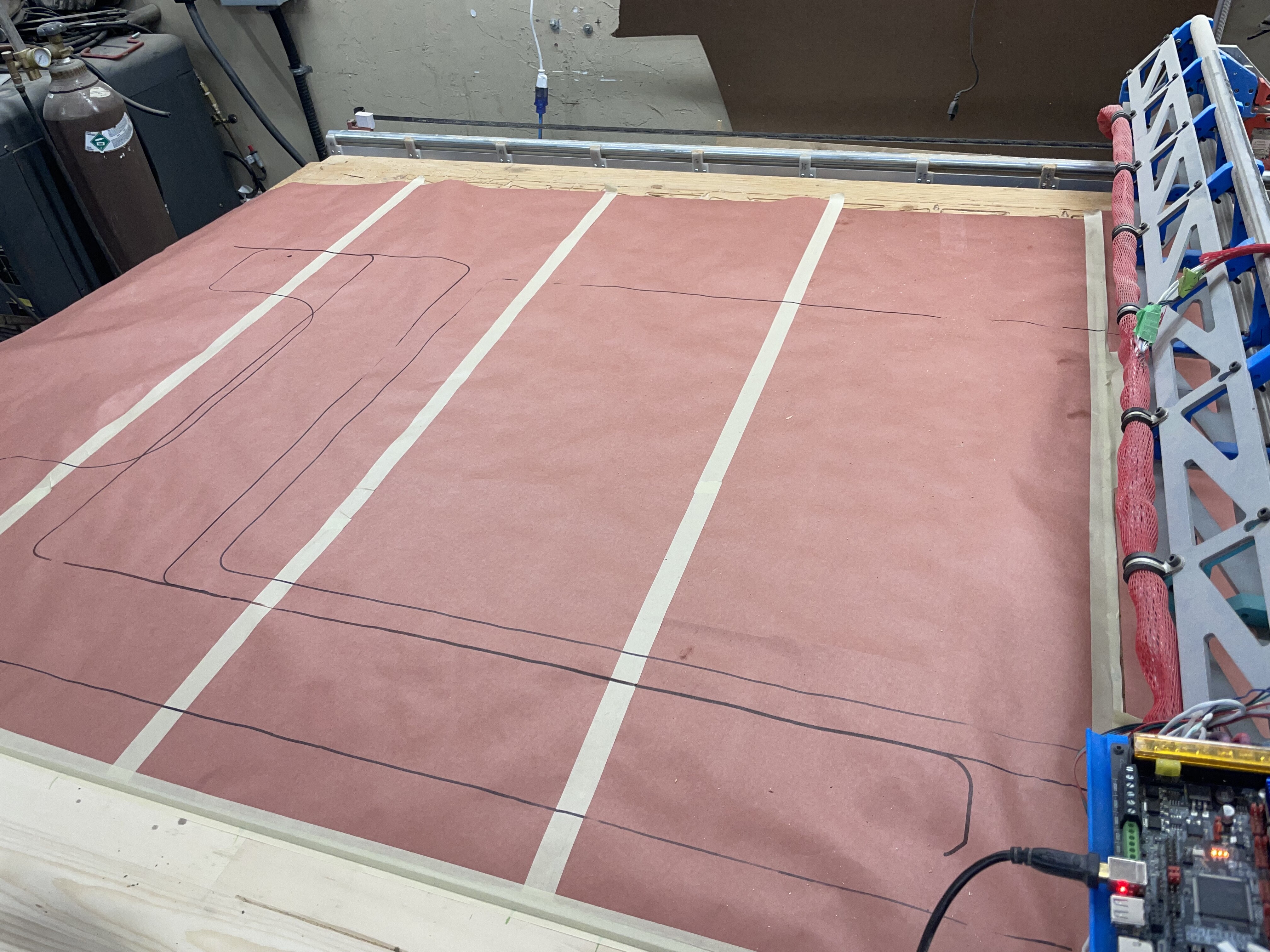

I printed a pen holder that someone on here made I think paolo was the name on the file. And started plotting my pattern to cut out and see how it fits and looks. I need to grab some more tape and ulay ply wood. Also have some single stage car paint getting color matched made up.

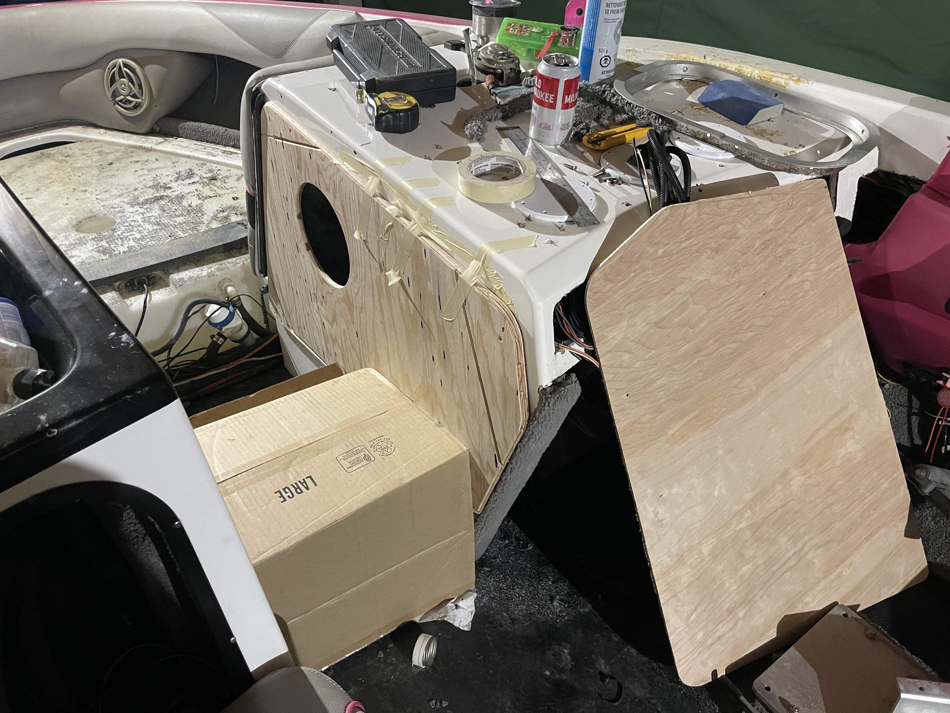

Not much update I drew the lower left and fuel lid panel and then cut it out to try the fit and boy was I off haha.
Took a couple revisions and tests but I have those two dialed in and now I am into the right rear.
I have to fix some radius and a bit of a boat hull taper but it’s coming along.

Hey mike yes of course I will take pics of the tape I am going to use and I will link the listing.

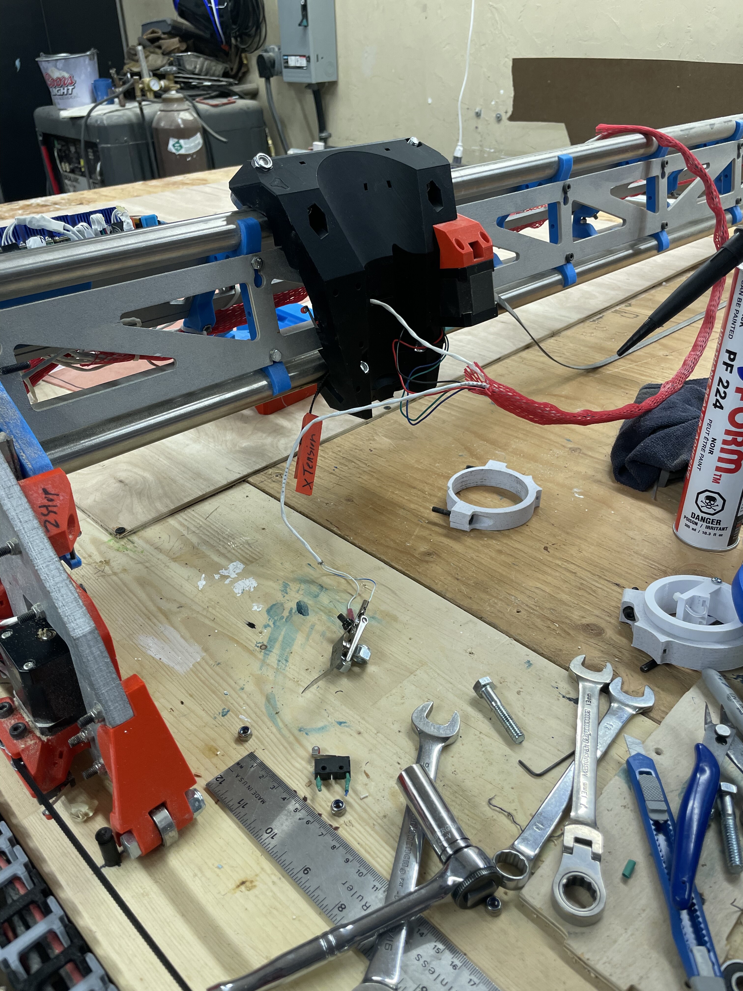

I was like “why is my core so loose”.Well I guess it’s print a core tonight lol. Original was a print fail save anyways.
Oh :poop: That’s a hell of a crack there LOL. Don’t believe there is any limping that one along lol.
We are almost back in business for the record it was a major delam issue and I should not have really tried to fix and should have just started back from scratch.
It took me 5 revisions to get my right rear panel to what I think is ok.
And the captains foot are is close now so I think that should work better than I just have the hallway to sort.
Well I got the template done it took about 40 or so revisions for small fixes. Core is installed and working great. I have a fuel tank seam I have to finish filleting, I stuffed a airline in there with seam seal so I can just pull the air hose and it will separate the panels for removal if I ever have to.
Also got my sub box side panel template done. The end is near it’s 30 degrees today and it’s dock install party time today.This is the best tape I have found for sticking pieces down. It’s at the dollar stores. Also was on the roof last night and got the northern lights pretty decent.
