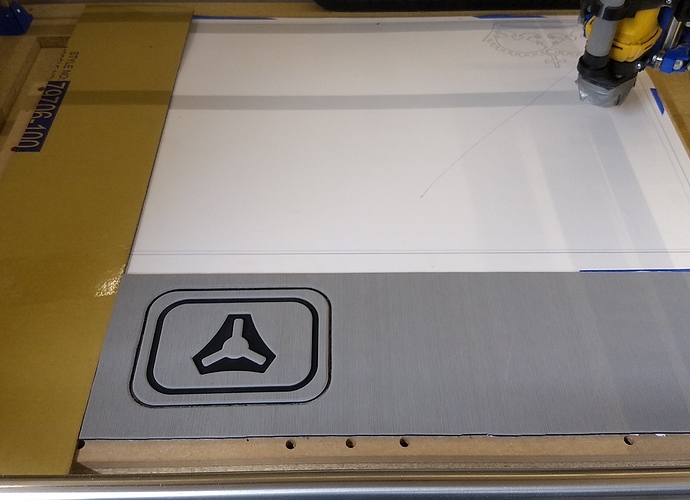

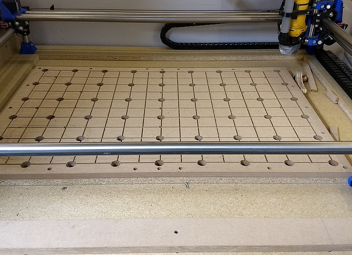

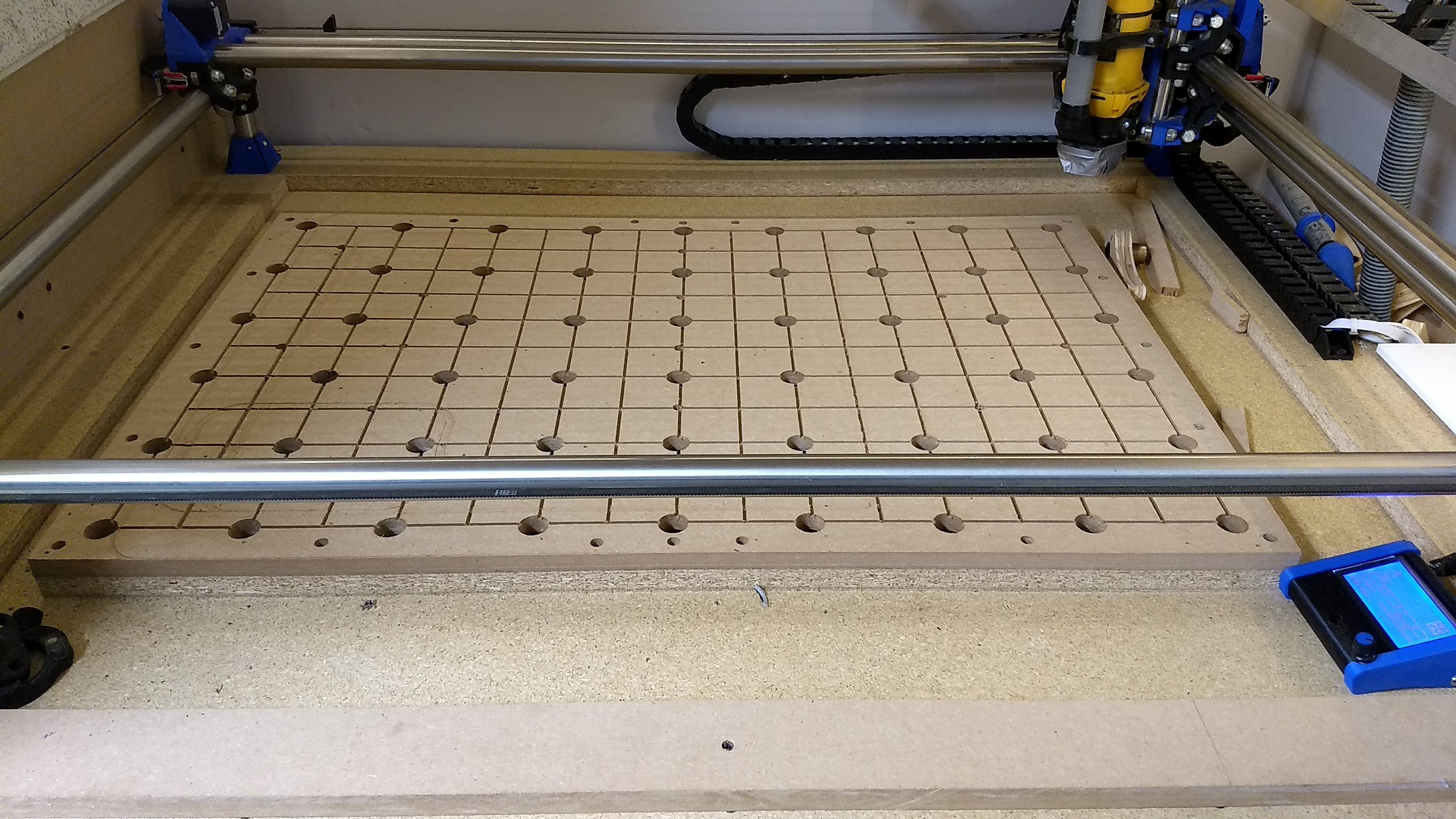

Hi guys,

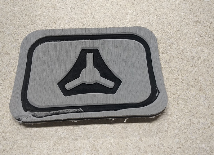

Trying to mill some Seadek which is a popular Marine deck covering made from eva foam. The stuff Mills far better than I expected but I am having trouble securing it to my wasteboard. It has an adhesive backing which is pretty much impossible to stick anything to. It laughs at super glue and painters tape.

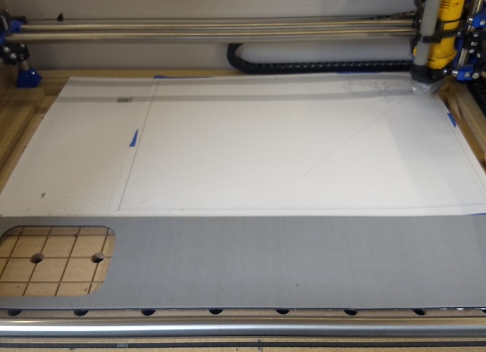

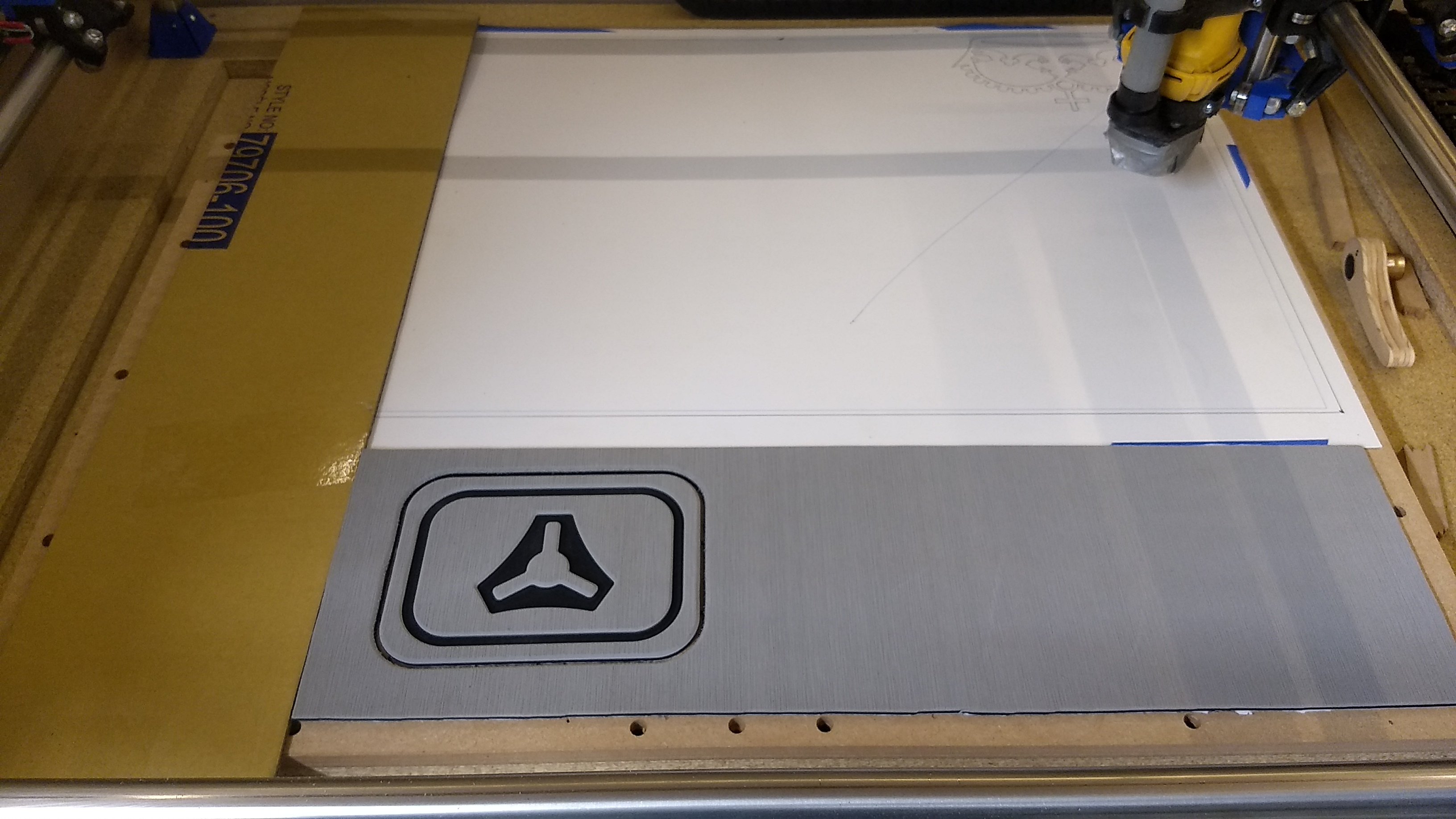

I made a quick vacuum table out of my wasteboard and it kinda holds until I made the thru cut around the perimeter.

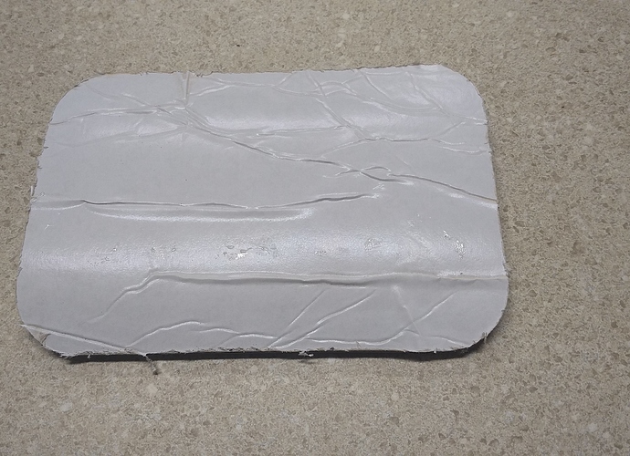

The center section milled nicely as it was still flat on my wasteboard, but things went bad when chamfering the perimeter

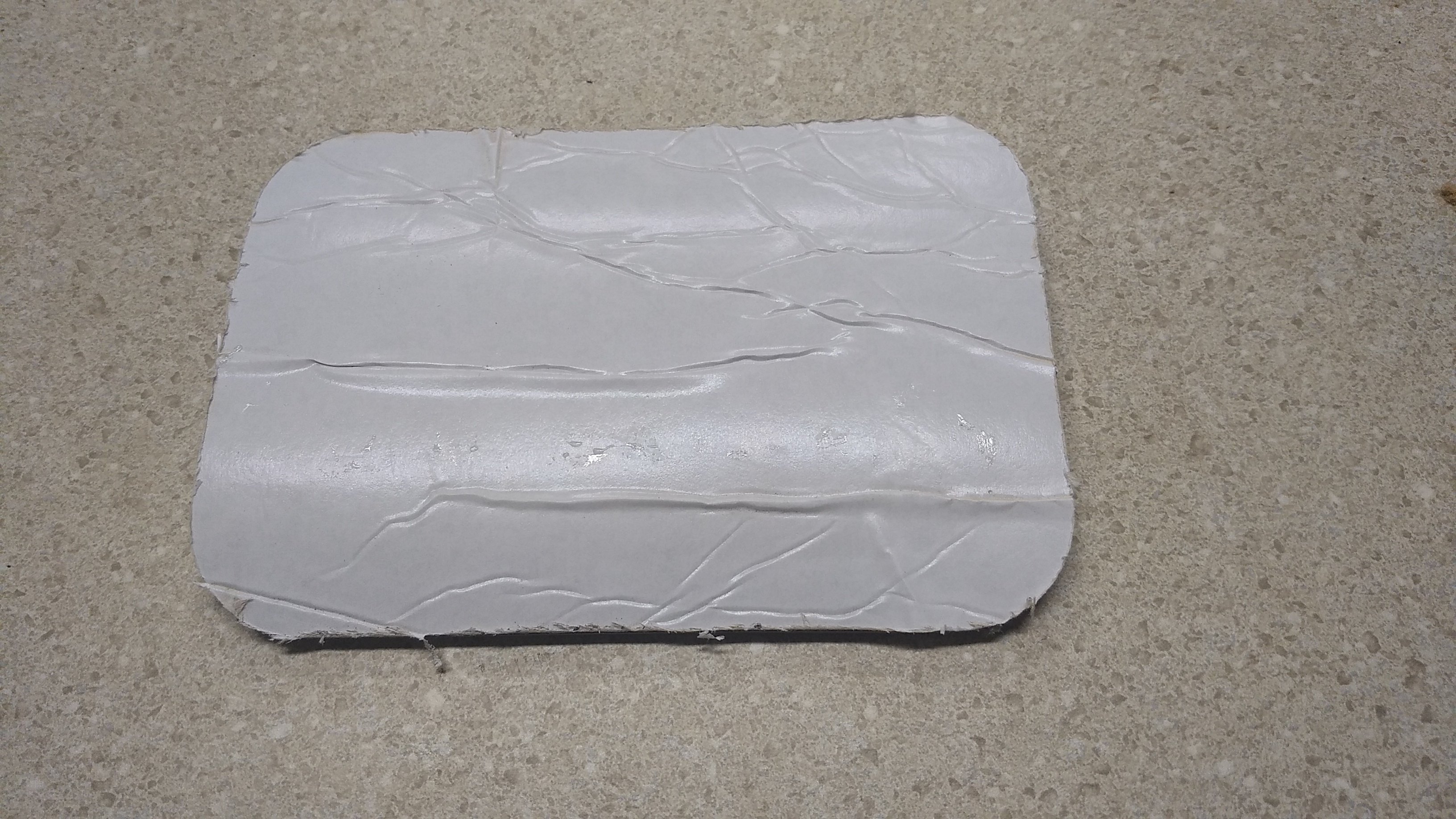

The material is shipped in a roll so it has some memory and the backing kinda bunches up.
Any thoughts? Should I rethink my vac table? The big holes were already in the wasteboard so I kept them. The table holds rigid material like sheets of ply incredibly well…can’t even budge them.
A couple pictures of the vac table

I will try the rubber cent and wood strips, though I will likely need a lot of rubber cement to do larger pieces. This was just my first cut for testing purposes. The real work will be pieces close to the full size of the wasteboard which would prob require a lot of glue!
I’m wondering if maybe an extra set of grooves cut into the wasteboard might spread the vacuum more evenly around the part? I did the perimeter cutout with 1/4" end mill. Maybe try an 1/8" next time so that I loose less vacuum when cutting into the wasteboard?
Also I have the material I am cutting laying flat to try and take some of the set out of it. That was a cutoff from the end of the roll, the center looks to be flattening a bit better and does not have as many creases in the wax paper on the back.

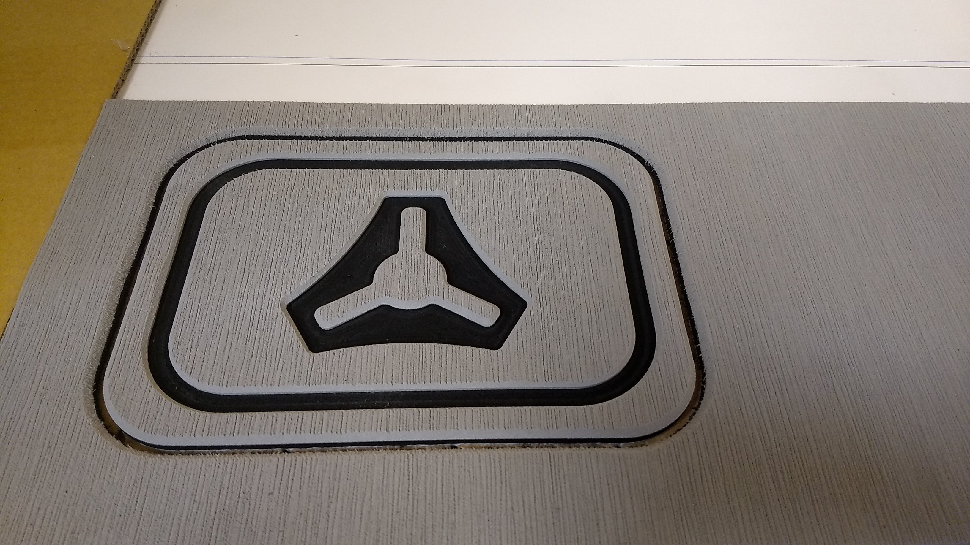

Trying to achieve something like the picture below
Do all the thru cuts last. Then as they finish put some printer paper over the cuts to hold the vacuum.
So you’re making custom covering for the decks of boats? Pretty cool. The rubber cement is just for the middle to prevent lifting You can do a bunch of splotches instead of the whole thing.
I agree with Barry about the vacuum and covering but I think I’d try saran wrap to cover the cut-through holes. It’s going to pull down better. Just don’t get it near your bit. The paper should work fine too. Just some thoughts to try and see what works best. Are you cutting one big sheet to lie on a boat deck (single piece floor) or are you cutting square panels that are then glued down like floor tile? The strips of wood can be screwed down directly in multiple places to your wasteboard along the edges. Run the crews through the material. When you get to the opposite side, pull your material tight and screw dow. That should help the vacuum keep it down. I would do the cut-through parts last by generating the cutting paths separate from all the other cuts. I have Aspire 9.5 and I can create that and rearrange which paths are last.

Looking at the vacuum holes on your table, those are way too big. A lot of small ones would keep the suction better when a cut-thru gets near.
On yours, the holes are so big the vacuum suction is lost the moment a cut-thru hits one. You could use 1/2" plywood and drill a 1/8" hole every 1/2".
That would increase the suction across the table even if you lost a little due to cuts. The more holes, the better the suction power. It’s reversed for air hockey tables but the same principles apply.

That boat is sweet looking. I like that decking. I ought to do that here in Louisiana. It’s the Sportsman’s Paradise. Too bad about the wasteboard. I get why you have that way. I saw someone on YouTube make an air hockey table with the underside having a sealed box. This permitted the air to flow through. I think it had like 15 small fans connect to 15 chambers. This created a constant velocity. Using this idea in reverse, if you could do that. each chamber only has a small area of suction while the one next to it has full suction. And the more small holes, the stronger the holding power. I’m old fashioned. Some 1x 1/4" thick wood strips screwed down (predrilled holes on the strips) and nothing moves.
Plug the holes where you’ll cut through the material. I think you can find caulk backing foam that diameter. Cut some plugs and jam them into the holes that get a cut over them. Should still be enough vac elsewhere to keep everything down.
Or cover the holes with painters paper tape and poke a bunch of nail holes in the tape to allow the suction. KISS rule and me being a cheap ass bastard. :slight_smile: lol

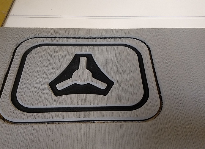

Anyways, I flattened the hell out of the stuff over the weekend and took the creases out of the “waxed” paper backing. Plugged the holes where I was working per Barry and Mike, changed the cutout tool to 1/8", ran the same gcode again and it went pretty well!

That looks so clean. Seems to mill really well now that you can hold it.
Wow, that’s much better. You might get several new bits so they cut sharp edges. My only concern is how the bit cutting edges will hold up when cutting rubber and synthetic cloth material. Get a good magnifying glass to inspect your bits after every cut to determine how long they are useful for - consider it my quality control advice for your business.
