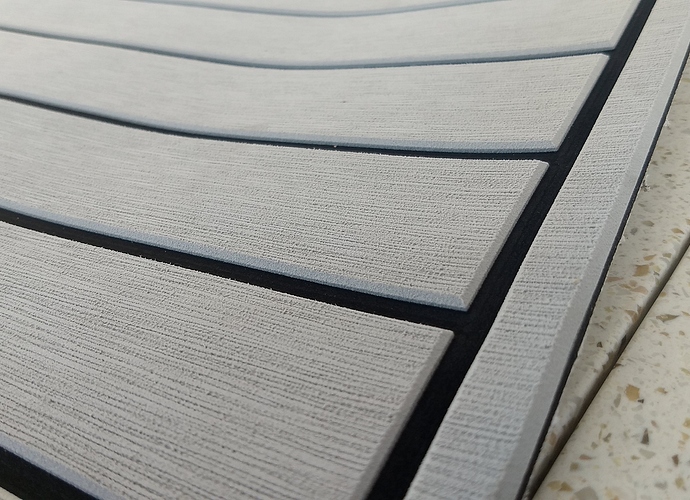

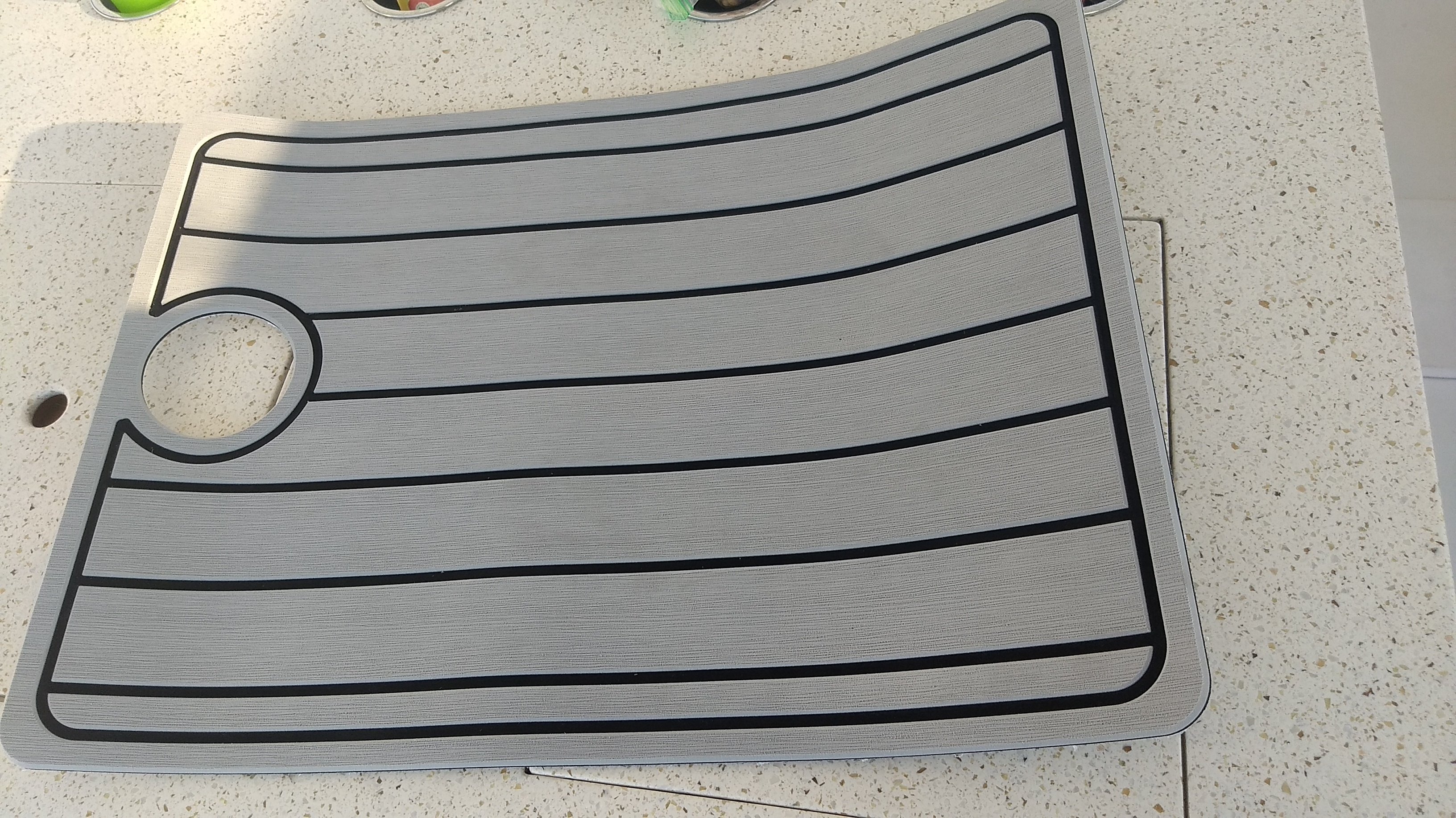

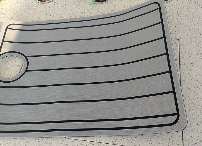

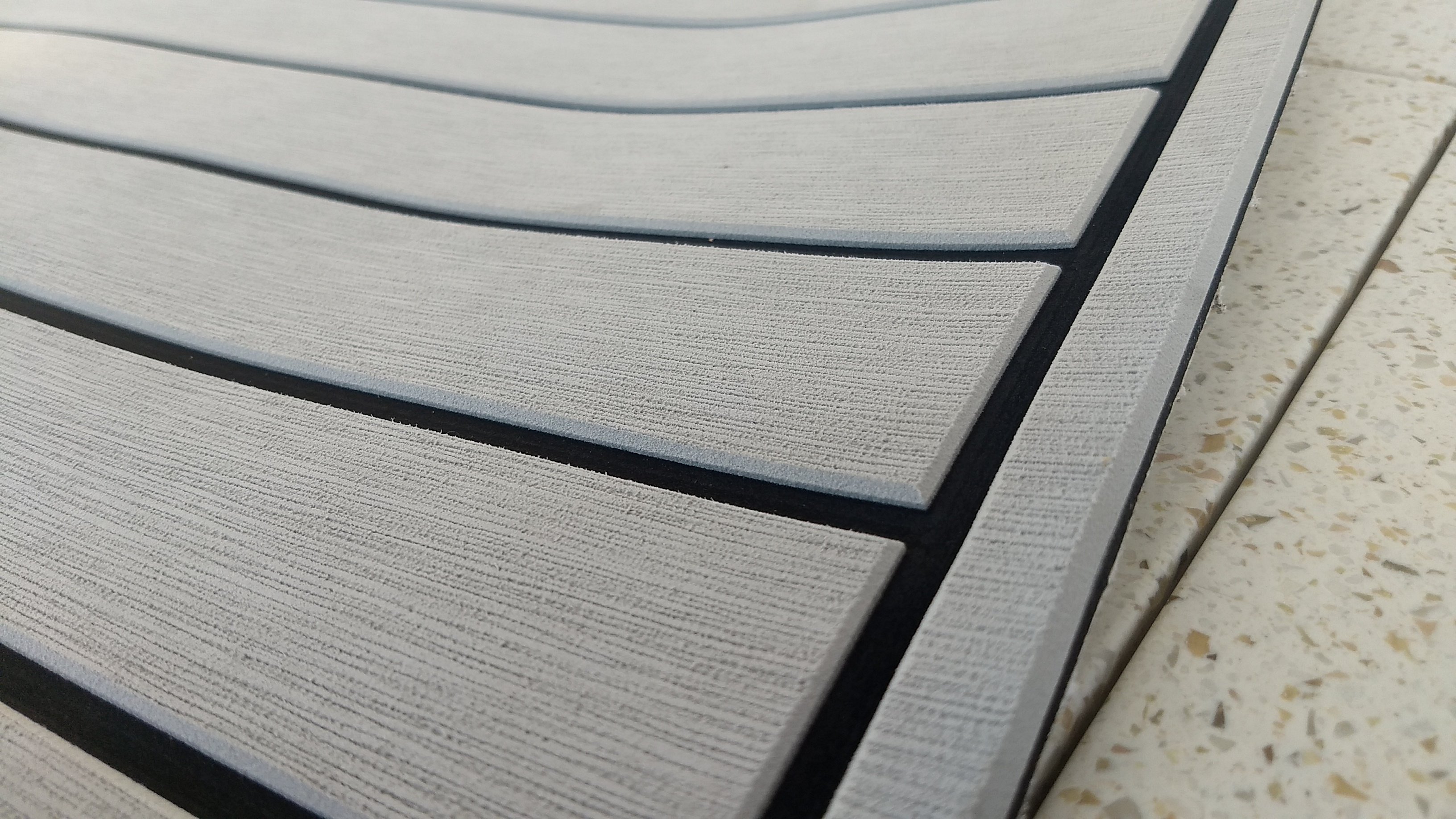

Figured I would give this thread an update. A little masking tape around the edges and all is well after flattening out the material. Been cutting out some simple shapes so far and have not needed to template or measure much. Thanks for the advice on templating Tim! I will be sure to give it a go. I am hoping. To find some material whether it be hydroturf or Seadek locally so that I might be able to purchase it without being rolled up. I’ve gotten a ton of interest in it so far. Currently cutting interior cabin deck pieces for my own boat. I am very happy with the results so far! Cooler tops and fish rulers next!
That’s really clean work! Nice.
