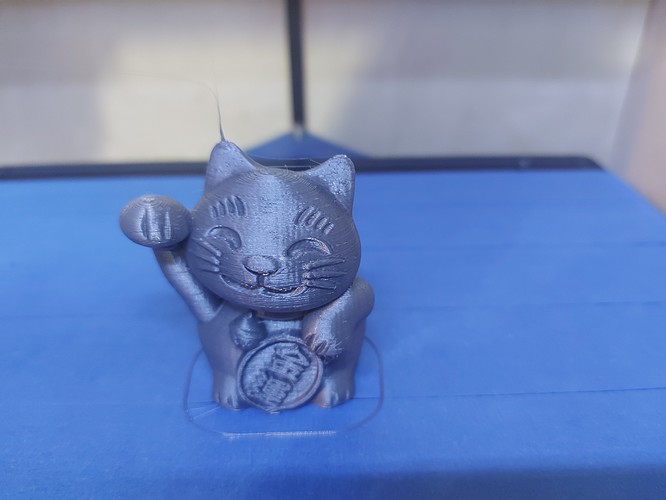

The current state of printing.
I have more of these little cat statues than I can shake a stick at now. Kind of like lots of people have benchys. (BTW, I’m pretty good at shaking sticks at things, so that’s lots.)

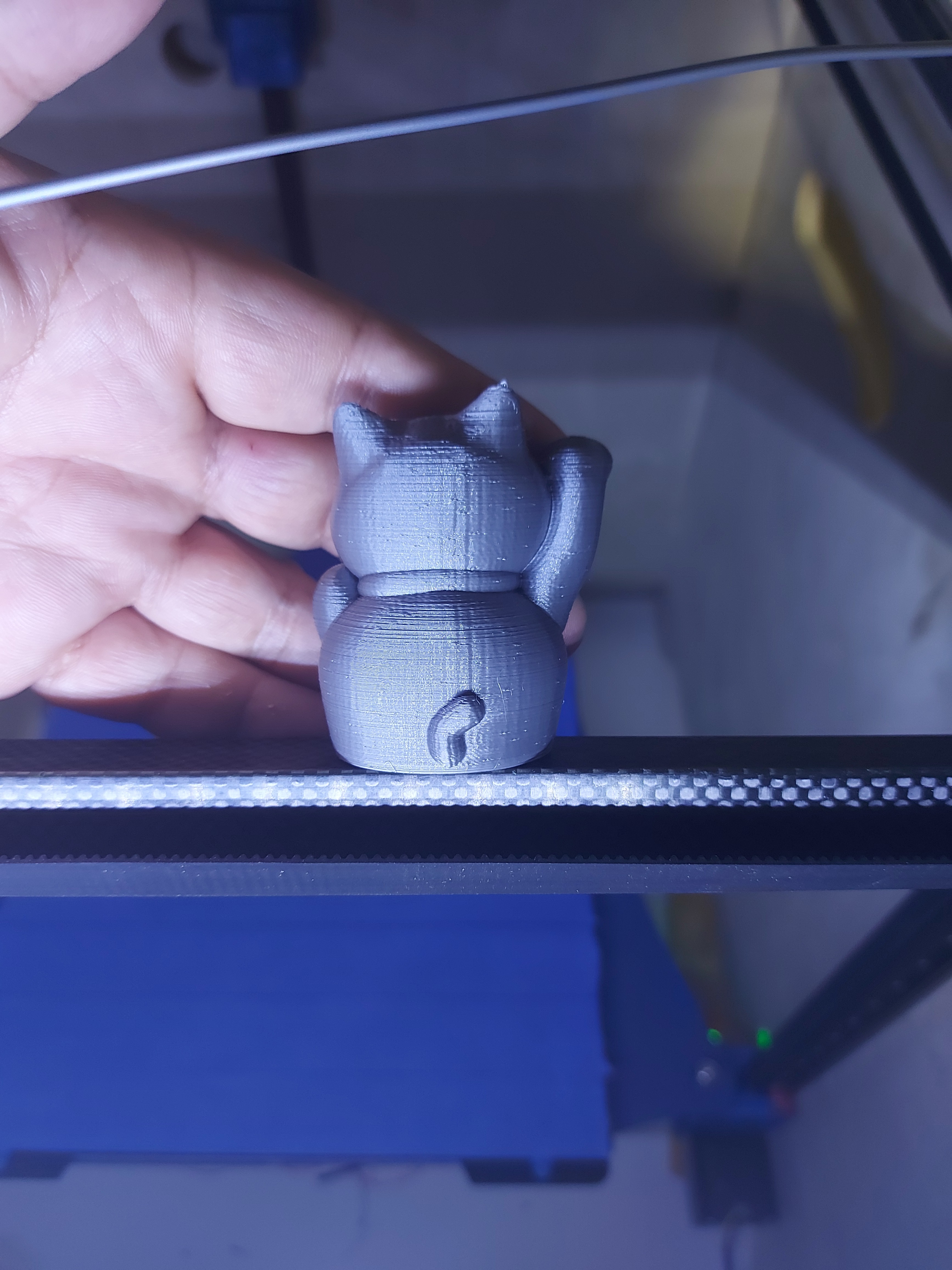

There is a ripple in X that I was chasing down, but I think it’s unavoidable…
The pattern is the same width as the weave in the CF tube. Maybe one day I’ll buy some Aluminum square tube, but in the meantime, I’m probably stuck with this. It’s not that bad, I can’t feel it at all, and the light here was set up to increase the visibility of the ripple to a maximum. It goes across the whole width, remaining constant in the X axis. Y appears to be immune, but of course Y is on the linear rails. Obviously not all CF tube is going to be equal.

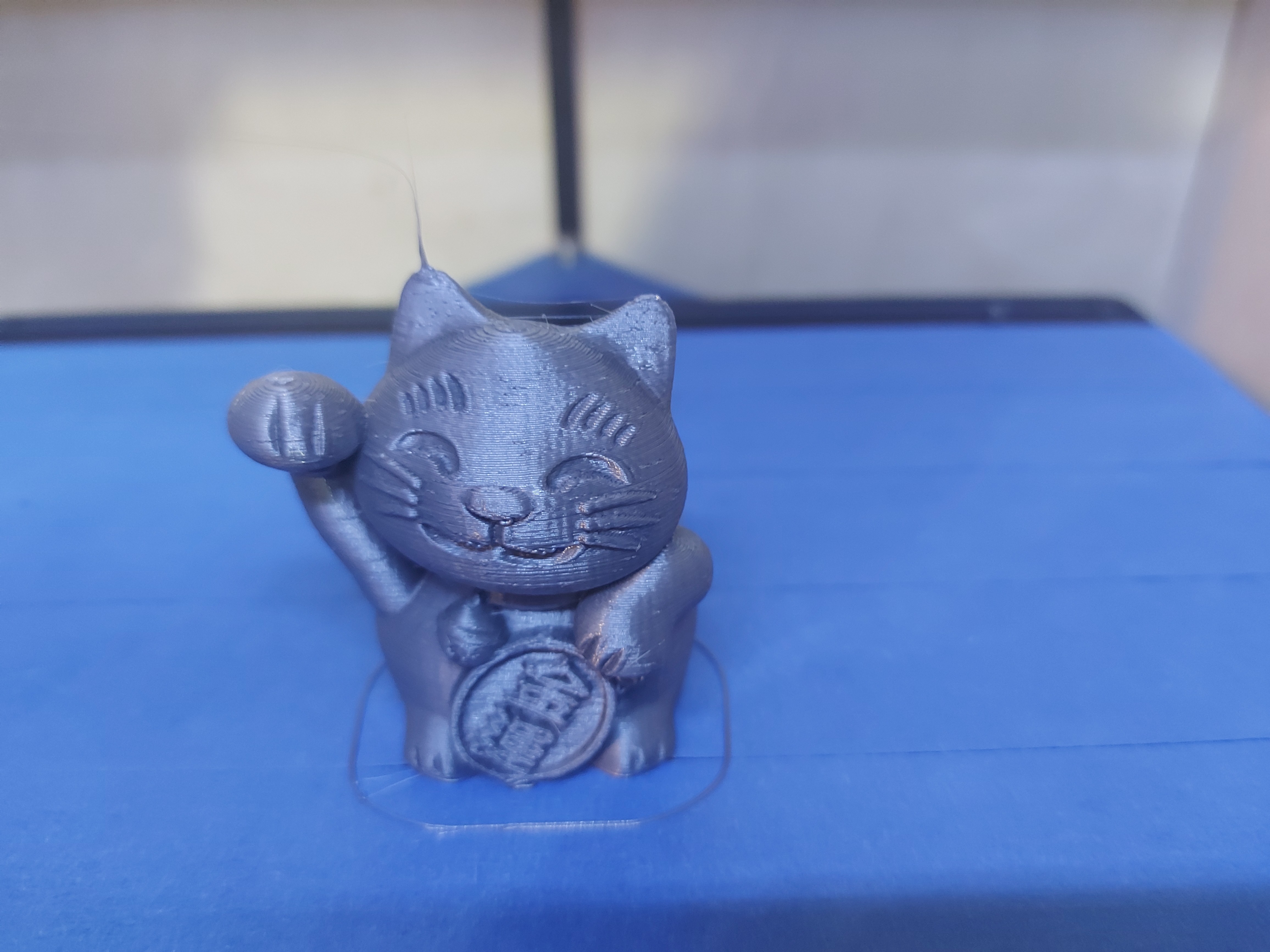

Print speed is fast. This was ~60mm in height, 6 layers/mm. Overhangs are very good, though not perfect (under the paws, you see some sag) Ringing is extremely faint, where I can find it at all.
Once I get the bed adhesion sorted, this will be great.
One thing that is probably related, I’ve never done much slicer tweaking with part cooling, because I’ve hardly ever had part cooling to tweak. The fan comes.on at layer 4 (disabled first 3 layers) and stays on. I thought I basically wanted it on for fast layers (like at the top with the ear points where it slows down) and bridging. I’d rather not have it on encouraging the parts to lift and curl, so I’ll have to figure out what logics turning it on, So I can get it to do what I want.
What’s the distance between lines on your ripple? I’m betting really close to 2mm.
I knpw where you’re going with that, and it’s close, but not exactly 2mm. It does exactly line up with the CF weave in the rod – or at least as exactly as I’m able to measure with this model. Also, it doesn’t happen in Y at all. I also tried lining it up with a piece of GT2 belt, and it drifts very slightly across. I’ll see about getting a picture of that relation. (It would make sense if the belt were stretched, but I checked relative to the belt across the X axis.)
I have seen similar ripples caused by using smooth idlers on the toothed side of GT2 belt, but I’m not doing that. 2 smooth idlers, 9 toothed ones in the BOM for this printer.
When you do more or less tension on the hub, how is that pattern effected? I do not have that at all.
Does that pattern change at different locations on the bed?
Heck, maybe try a straight wall across your bed to see if there is a larger pattern. Urethane wheels, and a lot of them, should significantly dampen any pattern that could possibly be there. I will have to try and introduce one on mine and see what happens. Your wires are not dragging on anything, spool is free?
You should be using a ptfe tube on your hemera anchored at the hemera and to the frame. So the filament does not influence it at all.
You can rotate the CF 1/4 turn as well.
I am just thinking your tube, if it had a texture, should not have one all the way across, or equal on all sides. So a large wall the width of your build area would reveal that, and if it was perfect all the way across it absolutely has to be something else. Wheel with a bad bearing or flat spot, off center idler or bad bearing. And this also double checks that another model/slice does the same thing. Speaking to that, is it the exact same at different layer heights?
