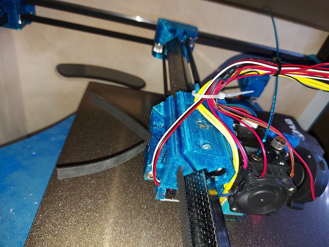

Still trying adjustments. I think I’ve dialed in hub tension, it’s possible to twist the hotend, but it doesn’t want to. I’ll play with it to see, but just getting bed adhesion has been a fight so far.
It is not uniform across. The pattern remains the same at height, and is the same in X. So if it does it at one X coordinate, it replicates at the same X coordinate regardless of height, or Y location. Some places are more subtle than others. The silver filament shows it most prominently. There is one spot about 1/4 of the way in from the left where the pattern is almost invisible, and it’s most visible just to the left of center (which is where you see in the photo.) At no spot is it actually bad. At it’s worst it’s very hard to see in red. You have to catch the light exactly right for it to show at all.

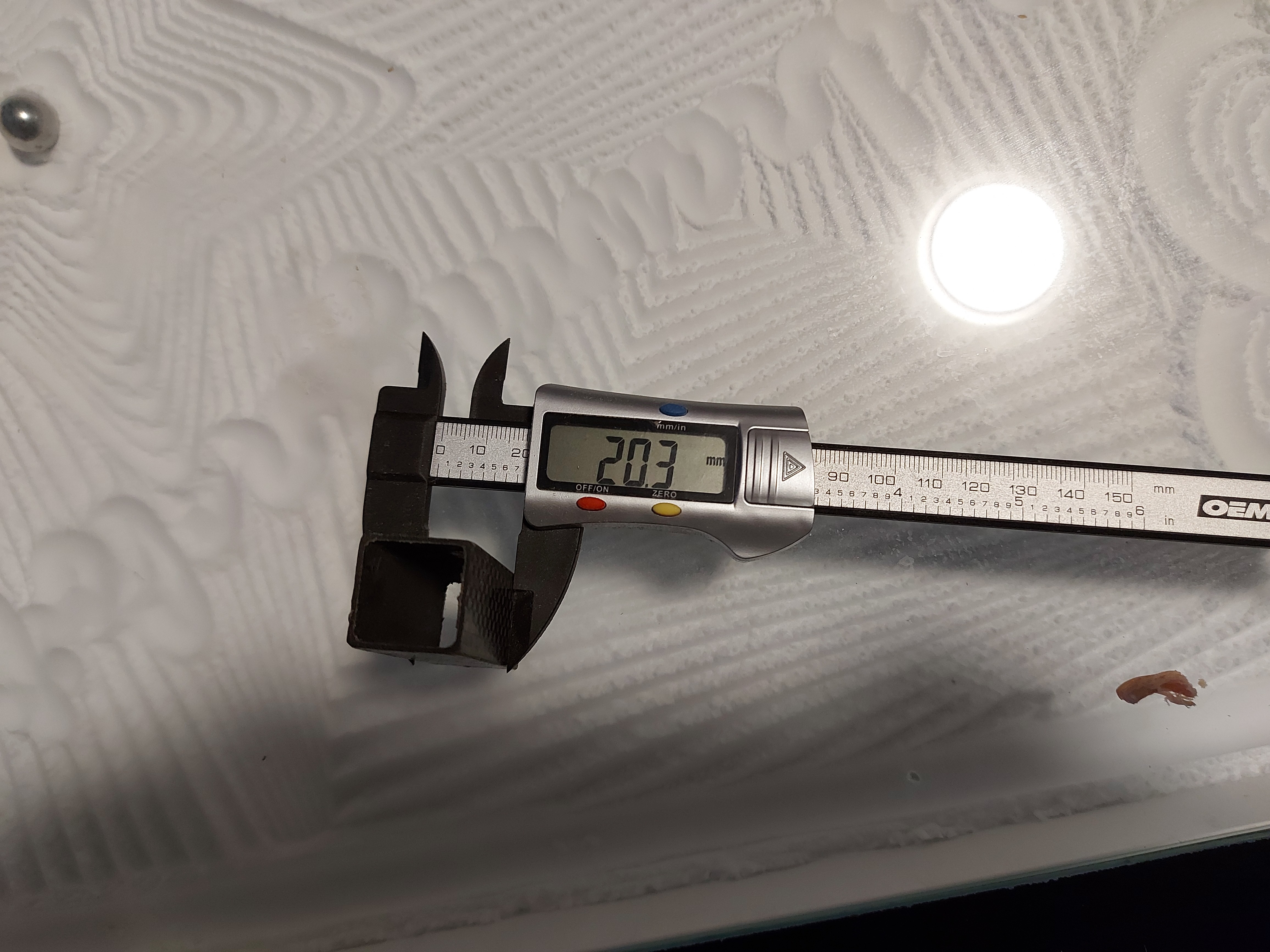

I should also point out that I never did get to the hub just rolling off of the tube easily. I had to cram stuff into my hub to widen it with zero bolt tension anywhere to get it as loose as it is, and I can still feel what I assume is the same pattern in the X motion. I believe my 20mm CF tube is a bit oversized, and my hub print is overtight.
Maybe a new hub print is in order. I will give that a shot.
I would think it would stretch a bit and relax. But it is a fairly easy and quick print.
Just out of curiosity, what did you use for infill and how many walls for the hub? maybe it is to rigid?

Because of where this is going to live, I didn’t do that. It’s supposed to end up in a closet with the spools stored overhead, so I don’t have the filament clip or the PTFE tube. I don’t think that’s the issue though. I do suspect the hub tension being too high. I remember measuring 20.2mm with my calipers on the CF.
I’m actually kind of curious if I could have made the 19.05mm 3/4" aluminum tube work with a bit of extra tightening. Maybe I’ll try to see with this hub after I.print a new one.
Just for comparison, while printing the new hub, I thought I’d show how far open I had to jam the current hub to still have it too tight.
It’s open probably about 1.5mm more than it was while printing. It had slipped my mind how big that difference is, until I saw the new one printing down there. Hopefully it’ll be a more accurate copy, and any variation in the CF tube size is unimportant. I have plenty of new POM wheels so I can still run my 3/4" experiment, just because.

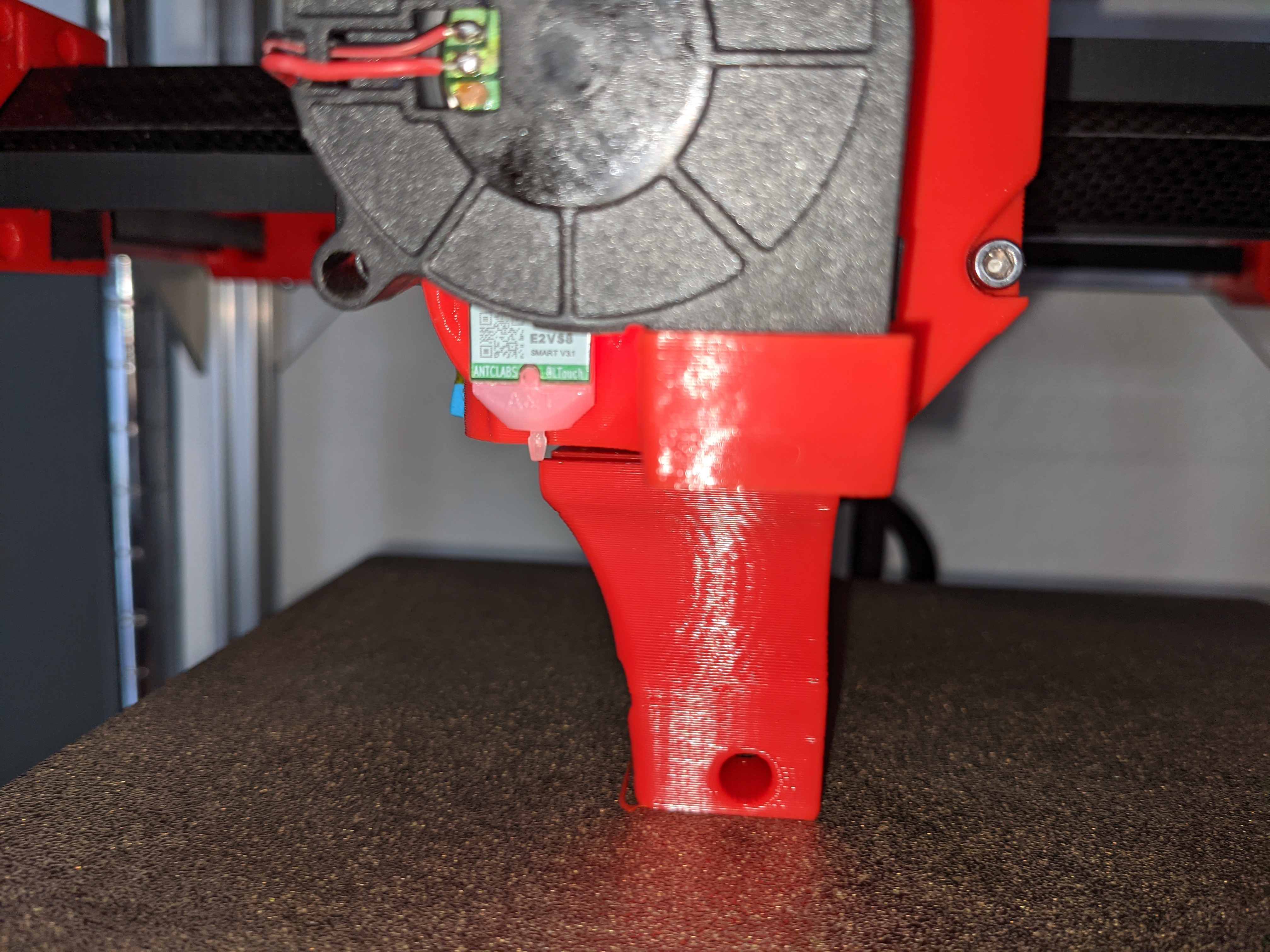

I did some prints yesterday all over my bed to see if there was anything. I would say there seems to be a bit more not perfect on the X faces, for me I am wondering if my belts might be too tight as the pattern seems consistent.
I need to print some more of the acceleration test piece, I think, from TT’s test page. That has a flat face in each direction and a diagonal. Then I can pause halfway up adjust the belts a smidge and see if it changes.
For me I am leaning to belts as I also have a super high frequency ringing on small holes, so I want to see if that changes or if it is a build thing.
Like you said though the prints are good, for me it is far more perfect than any prints I have ever pulled off a printer but there is something. I will do a few more prints today.

The lines curve… really hard to get a clear shot, very subtle.
That would be a pulley or idler right? On a curve the position is a little further or closer on the Y and Belt, but the same exact place on the CF rail. So this eliminates the rail, hub, and wheels??

I am going to loosen the belts a 1/4 turn and print another motor mount to see if anything changes…same gcode.

I can feel the weave pattern with my fingernail on the CF rail that I got. I’m actually not particularly happy with the piece, and am looking for a supplier that doesn’t want a ridiculous amount. The tolerance for 20mm is also more than a little sketchy…
That looks like pulley noise to me. Probably tension on the belt making it ever so slightly chunky on the smooth idlers. Curving like that (Try rotating the part 45°, I bet they’ll be straight then.) would be very typical the “noise” will follow one belt or the other, which on coreXY kinematics is at 45° to orthagonal.
I can get it to say 20.2 if I squeeze a bit at the jaws of the caliper, but that’s the tolerance thst I’m seeing with this piece.
