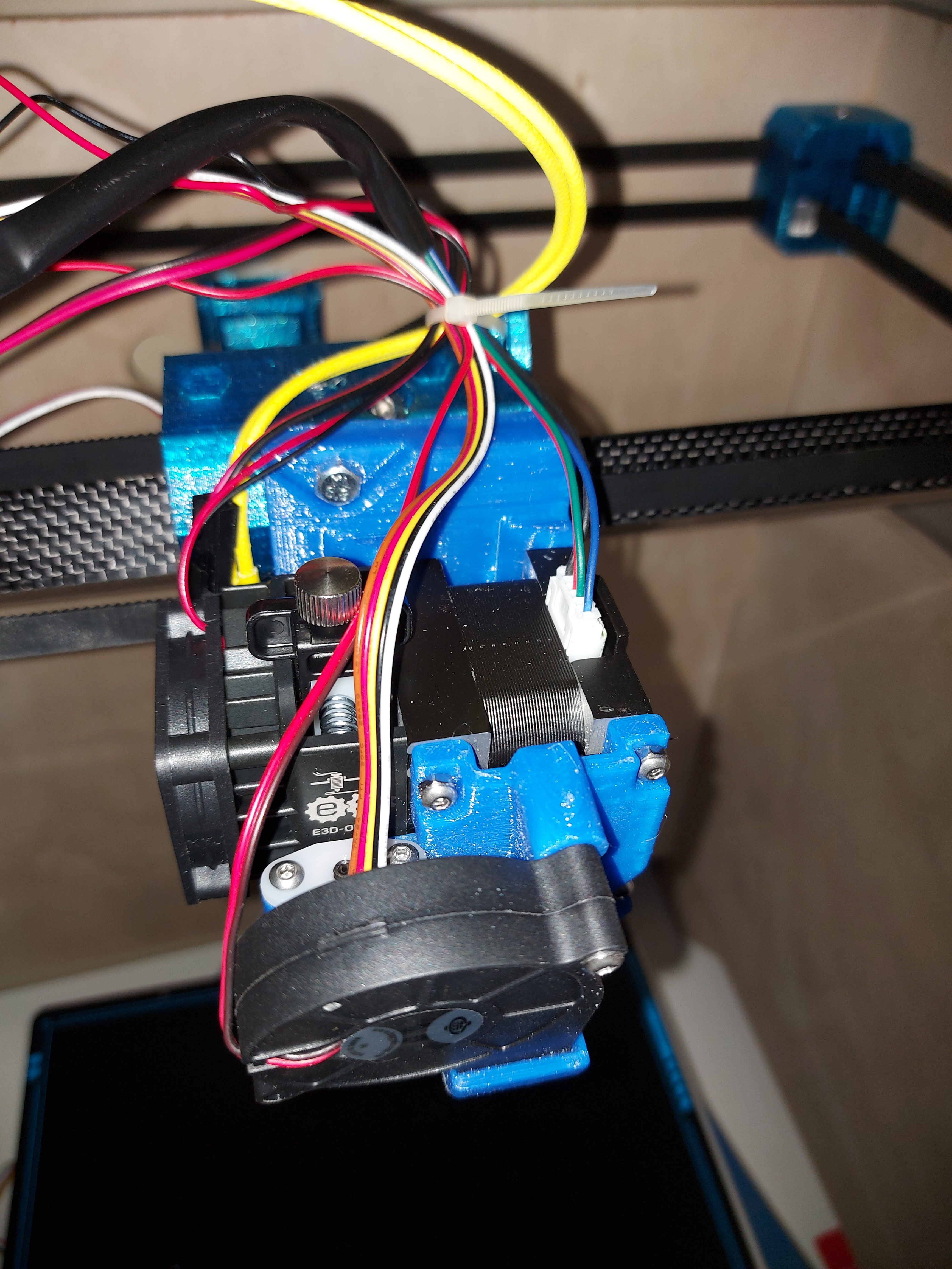

The Hemera comes with its own screws, I just used the ones in the bag. Well at least mine did.
I only saw 4, which I used to attach it to the tool mount. None left for the fan shroud. I’ll look through again, but that was all that was in the bag.
Oh man that is a bummer. I did buy 8 of those things so I guess mine might have only come with 4 as well. Sorry to get your hopes up.
You can edit the fan shroud to make the holes thicker to accommodate the screws you have. I should probably edit it to fit the M3x10 I use everywhere else that is not an M5. Thanks for the info.
Ohhhhh man people are going to hate me even more now. With CAD available I need to be careful not to tell everyone to just fix it themselves…
Mostly, I just don’t want to re-print the part before I have fan cooling so that the bridging isn’t so poor. (Actually, I think my printer did reasonably well considering the distance it had to bridge.) I do plan on re-doing the part. Maybe what I’ll do is edit the .STL for the shroud, and fasten it with some quick 'n dirty 2mm washers for the time being. The fan shroud has more room for that than the mount, so it ought to be fine.
Yeah, I think that the tool mount plate is fine as-is. If you still have some tweaking to do to the fan shroud, maybe editing it for the M3x10 screws would be best. This form looks good, and the BLTouch mount looks great.
I was worried about that bridging as well, I had originally made it without the inner ribs, and surprisingly it still worked for me.

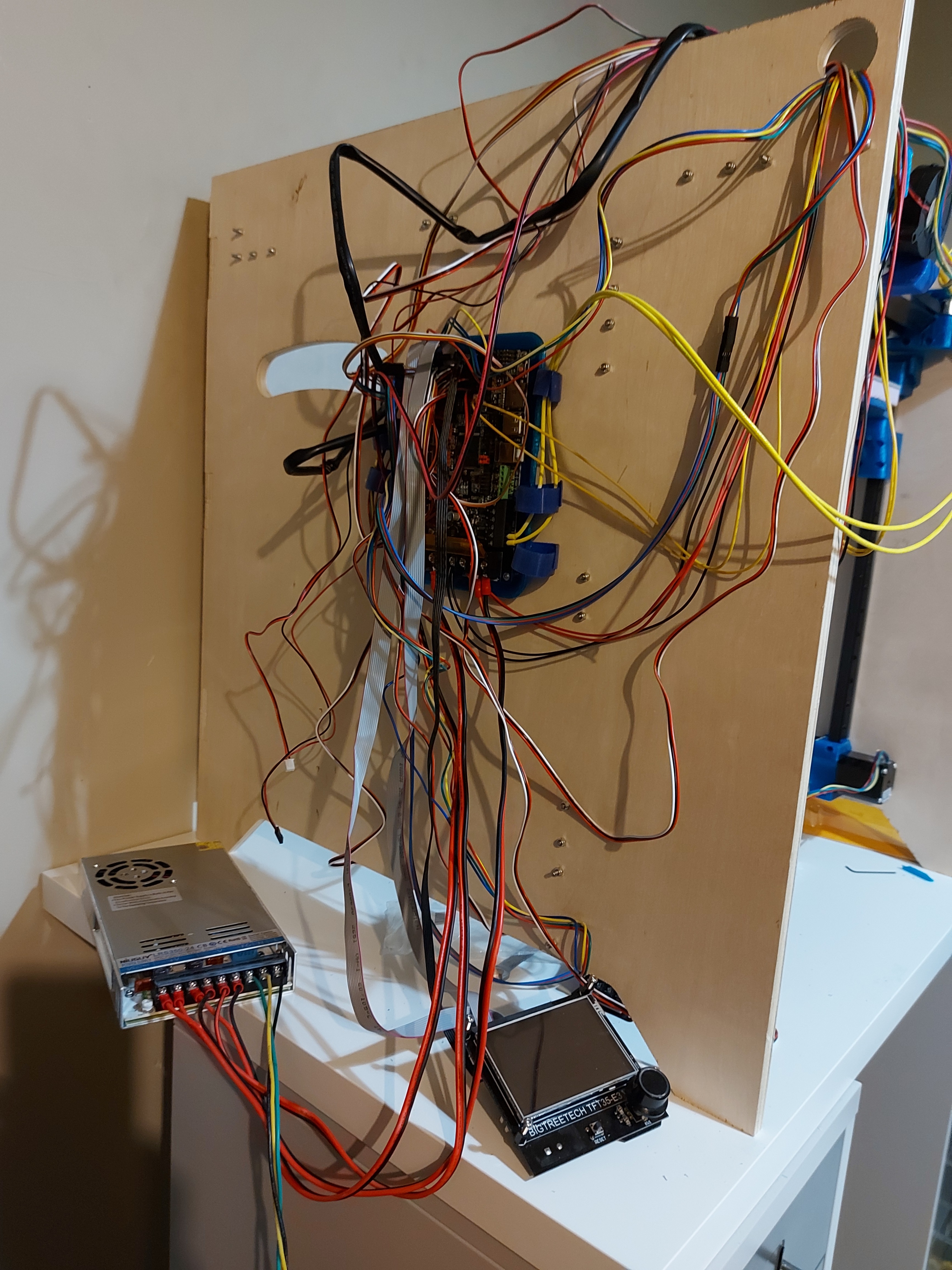

I have a big ol’ mess of wire now.

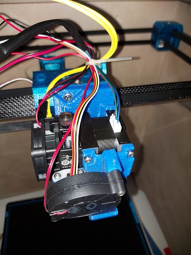

Extruder motor, heater, thermistor, hotend fan, part fan, and BLTouch clone. I’ll tighten and clip the zip tie when I get the sleeving over that. I ran out of the stash I had doing the LR2, and even then I barely got any of that done.
I’ve been procrastinating on making extension harnesses, only got one done. I gave up on my old crimper. It just won’t get the connector tight enough to fit in the housing without too much work. I have one that got good reviews in the box, but haven’t pulled it out. I should do that before the return window closes, but the very thought of all those crimps is so de-motivating.
I spent a few days moving the board around trying very hard to minimize extensions. In the end when it is done…very worth it.
The X endstop can be routed over the back like you have it, or you can wrap it under and run it up with the heater and thermistor.
So the last thing I have wanted to do to that mount was add a wire harness on the mount part instead of the tiny one on the hub. That orientation of the fan is a little less noisy than before but I still want to try and mount it flat under the hub, that would increase airflow significantly.
The problem is that I made it so much bigger. Even the wires that don’t need extensions are only just long enough. There’s not a lot of extra wire there. That 100mm extra doesn’t seem like much until you add it all together, then it’s massive.
I had considered that routing for the endstop, but I get paranoid about any wire getting nearer the hotend than it absolutely needs to be. I ran over a wiring bundle with the hotend once, and it cost me a Duet board. Since those aren’t cheap, I’ve been a little more careful about keeping wire away from it. I’m sure that it wouldn’t pose a problem, but this way seemed a little more straightforward. I have plenty of room back there, too
A wire tie location on the tool mount would be good. I almost ran the wires up in between the screws for the Hemera, but that seemed to keep them close to the heat block a little more than I liked, and the clip for the E3D thermistor wouldn’t fit nicely anyhow.

I ended up using an extra 3mm nut (I have literally hundreds) on the end of the 10mm screws, since they’re almost exactly 2mm thick. That way I didn’t need t print washers. That holds the fan shroud securely, and doesn’t stick out too much. Fortunately the button-head screws don’t stick out as far as the cap head screws, so everything still fits nicely. Everything around that core is packed in nice and tight. I’m really interested to try printing in TPU, which the Hemera is supposed to excel at.

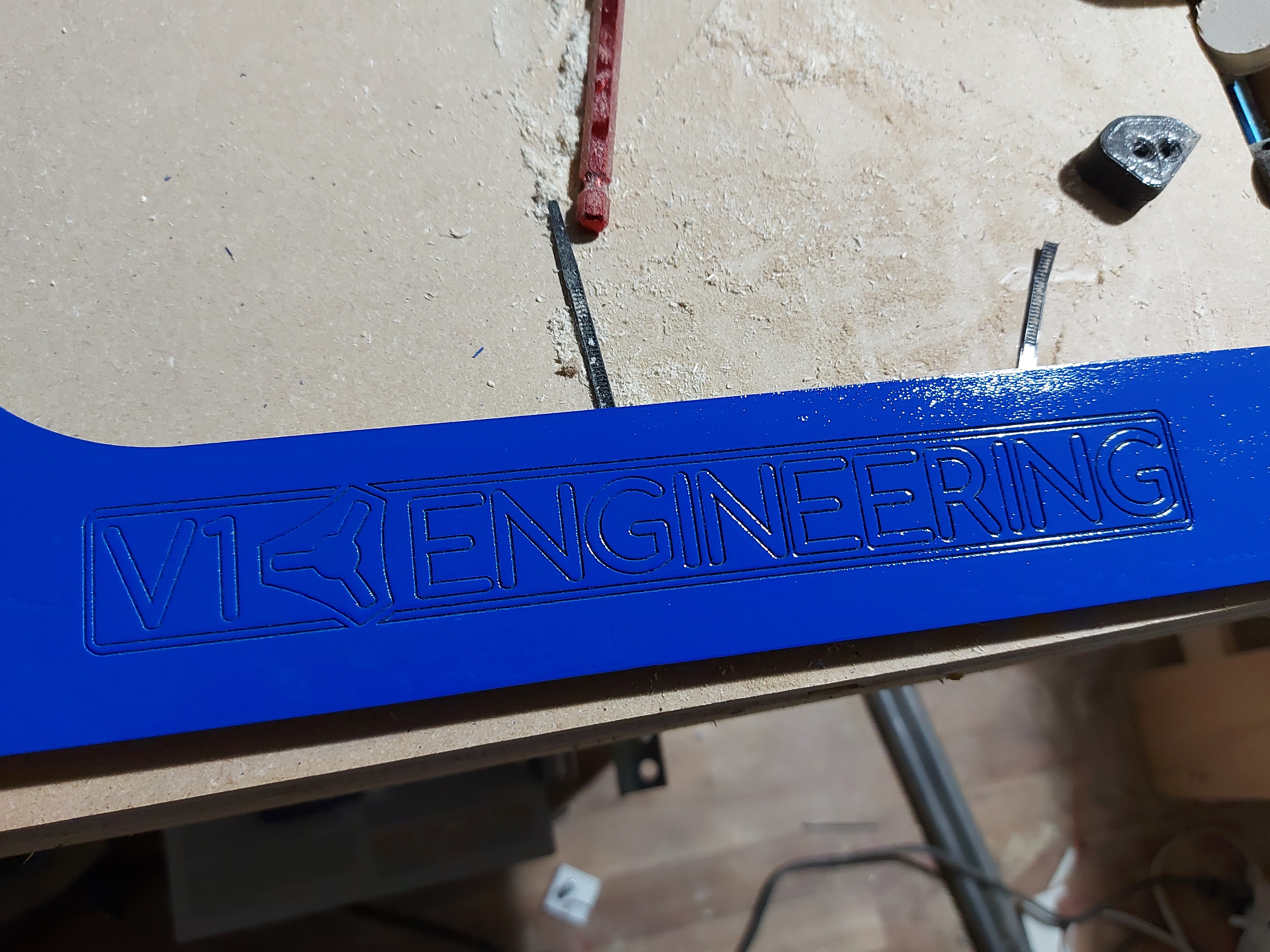

Somehow I scratched up the paint on the front panel. I’m a little bummed out about that. Maybe I’ll just cut a new one, patching up that paint seems like it could get really annoying.
Do you have any more stickers?
As it happens, yes. I am also considering just engraving the V1 logo.
There are some other improvements that I also want to make. Room for a light switch for the LEDs, for example.
I thought the scratches were deeper, but apparently not. A quick touch of 300 grit sandpaper seems to have done the trick to smooth it out for touch-up. Did the engraving anyway, just to see.

The wiring sure ain’t pretty, and I need to connect the fans still, but it’s almost functional. I need some more sleeving and a couple dozen zip ties, but it’s super close.
There we go, huge mess as a starting point before I make it better.
