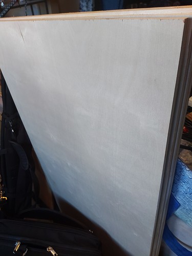

The last 2 sheets of 12mm MDF I bought have been like this for surface tearing, but it looks perfect with a light touch of sandpaper. That top pic, I just gave it a quick once-over with 300 grit.

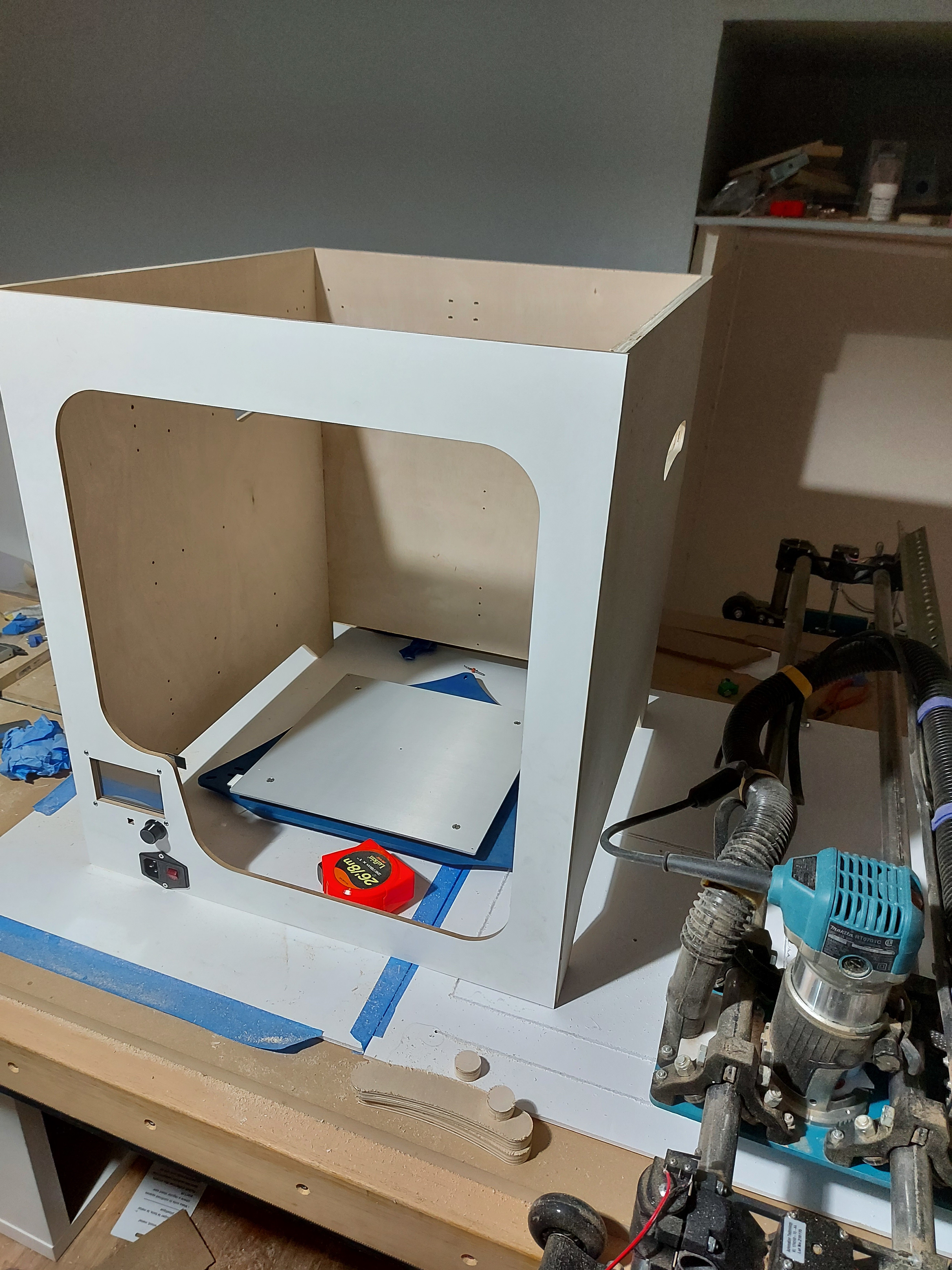

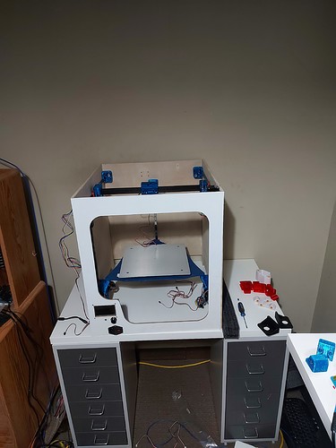

Okay 3 panels done… This is a monster.
No wedge panel as yet. Not 100% sure I’ll get that one cut. It might end up being an acrylic panel, or maybe 1/4" I really should have used 3/8" (9mm) material. Lessons learned…

I think the wedge piece keeps it square. If you decide to skip it, maybe cut a few 4"x4" trianglish pieces to glue in the corners to square it up.
Looks amazing though. What a great looking cabinet for a printer.
Nice!!
That front panel is not as bad as I thought. I thought it would box it in too much. Extremely functional and good looking.

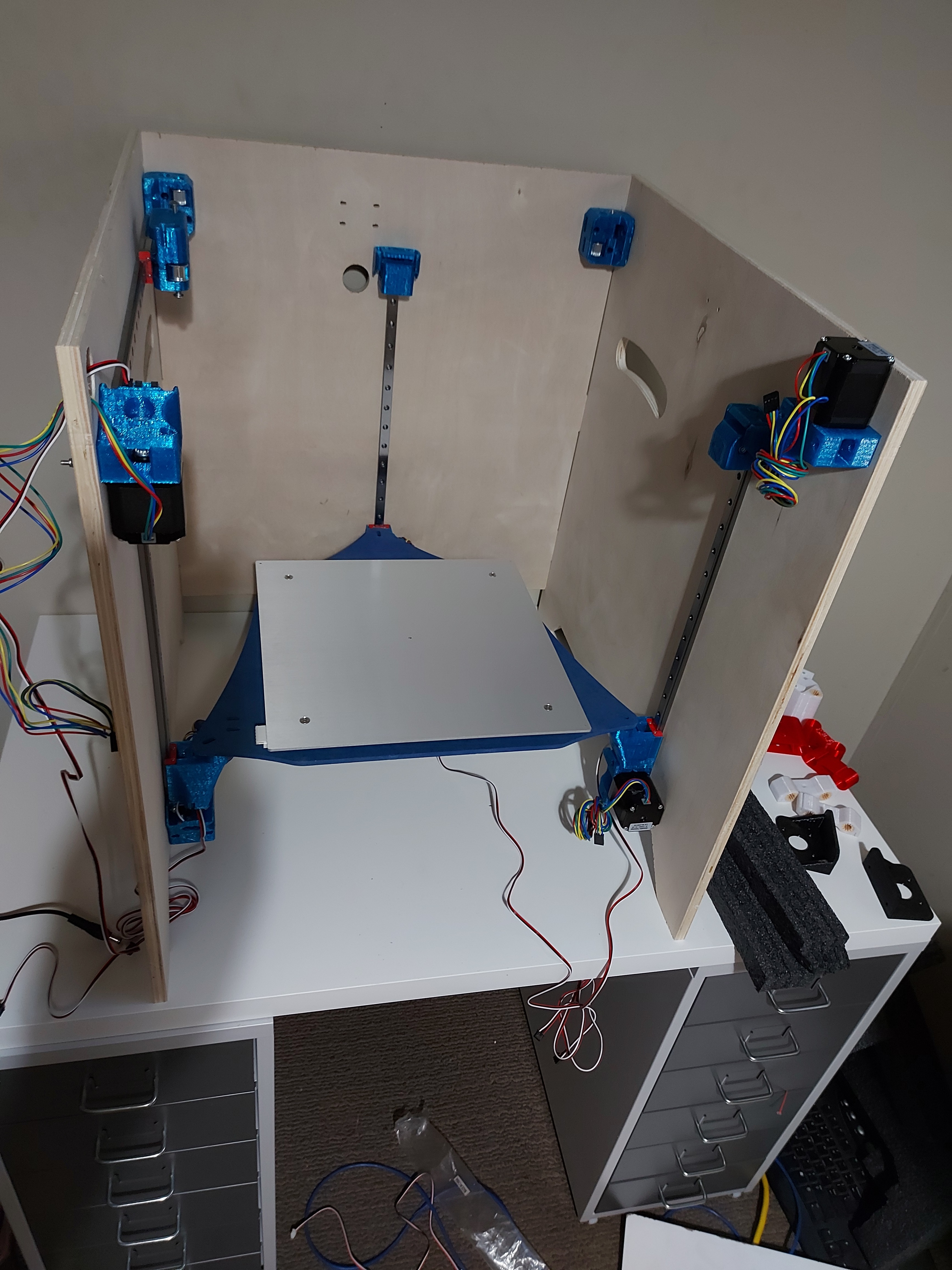

Next step is figuring out belt attachment for the Z axis. I didn’t look closely at it yet, but it appears as though I needed to get the rails on first.

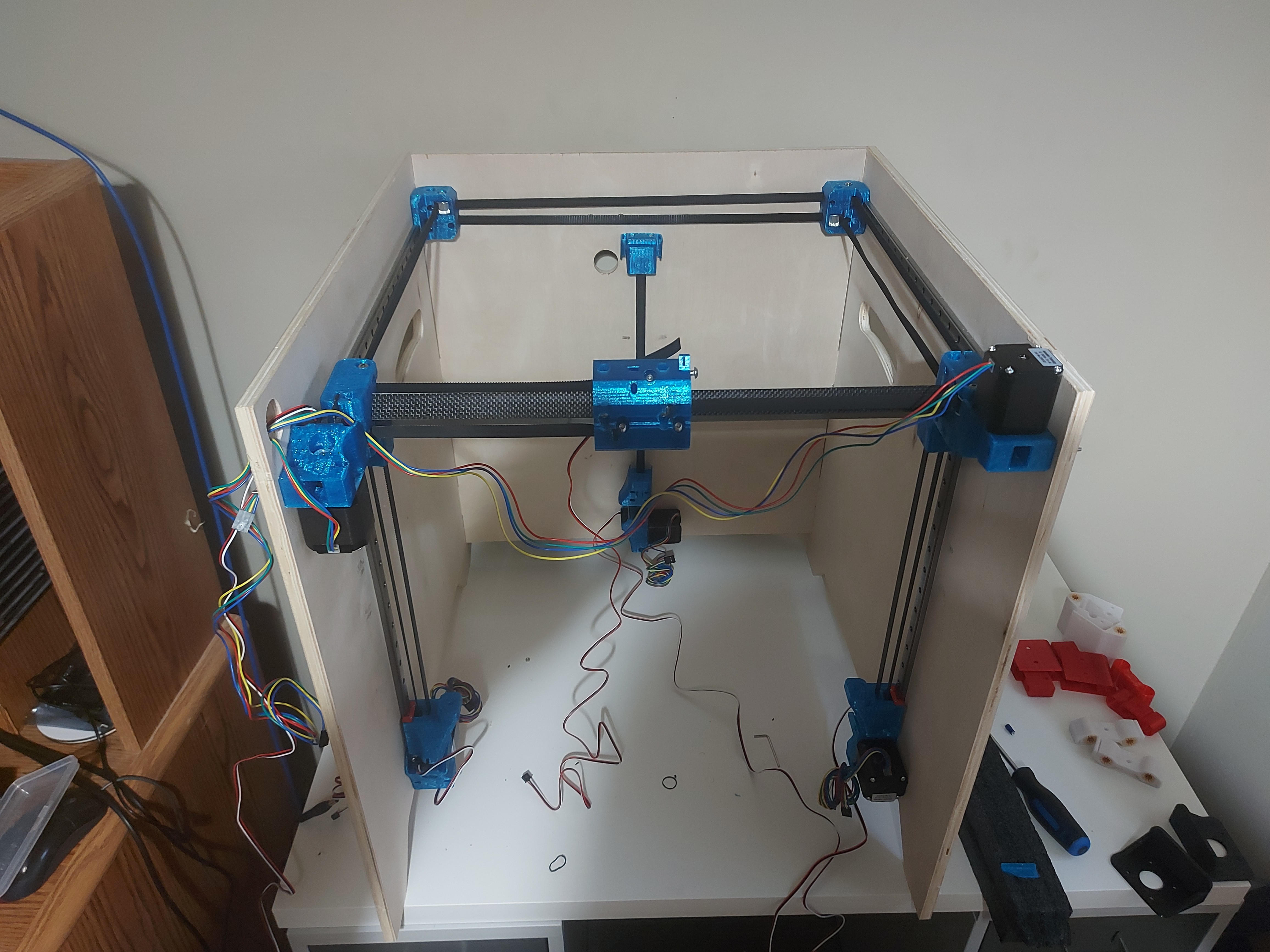

And… just because, one more shot, getting ready for belts.
So crazy to see another one!
Ok. Belts are a little tougher. My printer likes to make openings tight, so getting a locking piece in there isn’t fun. It occurs to me that heat shrink might make it easier though, now that I’ve done most of it.
I have the tensioner and the back Z slider to do. (Sure hope I guessed how this works right, lol!)

The belts can be easier if you cut the end at a point or wedge shape to feed it through, for stubborn ones you can push it one tooth at a time with pliers. My first prints were tough as well…the prints coming off this new printer work as intended.
For the lock I kinda tuck the belt end in with a flat head or needle nose then just pull the other end. Same here though the new prints are much easier.

Yeah, my prints seem to be extra tight, I need both of those tricks to make it possible. A couple of places, I needed to cut some printed plastic away to get the locks started. The Z supports on the top lock were the most troublesome for me. Still possible though.

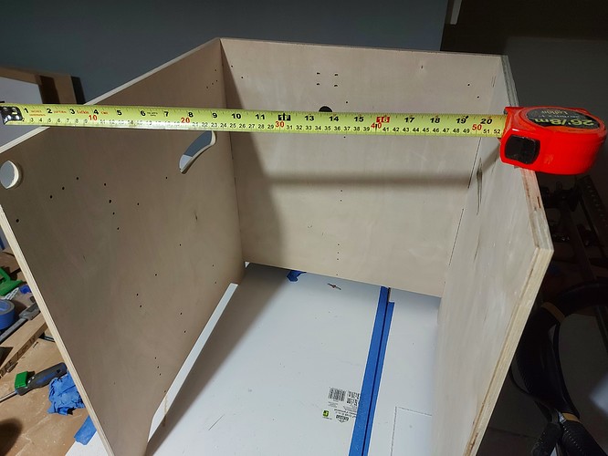

I did realize that I made an error on my side panels. I thought that I left 50mm for the beta motor on the right hand side, but I left 50mm from the motor mount which of course is intended to be in the center of the 2020 extrusion, so my right hand motor sticks up from the side by about 8mm, where it was suppose to be under the edge by about 2mm. This was intended to give me clearance to put a top panel on.
The top panel was going to be 1/4" and mostly open, about 50mm around the edges covered. (Similar to the front) just to keep the top reinforced and square, but not get in the way of any of the printer’s operation.
I could do it with 1/2" material and pocket out a bit for the motor… Or I could leave a hole in the corner… Or I could laugh it off and just use a couple of right triangles in the back corners. as reinforcement.
I’m glad that I cut handles into the sides. It’s rather unwieldy to move around.

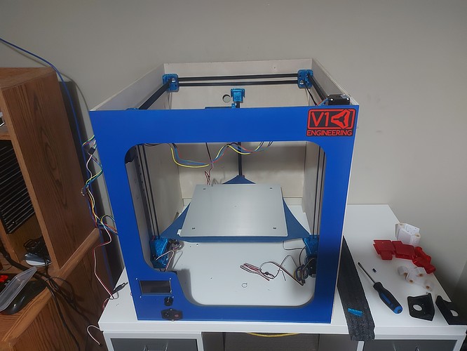

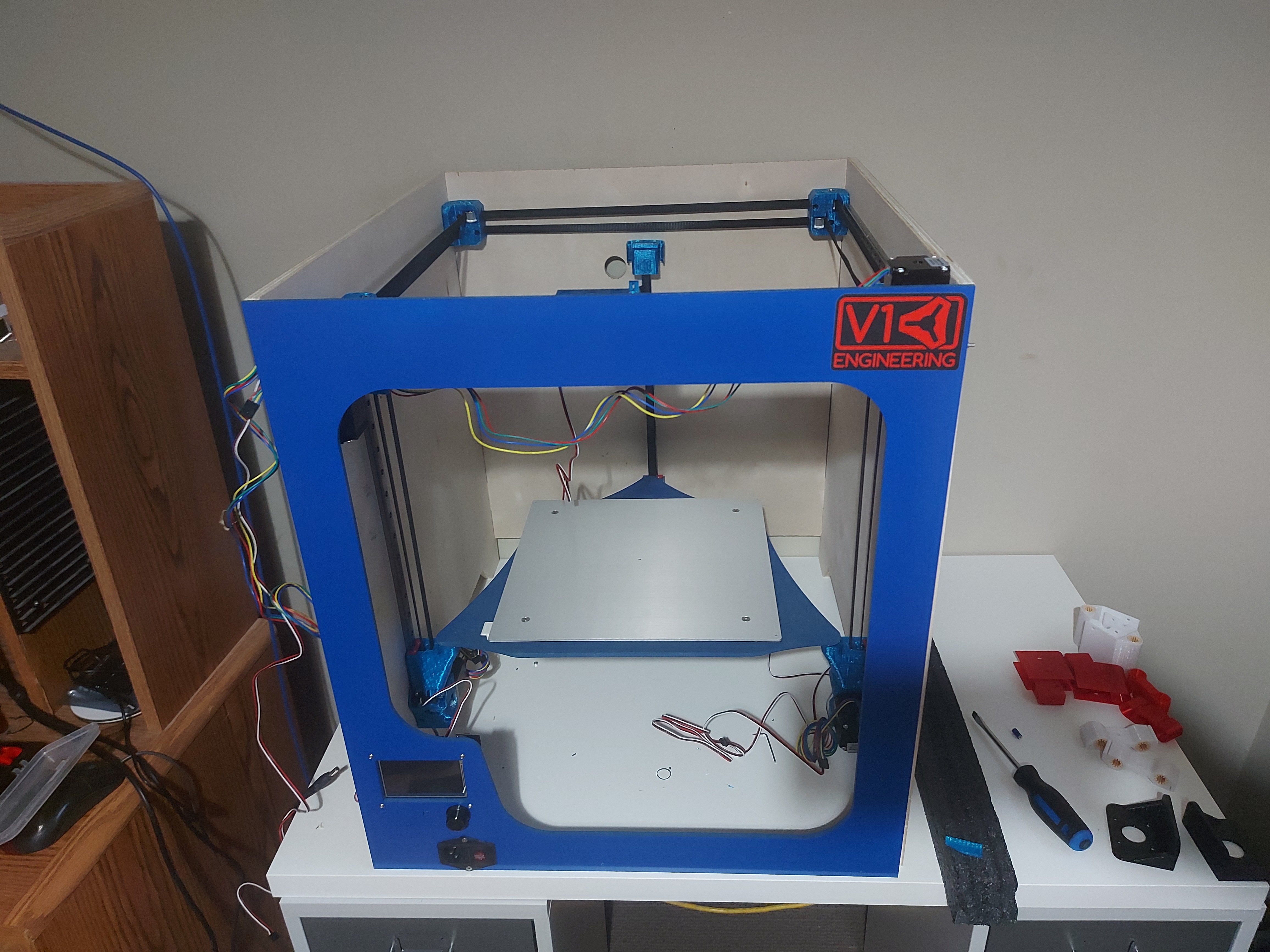

Belts are installed. I haven’t tensioned the CoreXY belts yet, I want to wait until I am sure that I have the X/Y plane squared, then I can be sure to have the X rail square at the same time.
And I.painted the front panel. Since I seem to be going with a blue theme, this deep blue seemed appropriate. The V1 decal was a spur of the moment thing. I was going to laser onto the melamine. I might still laser on the paint, but now I’m not sure. I can still do the sides later.

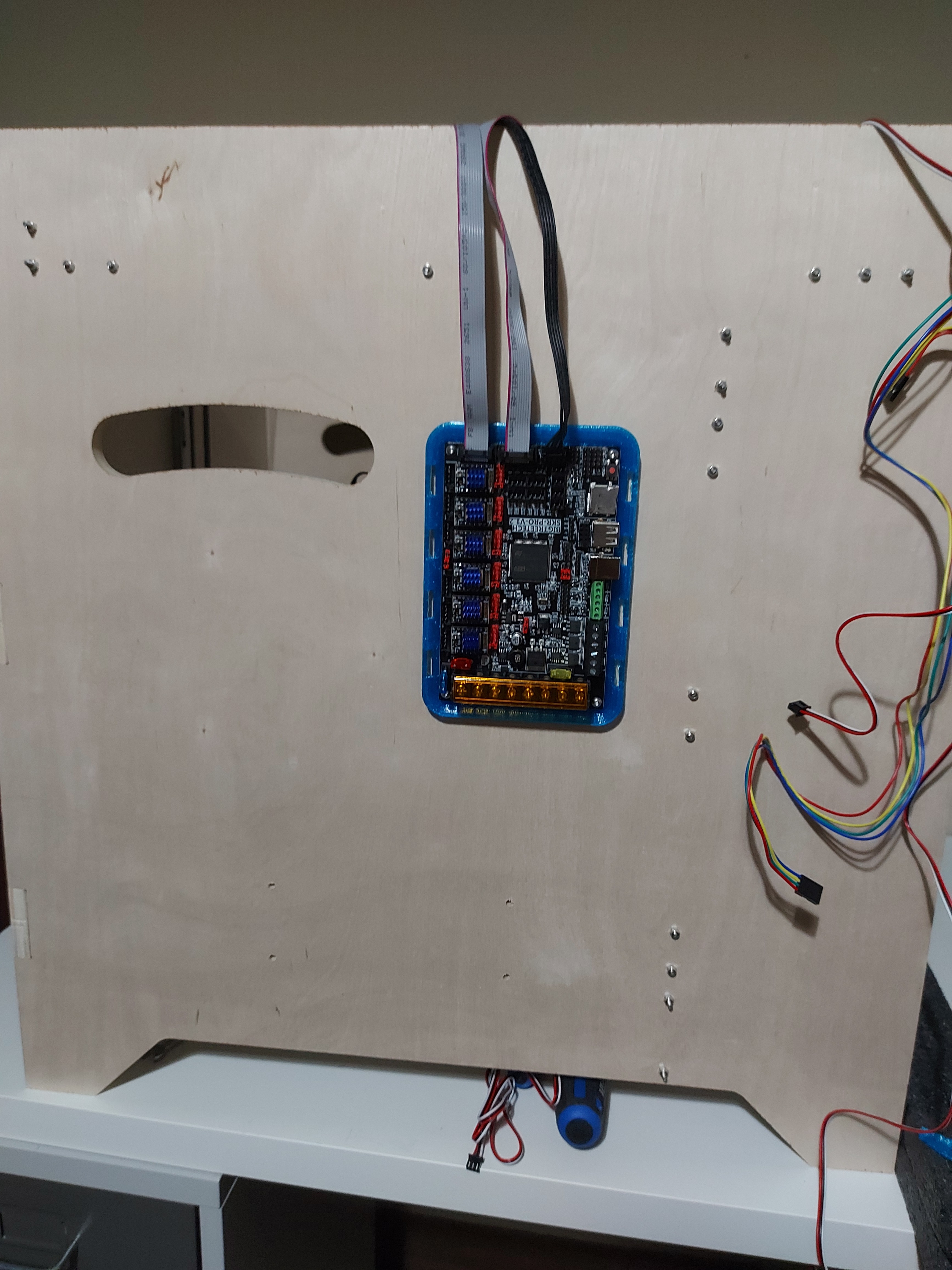

Next up is to print a mount for the SKR Pro that will allow some external wire management. I still need a pass-through for some of the Z motor wiring and the LCD cables too.
Just a tray for the SKR Pro. I also broke one of the belt tuggers, so I reprinted it.
It’s not too dissimilar from the tray that Ryan designed, with holes lined up to attach wires to. It’ll do until I can figure out more what I need.
My wiring is typically kind of messy. I should do something about that. It’s been that way since I was a teenager messing with stuff, so might not change anytime soon.
So that’s the tray mounted on the side.
Looking at the wiring… gonna need to extend the wires for the Beta motor, as well as Z2 and Z3. I’ll also need another passthrough on the left panel for the LCD and the Z motor wires.

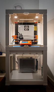

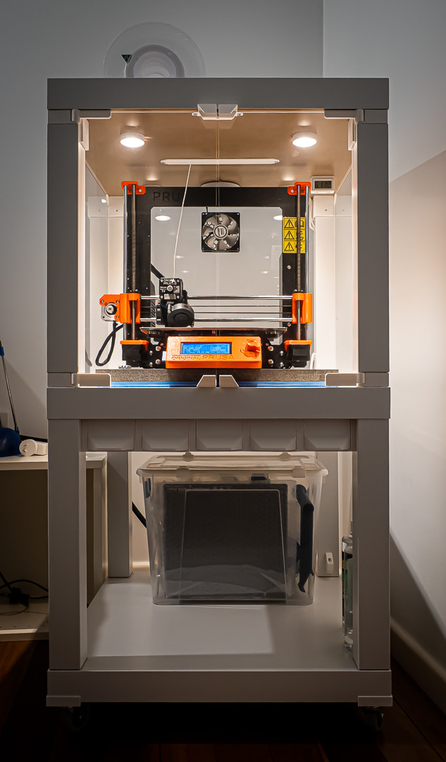

There’s something to be said for Ikea’s hollow legs and table tops. All the wiring and switches in my setup are completely invisible. Perhaps there’s room in future for a double skin or hollow beam to make management of (concealment of) wiring runs easier? Perhaps run everything on the outside and clip a light skin in the material of your choice over it all?
Not sure if an enclosure is contemplated, but that stepper might make it interesting putting a lid on the thing. If so, and yes I know you live in a place where a balmy spring evening does not bring you 27° and 65% humidity (for the benefit of the pixel peepers who spot the hygrometer in the cabinet) but be aware that when that 5" fan is running and the doors open some days I struggle to keep the temperature below 30° in the cabinet - and PLA doesn’t particularly like it after that.

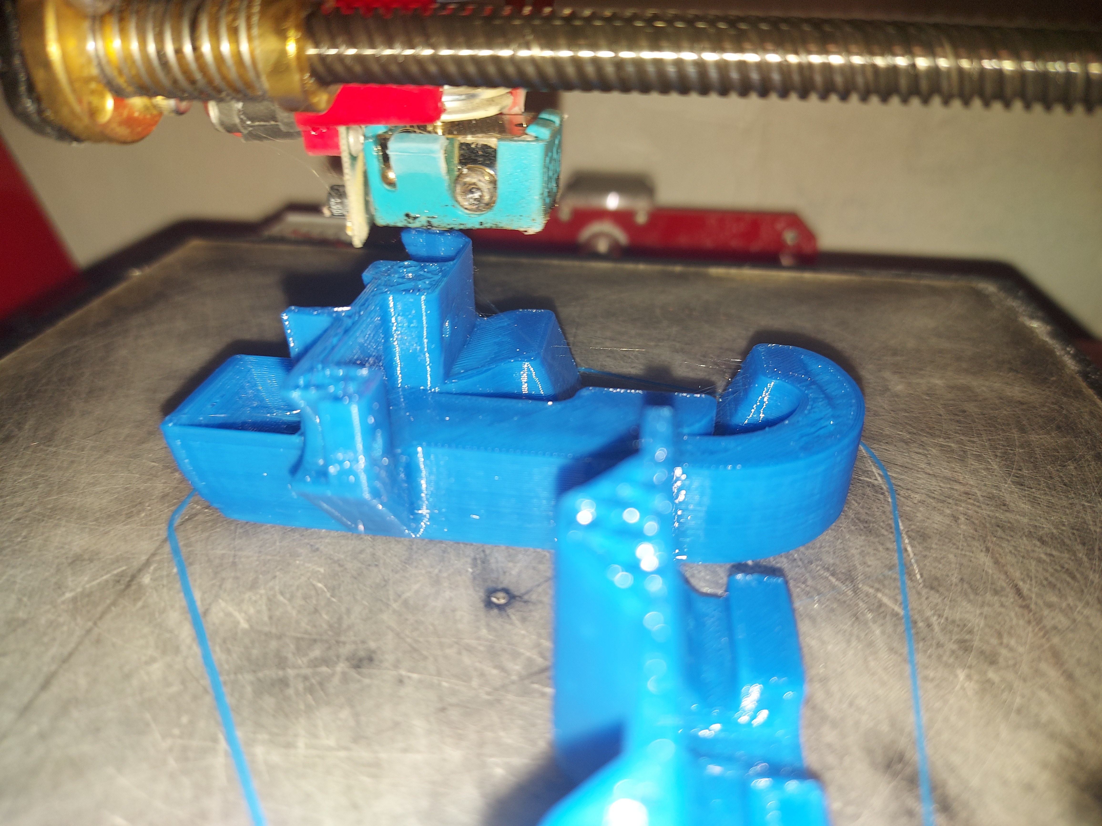

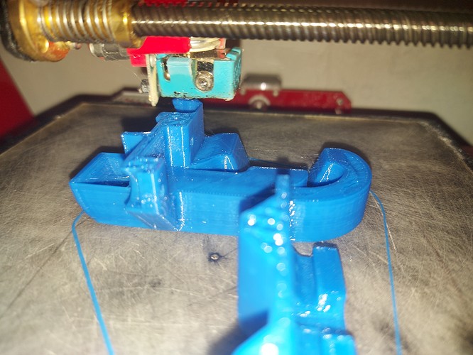

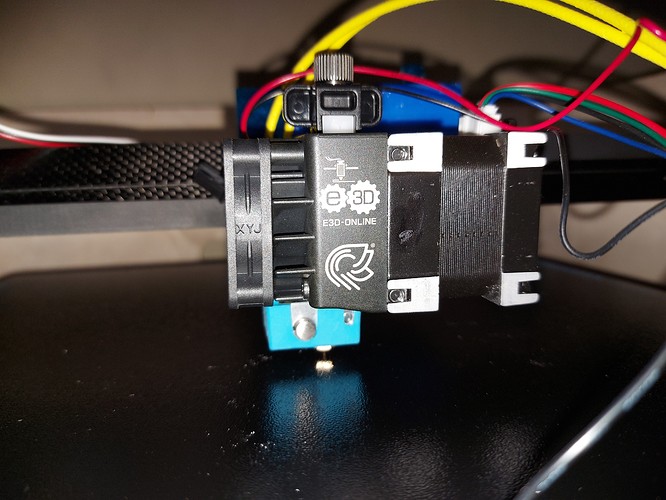

My printer’s less than stellar performance at bridging is going to cost me a bit for this fan shroud. The Hemera mount should be fine though, and I think the fan shroud will work well enough to print its own replacement when the printer is up and running.
It isn’t hard to anthropomorphize machines, and I sometimes wonder if my printer’s recent snits are because it’s working on its own replacement.
Well regardless, I don’t intend to entirely retire it, but instead I’m hoping to implement improvements to its design to make it faster and more accurate.
Well, that’s one potential worry out of the way. No problem with having the ability to get to Z=0
The Hemera mount isn’t bolted onto the hub yet, it’s just friction fit. I have some spare belt pieces holding the Z axis up, but for now the Z belts are tight enough not to slip that.easily anyhow.
