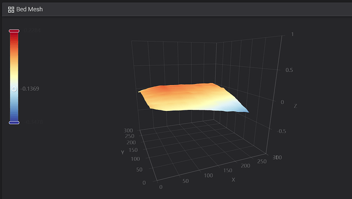

So using a visualizer might have a lot of benefits.
3D Printer Auto Bed Leveling Mesh Visualizer | ChillRain browser based.
In my #00002, it looks like I might be sitting on the power cord or something in the back corner. Shoot, this is some high-tech build optimizing. Both printers work perfectly, but this will make them even more perfect

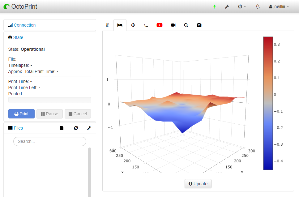

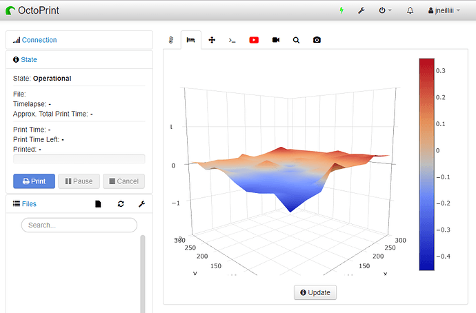

There is an octoprint plugin with bed visualization:
Works with Marlin and Klipper. It definitely helps a lot.
My bed mesh…
[bed_mesh]
algorithm: Bicubic
speed: 500
mesh_min: 30,43
mesh_max: 292,264
probe_count: 16,16
horizontal_move_z: 12
#*# [bed_mesh default]
#*# version = 1
#*# points =
#*# 	0.015903, -0.017847, -0.047847, -0.054097, -0.064097, -0.070347, -0.084097, -0.099097, -0.114097, -0.135347, -0.150347, -0.177847, -0.184097, -0.211597, -0.222847, -0.247847
#*# 	0.025903, -0.005347, -0.025347, -0.030347, -0.035347, -0.045347, -0.059097, -0.069097, -0.080347, -0.095347, -0.121597, -0.145347, -0.156597, -0.171597, -0.199097, -0.200347
#*# 	0.013403, 0.008403, -0.006597, 0.005903, -0.007847, -0.004097, -0.031597, -0.031597, -0.057847, -0.067847, -0.079097, -0.107847, -0.120347, -0.132847, -0.147847, -0.174097
#*# 	0.018403, -0.007847, -0.000347, -0.000347, -0.000347, -0.001597, -0.011597, -0.017847, -0.030347, -0.055347, -0.069097, -0.091597, -0.097847, -0.110347, -0.134097, -0.131597
#*# 	0.023403, 0.024653, 0.024653, 0.034653, 0.030903, 0.039653, 0.024653, 0.015903, -0.006597, -0.014097, -0.030347, -0.052847, -0.059097, -0.077847, -0.082847, -0.094097
#*# 	0.023403, 0.023403, 0.032153, 0.039653, 0.043403, 0.044653, 0.038403, 0.028403, 0.012153, 0.007153, 0.005903, -0.022847, -0.037847, -0.046597, -0.064097, -0.059097
#*# 	0.039653, 0.057153, 0.058403, 0.077153, 0.069653, 0.067153, 0.065903, 0.069653, 0.044653, 0.042153, 0.022153, 0.005903, 0.000903, -0.011597, -0.021597, -0.035347
#*# 	0.043403, 0.040903, 0.065903, 0.065903, 0.077153, 0.060903, 0.062153, 0.059653, 0.037153, 0.040903, 0.034653, 0.023403, 0.003403, -0.004097, -0.014097, -0.011597
#*# 	0.050903, 0.065903, 0.074653, 0.092153, 0.099653, 0.085903, 0.078403, 0.075903, 0.064653, 0.058403, 0.055903, 0.034653, 0.029653, 0.024653, 0.013403, 0.008403
#*# 	0.048403, 0.060903, 0.078403, 0.093403, 0.103403, 0.085903, 0.083403, 0.083403, 0.068403, 0.060903, 0.048403, 0.045903, 0.039653, 0.027153, 0.019653, 0.047153
#*# 	0.052153, 0.072153, 0.083403, 0.097153, 0.114653, 0.097153, 0.090903, 0.090903, 0.080903, 0.079653, 0.063403, 0.060903, 0.058403, 0.050903, 0.043403, 0.035903
#*# 	0.053403, 0.059653, 0.077153, 0.095903, 0.115903, 0.094653, 0.088403, 0.088403, 0.078403, 0.073403, 0.065903, 0.079653, 0.057153, 0.050903, 0.083403, 0.054653
#*# 	0.035903, 0.065903, 0.089653, 0.102153, 0.128403, 0.107153, 0.107153, 0.113403, 0.099653, 0.089653, 0.085903, 0.100903, 0.075903, 0.078403, 0.082153, 0.064653
#*# 	0.003403, 0.034653, 0.062153, 0.097153, 0.088403, 0.092153, 0.087153, 0.094653, 0.084653, 0.090903, 0.079653, 0.073403, 0.075903, 0.070903, 0.072153, 0.068403
#*# 	-0.016597, 0.029653, 0.065903, 0.083403, 0.099653, 0.090903, 0.095903, 0.088403, 0.095903, 0.085903, 0.080903, 0.079653, 0.085903, 0.087153, 0.077153, 0.079653
#*# 	-0.020347, 0.017153, 0.035903, 0.067153, 0.072153, 0.074653, 0.069653, 0.075903, 0.063403, 0.072153, 0.065903, 0.062153, 0.070903, 0.067153, 0.059653, 0.068403
My variance across the bed is .3762mm

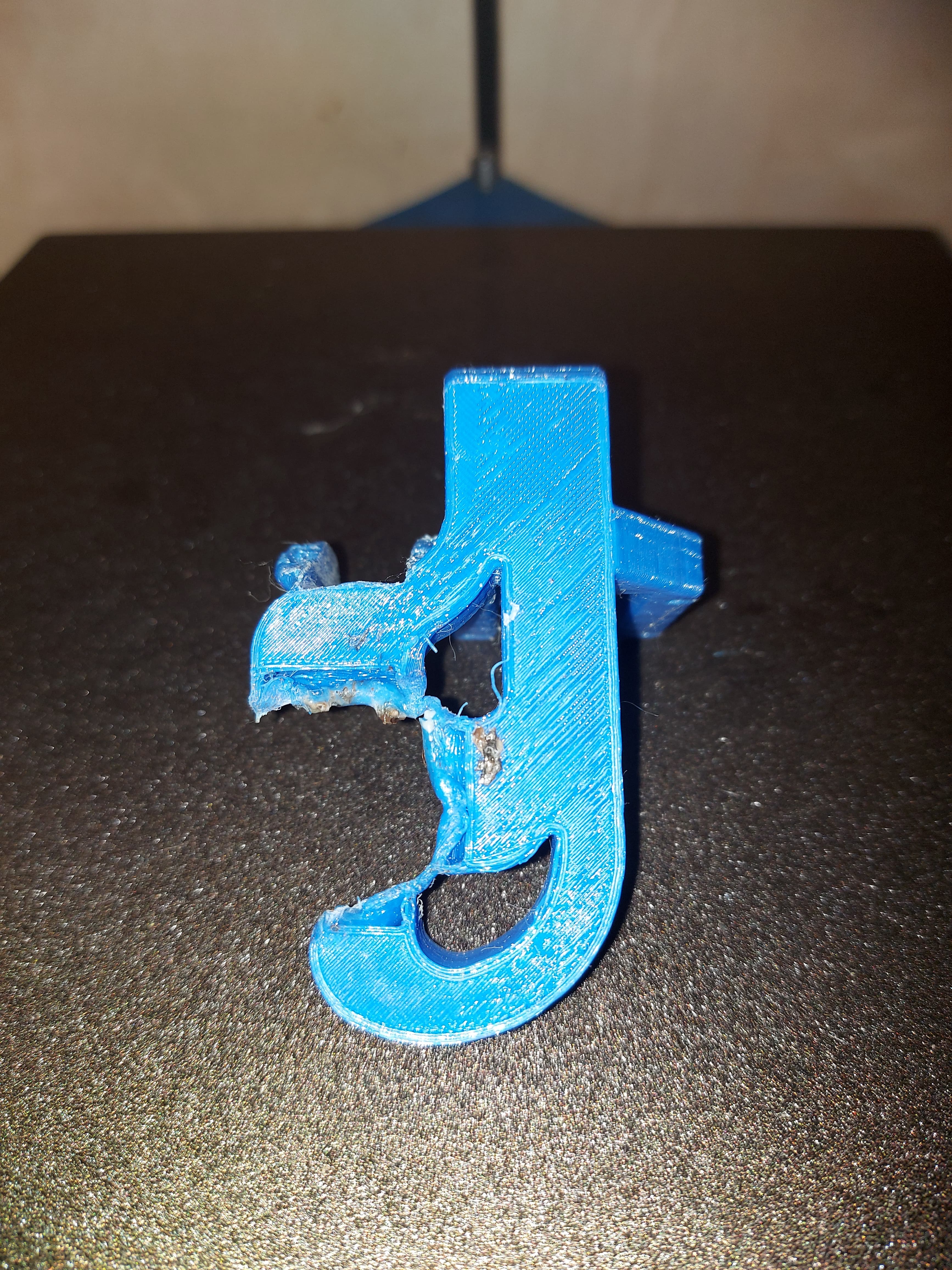

I started havimg some weird print problems. Turned out that the fan shroud was sometimes catching the edges of the print and moving thinfs around on the bed, or knocking things over… or sometimes picking up the perimeters of the first layer. Only a few, then more. I re-did the fan shroud early on, so I replaced it, but it will probably happen again.
Maybe I’ll see if I can get nylon or polycarbonate working… might be time to look at those new BIQU extruders, supposed to be good to crazy high temperatures.
The good news is that the bridging for the replacement fan shroud is great, so it doesnt have that big dip in it.
I have my slicer settings turn off the cooling fan unless bridging or small layers. Maybe I should let it run all the time when printing… give it a non-zero minimum speed…
Interesting. I know some filaments need no fan, I had not really considered that. I wonder if a minimum flow would have prevented that…and not messed up the print.
It is fairly easy to take off, if you leave the plug on your fan…or we could make a new shroud with the ducts a bit further back.
I doubt it got up over the melting point of 230C or whatever. But it probably got hotter than it’s glass transition temperature, which is something like 85C for PETG. Certainly higher than pla. There’s a nice chart here:
I think my fan shroud is HTPLA. And I didn’t heat treat it. So I assume it would be close to 60C, but it still looks fine to me. Maybe it does need to be a bit further from the hot end.
Well, I print almost exclusively PETg at 250°C. Probably didn’t get hot enough, I do have the silicone sock on the heat block. (I had to remove a bunch of gunk from a print getting fouled, but I’m pretty sure that was after this happened.)
