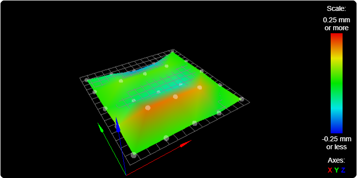

Now a G29 after
17:32:22.904 : Bilinear Leveling Grid:
17:32:22.904 : 0      1      2      3      4
17:32:22.904 : 0 +0.010 +0.010 +0.010 -0.030 +0.030
17:32:22.904 : 1 +0.080 +0.180 +0.160 +0.150 +0.010
17:32:22.904 : 2 +0.030 -0.070 -0.090 -0.110 +0.020
17:32:22.904 : 3 +0.010 +0.050 +0.030 +0.050 -0.010
17:32:22.904 : 4 -0.020 -0.070 -0.170 -0.160 +0.000
Is that a dip in the middle or a hump?

Just a heads up, the mapping for corxy machines with a moving bed is upside down usually. So a hump in the map, is really a dip. You can verify by throwing a shim under one of the probe points to see which way it says the error is.
That makes sense. That was the first build and I am pretty sure my bed insulation is touching in the middle, possibly pushing it up. I need to loosen it a bit.
How do you figure?
Z+ is still moving the print head away from the build plate. In a bed flinger, Z+ moves the gantry away from the bed. In this case, we’re moving the bed away from the gantry. The result is the same, and the machine can and will run the exact same gcode with the same results.
Anyway, I plugged Ryan’s numbers into a heightmap and used the Duet’s visualizer for it
positive numbers are high spots, negative numbers are low. The visualiser exaggerates the differences.
What an odd way for the bed to be wonky.
I wonder what that would look like if I took off the filament feeder tube. I feel like it can push or pull on the extruder by 0.02mm pretty easy, and it would explain the straight lines. Or maybe it is the wires, since the do rub on the top of the shelf. Ultra precision is nothing like “eyeball it with a piece of paper”…
That’s how it’s always been explained to me for my printer. Up on the visualizer is actually a dip on the bed. Positive Z+ moves the bed down.
That’s also why Duet has an “invert z coordinates” toggle.
My gut reaction to the image was that it looked like something might be offsetting the probe result based on if the preceeding motion is goin in the +X direction or the -X direction.
In this case, the first, third and 5th rows would have followed +x motion, and the second and fourth rows following -X motion.
The easiest way to compare would be to go to 3 rows, and see if the center point (which currently registers low) registers high instead.
As to how to fix it if this is the case… Beats me. I’m not seeing any regular patterns like this in mine.

So now we know on these it is + = a high spot.
