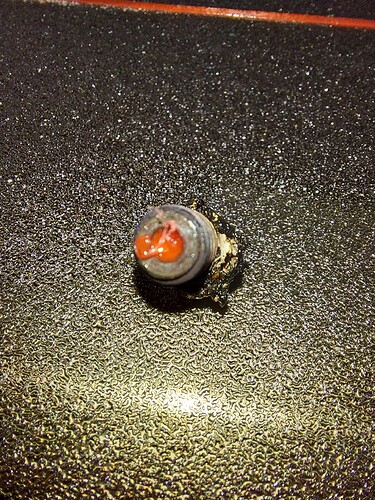

Clogged nozzle, and my BLTouch clone is being awful. G34 bed levelling has become a crapshoot. It will do a couple passes, then I’ll get “decreasing accuracy” and one motor will move an obviously wrong amount. It seems to usually be OK, but with some of those adjustments being 5mm or more, it ends up way too dependent on the G29 bilinear. Seems to work though, surprisingly enough.
So I’ve ordered another BLTouch. It’s a similar clone, but one just like it has been rock solid on the kids’ printer. This one was too until yesterday…
I dislike coincidences. So I happened to have taken apart the CoreXY portion of the printer. It should not have touched the Z axis, but I want to take the Z motors out and triple check those grub screws. It SEEMS to be moving as expected, though.
I know that I missed loctite on one of the CoreXY motor pulleys, so maybe I missed it in a Z motor as well. It only seems to be a problem during G34 though, so I doubt that this is it.
The clogged nozzle is a bit more troublesome. I have more nozzles, but I’m really not looking forward to taking apart the heat block. I’ve done it before, but it’s always such a hassle, plus this hotend has had plastic all over the heat block, which always makes disassembly such fun…
I have some of those little file/drills for cleaning up the nozzle, too, but I don’t remember where they are. Easier to just replace it, I think.
What was your Z offset. I am pretty sure the BL are super sensitive and need to be in the middle of the recommended range.
Mine are all just 2.7 -3.5mm offset.
Offset is currently 3.35mm. It was lower because I needed the spacer before I re-did the trucks, and was at 1.47, and did the same thing (but worse, because it would sometimes bump motor 3 up by 4-5mm and then the hotend would hit the bed before the probe did.)
The probe messing up is most likely why the nozzle jammed, it tried to bury itself in the heated bed. I didn’t notice for a bit as it was trying to lay down a first layer and couldn’t extrude at all. (It started out OK, but it didn’t stay that way.)
I just remembered that I have the one for the kids’ new printer in a box… Since I’m waiting to assemble that one anyway, I think I’ll grab it. (Tempted to grab the whole Hemera extruder while I’m at it.)

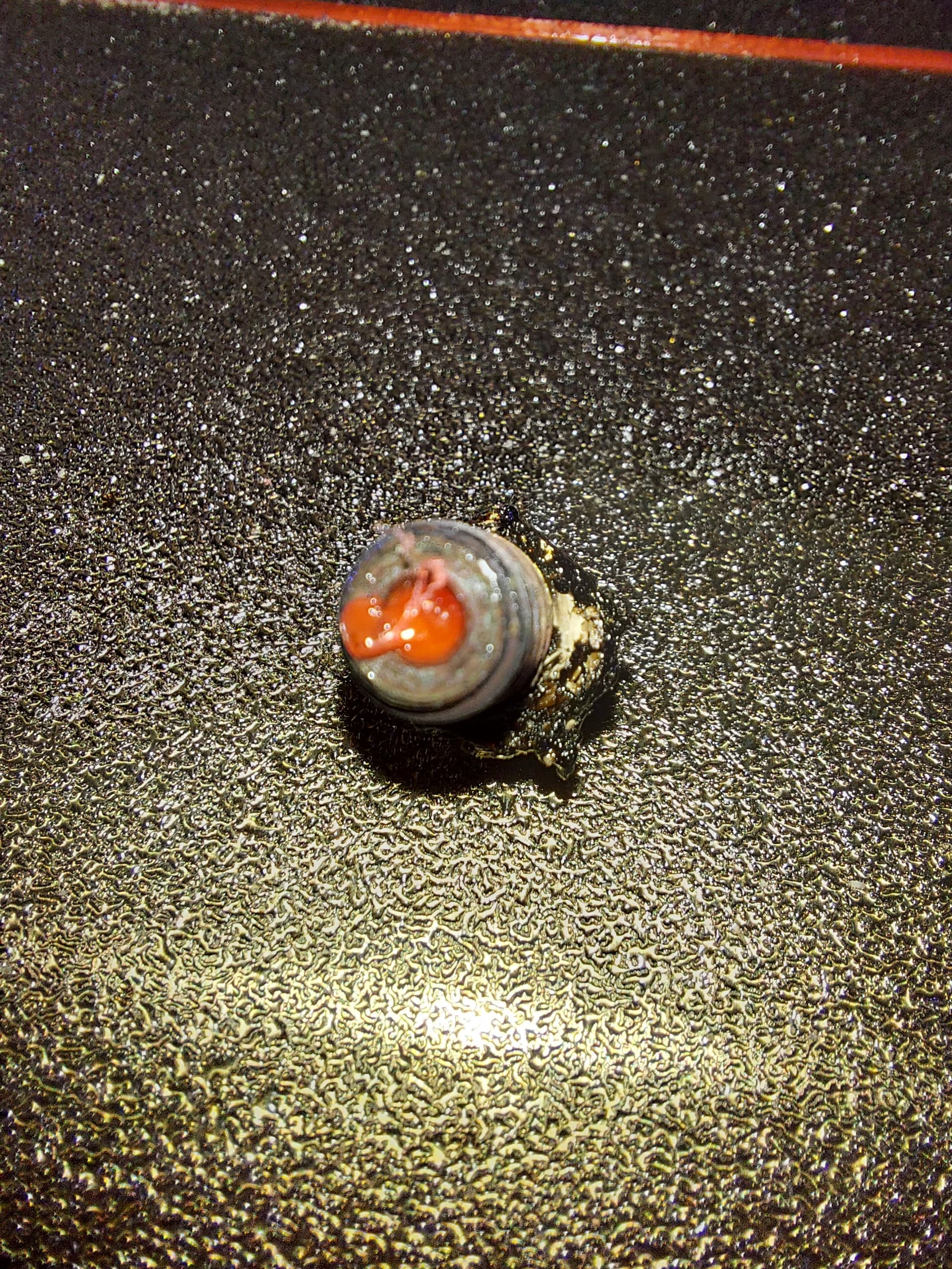

It would probably look exactly the same if it weren’t clogged, but there it is. I replaced the nozzle without removing the heat block from the extruder, so fingers crossed that it won’t end up with it crapping all over my prints. Well, it did that before I tightened it last, so…
Anyway, G34 ran perfectly twice, then took all 8 with some adjustments that were visibly wrong on the third time, but I haven’t yet swapped the BLTouch, because it’s in a box full of boxes. Also realized that the new Hemera isnt here yet, it’s due Tuesday.

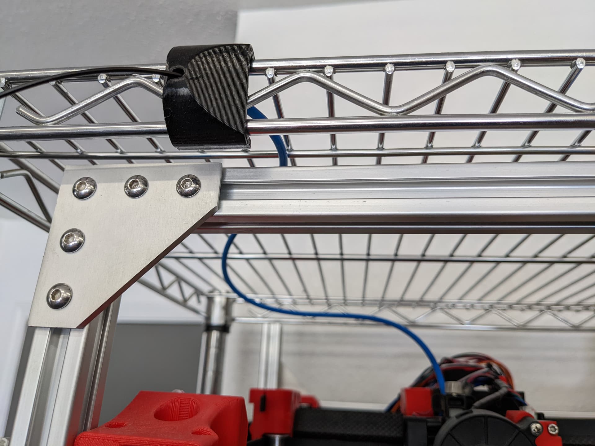

The BL can be bad, the x carriage could be funky (is it level and not wobbly, not too tight), The other thing that messes with it is super loose Z belts or the umbilical pushing on it (I loosened mine up and have much better levels now).
Oh I just saw your other picture. If you do not anchor the far end of your filament feeder tube the spool will pull on the head and mess up the offset. Unless you are really careful while it is probing.
Pretty sure that’s not the issue. I set up the filament spools so that the home position is where the greatest potential tension is, everywhere else has less. The wire harness might be tugging a little, but it seems OK when printing. Also, it’s worked perfectly so far as I can tell until this overhaul.

Have you tried the cold pull method for removing clogs?
Honestly, I didn’t have many clogged nozzles until I started printing PETG. And I haven’t really figured out the best way to fix it. I just haven’t used PETG with my current extruder.
And my only nozzle clogs ever have all been PLA. Never had one with PETg, though my first 2 printers never managed a successful print with PETg either. I used to do everything in ABS, but that of course has its own issues.
Now it’s entirely possible that switching filaments is a problem, I never used anything except PETg with this printer until this beta, so maybe it was the switch between leaving something behind. Now this new nozzle has only bee used for PLA.), so we’ll see when I.start using PETg again.
Obviously leftover PETG will not melt enough at PLA temps. I have also heard that pla can get burnt and turn extra hard at very high temps. I have some cleaner filament that has a very large temperature range. I try to do cold pulls with that. But I still look at PETG sideways. YMMV.

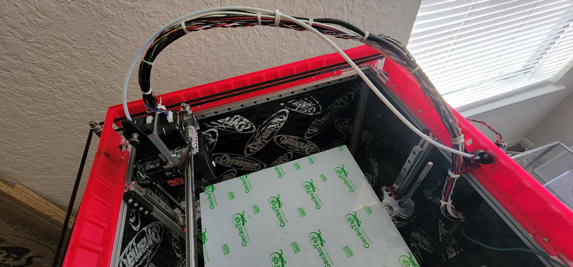

I want to find a better solution for the umbilical and filament guide. It is the least accurate part of the Repeat. Or maybe the just cause of the most inaccuracies.
For the railcore, we use one of those 30" zip ties as an umbilical stiffener. All the wires are long enough to reach the far corner with a few inches of slack.
I was just thinking about one of those. The umbilical on mine is just a little floppy. I should fix the other end of the filamant guide first though.
