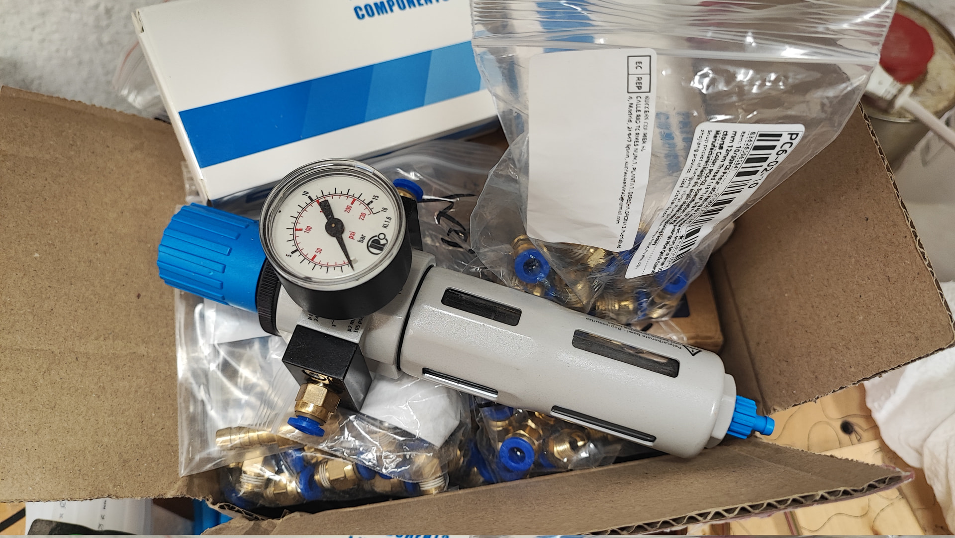

Are you planning to use air compressor just for air cooling/misting? And/or does the ATC or anything else use pneumatic stuff?
For air cooling, am following Bartman’s/Jonathan’s setup… With filter/regulator, pneumatic tube, fittings, mixing valve with flex nozzle. I don’t like how stiff the 8mm hose is.
Yes, ATC always needs a stream of air to keep dust from entering the bearings etc. and to pick up and release tools.
Didn’t consider mist cooling yet, but I just might add a third waterline for mist while I’m at it. I really dislike disassembly of the drag chains… :face_savoring_food:

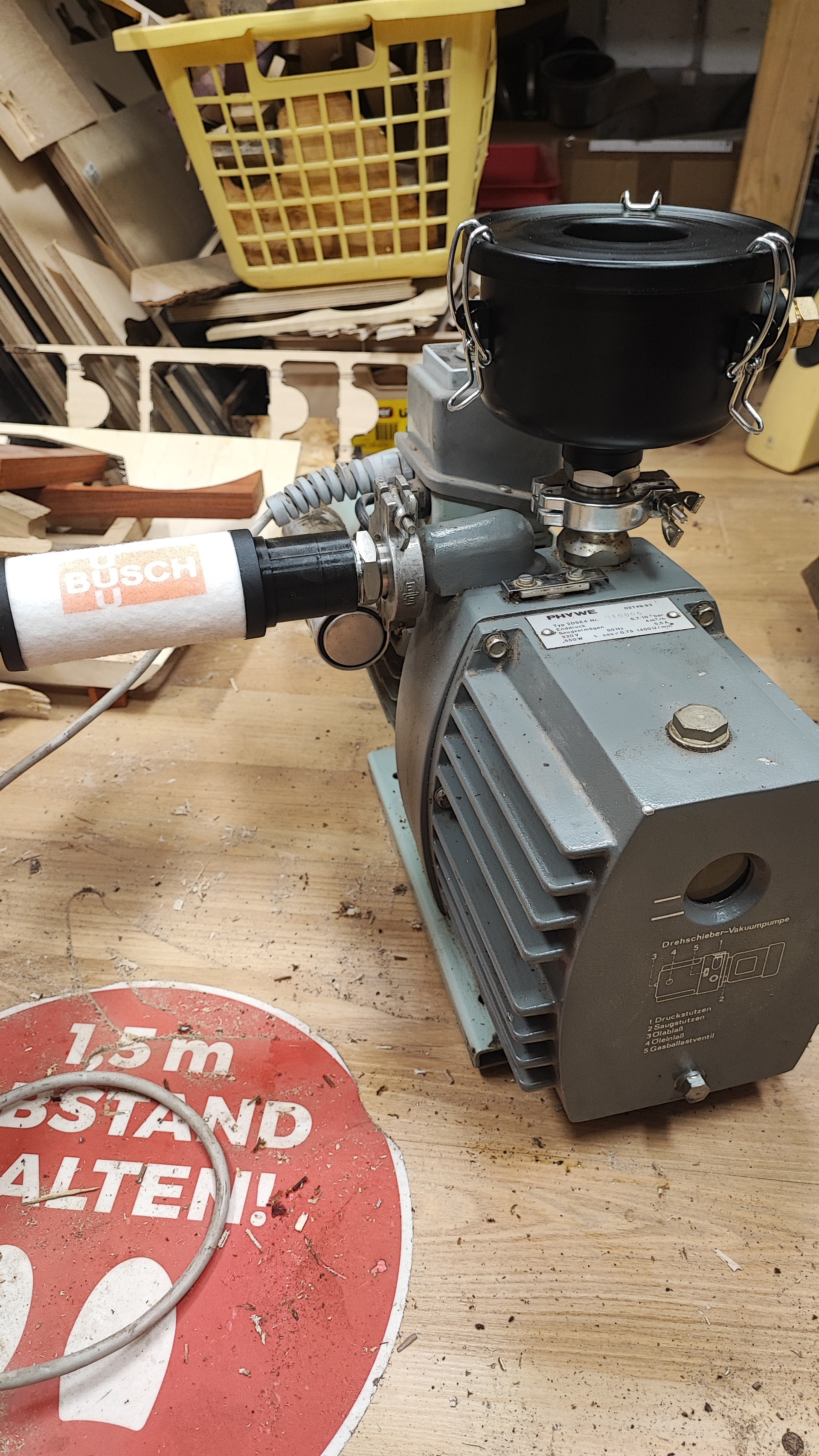

Bought an air filter for the intake and an oil filter for the air outlet as well as some fittings (picture from yesterday) to start using the vacuum pump that I was given as a trade-in for my Ghostrider on top of the money. Today I got some oil, filled it up and fired it up an first I was really like “what, that’s it?” when holding my finger to the air inlet. I also printed a fixture which I was not really impressed with because it didn’t hold the wood and I was like… eeeh. But then I noticed that my insulation thingy wasn’t hight enough. Added another strip and booooooy that thing sucks.

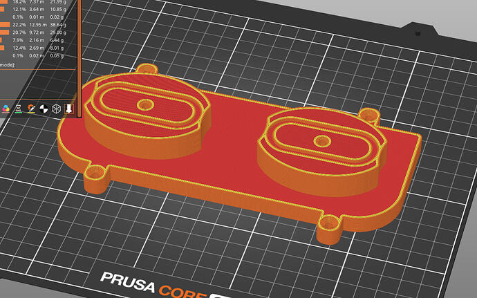

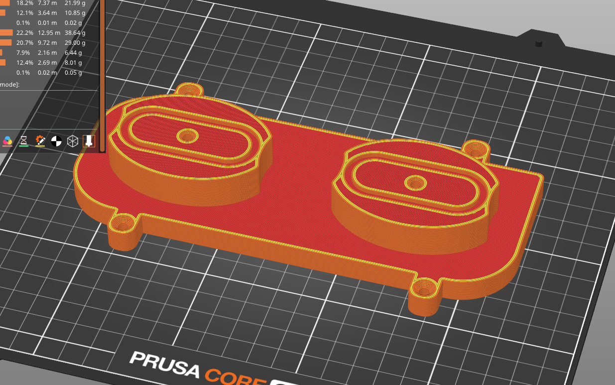

I now created a fixture for my ring-boxes that I fairly often make so that I can just suck them down when doing the engraving on top of it. I left one corner “cornery” and didn’t make it round so I can always find the corner with my touch probe if needed.
I am going to know whether it works in a few hours. :slight_smile:
If it works, I am going to do another fixture for my pencil cases.
Any issues with the vacuum leaking through the printed layers? I guess you could to a clear/sealer coat over the part to reduce that.
That infill % are you using?
3 walls with a 0.6mm nozzle, 20% infill, no leaking. :slightly_smiling_face:

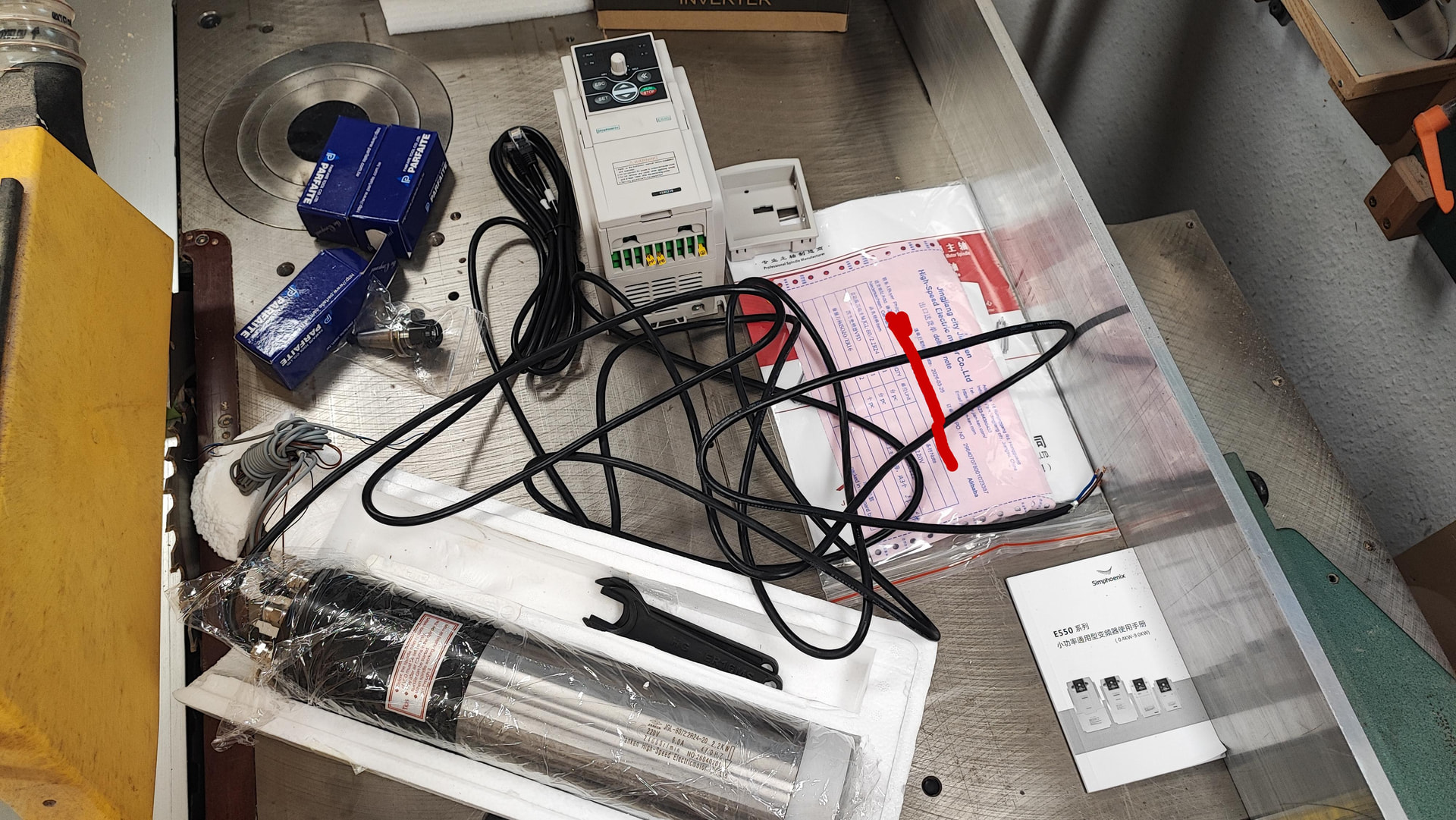

New toy arrived… :smiley: I hope I’ll have the time to play with it soonish. :smiley:
1.486,78 € EUR in total (Spindle, VFD, three ER16 tool holders (that were pretty expensive and I’d skip them the next time)). I asked for DDP and it was cheaper than “normal” shipping because it takes longer… I ordered on the 25th March, so I can absolutely live with that, saving 350€…
A little bit of chaos, but after 10 hours, it works. Not the ATC part, that’s for later… :stuck_out_tongue:
How much was shipping of your total after all of that? I know you saved 350 EUR off of the original shipping but what did you end up paying?
This. :slight_smile:
OMG that was the shipping cost???
No, the hole thing including shipping. VFD, three tool holders, spindle, shipping.
Right but what of your ~1400 EUR spend ended up being shipping? Like was shipping still hundreds of EUR even after saving 350?
That’s the detailed breakdown:
  • JGL-80/2.2R24=1035 EUR
  • VFD 2S0022B=145 EUR
  • 3x ISO20/ER16 costs 72 EUR
  • UPS DDP 135 EUR
The rest was PayPal fees.
I just noticed that I actually paid less because they quoted me in € but charged me in $, which was a loooot better for me. :smiley:
Their support is also top notch, they reply in a few hours usually and the sent me everything I needed. Parameters for the VFD for control via 0-10V, schematics, connection diagrams etc. Everything in English.

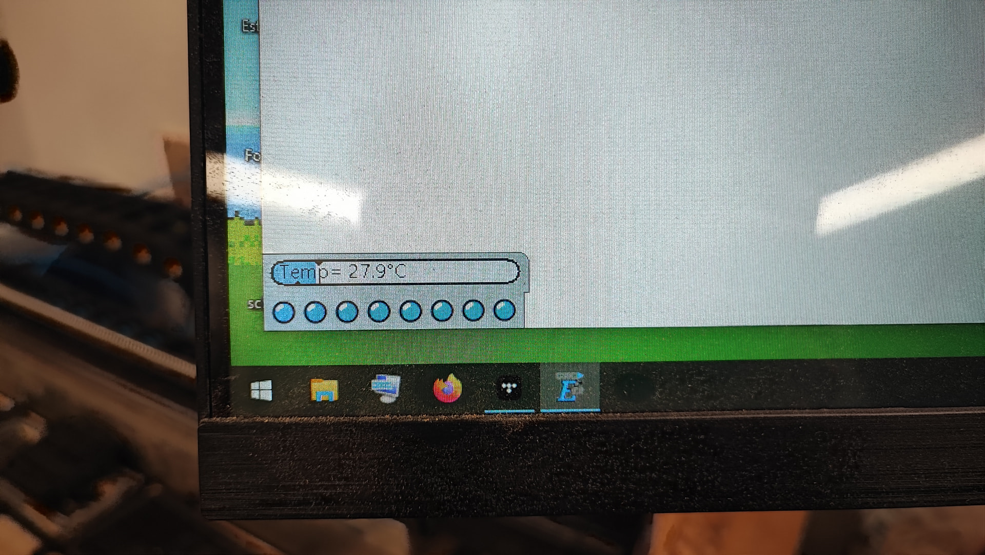

Finally connected the temperature sensor. :slightly_smiling_face: After half an hour the spindle is at roughly 29°C.
I’ll be interested to see how hot it gets once you turn it on! :rofl:
give more info about temp reading … still thinking about it
I have info that 1 the same spindle is free in Belgium, new, newer used for good price
are you using the air when running? According the manual
Hey Peter, I am not doing it via the manual, that’s not possible regrettably. I did try turning the spindle by hand with it activated all the time and it does not make any difference, so I am just using a 5/2 valve for those two, the other two are addressed via 3/2s. The picture you posted that says “wrong” is the one Jianken also sends with their instructions, so they are still contradicting themselves. Per the support I could just leave it out with a new spindle as well.
The temperature reading has to be taken from the black cables (the brown ones are a different sensor), so the instructions aren’t clear there as well. Then it’s a normal 10kOhms resistor.
