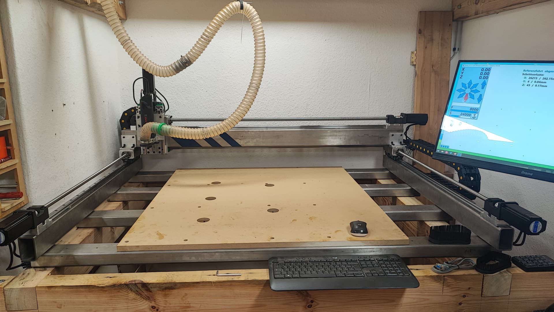

I did consider the Volksfräse by Uncle Phil, but again: lots of aluminium, pretty expensive in the end. I had had an eye on the PrintNC for a while, but I didn’t want to drill all those holes in straight lines. Ugh. Not a task for impatient me without a drill press… I got a bit lucky because I Chinese guy just had started offering the beta for a kit (who has now gone MIA for a month with a lot of people still waiting on their orders, I am also missing a probe and tool length sensor…). So after ordering it at the beginning of May, I received my shipment on Friday, a 145kg box, and then spent the next four days assembling it. The new CNC is called Blue Steel (as you might remember, I did consider that for the Ghostrider, but this CNC being steel and me loving Hammerschlag Blau… that was a no-brainer) and this is what it looks like assembled (the endcaps are missing, but that’s just optical).

I can’t wait to know how it does. How was assembly and squaring?
Assembly took four days with roughly four hours a day, most of the assembly has to be done via CAD. Squaring the frame was pretty easy, the rest of the squaring was also doable but took a while, because there are a lot of screws at play and tightening the wrong ones messes up the alignment quickly.

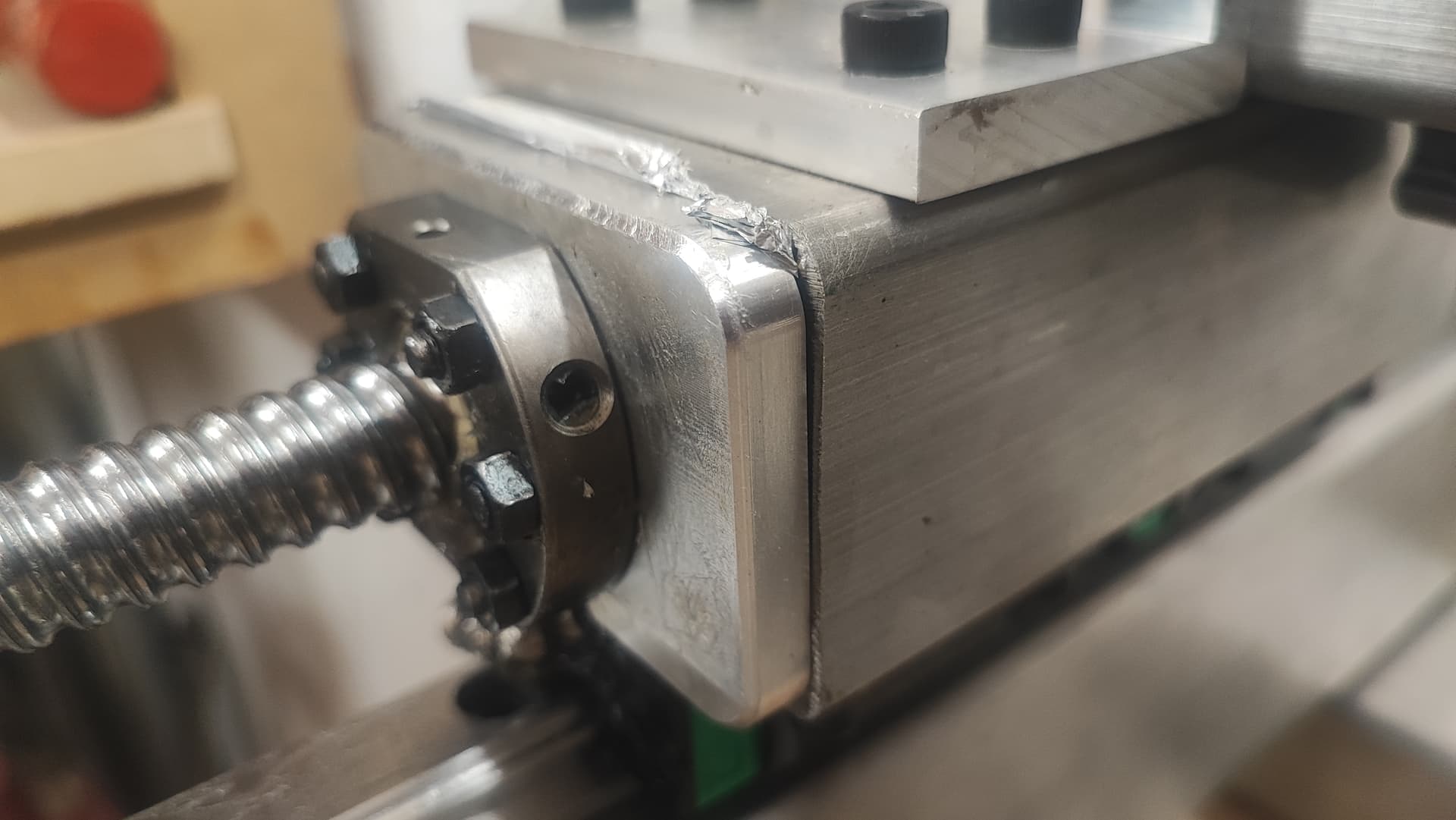

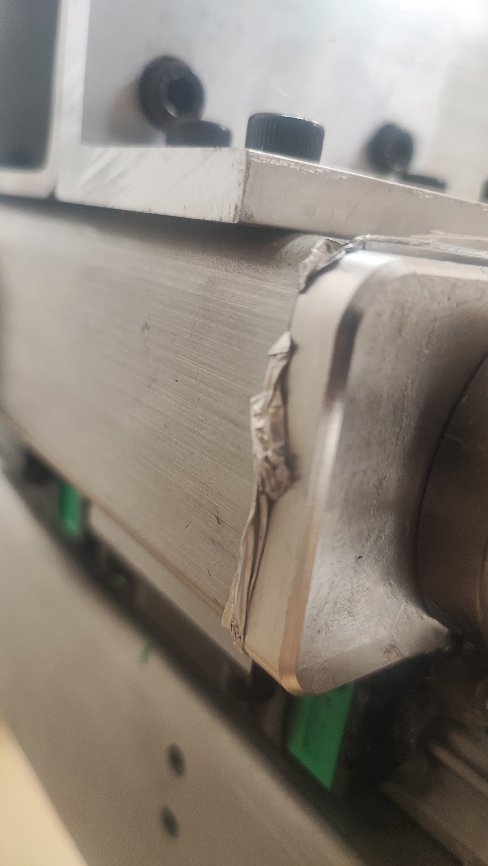

The biggest gripe were the rollers of the set where it seems the saw they cut it with was off, I need to shim quite a bit. If I had realised that before I would have asked someone with a belt sander to square it up for me, now it has ugly shims. Making those rollers move without binding or making weird sounds took me the longest.

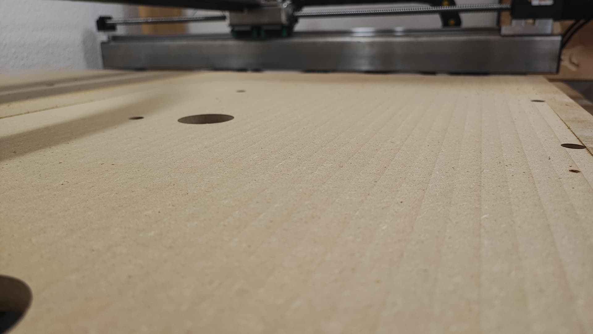

Tramming is fine I guess. 16mm endmill with 75% stepover. :tada:
Can only be seen in the pictures, can’t be felt at all.

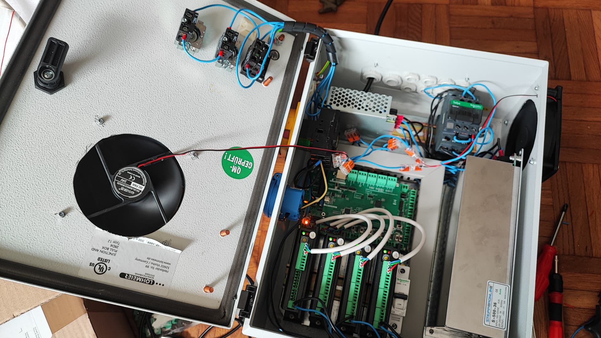

Let’s see the electronics!
There are now some more cables, but the idea is the same.
