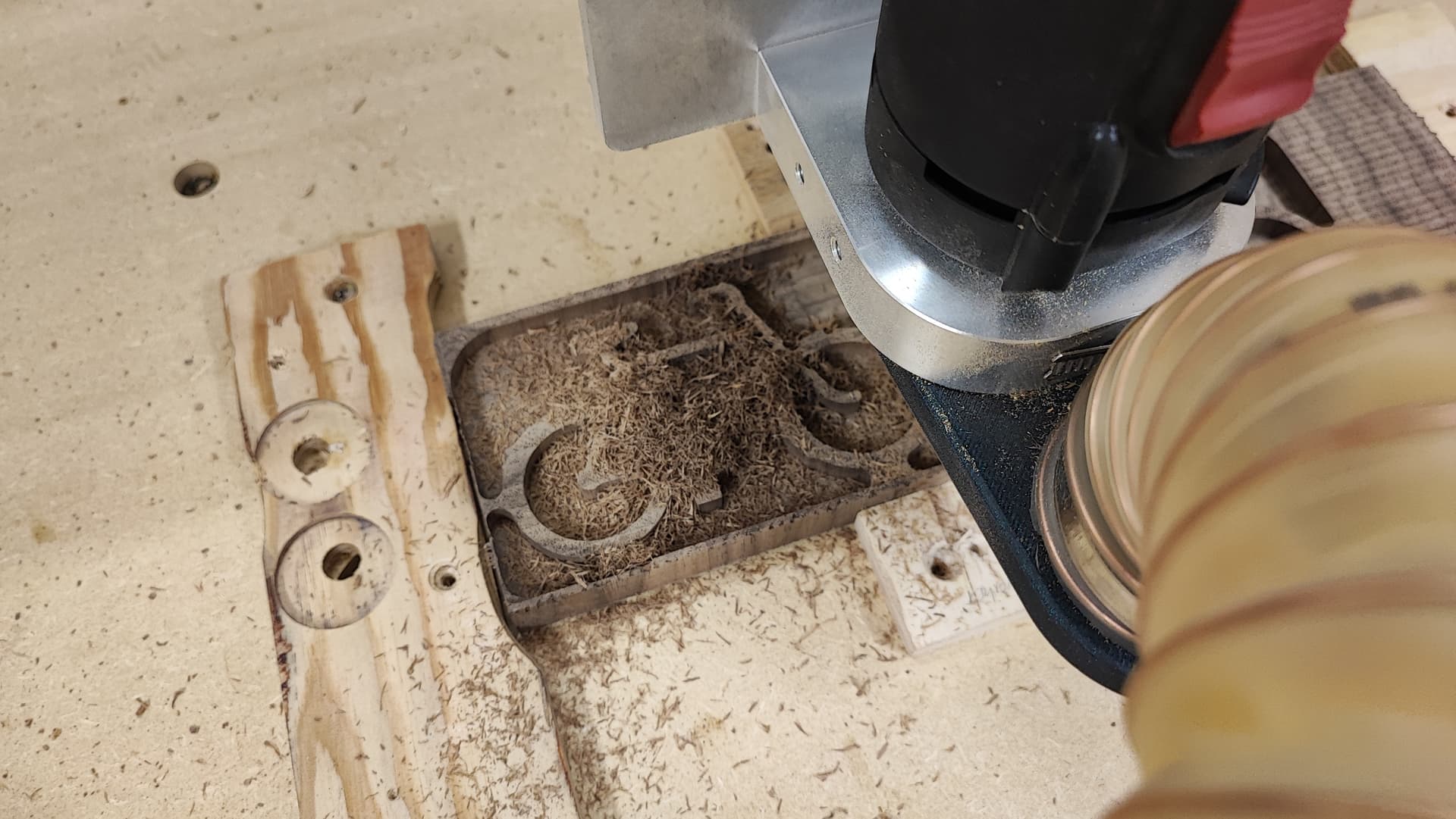

I just used ryans 1/16 at 1250. Made ornaments in short time!

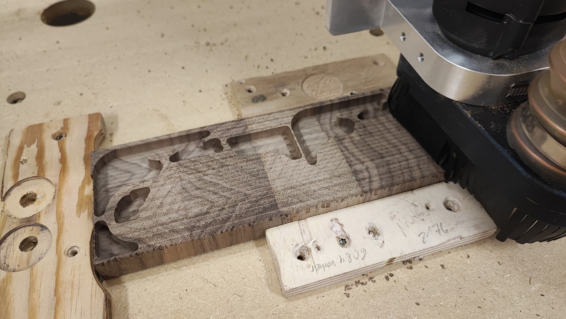

The spindle is an AMB Fräsmotor 1400 FME-P DI 230V (für ER16 Präzisions-Spannzangen), so it’s got 1400W, it’s a long way from slowing down. :stuck_out_tongue: I would have taken the ER20 version, but I bought it used (but new, he never put it on his CNC and bought a Mechatron spindle).

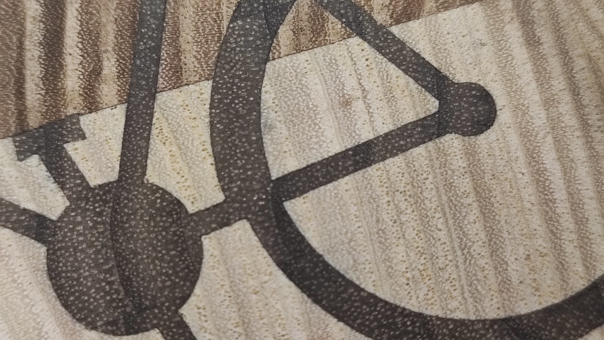

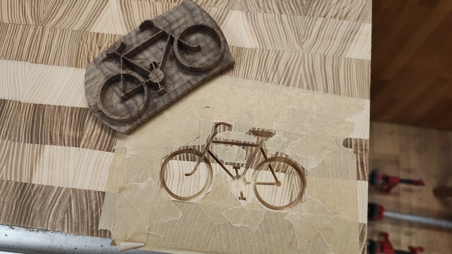

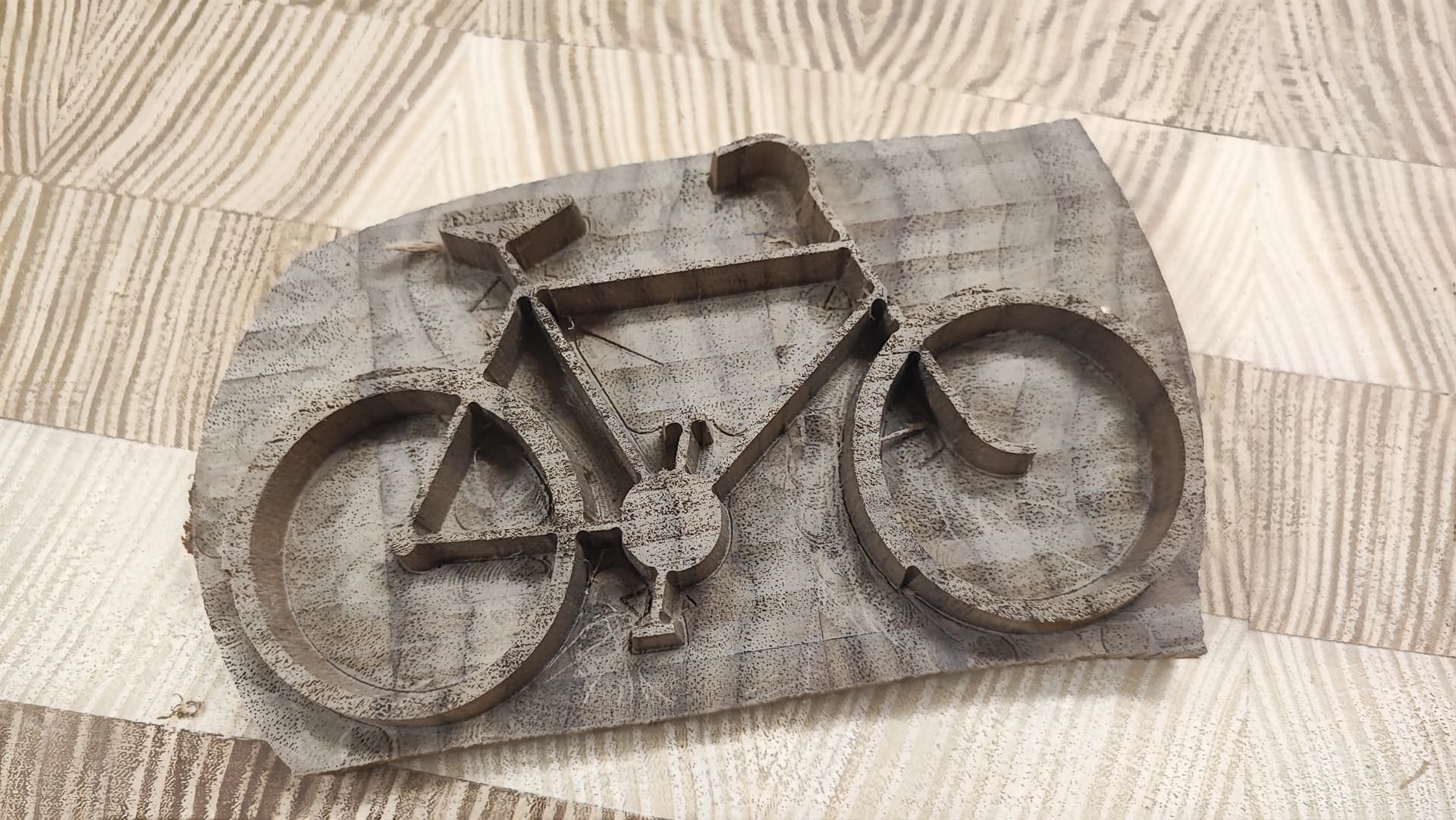

Went 7.5mm DOC on this one with a 1-flute at 1800mm/min and 24k RPM. Edges are great, finishing pass with the 5.2° endmill turned out perfect, no wandering of it.

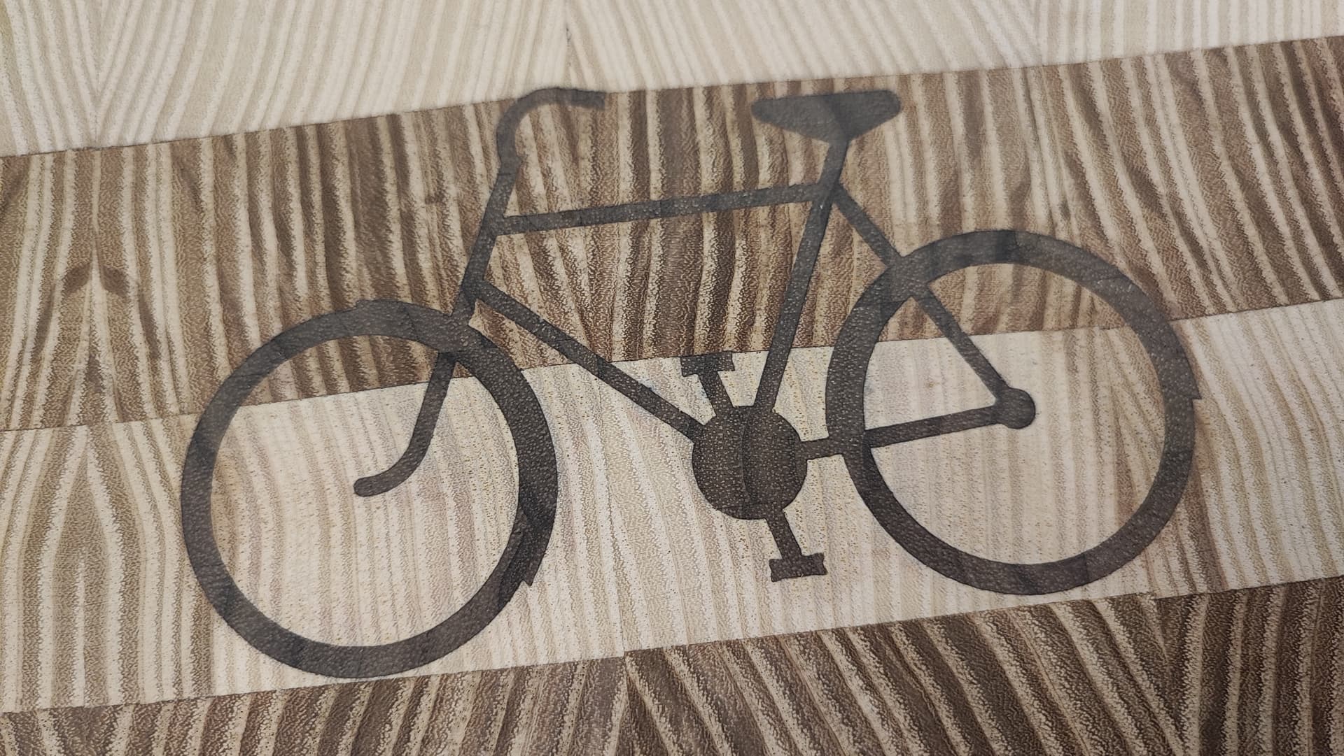

Well, I dare say that this turned out pretty well. :heart_eyes:

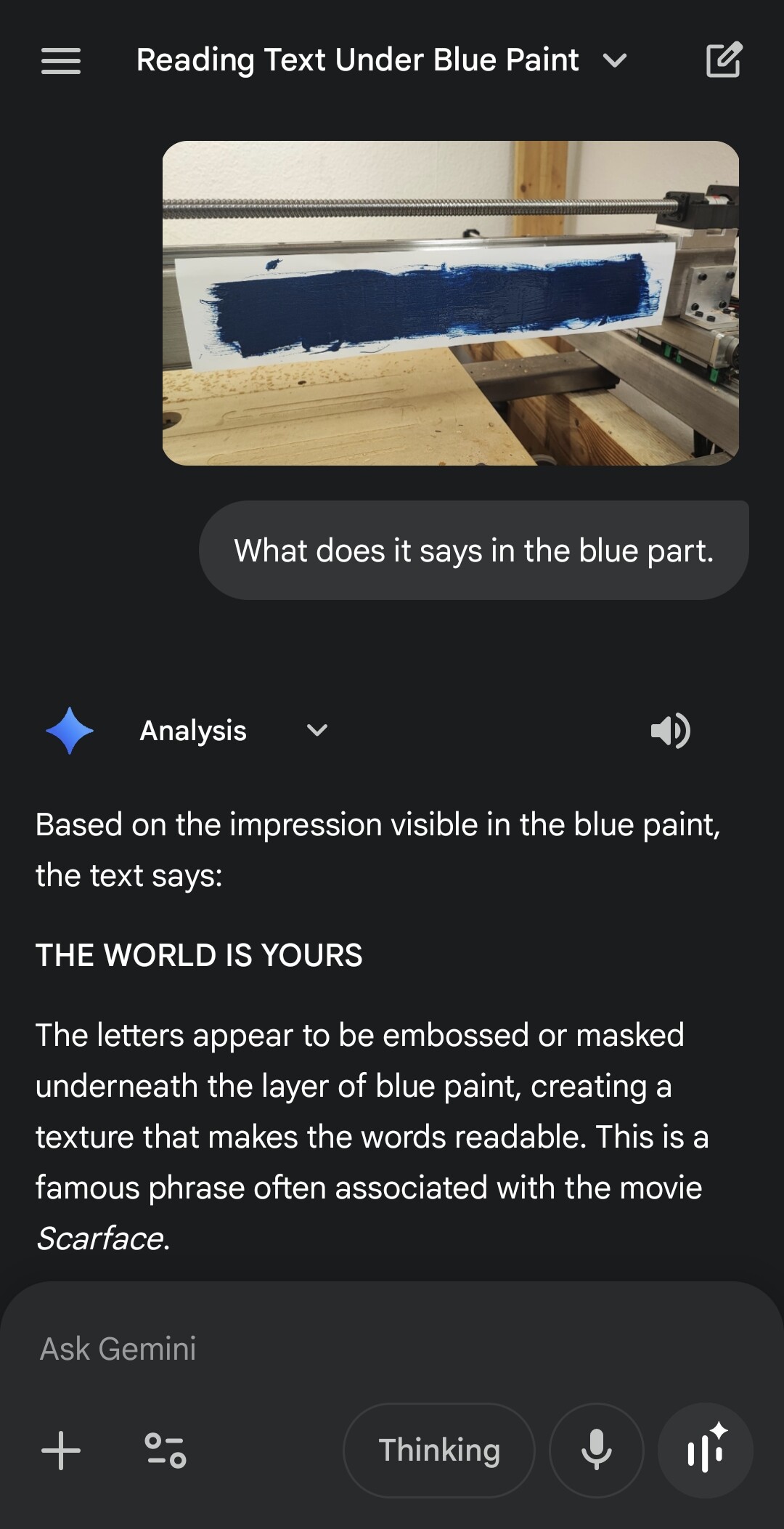

Let’s hope this also turns out fine… :sweat_smile:
And sometimes AI just makes stuff up.
If we’ve learned anything from the past, it more likely says something like
Flarfenugensonheim

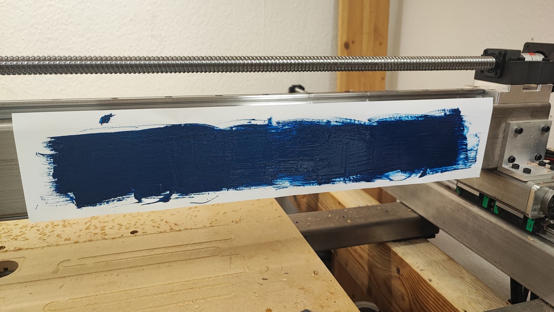

Guys, the name of the CNC is in the freaking title of this thread… Guess what I am going to write on that beam…
wait..
That’s not how you say ‘Blue Steel’?
