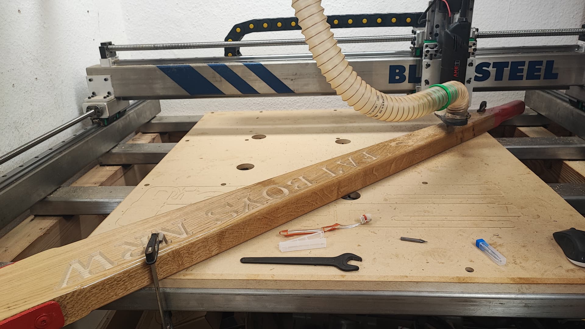

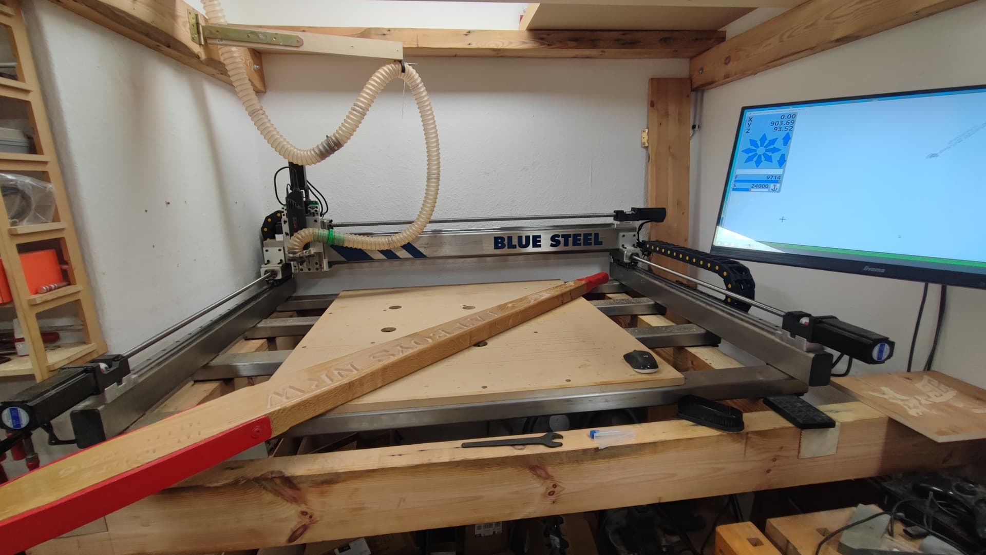

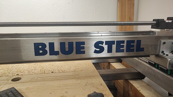

Well, that also worked. There’s one spot at the L I am going to fix as soon as it’s fully dry.
Next time, a quick first coat of clear will prevent that - the clear will bleed under the tape and will be invisible!
That was a user error, I had a little bend in the stencil. The other lines came out perfect. :slight_smile:
I paid for the whole CNC, I am going to use the whole CNC… :sweat_smile:

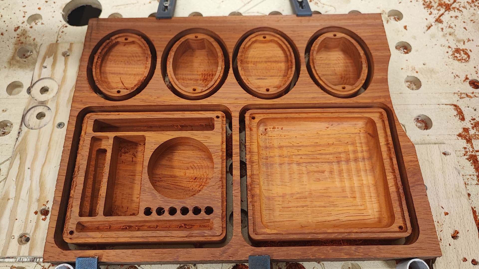

All of those cuts were 25 minutes, including seven toolchanges and 5 minutes of rearranging the small boxes and changing some parameters in EstlCAM because I spontaneously decided to add them as well.
The smoking trays now have a cutting time (excluding toolchanges) of ~9 minutes, before they had 26…
Additionally, the endmill I was cutting with is basically dull… I ran my fingers over it and tried to cut myself (like, not really, but I would have cut myself if it had been a fresh endmill) and the cuts are still spot on. Going to get some of my old mills out again that are still better than the one I am now using.
The bowl endmill with 19mm Diameter is at 4.5mm DOC, 4000mm/min and 18000RPM. Works really well, I think I could go a little deeper.

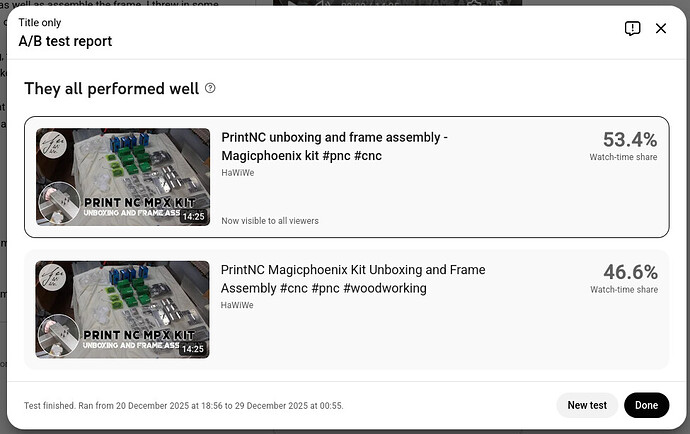

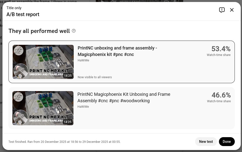

Well YouTube, thanks for nothing?? But the one I thought would do better did marginally worse…:
That looks statistically significant, now try different thumbnails.
That only works if you let it auto generate them I think… And those are ugly. :sweat_smile:
You need photos of yourself looking shocked and disappointed!:grin:
