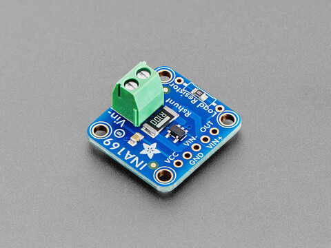

Alternatively, adding something like this:
That would allow you to monitor the current and potentially detect a stalled servo condition and disable everything before damage occurs. To start with, it could simply be a ‘too much current, disable everything and light a fault LED’, with that limit slowly being raised until you’re comfortable. Then potentially you can implement fancier fault methods where you can implement different current limits based on whether there is motion occurring or not. This can be as simple as the current limit being checked in a timer interrupt at something like 100Hz rate using the latest ADC sample and compared to a limit. If motion is commanded, raise the limit to 4A. If no motion is commanded, lower the limit by 0.1A per interrupt until a minimum of 500mA, say. This way you’ve got headroom for motion, allowance for some settling time and a slowly falling lid on the allowed current that assumes things will settle to the idle state. For debug/development you could output the current limit via a PWM channel +filter or a DAC channel and then watch both the current sensor output and current limit using a scope. That makes it easy to visually see what a ‘good’ condition and ‘bad’ condition are and to tune the behaviour accordingly.

I’d put some thought into adding current monitoring of the entire thing to your project, though. That’s likely the single simplest option for avoiding anything too catastrophic to start with.
