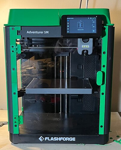

FWIW, I’m still not actually using the enclosure, I haven’t bolted the lower parts to the frame yet. I’m also not very happy with the top piece that holds the LCD, but the top parts are in place.

@MakerJim is not printing the original DIY enclosure but rather my newly remixed minimal enclosure.
In this new one, the LCD does not get moved. It’s in the stock location, mounted on the steel frame.

This is the best part so far, I really like that you don’t have to mess with the LCD mount.

Yes. This new minimal enclosure means the stock, normal distance between the camera and the touchscreen remains unchanged, because the touchscreen does not move. Access to the screw hole used to mount the camera, is offered in both the original DIY enclosure and this new one.
In the original DIY enclosure, the camera stayed put, but the touchscreen moved, and the cable between them became too short!
I had previously found a way to get around that by designing a new printed mount box for the PCB of the camera, effectively raising the camera as much as possible, barely getting its short cord in reach of the moved touchscreen. It worked, but barely, and sometimes the tension on the cord would result in the camera becoming unplugged. Frustrating.
Now that the touchscreen does not move, the camera cable is more than long enough.
I like these aspects of the new enclosure (touchscreen mounted more securely in original location on steel frame, and camera cord not being stretched) so much that I’m seriously considering redoing the DIY enclosure on my #1 and #2 AD5M’s to match the #3!

I’ve now got a first cut of everything but a spool mount printed, and all the front/side panels and parts installed. I’ll work on the top stuff tomorrow most likely.
There are things I like and don’t like about the remix.
Not moving or messing with the LCD is a big one. I really, really like this.
The modified handle that needs no supports and the relocated filament sensor part appears great.

Present state:
Some more issues:
The hinges suck. They didn’t break free for me, and instead when using force to try and snap them free, they broke at a layer line. Maybe bad adhesion, but honestly it’s a terrible design. (from the original FF parts onward.). I found an alternate part on Printables which was a multi-part print, then had to re-size the hinge pins to make them installable. Good idea on that remixer’s part, terrible execution. But it worked eventually.
The four back parts on the sides, these are only retained with a single screw each. The original FlashForge enclosure parts (that were not minimalist) wrap around and there are more than one screw to secure each part.
Honestly, only using one screw to retain a part like this is a terrible idea. These should get recesses in the side opposite the screw to install a magnet in each part near near the edge opposite the screw.
Just after I took the picture above, I used some blue painters’ tape along the back sides to get them to lay down.
Edit to add-
The four side bottom parts have guide slots for the acrylic panels. These print as unsupported overhangs. They printed, but I had to do some trimming with a hobby knife to get the acryilic to slide in.
I plan to re-print the top parts with a different brand of PETG which will arrive Monday.
