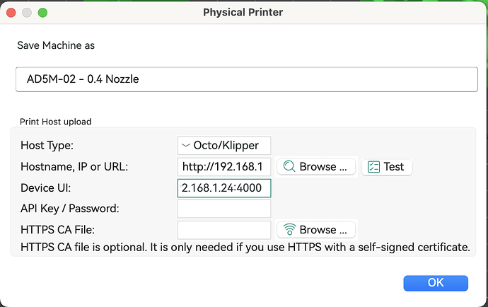

Out of the box, I connected my new A 5M to my IOT WiFi network and let it update its’ firmware, but am unable to get connectivity. The factory FlashForge MacOS Orca version won’t connect to the printer, nor the Linux version of OrcaSlicer 2.2.0-RC.

On OrcaSlicer 2.1.1 on Windows, I have no problems sending files to the printer. I just told it a host type of FlashForge, put in the printer IP address and it worked. It is odd that there is a Device tab that won’t load but otherwise that part works.

Hmm, the device tab being inoperative is what stopped me.

But I believe the device tab is inoperable because the flash forge doesn’t come with mainsail/fluid installed. So there is no webui for it to load on the device tab. Once you do the full Klipper conversion then you can install mainsail or fluid and you will then have the device tab working. Or be able to load the webui in a browser. That would also give you a lot more info on what the error is. I know I have arc fitting disabled on my Klipper printers. I was fighting a timer too close issue on my V5 and that was suggested by one of the Klipper admins on discord.

The device tab is basically a browser tab that can show a Klipper HTML UI served from the touchscreen. On stock I guess nothing is served. This works with Klipper mod. One port number (7125) is for transfer and another port number is for UI. (4000 is for Mainsail, and I think 4001 is for Fluidd).
One can connect for file transfers (port 7125) (shown in upper row of screen shots) without bothering with the device interface row, which I think, on stock, is the only way to get remote transfers short of not using OrcaSlicer and instead using Flashprint reskinned Orca. In actual OrcaSlicer, ignore the device tab settings unless using the Klipper mod. Same screen shots I shared a moment ago, again below.
Note: once the remote transfer URL and port are set and working, you can choose between “print” or “export” — print will send to printer remotely, and export will output a GCode file on local hard drive or local USB stick.
After selecting between print and export, it alters what the main button says. Then just tap the main button while it says Print, and you get this modal popup dialogue:

When you first switch to the device tab, and with the Klipper mod installed, and the URL and port number setup, for example:
Mainsail: http://192.168.1.14:4000/ (where the IP address is changed to match your setup)
Fluidd: http://192.168.1.14:4001/ (where the IP address is changed to match your setup)
Then you see the very same thing as would be shown in a browser.
At first you see a connection response:
…And then the chosen UI:
